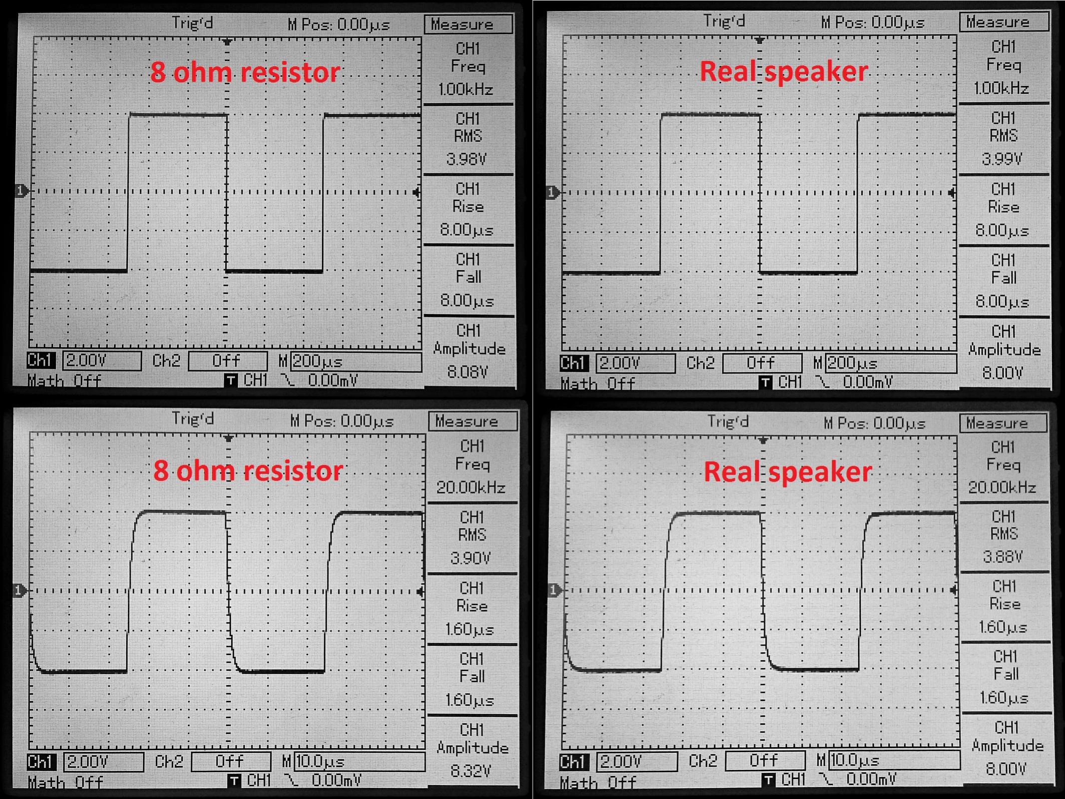

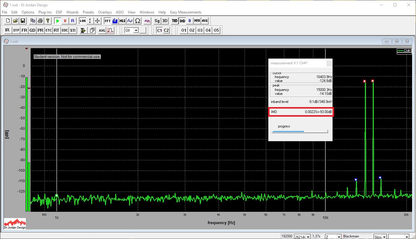

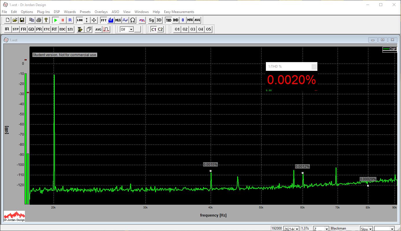

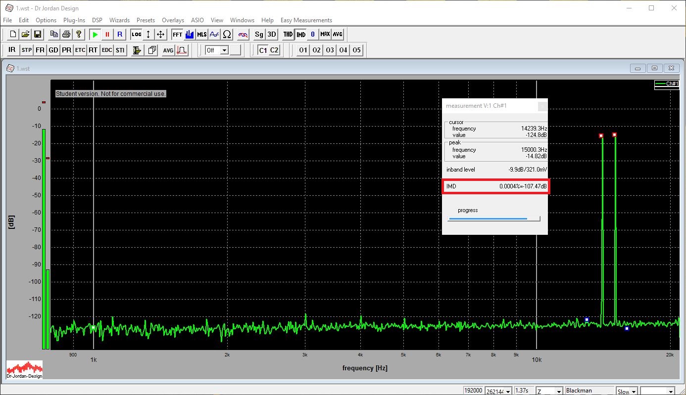

Here are the same measurements for 5W @ 8 ohm.
It definitely goes easier with the resistor - no surprise 😛 - but still looks pretty cool with the speaker.
I will also try to see the square wave on the speaker later today 😉

real good!
practically the only IMD showed significant differences...
but distortions still damn low!
great!
great!
Almost no one posts scope pics into speaker loads, or simulated speaker loading.
That makes comparison with other builds nearly impossible.
Do you think your "real load" results are good, or excellent, compared to other designs?
Could you post a sch of a simulated speaker load so that others can try a similar test if they care to compare when loading is reactive.

These ones are physically measured on the real Monitor Audio RS-8 - I had to cover it with a few winter coats, so that 1KHz does not drive me crazy too much 😀
Although, Richard Marsh has sent me a good speaker model the other day - useful for simulations. I'll try to find it must be somewhere in my simulation archives.

Here are THD and IMD measurements for 2W @ 8 ohm.
These ones are physically measured on the real Monitor Audio RS-8 - I had to cover it with a few winter coats, so that 1KHz does not drive me crazy too much 😀...
