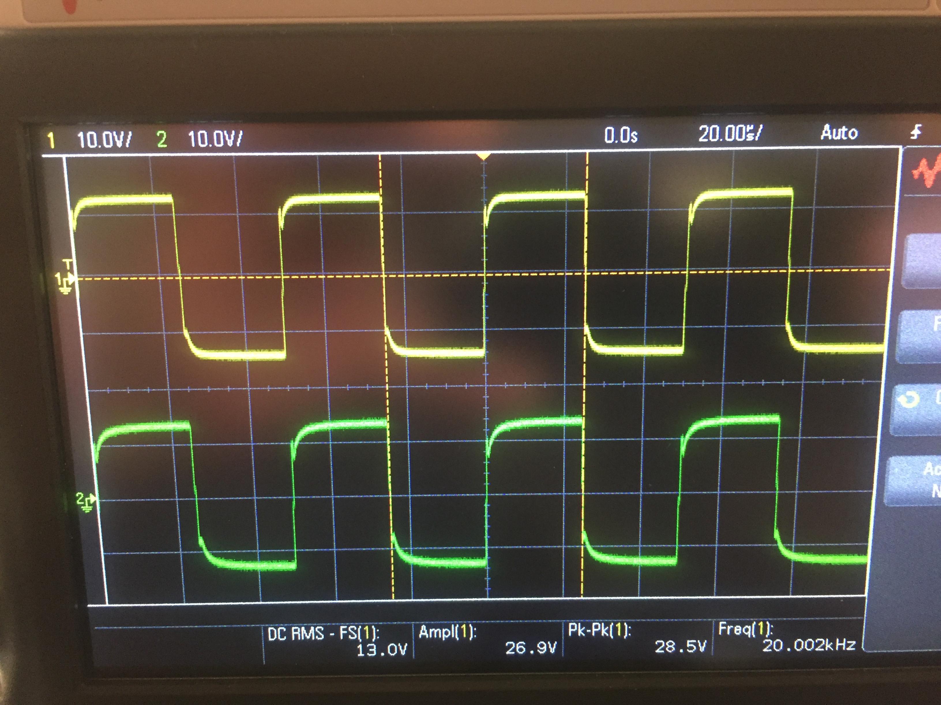

Well I finished replacing all the electrolytic capacitors in the power supply and throughout the amp. I am pleased with the outcome. Well worth the effort.
Now, does anyone have an idea of the cause of the spike on the square wave.

I should add that the square wave in the previous post is from the Sansui 9500 @ the output with an 8 ohm load with the signal into the main amp, preamp separated.

Scope one chanel at a time.
The output signal only.
it could be:
1. Slightly more VAS compensation is required
2. More output bias could clear it up.
