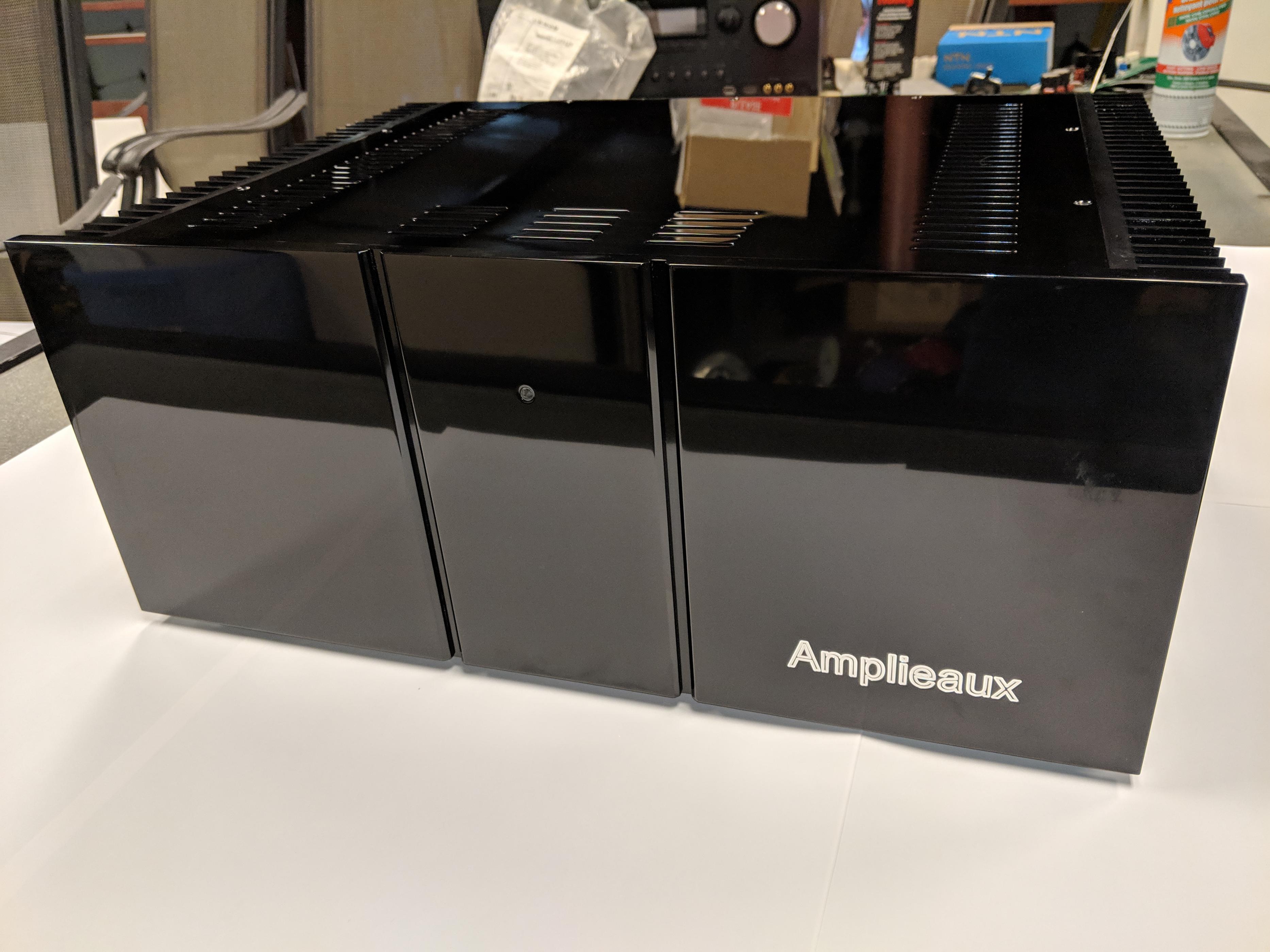

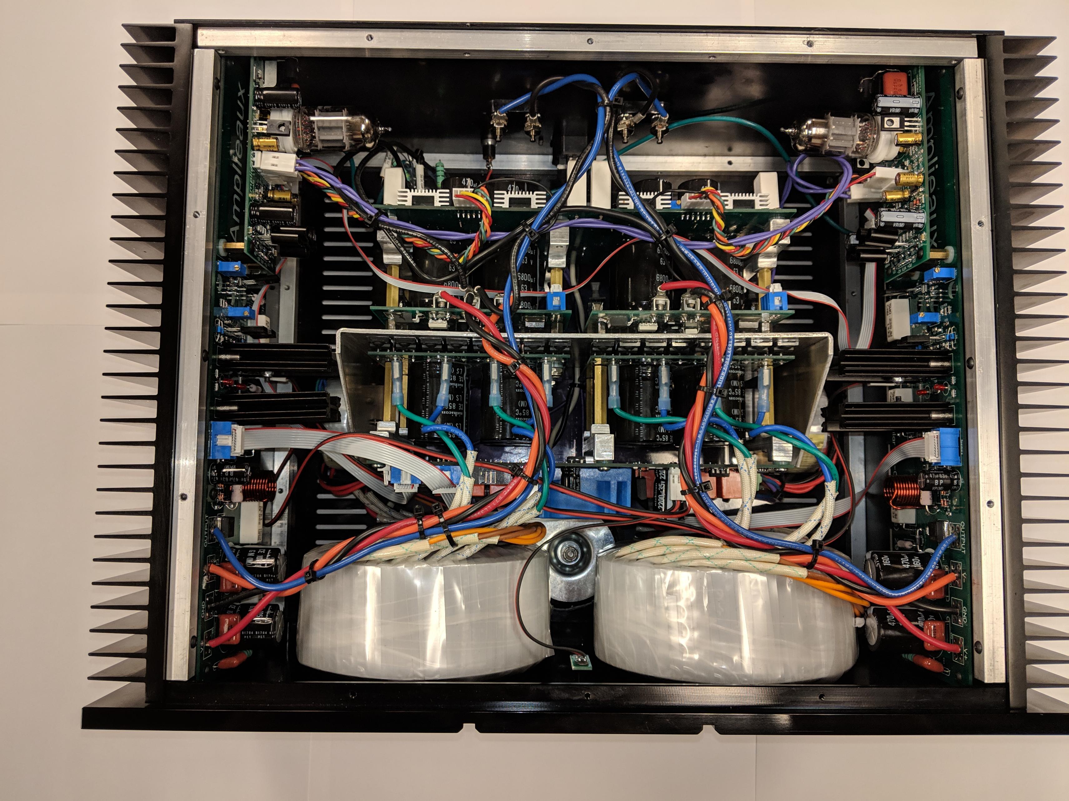

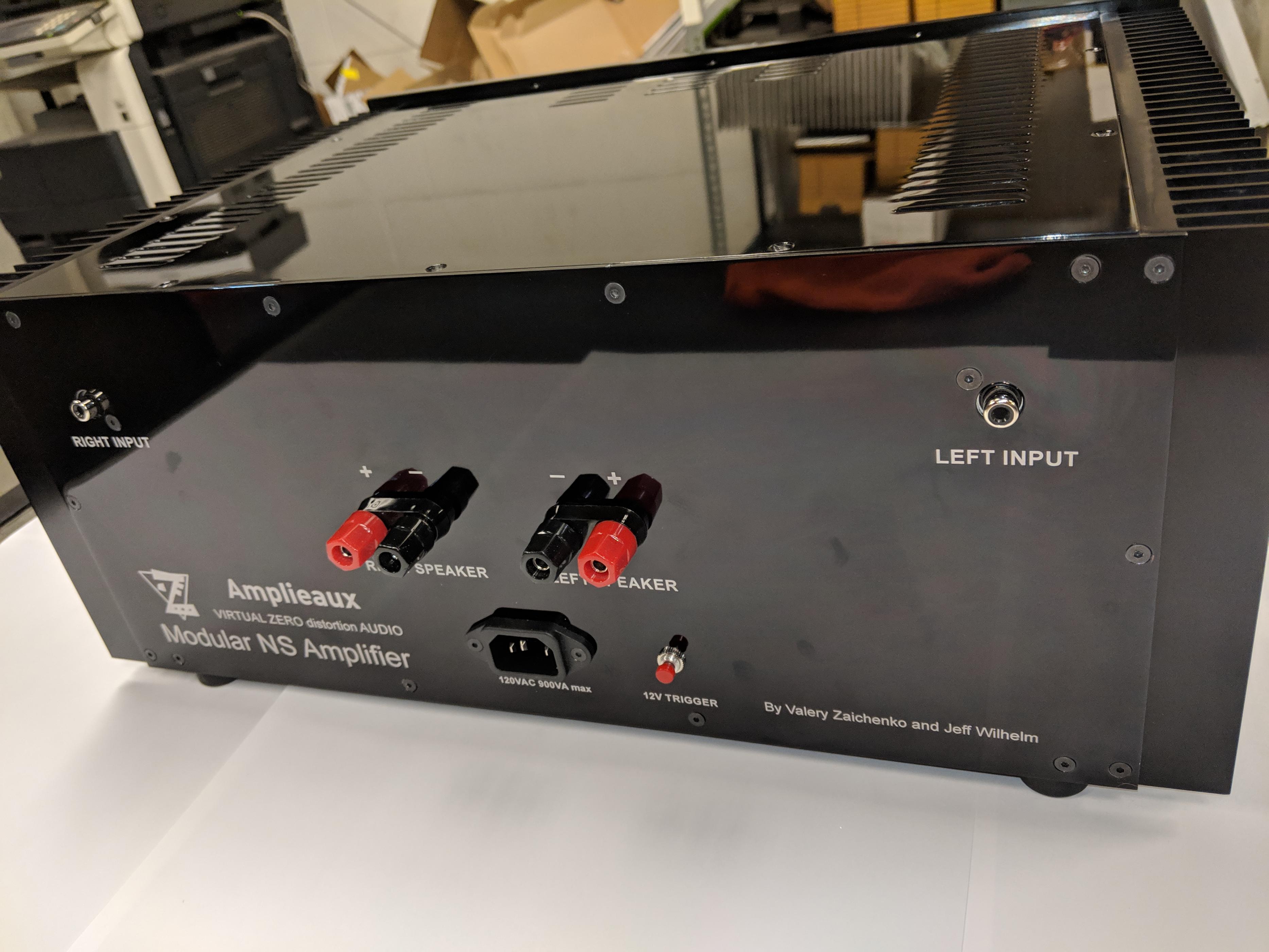

I'm putting the finishing touches on a new Modular NS-OPS amplifier with TubSuMo inputs. It's running +/- 56V rails with an output power of 150W RMS @ 8R. I tried a new finish on this one. It was buffed to a mirror state before anodizing, then lightly polished after dying. I like the results but it's definitely not good around kids, fingerprints are a problem.

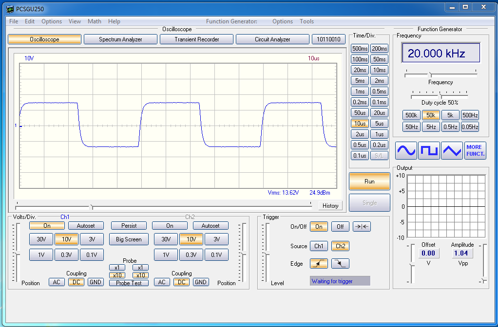

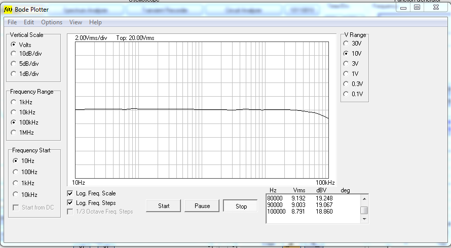

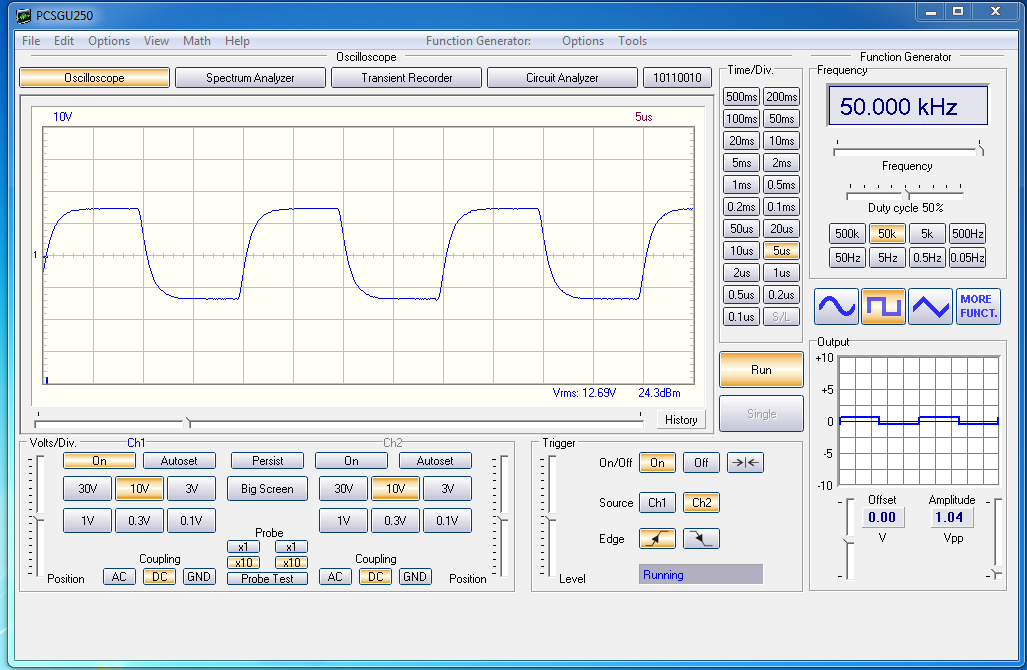

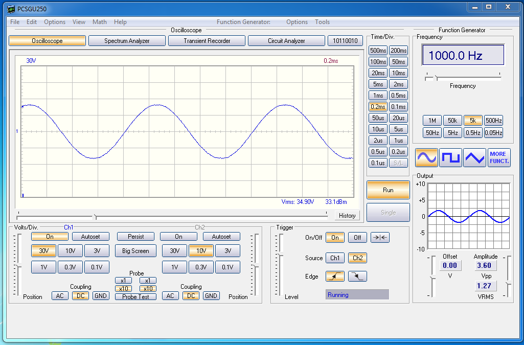

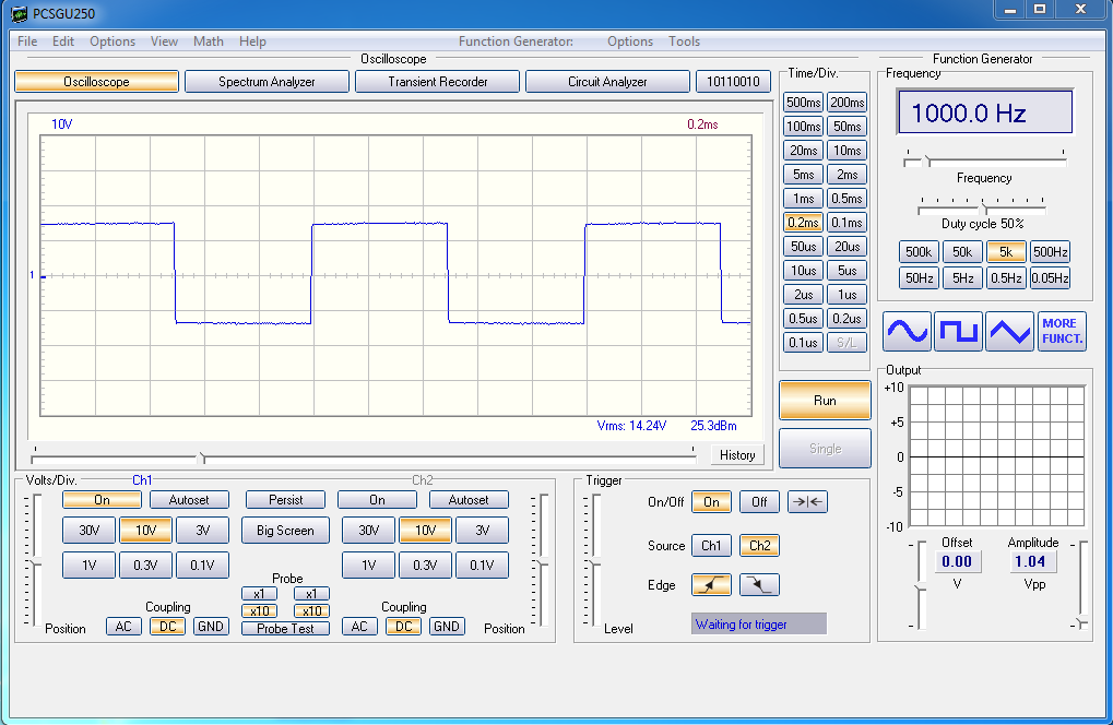

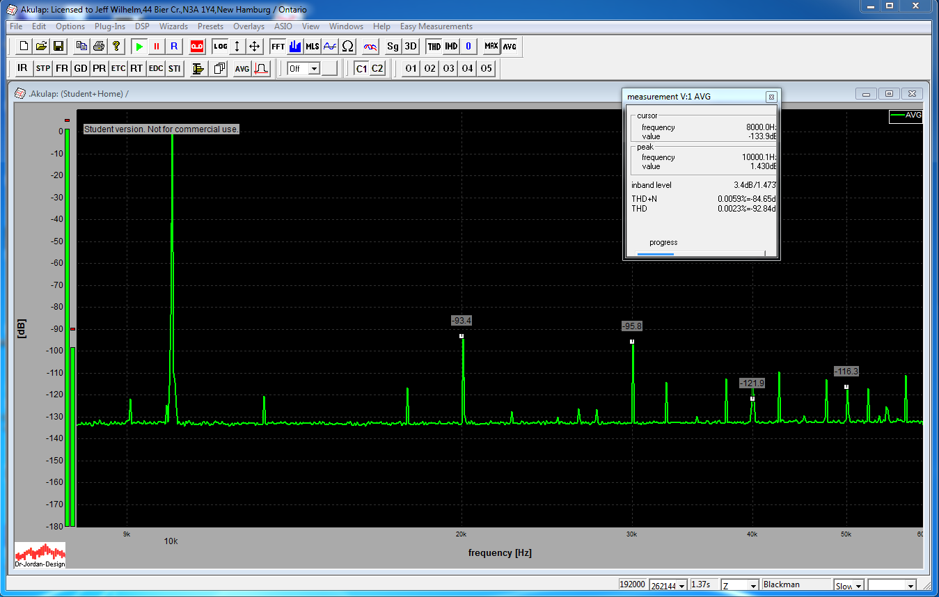

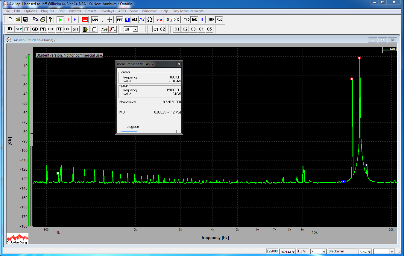

I've done some quick measurement on the amp. Sound is great! With open input you can faintly hear some 60Hz hum with your ear against the speaker. This hum disappears completely with the input shorted. My quietest amp so far, but I'm having some ground loop issues with my test equipment so it doesn't measure the best yet. All tests were done with a 8R dummy load.
What a pleasure to my eyes

Nice very nice Jeff,perfect!😎I've done some quick measurement on the amp. Sound is great! With open input you can faintly hear some 60Hz hum with your ear against the speaker. This hum disappears completely with the input shorted. My quietest amp so far, but I'm having some ground loop issues with my test equipment so it doesn't measure the best yet. All tests were done with a 8R dummy load.
Wellcome to fft world.😉
If my memory serve well you are an RTX6001 owner?
If my memory serve well you are an RTX6001 owner?![]()
Yes I have an RTX6001. I've got the new Virtins software too but haven't had time to even install it yet. I still need to install the hardware and firmware updates in the RTX too. Racing season is done for the year so I'll have some time to play before it's time to rebuild the bikes for next year.
