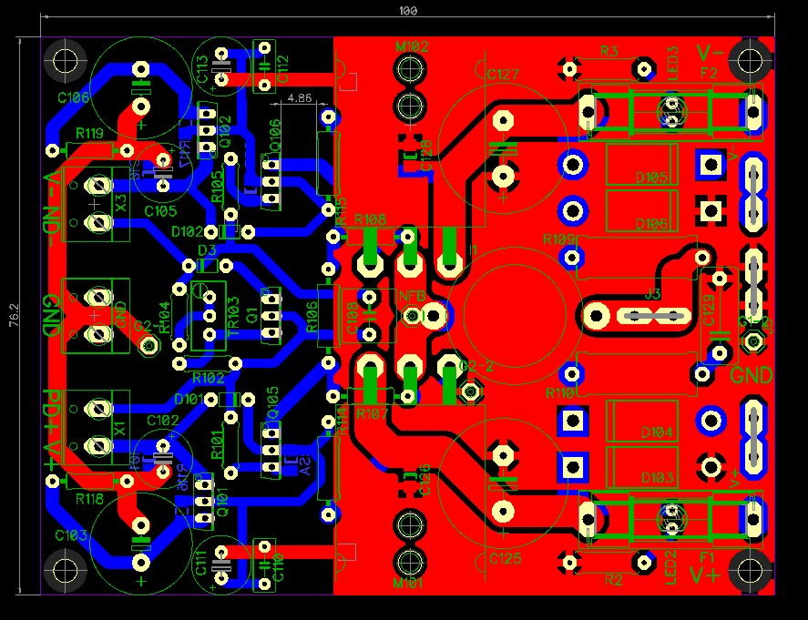

Yes it worked first time. A warning. the boards I etched were designed my Marc (Idefixes). They have different part numbers that the schematic that Valery posted. Marc provided a BOM that helped quite a but I wanted to use Valery's values which were different on a couple resistors and caps so I had to follow the traces on the board to discover which ones they were. It may work fine with the values in the BOM, I didn't try those.
This is asking a lot, but since I etched the same layout, any chance you would post your silk with values? I can trace it as well, but I am a Pass Forum greedy lazy boy. It's cool if that's too much of a pita. Thanks!:cubist:
I won't have time today but I don't mind doing it. I'll try to post it tomorrow.

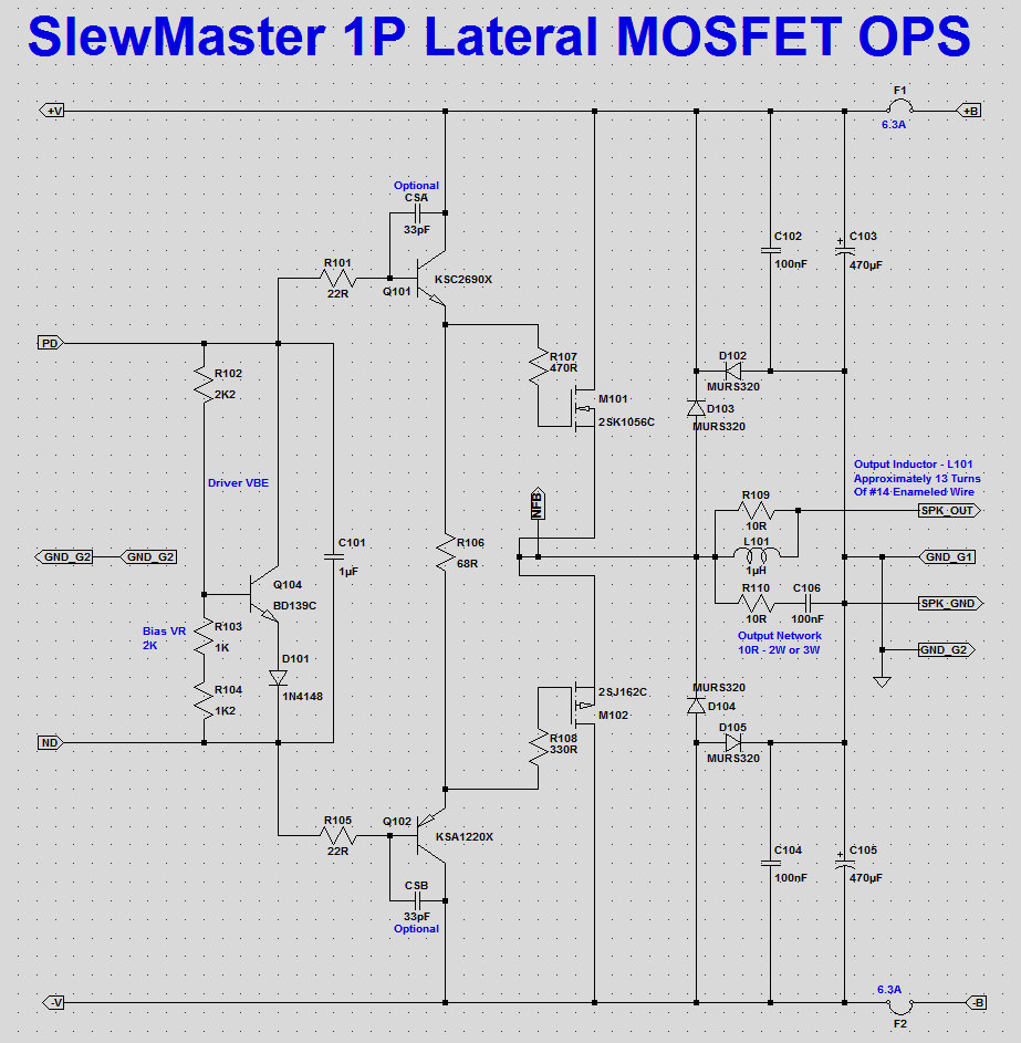

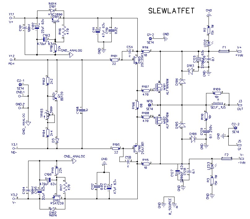

Very cool! Is it mini Slew, that was used in all these recent tests? Have you got a link to its schenatic by chance?
Thank you,
Valery
Hi Valery,
Yes it was the slew mini. I like to use it for testing when I can because it is small and somewhat more tolerant of ips current differences. I'm not at home so I'm on my phone.l tried searching for the schematic but we designed it through three different threads and I couldn't find it. I will look again in the morning when I am back at my computer.
Blessings, Terry
Edit: I see that Marc had it.

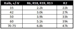

Hi valery,
do you remerber, we discuss about a Parts Value / Vrail (35vdc, 42vdc, 50vdc... ) charts for tube version? If you had a little time...I will order some board of the Tube IPS.
Marc
Hi Marc,

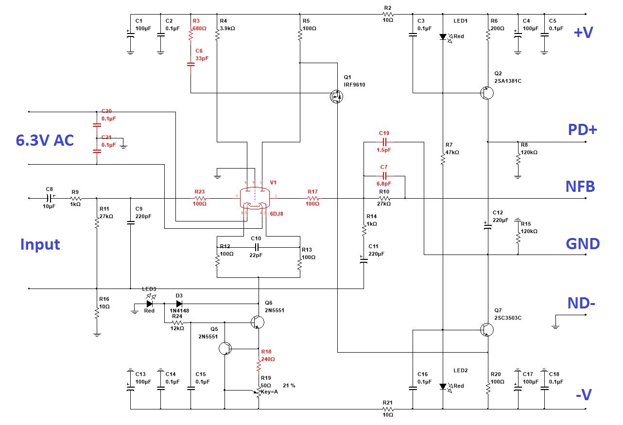

Here is the chart for Tubie version together with the schematic (just in case, same as shown in post #209).
Valery
