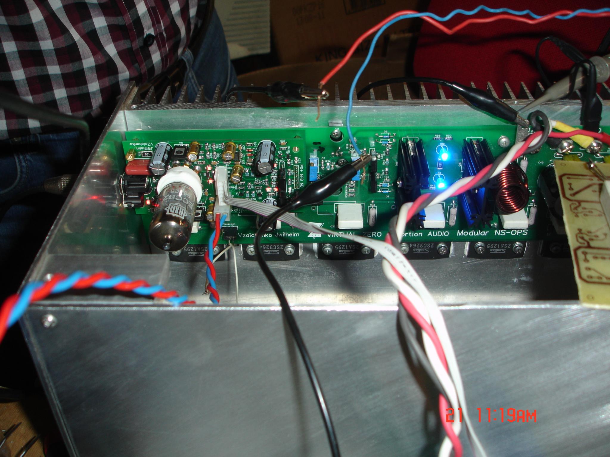

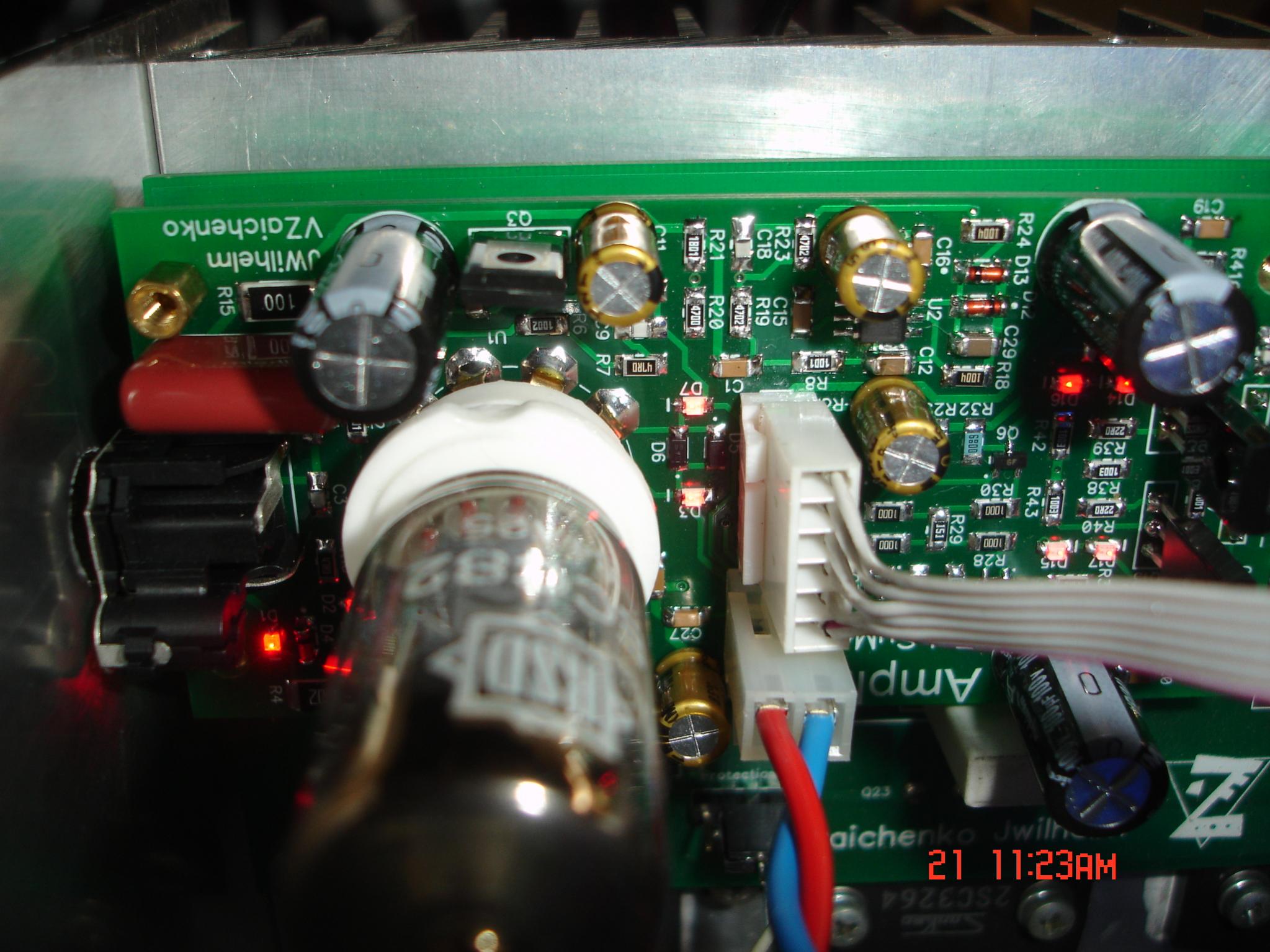

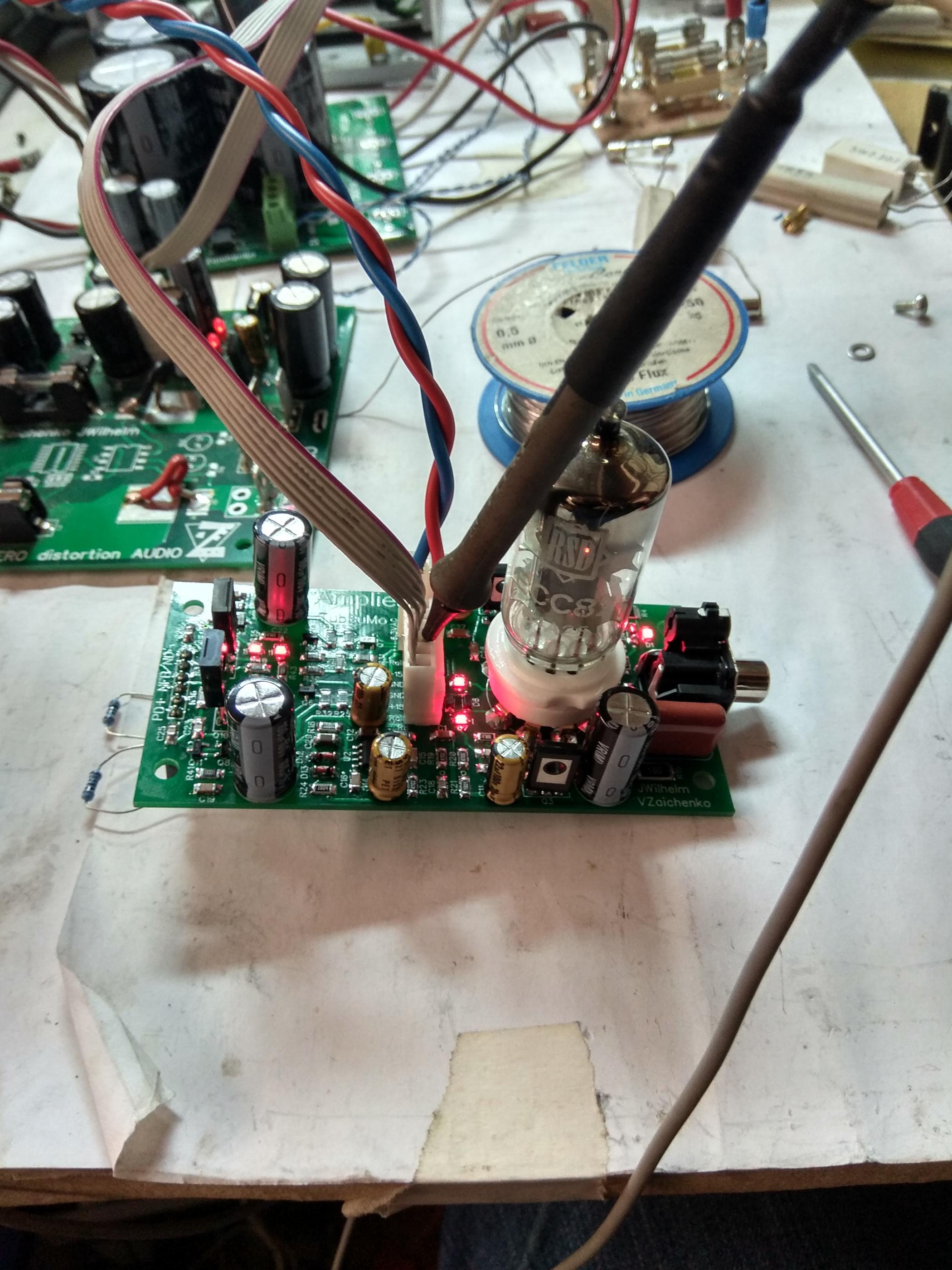

SMD LEDs look cool 🙂 I didn't test this version before - tested only an earlier TH one, so this is the first time I see this one running.
Stonehome, use only white heatsink paste. The stuff for CPU heatsinks can be conductive. I lost a few IRF240 in the sx780 over this issue.
Great build Thimios!
Mine is assembled but not yet tested. I'm re-calibrating the NS OPS channel that went bad due to a bad choice of resistors for the drivers. I was told not to use high precision resistors in high current areas since they cannot take abuse and tend to snap quite easily. Bought some 3/4W thick film and installed those. The amplifier seems to be working properly now and I'm just finalizing the last calibrations on that channel.

Finally found the time to finish re-calibrating the NS-OPS and everything seems to be fine. I hope I have some time this weekend to fire up some music on it.

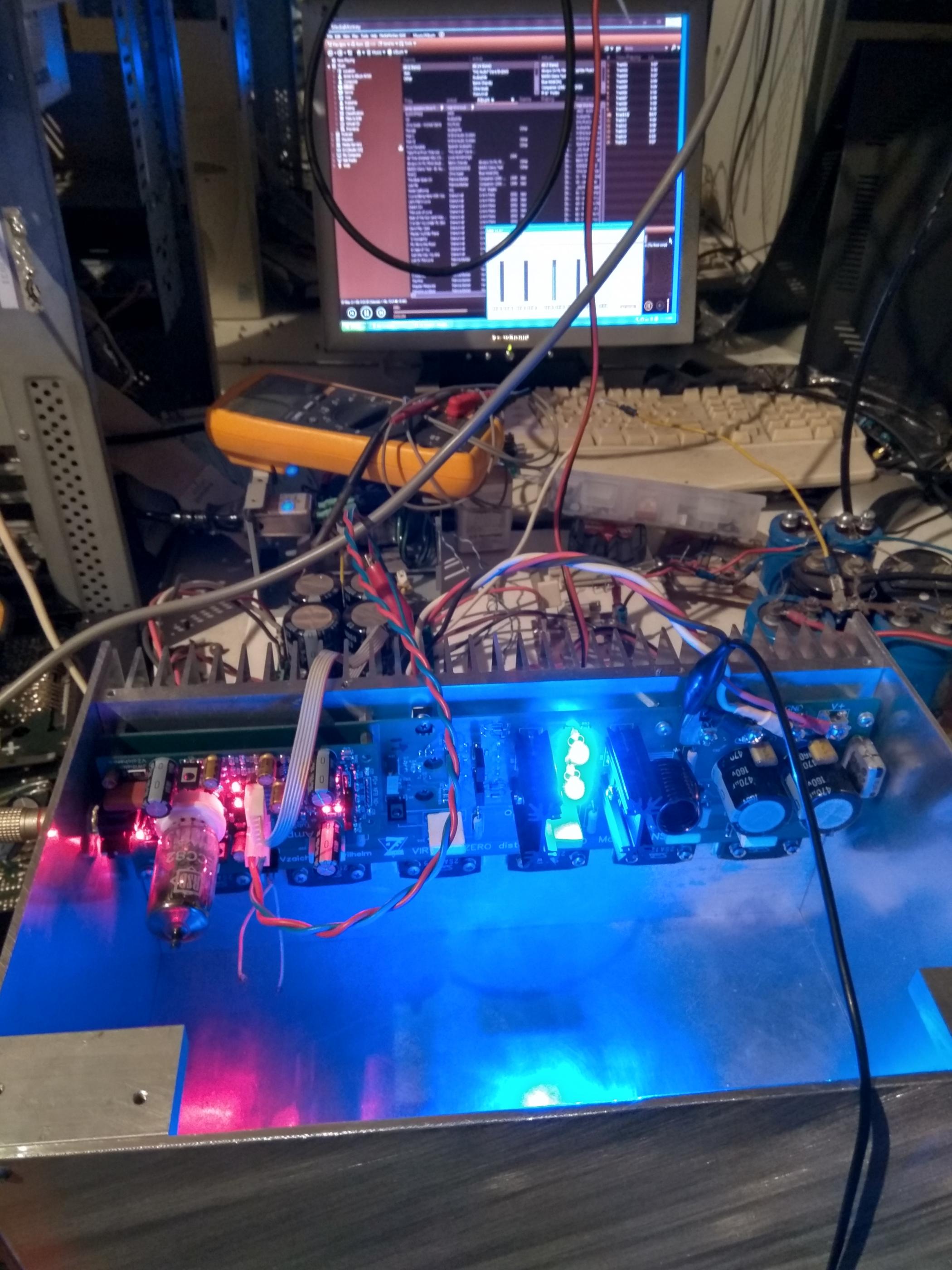

Singing!
A wonderful sounding IPS.
I listened for a little but i like this!😎
Test will be later.🙂
Beautiful - many red and blue lights - it's alive! 😀
I like this combination a lot I have also tested it with my TH prototypes about a year ago. Now this is the next level of "technology" 😎

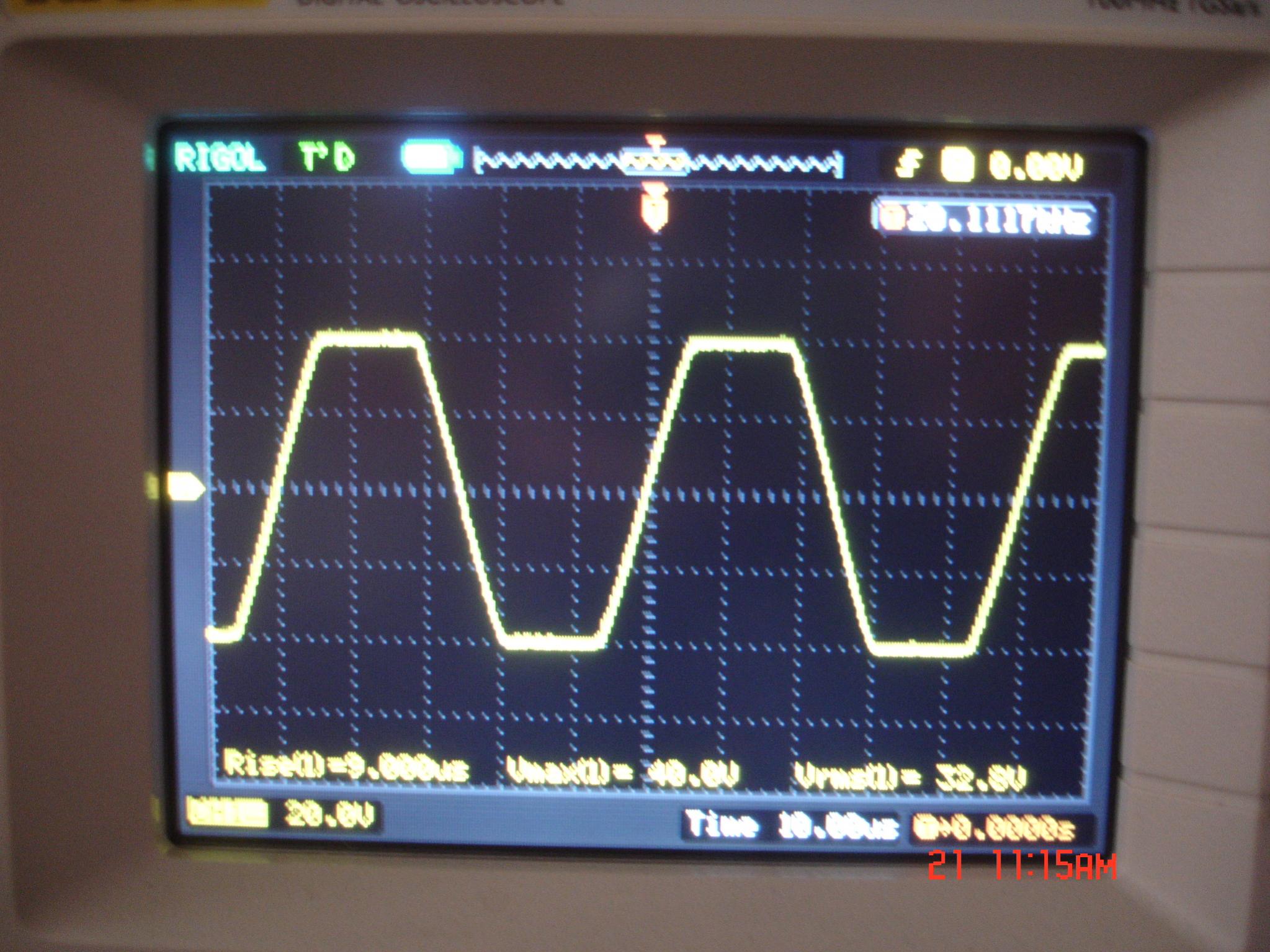

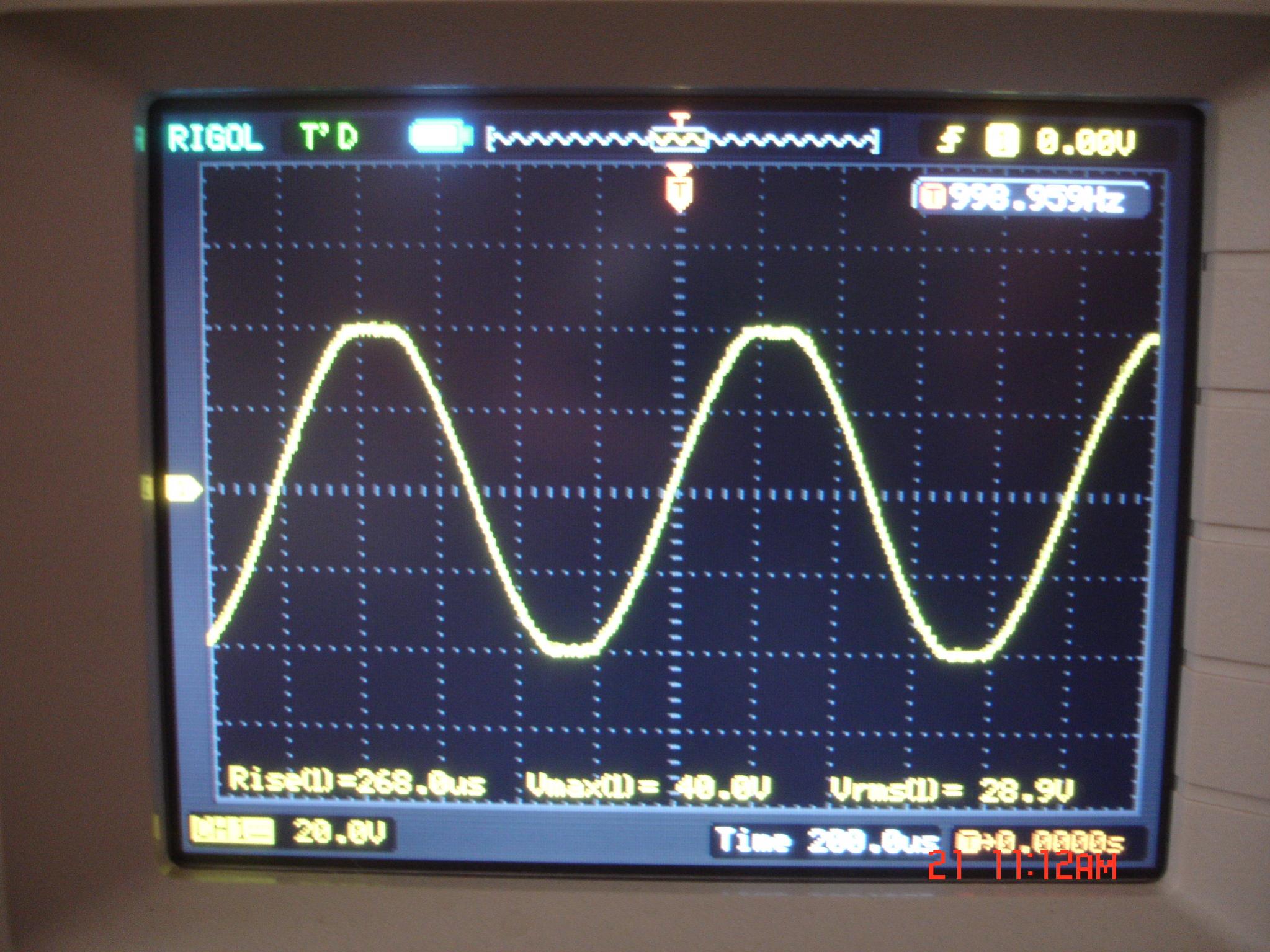

TubSumo

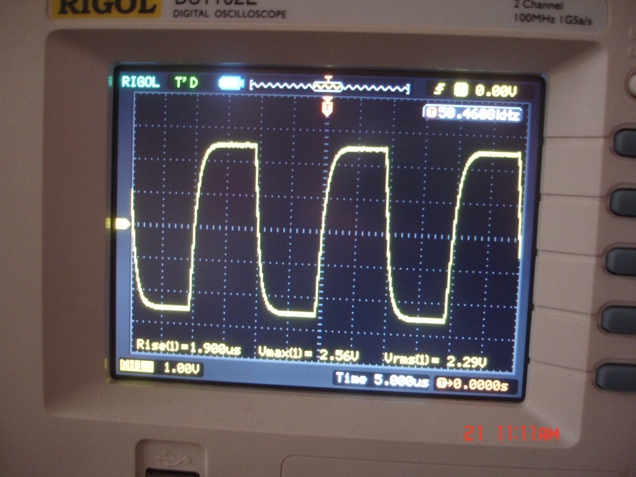

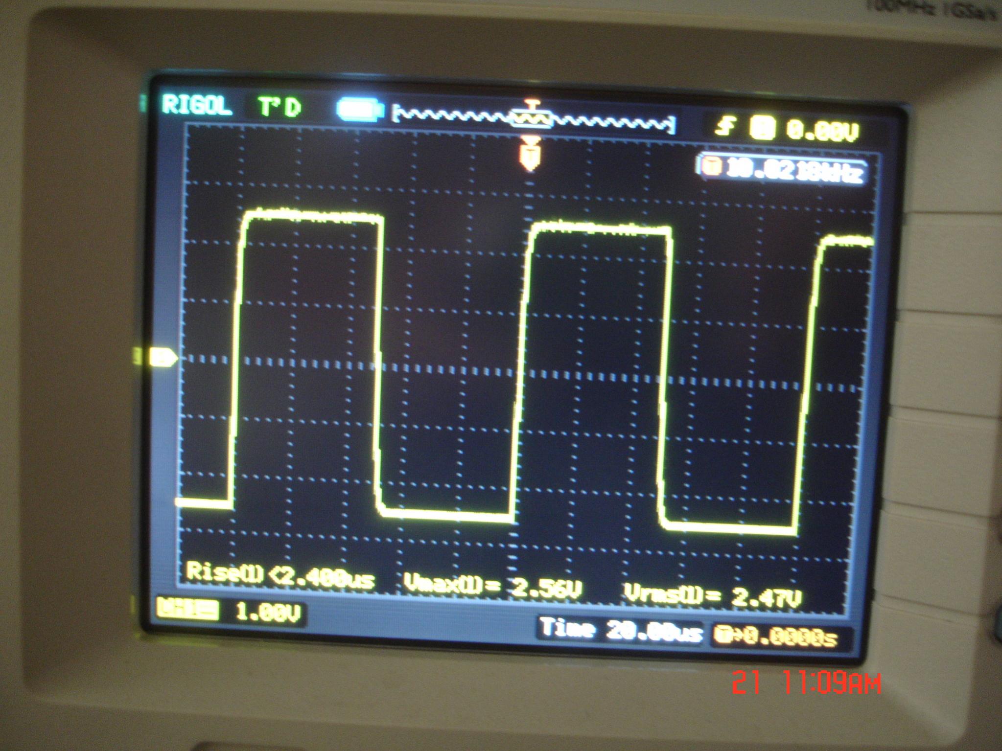

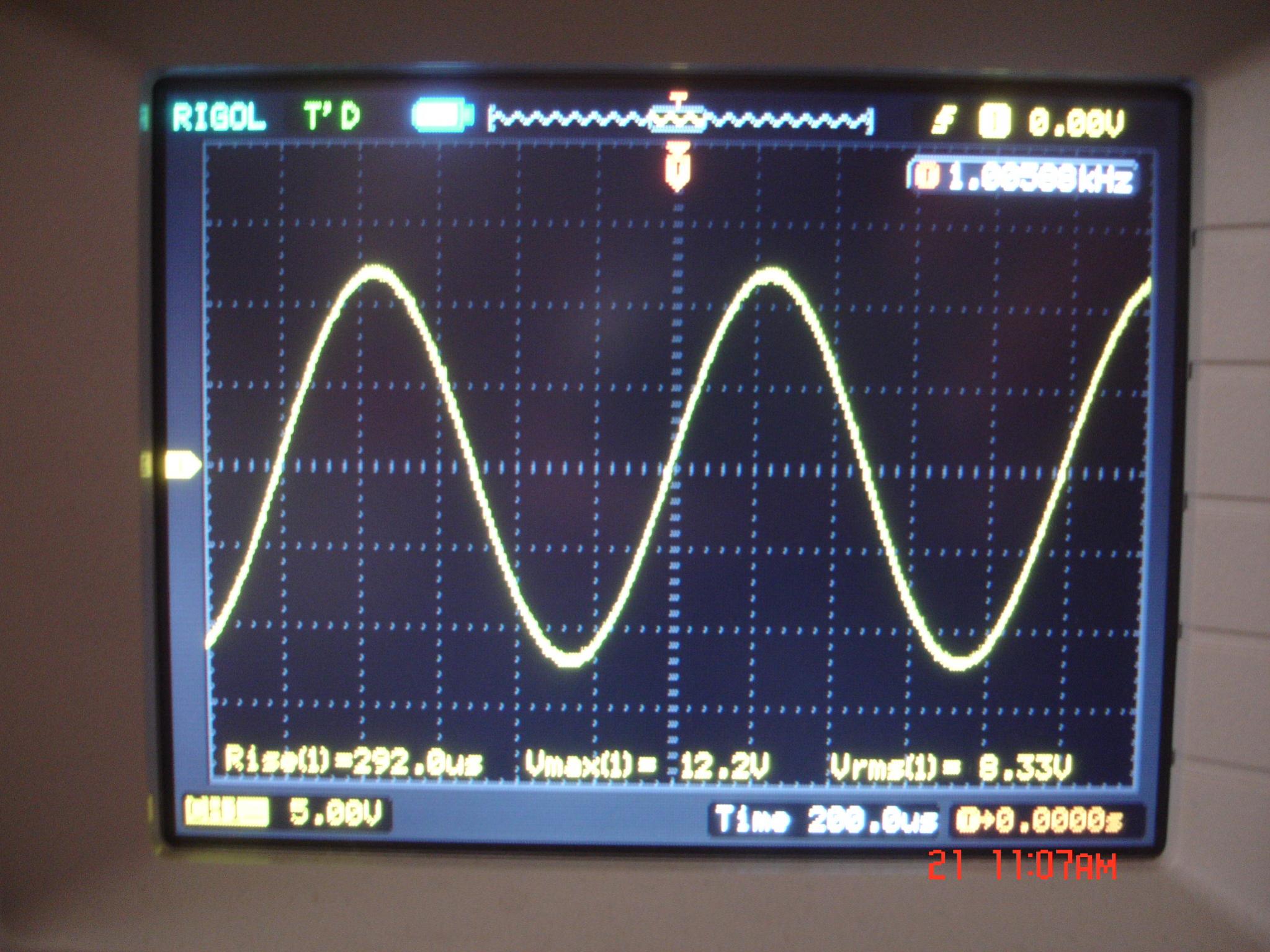

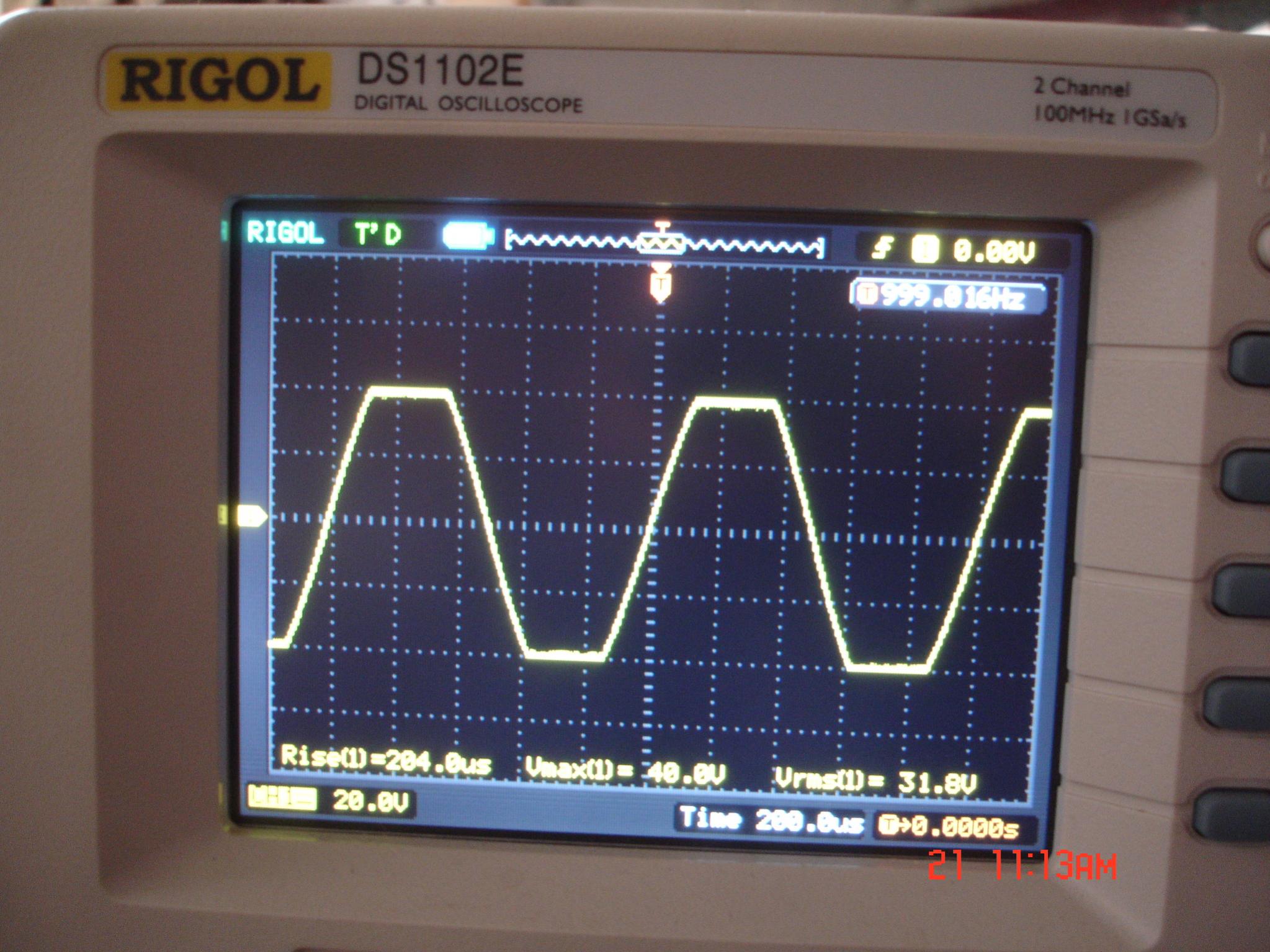

First scope test.
Power Supply+/-50v
Bias 88mA
Offset 0mV.
Picture 3) 1Khz
>> 4) 1Khz clipping
>> 5) 1Khz hard clipping
>> 6) 20Khz clipping
>> 7) 20Khz hard clipping
Amplifier come out of clipping immediately!

Even at 20KHz there's no sign of the rail sticking - mostly because of the very cool VAS configuration. Also, unless you go deep into clipping, the corners are slightly rounded - it clips pretty softly.
Valery yes,i think TubeSumo is one of the best function,even under hard clipping conditions ,IPS.Thimios, Hope all is well.

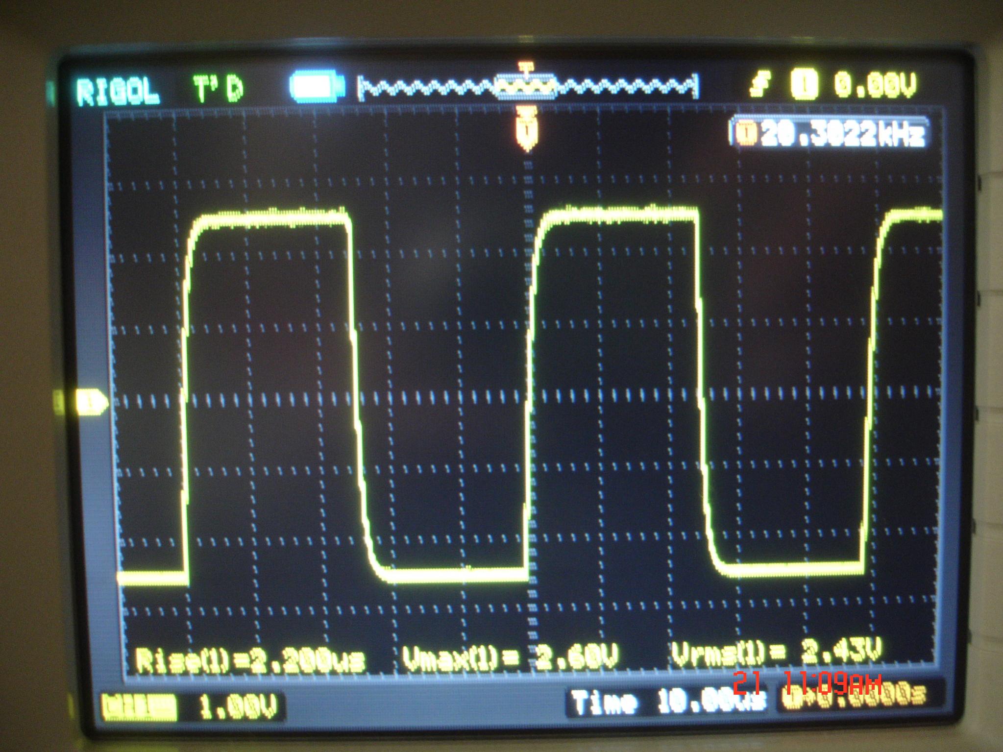

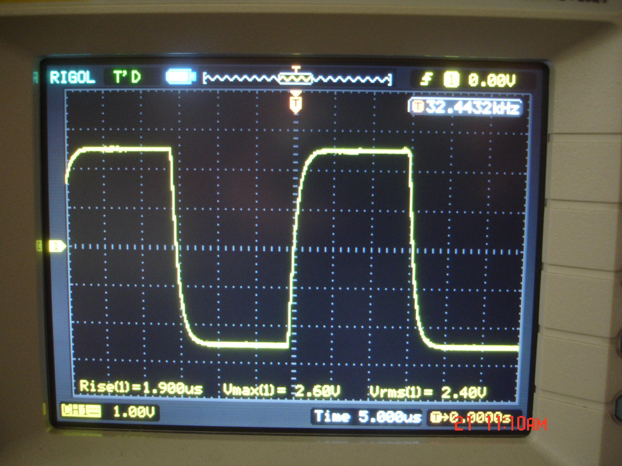

TubSumo

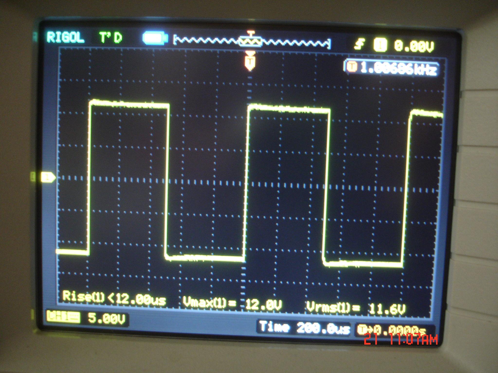

A square wave test.
Looks like a little overcompensated?
A square wave test.

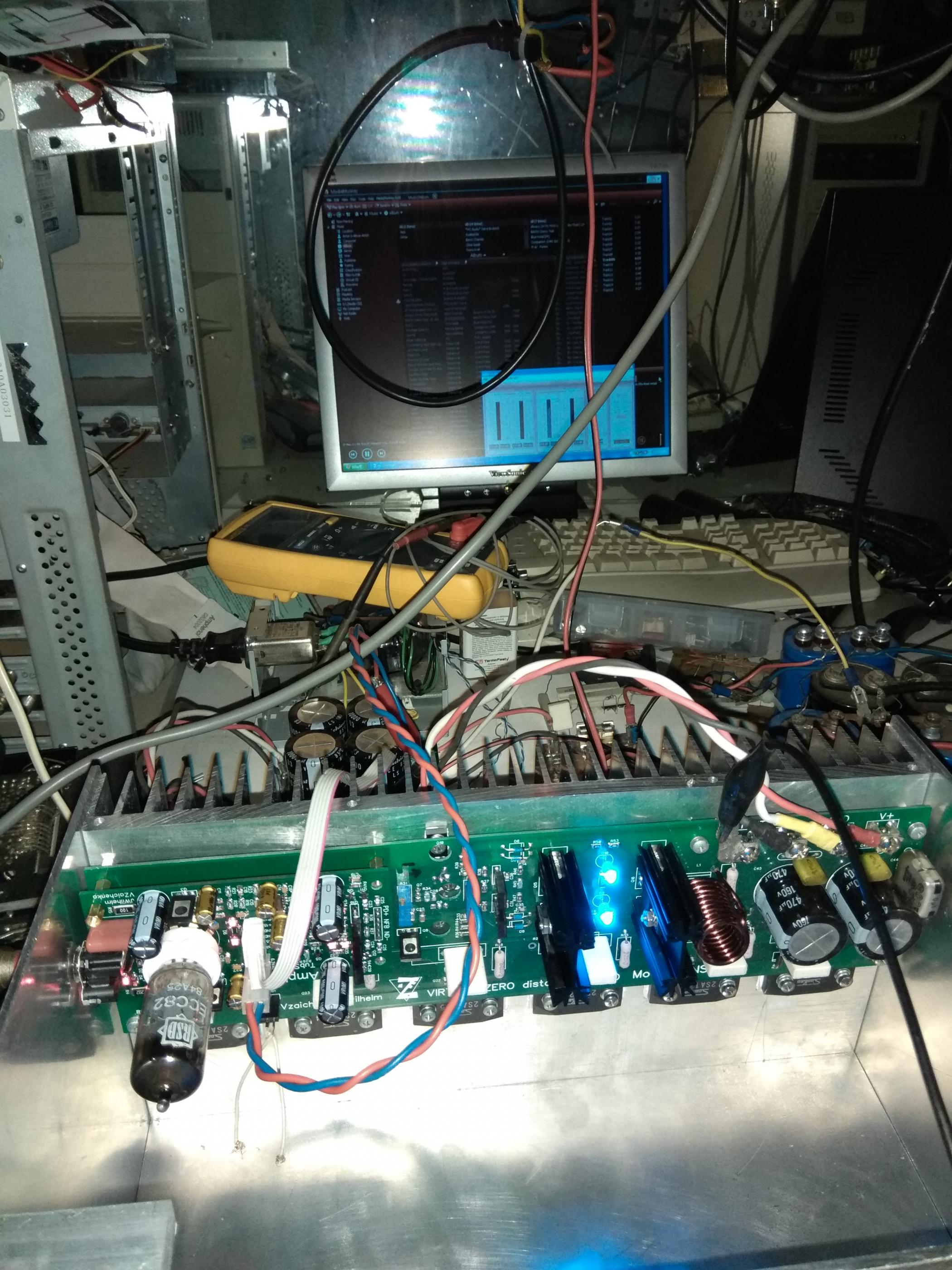

TubSumo

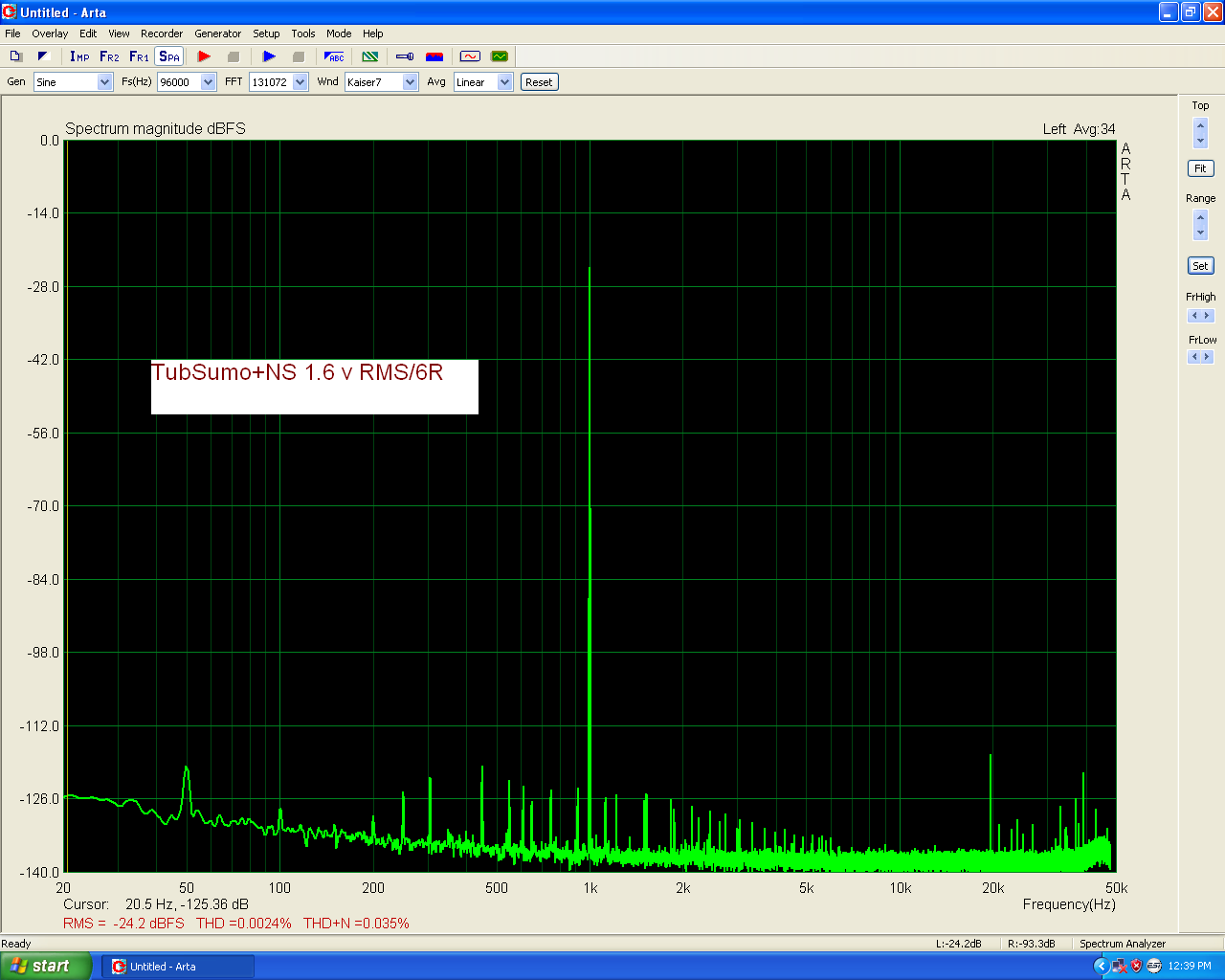

Testing farther.
Power Supply +/-50v
bias current 88mA
Offset 0mV
52.000uf/rail
Filament 6.3v d.c stabilized.
Testing farther.
Power Supply +/-50v
bias current 88mA
Offset 0mV
52.000uf/rail

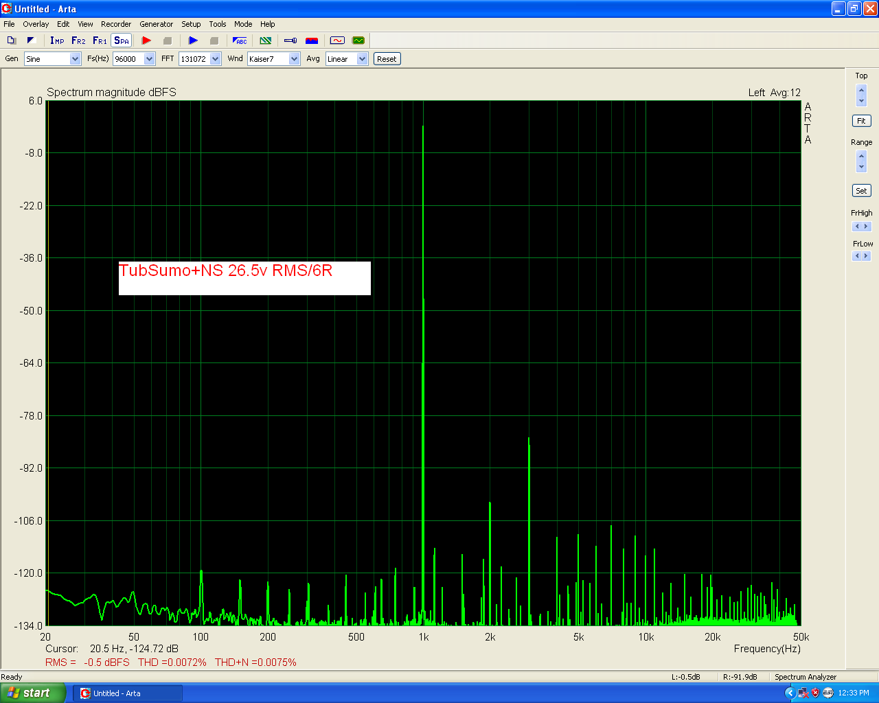

- Revisiting some "old" ideas from 1970's - IPS, OPS
