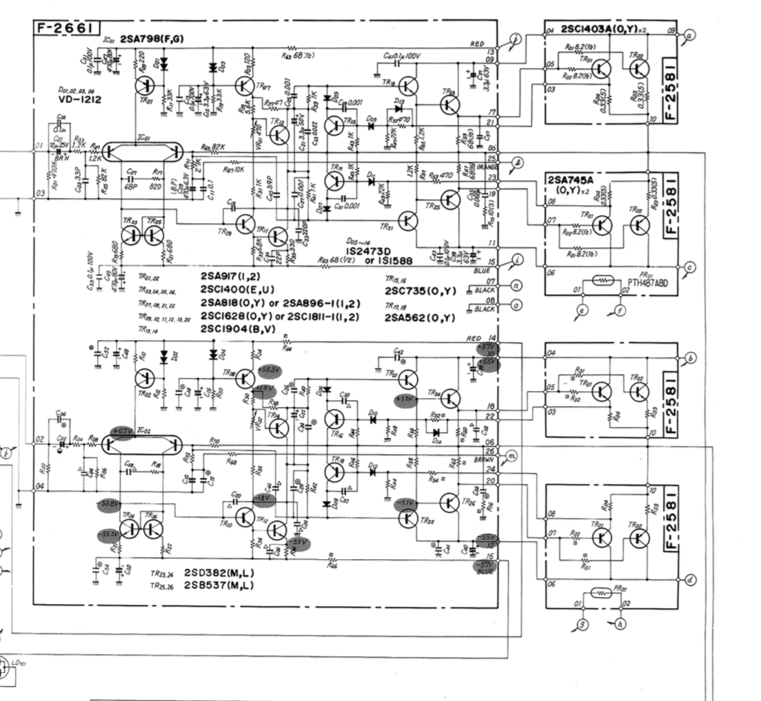

Sorry, the thermistors are part of the original BA-2000 I installed the Tribute boards in. The 2 schematic parts I posted show the thermistor at the output transistors and the part of the protection circuit where they connect. Points e,f,g,h.
Those thermistors belong to the protection circuit (temperature sensors). However, protection controls only the speakers' relay.

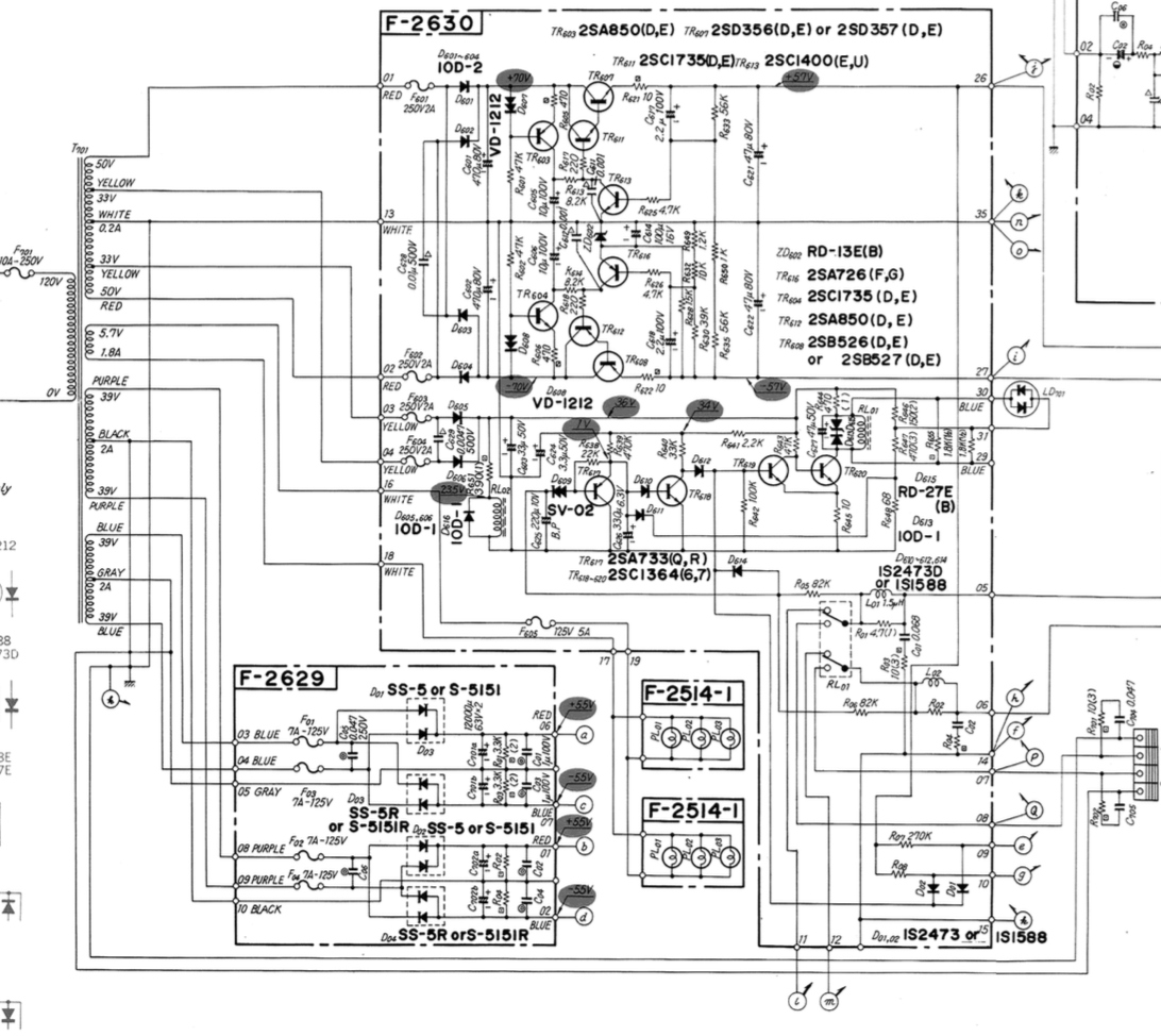

Let's check the PSU first. The original PSU assumes the driver boards are powered by the regulated supplies - points j (+57V) and i (-57V). The output boards are powered by the separate unregulated supplies - points a (+55V) and c (-55V), plus b and c for the other channel.
Is this the way the boards are actually connected now?

Yes that is how the driver and output boards are powered. In my haste I didn't post all the info from that thermistor connections. It looks like the e,g connections from the thermistor connect to terminal 26 (f) which connects to the meter board and is also the PSU connection for the driver boards. Terminal 26 is the connection I used for the Tribute 3000 driver boards + supply.
Terminal 26 is the same connection I used to power the driver board separately and they worked fine. When I make the connections to the OPS something is amiss.

Is there a soft-start circuit used in this amp? What you are describing sounds like a constant resetting soft-start, possibly from a dried out timing capacitor.
Yes, there is a simple analog soft-start circuit, resulting in RL02 relay shorting 2 x paralleled 8.2R resistor in a short period of time after power-on. However, if it resets, the relay would click all the time.
The other idea - maybe the bias trimmer is set to the maximum bias position (minimum R-value)? For the minimum bias, it has to be set to the maximum value position. You can also try to increase the value R26 - some 2.2K value is going to result in zero bias.
Connect the voltmeter between the emitters of Q16 and Q17 (easy to connect the clips to the emitter resistors). What does it show as you power the amp on?
