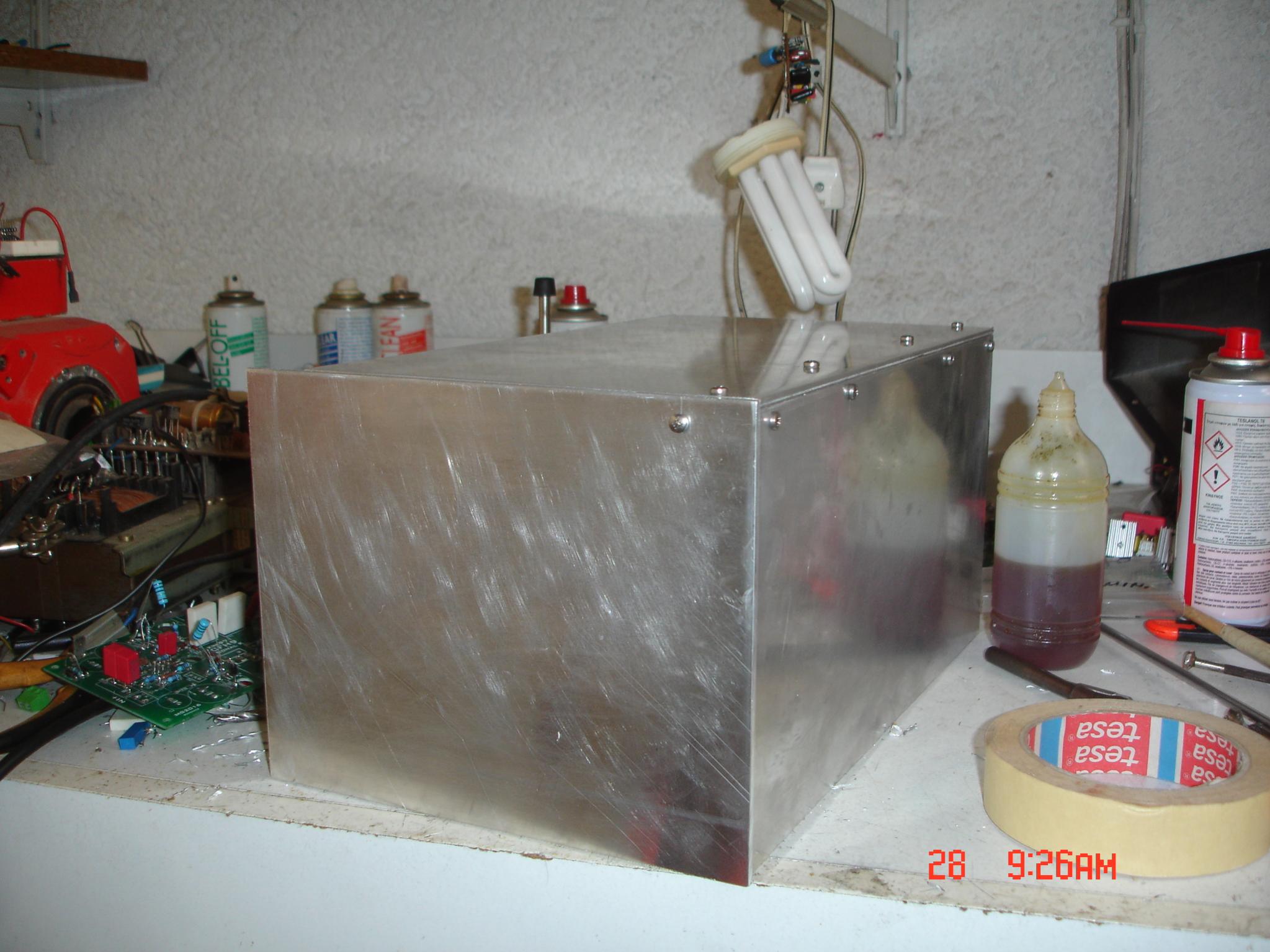

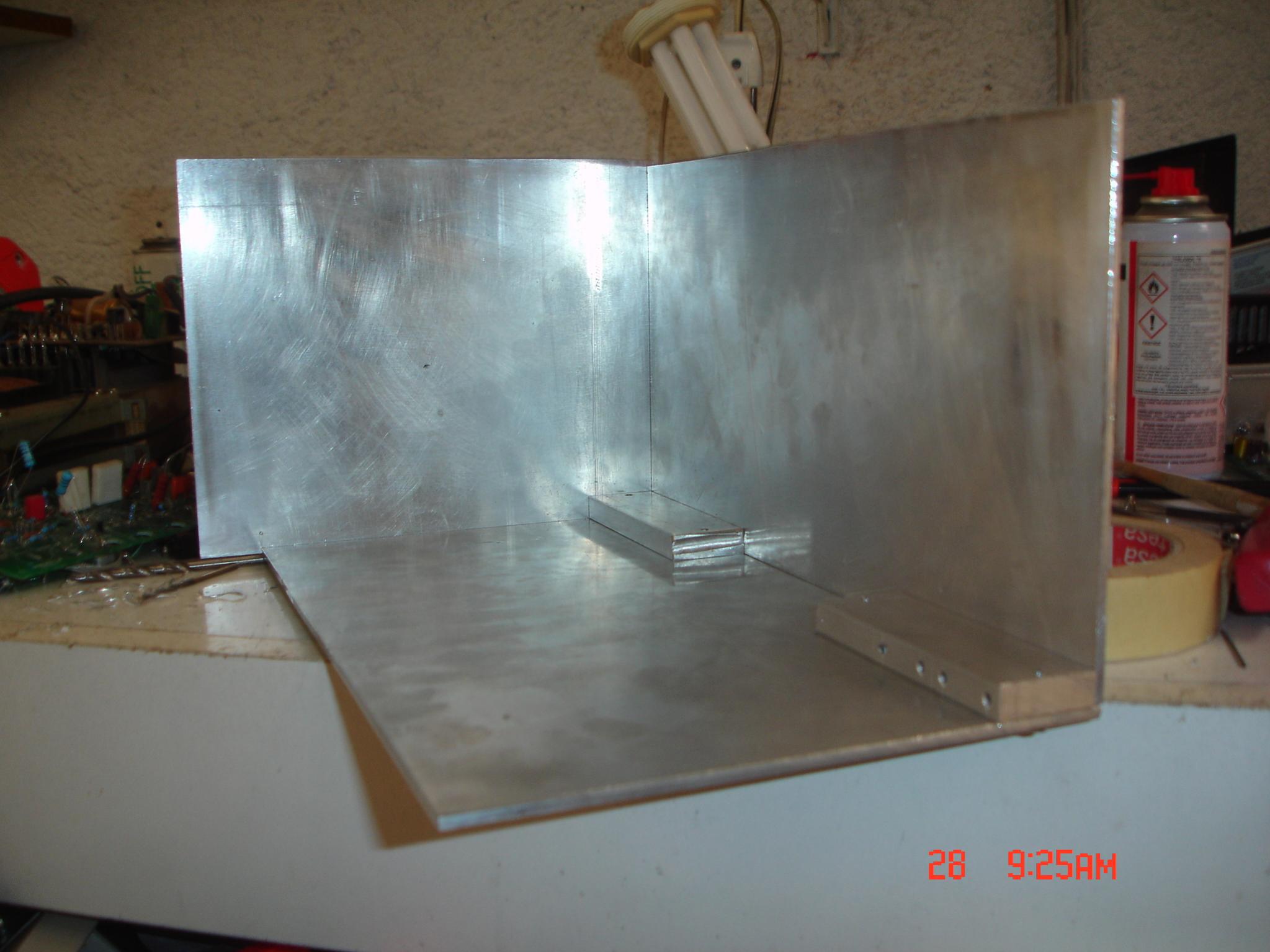

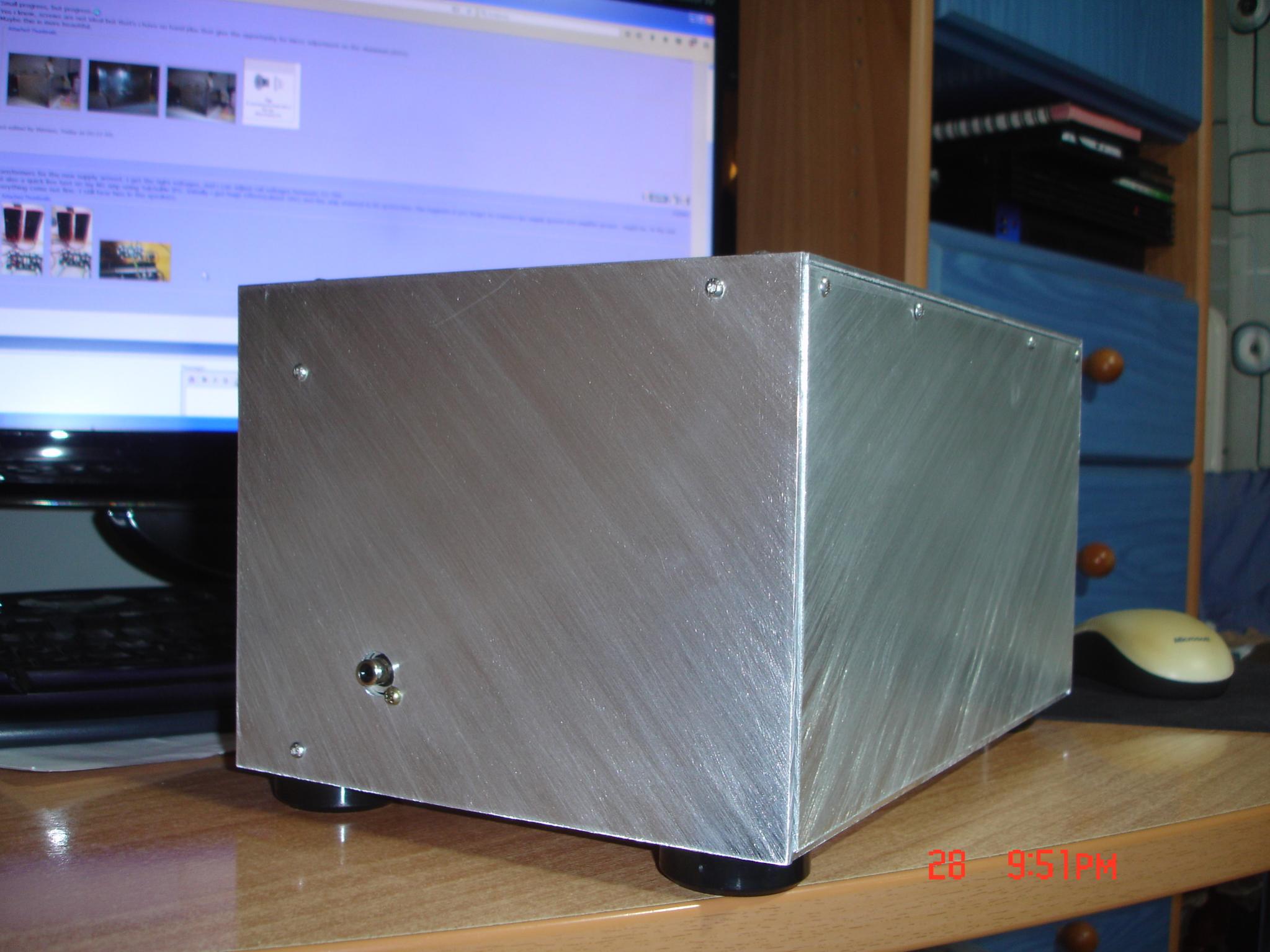

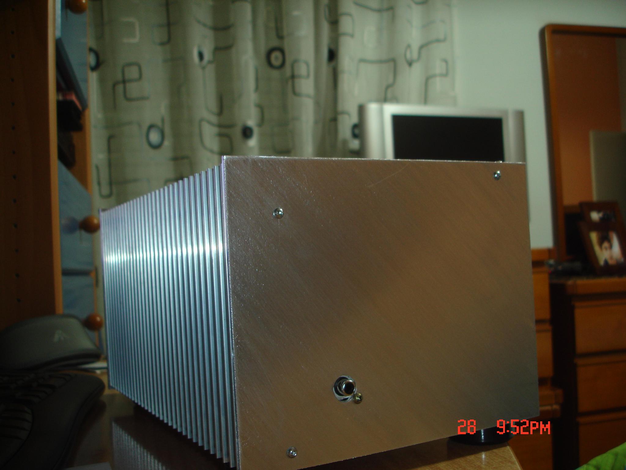

Housing
Small progress, but progress.😉
Yes i know, screws are not ideal but that's i have on hand plus that give the opportunity for micro adjustment on the aluminium plates.
Maybe this is more beautiful.

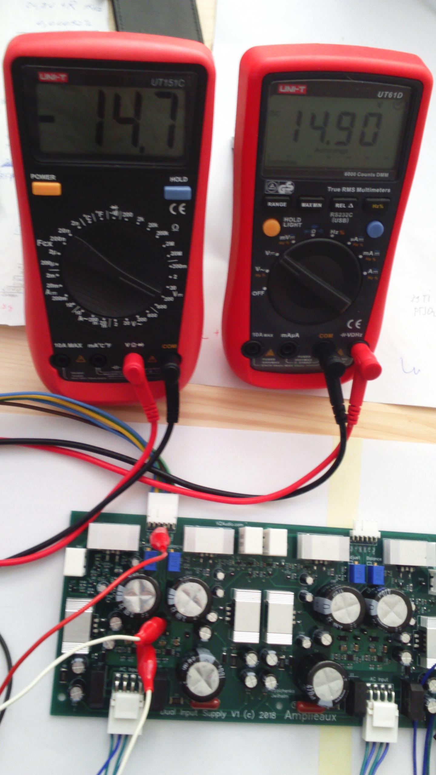

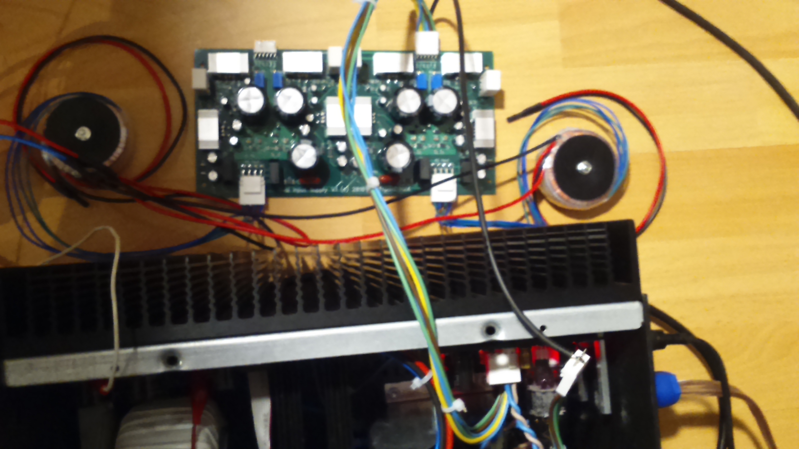

Transformers for the new supply arrived. I get the right voltages, and i can adjust rail voltages between 53-70V.
Did also a quick live test on my NS amp using TubSuMo IPS. Initially i got huge offsets(about 10V) and the amp entered in DC protection, this happens if you forget to connect ips supply ground and amplifier ground - stupid me. In the end everything come out fine. I still hear hiss in the speakers.
We need to figure out where your hiss is coming from. Can you measure AC voltage on the output with the input shorted and a dummy load connected to the output? It would be nice to know what sort of levels we are looking for.
There is nothing to worry, in my opinion. I can hear the hiss only if i put my ear to the tweeter. It is very low level.
In that case you're probably hearing the input transistors.
