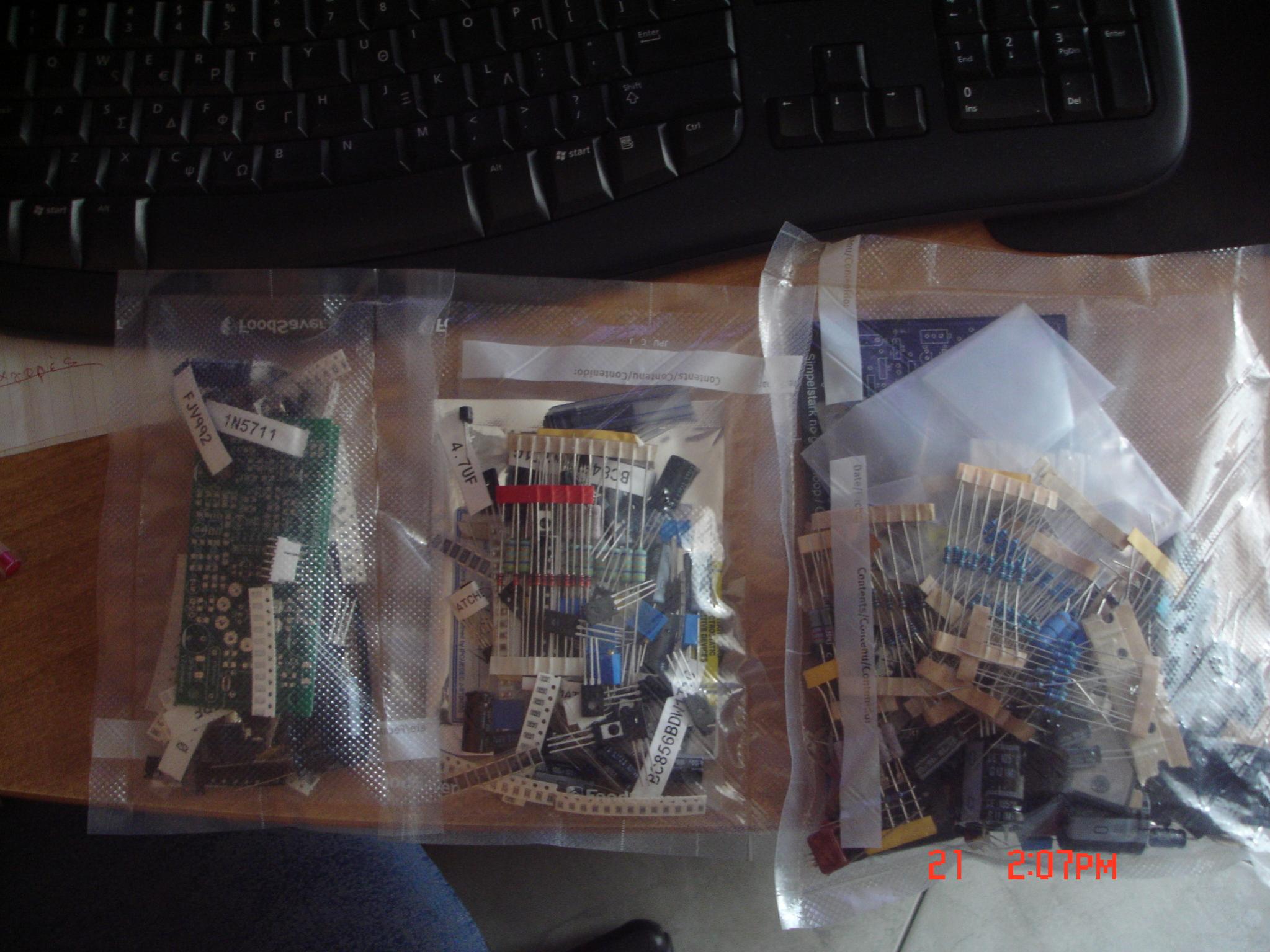

That looks like the parts I sent last week. I thought your missing parts would arrive as soon as I sent another package. Maybe they are gone for ever.
Yes i'm.Lucky you!! 😀

I hope NOT.That looks like the parts I sent last week. I thought your missing parts would arrive as soon as I sent another package. Maybe they are gone for ever.
I received a package in the past, 2 months later after astx sent and after he recent a new one.

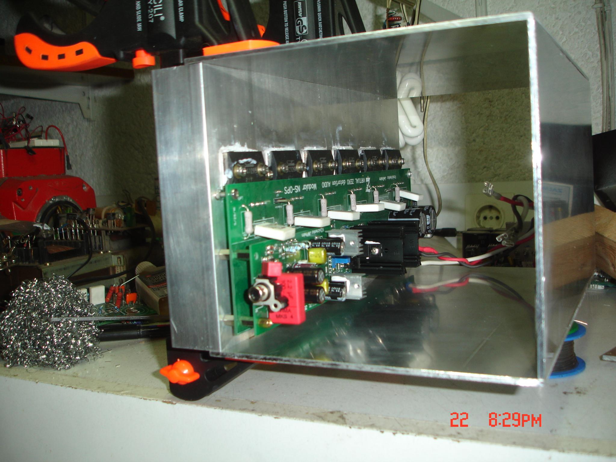

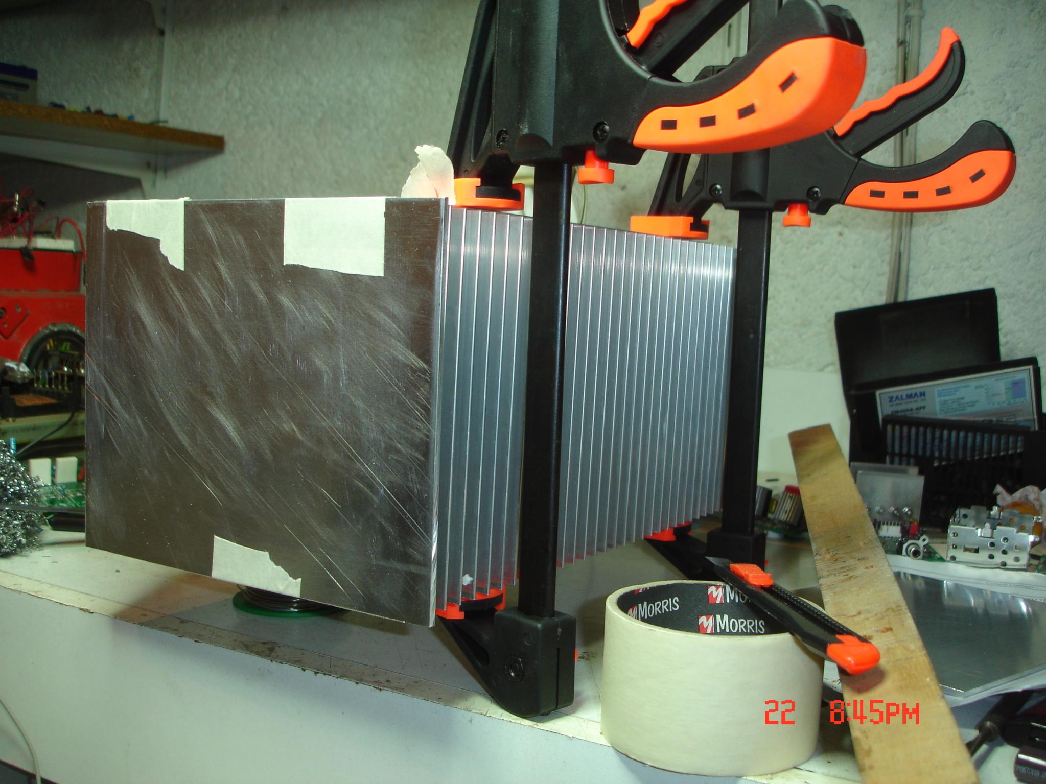

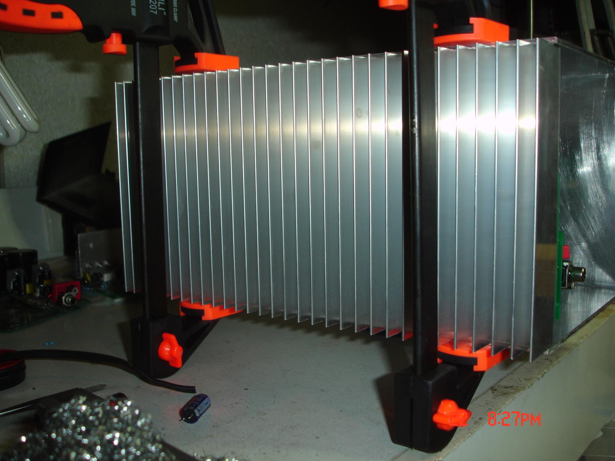

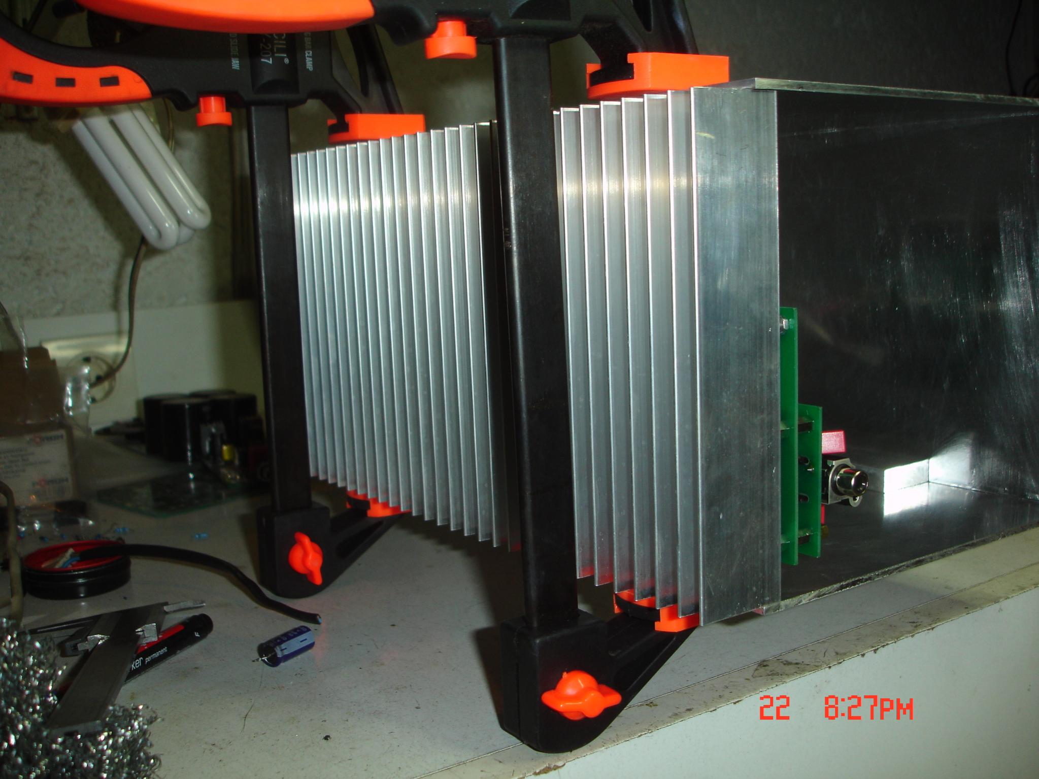

Some progress about housing in full mono configuration.
Also Power supply will be in separate enclosures in full mono configuration.

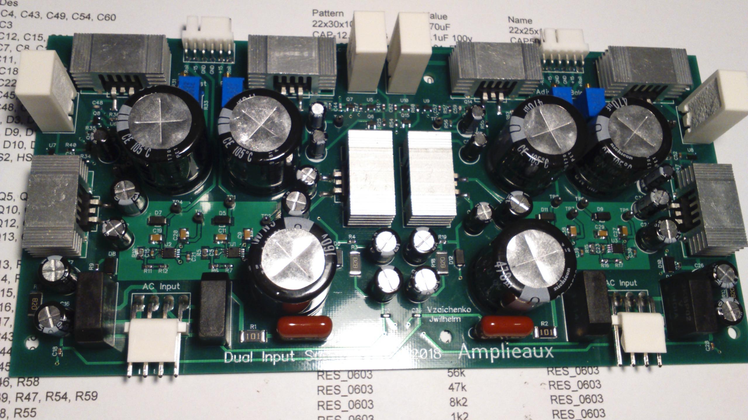

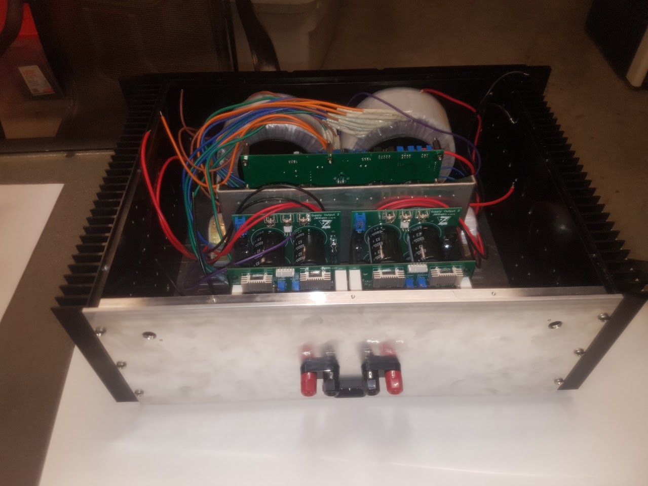

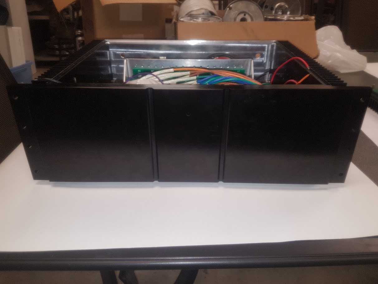

I've finally managed to make some time to assemble an amplifier to properly test some of the latest board designs. This one's almost ready for anodizing and laser work. It's going to be full but it still seems easy to service so far.
Housing time everywhere.😎I've finally managed to make some time to assemble an amplifier to properly test some of the latest board designs. This one's almost ready for anodizing and laser work. It's going to be full but it still seems easy to service so far.
Nice work Jeff!
