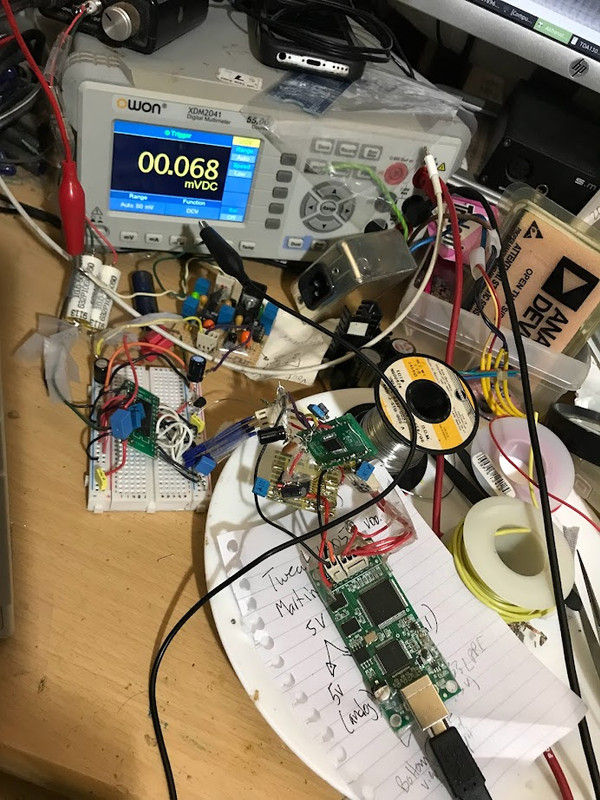

What IO supply voltage do you use for the AD1896? The DAC is only guaranteed to work when the high input level is at least 70 % of its digital supply, 80 % for the clock input.

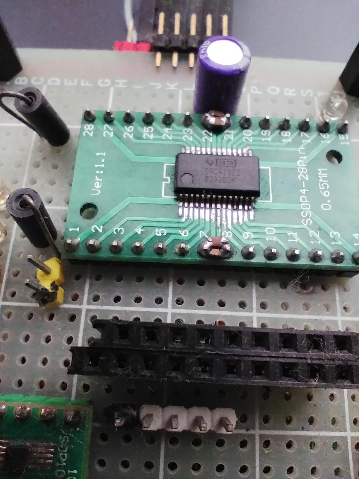

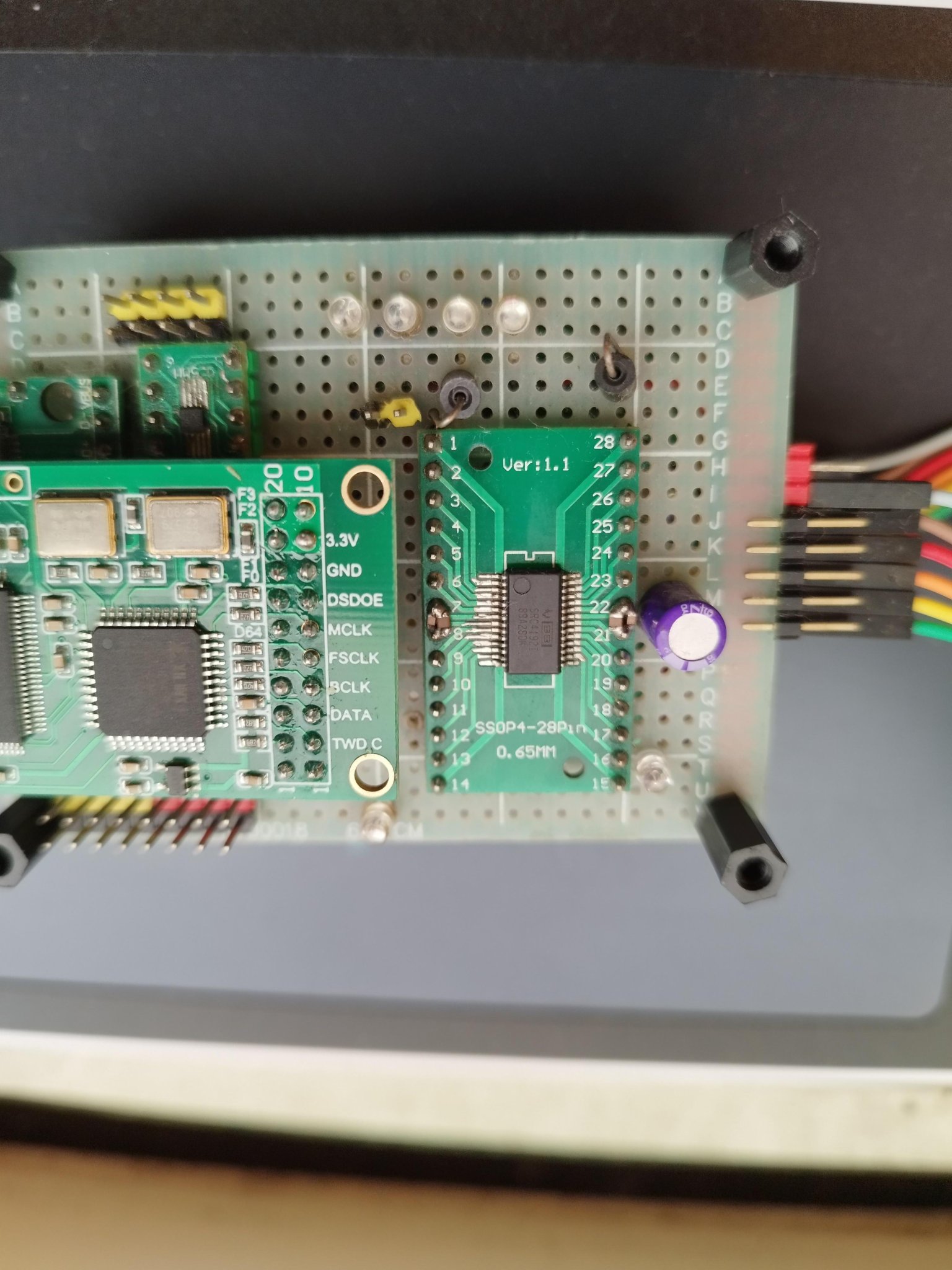

Both the divide-by-two daughterboard (dividing Amanero MCK to 11.289) and the AD1896 (or SRC4192) are supplied 3.3v from the Amanero ( its gpio 3.3v supply lines). This is the easiest way for me to get 3.3v to the AD1896 or SRC4192 need. And then heavily decouple that 3.3v on at various places on the ASRC.
Besides, the long unterminated wires and poor or nonexistent supply decoupling won't help.
Not sure what you mean by "the long unterminated wires" . Yes, the breadboard connections are not tight. And yes: lots of flying wires. But I am using thick solid core, as short as I can possible manage. The messy, 3D "flying object" arrangement is meant to keep leads short.

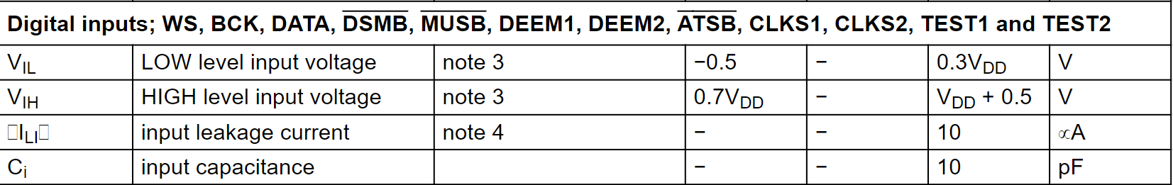

Right!Please check your logic voltage levels - this is what the TDA1305 expects:
Amanero out (no /2) ;SRC 4192 (/2)
BCK: 1.64vdc; 1.43
WS: 1.64vdc; 1.43
DATA: ~0.82 ; ~0.88
MCK: 1.64vdc ; 1.33
All above: with with music playing.
The 1305 DS does note V_DD min = 3.4 v. Testing with digital display variable PSU, there is some wiggling room.
The ASRCs are in no way to exceed 3.6 for VDD_CORE, especially the SRC4192.
But too bad the min. specified for V_DD min = 3.4 v. It does work below that. It's only 0.1v to make it the ultra-common 3.3. I do have some fixed VDO at 3.3v. Including some goodies from Linear.
To what end ? One of the benefits offered by the ASRC is the separation of the clock domains. The output clock can be a new clean clock. Operating both sides with the input master clock means any crud derived from the MCLK on the input side is simply added back on the output side.I'm using Amanero(MCLK) 48k -> src4192(RCKI, pin 2) 192k, 4x upsamping.
Amanero MCLK (48k) might be a typo by iitzex. My Amanero MCLK is 22.xx Mhz.To what end ? One of the benefits offered by the ASRC is the separation of the clock domains. The output clock can be a new clean clock. Operating both sides with the input master clock means any crud derived from the MCLK on the input side is simply added back on the output side.
I've tried to keep the messy ASRC experiment as all-things-kept-equal as possible. The contenders: a now-highly-modded Chinese dual (parallel) TDA1305 kit vs. the ASRC mess you've seen in my photos.
But with even in the mess with the SRC4192, the inferior of the two ASRCs tried thus far, I keep preferring the ASRC mess. Sounds cleaner and more dynamic. Maybe the superior Amanero has something to do with it ???
About the " logic voltage levels" issue ... The 1305 runs just fine even down to 2.7vdc (I am feeding both analog and digital V pins with the same Tekpower supply -- not ideal, but that's just breadboard convenience ). I'd still like 5v (nominal) on all the 1305's +V pins I can get away with. (I assume the logic voltage level limits are for the 1305's V_DDD digital supply voltage only). In other words ... keep V_DDD digital supply voltage (pin 10) at 3.3v; but, supply independent 5.0v to V_DDA analog supply voltage (pin 1) and V_DDO operational amplifier supply voltage (pin 28). Yes?

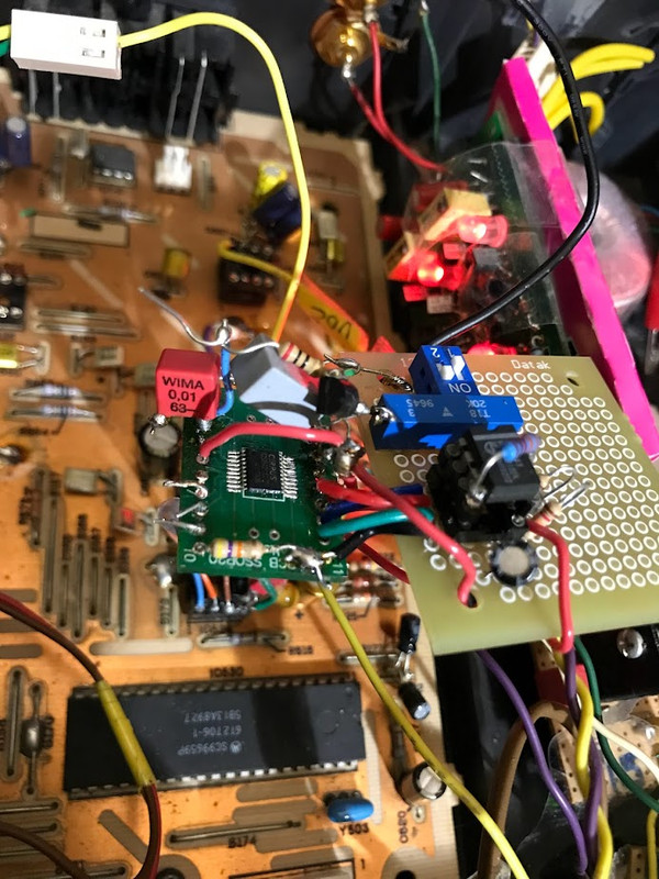

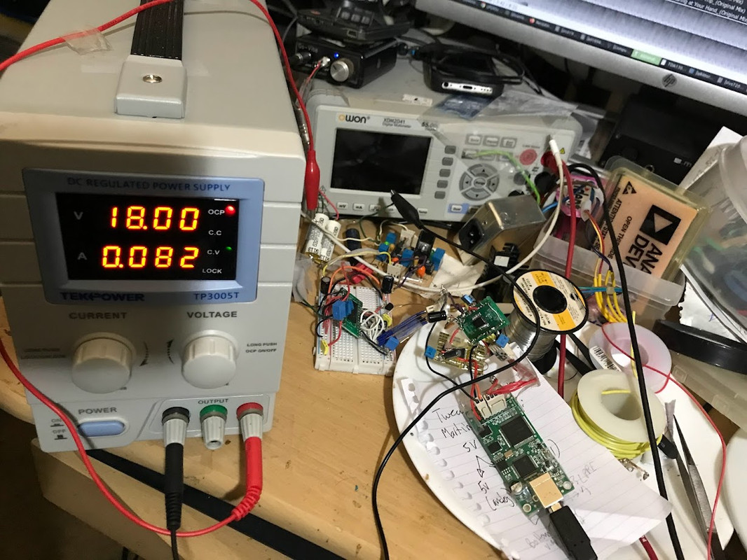

Some major improvements to the messy project ...
TDA1305 now using a highly-regulated (see **) 5.0vdc on its V (analog) and V (internal opamp) pwr pins. Pin 10 (V_DDD) now a uses three-pin LP2950-33LPRE to bring 5.0v to 3.3v (ideal for I2S from incoming 3.3v devices). About that 3.3V for V_DDD. It seems that other DAC datasheets --PCM 1792, 1794, etc -- specifically mention V_DDD being fed 3.3v.
And, yes, the sonic improvements are quite significant.
** There is "new" protoboard in these images ... not so new as I built a few Flea's over 13 yrs ago, including the one in the photos... notice the 18.00V. Martin should recognize that.

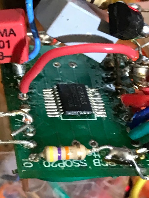

In this thread, I've successfully implemented the AD1896 and SRC4192 asrc's. After quite bit of time tweaking, some very good-sounding success with the last of the ASIC-based ASRCs in my kit. This one, the CS8421, currently feeding a tda1543 from my DREAM Project test-bed experiment. Not using a downstream digital filter. The 8421 is essentially up-sampling at 2x.
Note the long, variable resistor. The 8421's Output Port Configurations are based on weird resistor values. See DS: Table 3. Serial Audio Output Port Start-Up Options (SAOF).

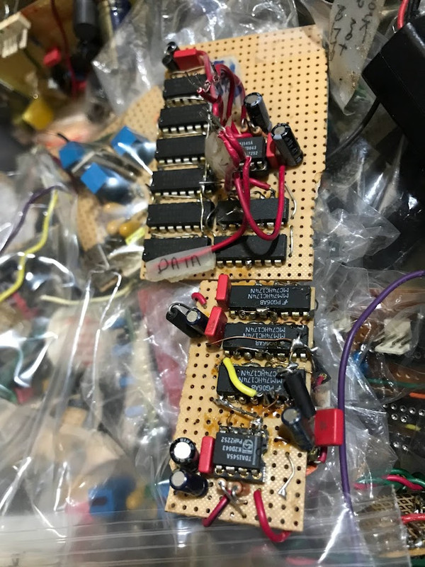

Note the DIP switch. No. 2 is for toggling between I2S and other modes. Working on an I2S to EIAJ solution for "Sony" format DACs using this/any ASRC alone. Format conversion using glue logic is messy!
These I2S to EIAJ converters work but are messy. (These must be a more elegant soln!)

The CS8421 is significantly more sensitive than the other two ASRC's that I noted. For example:the CS8421, currently feeding a tda1543
+2.5-V Digital Supply (VD)
+3.3-V or 5.0-V Digital Interface (VL)
Note the to-92 small lp2950-33lpre3 regulator in the photos. This is a 3.3 v reg. part with a 20R in series to drop the 3.3 to 2.5V. I had no 2.5v reg so I had to improvise with a 3.3v part! Works well, but man is that VD/VL voltage difference critical.
Still trying to get another I2S dac -- tda1387 -- to work. And then the 1545 EIAJ. No luck with either those thus far. But 1543 sounds very, very good with no noise and clean separation. Do have some issues where signal not latching, but restarting the CD player fixes this. Again, the CS8421 is very touchy ... but when it works, it does so well.

Why don't you just use left-justified output format with CS8421?Working on an I2S to EIAJ solution for "Sony" format DACs using this/any ASRC alone. Format conversion using glue logic is messy!
