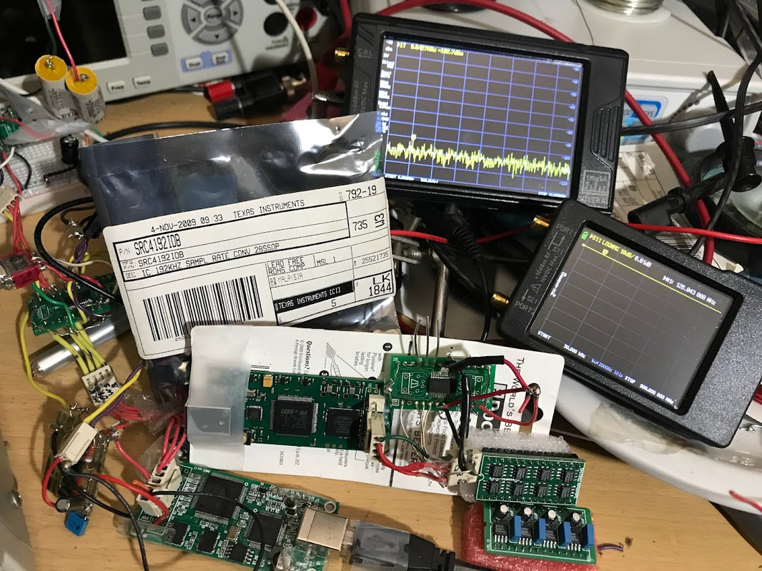

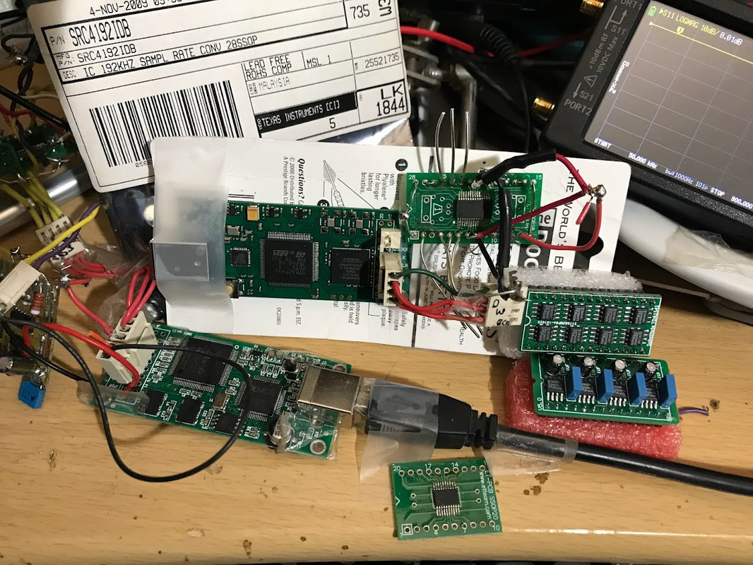

Just acquired another Amanero ... this one is supposed to be the better device, as suggested elsewhen in this forum. (Both shown in photos below)
Recent success with the AD1896 asrc ** is prompting another potential experiment. Up-sampling w/o over-sampling.
[** Highly suggest others repeat that experiment -- easy to to do -- and report back.]
I do have two ASRCs ready to go: CS4121 and AD1896. Also have SRC4192 on hand (but that still needs to soldered onto green proto board).

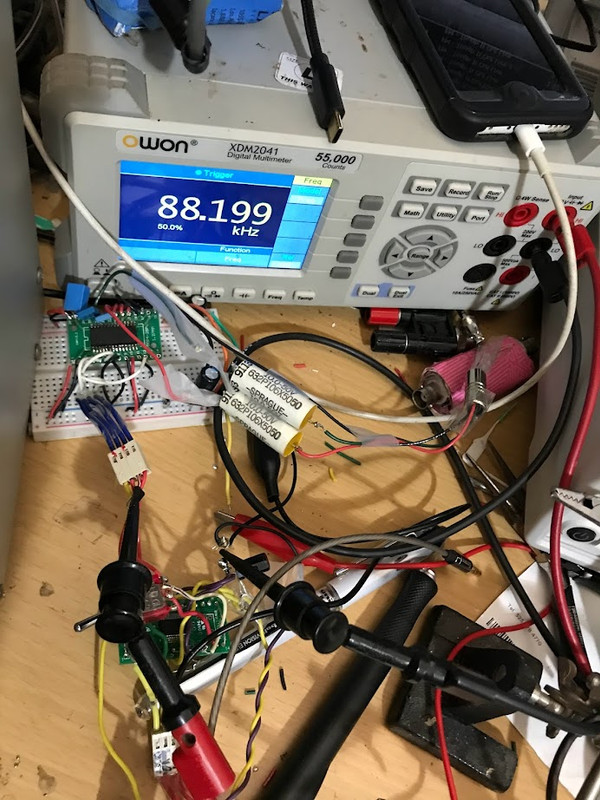

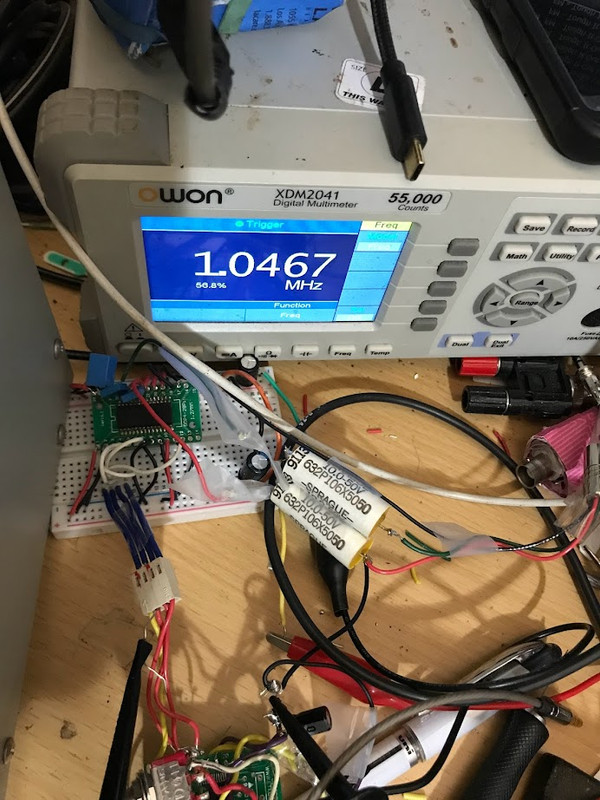

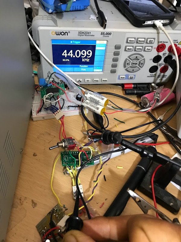

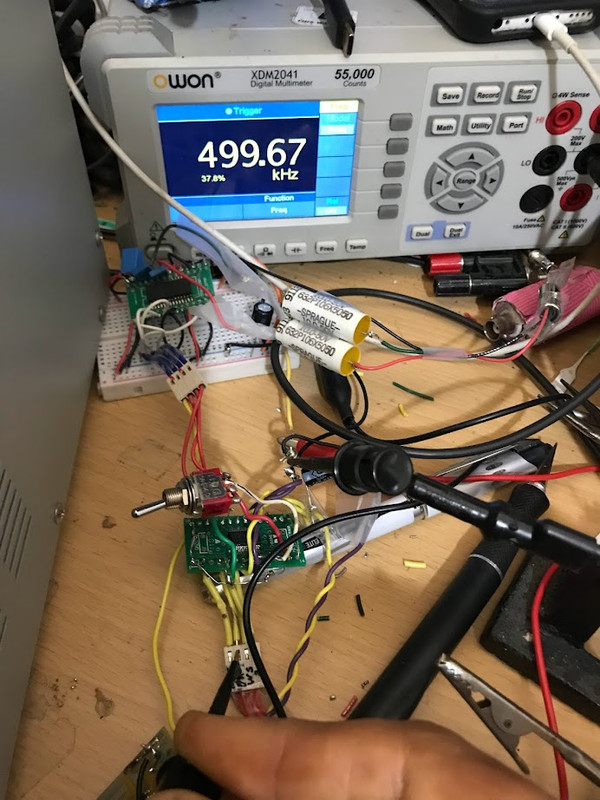

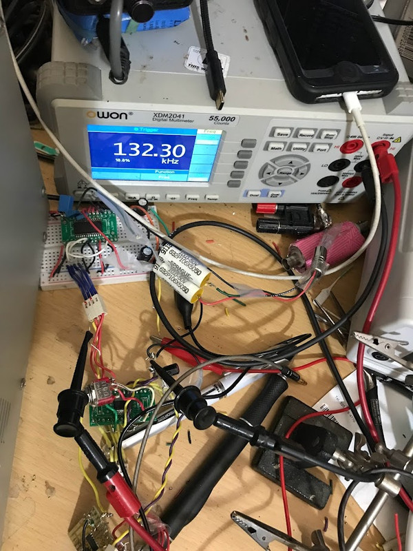

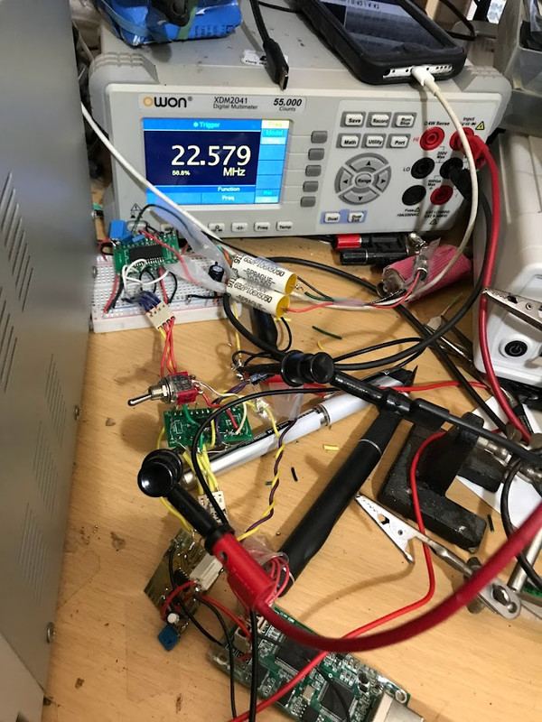

A follow-up on the ASRC ad1896 experiment that should've been continued in this thread, not the RESET (with overbar) thread.
The high-school math exams I grew up with were prefaced by a note in BOLD: Show Your Work.
Hence, for the "exam" experiment, note:
Amanero feeding I2S plus MCK into the AD1896 w/ music [Not shown, no music on DATA. It is 0.0hz]: .
AD1896 feeding the TDA1305 dac w/, and w/o music [note that DATA line playing no music, has "background" 132.xx Khz signal --- dither??? Also note that up-sampling is an integer 2x, which is ideal ].
Further comparing sonics of crude up-sampled bread and protoboard set up against my much-modded Chinese dual (parallel) tda1305 kit, are very positive. But, to be fair, the Chinese kit is battling its internal inferior USB topology, as well as no ASRC.

Do you mean using an ASRC with the exact same input and output sample rates? The only advantage I could think of is that the AD1896 can properly round > 20 bit signals to the 20 bit word length of your DAC.
Not to be "mean" (= facetious), but I don't know what I meanDo you mean using an ASRC with the exact same input and output sample rates? The only advantage I could think of is that the AD1896 can properly round > 20 bit signals to the 20 bit word length of your DAC.
That is, I don't know why the ASRC improves sonics? I definitely heard improvement when I added the AD1896 into the 1305 setup -- compared to no SRC.
Yes, as can be noted in the photos, the AD1896 will 2x "oversample". But it might be interesting to use the ASRC with, say, a TDA1543 or 1545 or 1541.
I suppose I should do some objective tests. But one can only go so far w/o, say, this: https://www.ap.com/analyzers-accessories/apx555/
Yeah, I saw that and the note on pg. 8.According to TDA1305 datasheet tables 3 & 5 all filter characteristics are worse with double speed.
Weirdly, table 5 (double speed) does not provide a "SAMPLE FREQUENCY" column as Table 3 does.
I suppose it's not surprising that the faster the internal circuits are asked to perform (2x vs 1x), the more demands there will be on power supply and regulation. So more hash in line. Delta-sigmas run so fast that they have to noise-shape their way out of that mess. The 1305 does do a little noise-shaping per its "hybrid" design.
