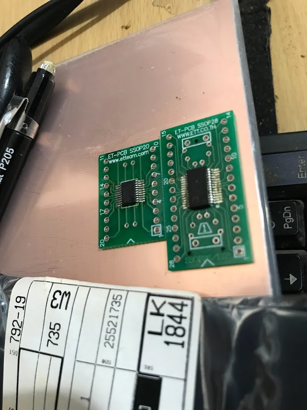

My parts bin has quite a few of them, many models and manufs, collected over 15 yrs ago, never used, but ready-to-go on micro PCBs. So I might experiment -- see what the old craze was about.

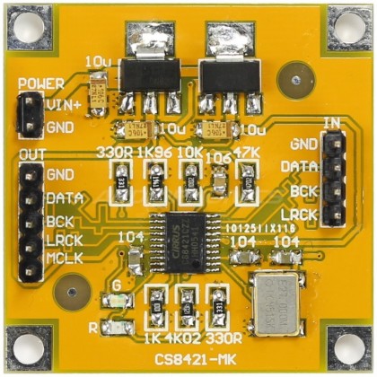

Did find this French PCB module based on that 20-pin CS8421 device:
https://www.audiophonics.fr/en/inte...verter-module-cs8421-32bit192khz-p-11456.html

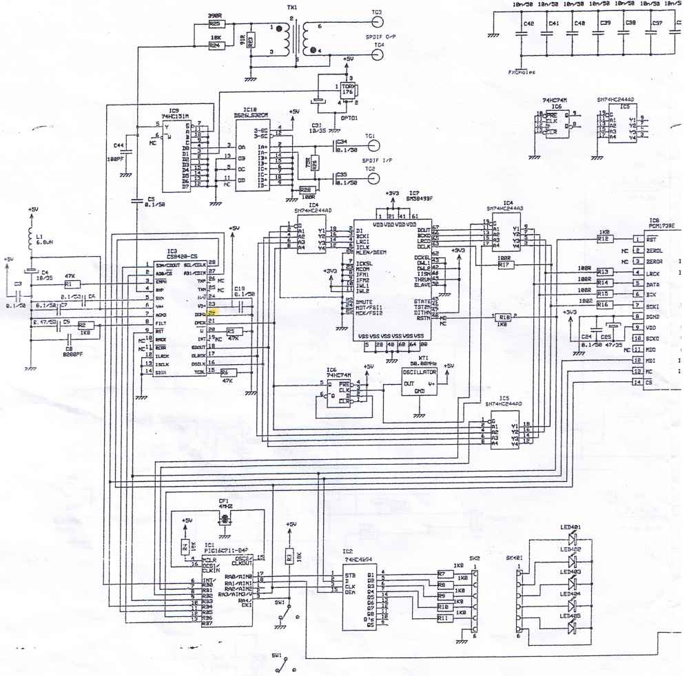

One of the strangest uses of upsampling was in certain Musical Fidelity DACs. They offered selectable 96k and 192k via a rear button. Looking at the schematics of the MF, there seems to have been two SRCs used (????). CS8420 followed by a NPC SM5849AF, and then a PCM1738 dac. I'm guessing both ASRCs were necessary to achieve 192k.

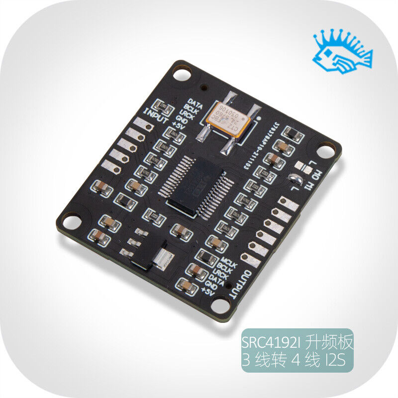

My main question is about what to feed the "clock" input (not BCK) of an ASRC chip.
If you look at these two boards, you'll also note they have an osc.
I am assuming that if I'm coming off an Amanero or other USB-I2S adapters, I just use the MCK? Correct?
The Musical Fidelity DAC seems to be distributing the same osc to both ASRCs and the PCM1738. I am assuming this is the MCK or Reference Clock.
You could use the Amanero clock if it complies with the requirements in the datasheet. If both the input and output sample rates have a fixed relation to that clock, you are effectively using the asynchronous sample rate converter as a synchronous sample rate converter, but there is nothing wrong with that.
