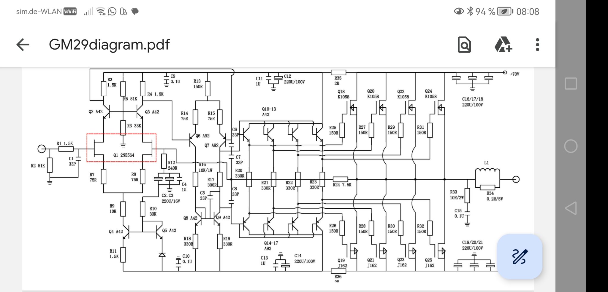

The MPSA42 and MPSA92 are not suitable for two pairs of MOSFETs and a 100mA quiescent current each. The transistors will overheat if the rail voltage and quiescent current are not drastically reduced. There are other Goldmund-based circuits, such as the GM 29 or Telos 300. These use one MPSA per MOSFET.
