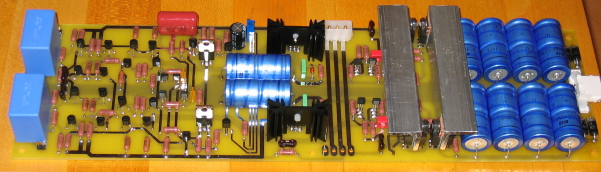

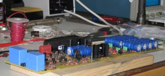

Project is coming along nicely. I repaired the original equipment, and it works great. I'm almost finished with my first board, and the second one has a few parts on it as well.

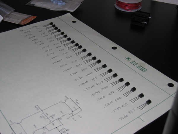

Viva la resistance. It'd done, and it works great. The only hacks I made were where I used a TO-92 (actually E-line) MOSFET where I had put a TO-220 footprint, and I accidentally specified 100V Schottky rectifiers where I really meant to use 200V. In the end I used a 1000V 1N5408G.
Note that my board has substantially better heatsinking than Krell's. The original KMA-160 must have had a reputation for blowing up the drivers. On the board I fixed, the strip of metal that passes for a heatsink runs in excess of 85C.

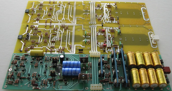

Stick a fork in it, it's done. Kinda hard to see my boards when they are installed, but here's the photos anyway. I couldn't get the older Neutrik connector, so I had to stick the new model in sideways. Alas.
