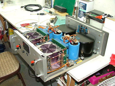

Additional Krell schematics and photos
I have posted a new thread on some of the older Krell designs including the KSA-50 and KSA-100. There are schematics and photos. Here is the link to the page:
http://home.ca.inter.net/~lloyd.maclean/Krell/Krell.htm
here is one of the photos:
