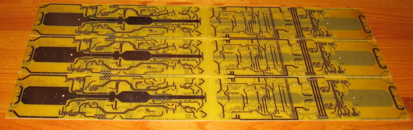

I posted a new layout. I moved the screened names so they aren't under other parts, and I have changed the 20mA current sources for 2mA cascoded current sources that run within their SOA.
634KiB PDF download
634KiB PDF download

I finally found the perfect FET to replace those Supertex FETs: Zetex ZVP3310 and ZVN3310. I don't know why I didn't think of it before, they're very common, but I think I had the TO-220 stuck in my mind. There's no reason for that, since these components dissipate < 200mW in this circuit.
What do I need to view these drawings?jwb said:Manufacturing data for KMA-160 audio board, as modified and drawn by myself.
