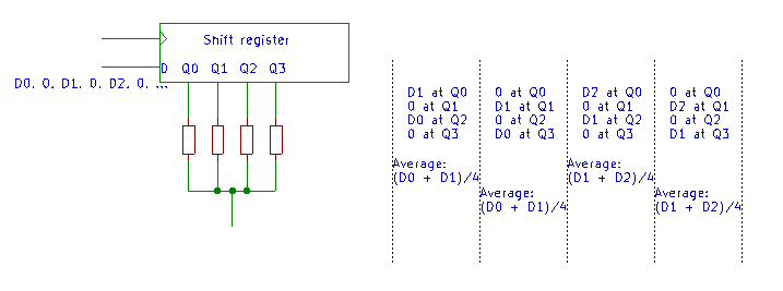

For reasons of sensitivity to jitter (jitter related to far-off phase noise, to be precise), I like to turn on the odd taps with the same clock edge that forces the even taps to zero and the other way around. Increasing the duty cycle of the even taps then reduces the duty cycle of the odd taps, so it doesn't help. I will have to draw a timing diagram to show you what I mean.
The problem with frequency doublers is related to subharmonics of the sigma-delta modulator's clock frequency. Some of Andreas' oscillators worked at the second subharmonic and used a doubler to make the full clock frequency, with some second subharmonic leaking through. The second subharmonic is exactly where a single-bit sigma-delta modulator is most sensitive to interference. The doubler I use only produces harmonics of the sigma-delta clock frequency, no subharmonics.
This is an oversimplified schematic of the DAC, drawn single-ended and unloaded for simplicity. When you look at the transitions at the output, you will see some switching spike and a transition to the next value. In half the cases, the next value is (except for resistance tolerances, including shift register output resistance differences) the same as the previous value: from (D0 + D1)/4 to (D0 + D1)/4 or from (D1 + D2)/4 to (D1 + D2)/4. In the other half of the cases, only one of the averaged data bits is replaced with a new one: (D0 + D1)/4 to (D1 + D2)/4.
When the clock transition is not exactly at the right moment, shifting the transition from (D0 + D1)/4 to (D0 + D1)/4, the switching spike will shift, but otherwise almost nothing changes. In particular, the average value over the two clock cycles stays the same except for some small effect of resistance tolerances. If the odd and even taps were clocked by different clocks, shifting an edge of one of them would immediately affect the average voltage, that is, the low-frequency content. Hence my preference for using the same clock.
When the next clock transition is not exactly at the right moment, shifting the transition from (D0 + D1)/4 to (D1 + D2)/4, the low-frequency content will be affected whenever D0 and D2 have different values. If I had used a long shift register, I could claim that as only one bit changes, the average is always affected far less than with separate clocks for the odd and even taps. For example, with 16 taps, it would be a transition from (D0 + D1 + D2 + D3 + D4 + D5 + D6 + D7)/16 to (D1 + D2 + D3 + D4 + D5 + D6 + D7 + D8)/16.
Still, even this short shift register is quite useful because it suppresses quantization noise around half the sigma-delta clock rate (equivalent to four shift register clock cycles, as the shift register runs at twice the sigma-delta clock rate). Single-bit sigma-delta modulators typically produce lots of noise and tones near half the sigma-delta clock rate, which implies that the chance of D0 and D2 having the same value is substantially higher than in a pure random bitstream.

No shortcomings that I know of, except of course that the circuit adds to the phase noise floor, as does anything you put in the clock path. The RC network R134-C86 affects the jitter at the falling edges at the EXOR output (U28A), so the shift registers are clocked by the rising edges.

Interesting that your third harmonic level is much lower than my -95 to -90 dB. The even harmonics should largely cancel when you make a balanced version.
Regarding the taps, the FIRDAC also filters the desired signal. With an unweighted averaging over a time n T, where n is the number of taps and T the delay from tap to tap (usually a sample period or half a sample period), you get a sin(pi f n T)/(pi f n T) response. There are deep notches at f = 1/(n T) and its nonzero multiples, and the response is already down to 2/pi or about -3.92 dB at f = 1/(2 n T). So the treble loss you are willing to accept, the sample rate and whether the delay from tap to tap is 1 or 1/2 sample time determine how long you can make a uniformly weighted FIRDAC.
