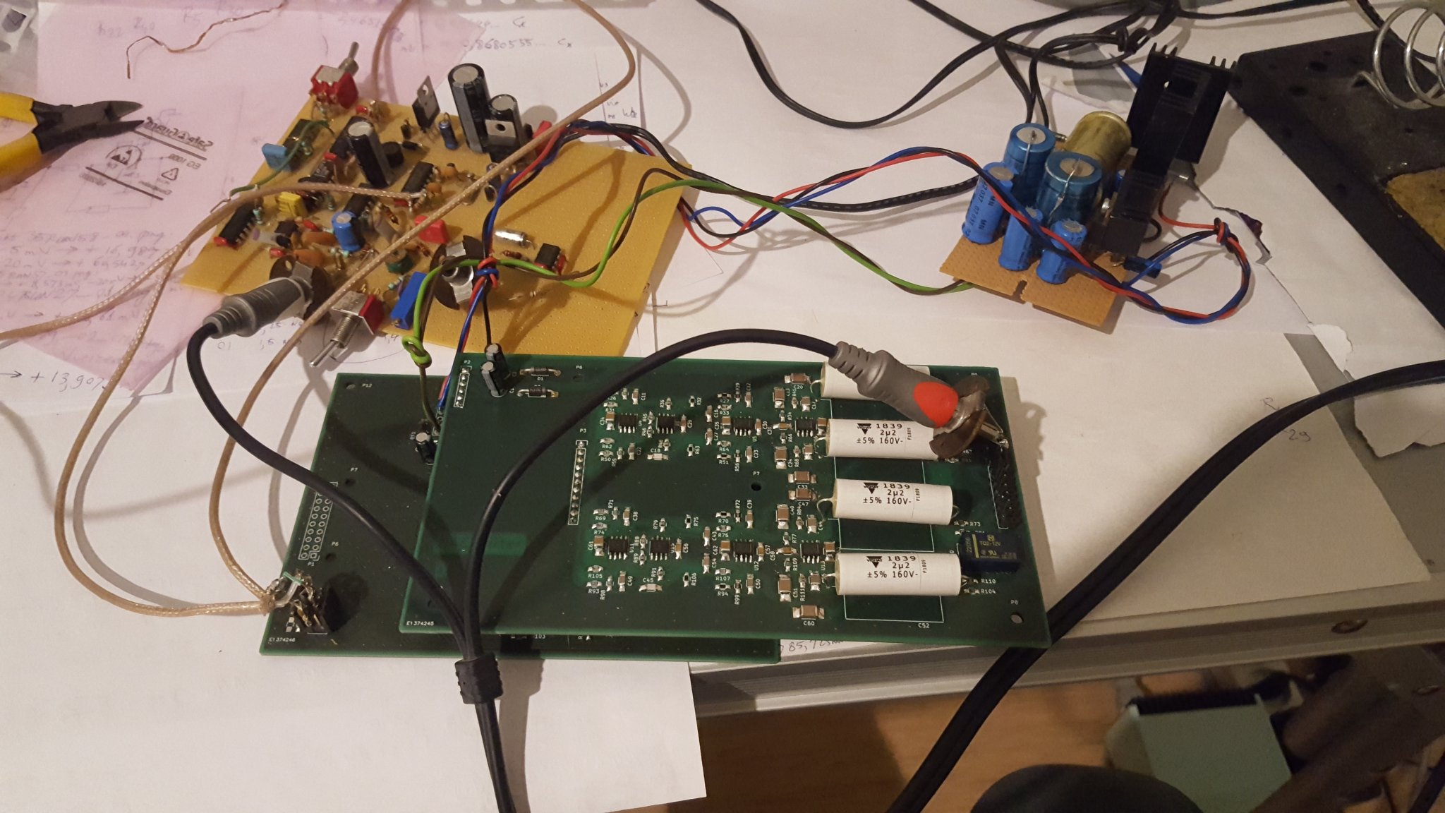

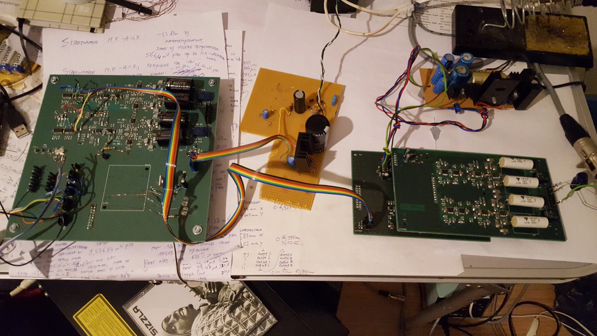

I hooked up the digital part of my earlier logic gate DAC to the shift register DAC to see if it works at 27 Mbit/s and if it has a lower noise floor.
The good news is that it works, the bad news that the A-weighted noise floor is 10 dB worse: -87 dB(A) with respect to the maximum sine wave level instead of -97 dB(A).
I wanted to check if splitting the flatcable to separate the clock part from the data part would reduce data-to-clock crosstalk and lower the noise floor. It had practically no effect, but by chance I found out that moving the whole cable could substantially reduce the noise, to about -98.7 dB(A). I haven't a clue why yet. To be continued...
I've had several bad experiences with those ribbon cables Marcel, both with the crimped connectors and poor continuity in the the cables - I now make up my own cables with good quality wire and I solder the connectors - I put a little solder paste into the connector before crimping them and then hold an iron on them.
That could very well be the case. If it were an ideal transmission line, its length wouldn't matter as long as at least one side were perfectly terminated, but in reality neither the cable nor the termination is ideal. The power supply of the left PCB is completely separate from the supply of the right two PCBs. The grounds are connected via four of the seven flatcable wires.
I made the data cable much shorter, replaced the clock cable with a short, thin 75 ohm coax cable (RG-179) soldered on both sides, and tapped off the clock a bit earlier in the clock chain of the PCB that generates the clock and data signals. The noise floor now dropped to around -107 dB(A).
I need to measure it more accurately, because there is too little difference between the noise with the DAC off and with the DAC on. I subtract the noise power measured with the DAC off from the measured noise power when playing silence, but as there is only a 0.59 dB level difference, the result gets very sensitive to measuring inaccuracies.
