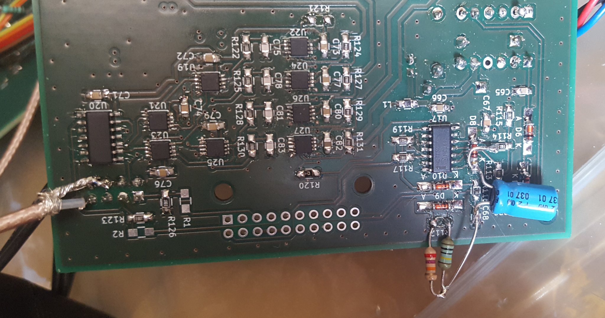

I've debugged the mute function tonight. I had forgotten to include an extra long delay for the filter behind the bandgap to settle, it is fixed in the attached schematic. I've also changed R120 to mounted and R121 to not mounted, so the output gets muted faster when the MUTE input goes high. The clock now has a coaxial connector. Based on what I've measured so far, giving the clock its own connector is a better idea than sharing a header with the data signals. There is no up-to-date PCB design yet, I made these changes on my PCB by three-dimensional soldering.
What exactly is three dimensional soldering? Sounds like a form of art... 🙂There is no up-to-date PCB design yet, I made these changes on my PCB by three-dimensional soldering.
I've measured a couple of square wave responses to check feedback loop stability, found no issues except the usual problems with oscilloscope ground leads, and updated the PCB design. I've also put in U.FL connectors for the data, if you need them on a header, you can mount R1 and R2. See the attachments, which are meant for 360 um thick prepreg, a few traces have to be made narrower for thinner prepreg.
Mind you, due to the 13 mm height of C4, C6 and C9, normal headers are just too short to connect the filter PCB to the DAC PCB (with the filter above the DAC). It just makes contact when you mount them a bit higher than intended. I hope connectors such as the Samtec DW-06-11-F-S-630 and DW-11-11-G-S-665, both available at Mouser, work better.

I think I fixed the bugs and I hope I haven't introduced any new ones, so I think you have a good chance of getting a usable DSD DAC when you build the latest version. By design, the part of the mute circuit that monitors the supply only monitors the +15 V, so the other supplies should not lag too far behind the +15 V at start up, and not disappear before the +15 V at power down.
Except for the noise floor and the noise of the voltage reference, nothing is known about the performance yet. I will do some more performance measurements on my PCBs to see how well they work. I can then also check the supply currents, I only have estimates now.
