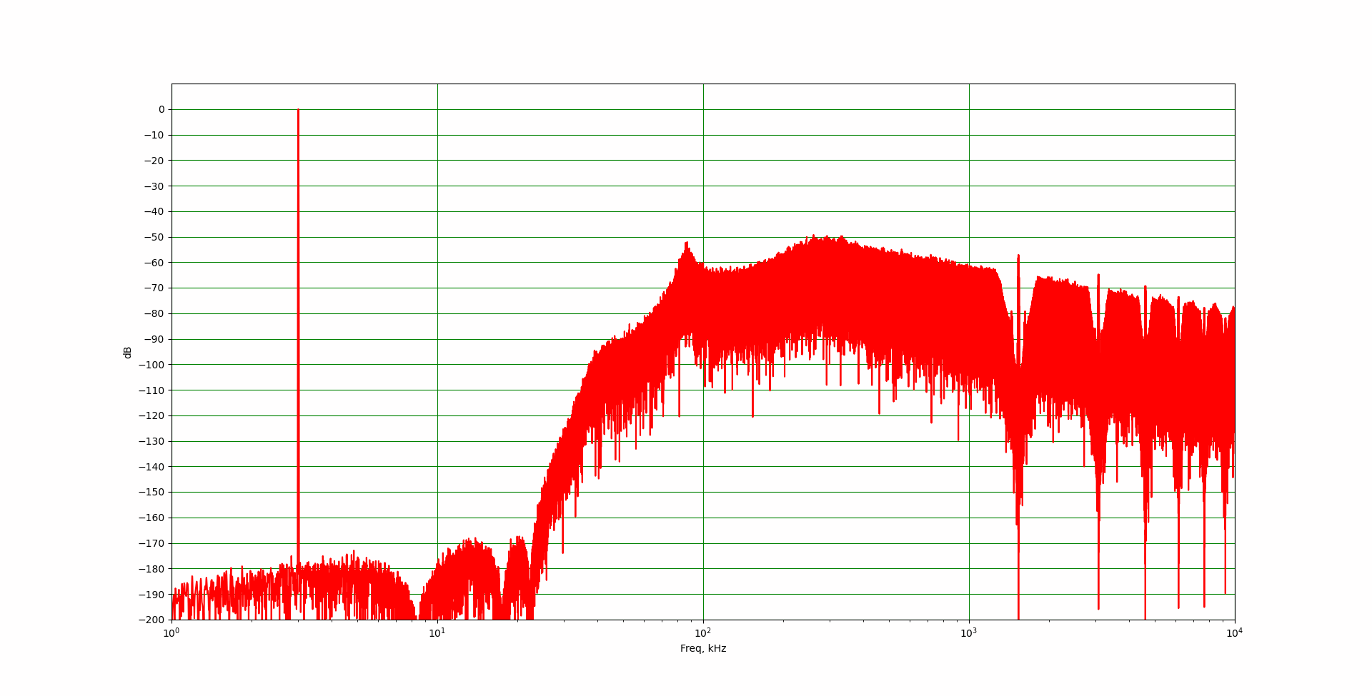

It is an intermodulation products created at the input stage of the OPAMP by high level of quantization noise, essentially when signal as low as -60dB.
If you still insist in existence of the "idle tones", I can present a simulated spectrum of the modulator for -60dB 1kHz tone.
There is nothing there even at -190dB! The model is exact, including fixed point arithmetic and truncation errors.

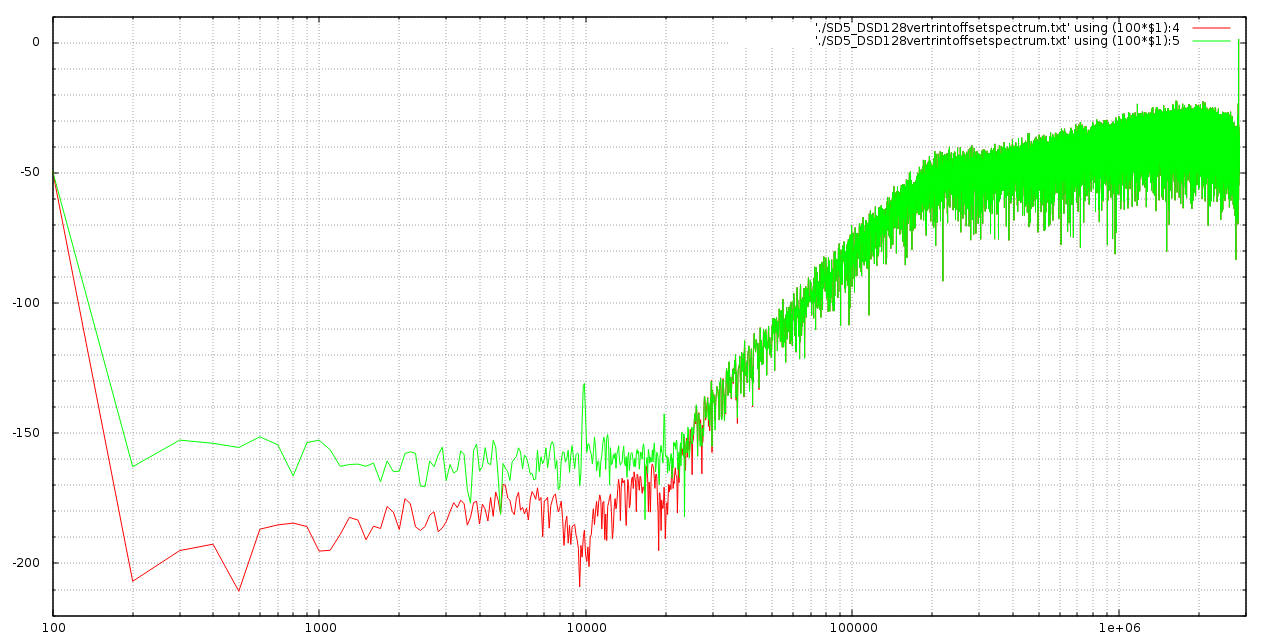

Of course it's an intermodulation product. That's what I have been writing all the time. Whether it is created by an op-amp is unknown; it might as well be created by other analogue imperfections, such as data-to-clock crosstalk, data-to-reference crosstalk or some intersymbol interference due to imperfect settling.
When the signal is just a small offset, the intermodulation product is a tone or a narrow noise bump. That's why it is commonly known as an idle tone.
Example of intersymbol interference:
Fifth-order single-bit sigma-delta modulator of post #2696, no dither, small offset as input signal.
Horizontal scale in Hz, vertical in dB DSD, Hann window, bin size 100 Hz
Red trace: ideal case
Green trace: some second-order intermodulation introduced by making the bit weight vary +/- 1 ppm depending on the previous bit
Why are you so focussed on everything digital? Are you a digital designer?
Anyway, would you kindly look at what the spectrum looks like around fs/2 and how that changes with a little offset? Do keep in mind that there is an image on the other side of fs/2, and then think about what happens with a little second-order intermodulation somewhere.

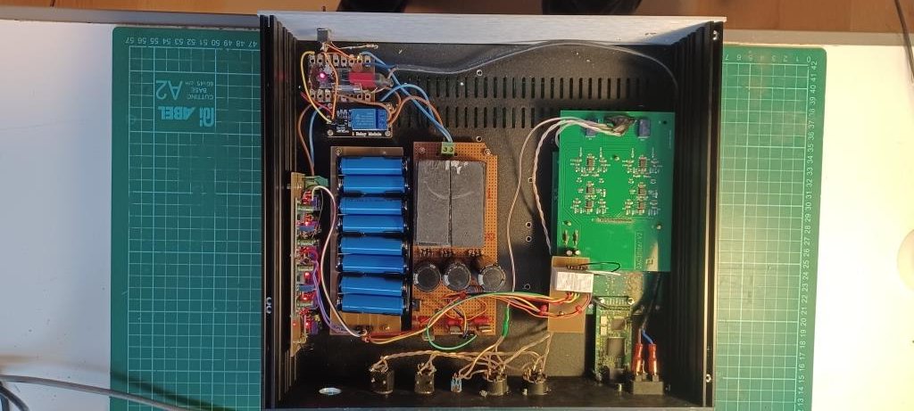

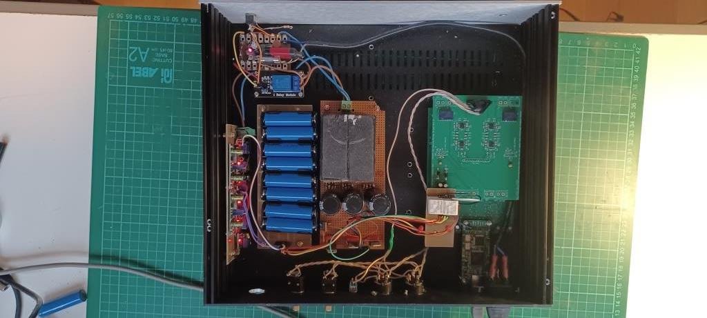

Hi All.
I finally got filterboards, two different, for the RTZ dac.
I know my build will not win any beauty contest, but it is a bit like a prototype. A lot of things shall be tried before the final version.
The power supply for the dac is from another project, modified to fit the bill here. The batteries are LifePo4 and they power the filterboards. The small pototype print on top of the filterboard, is a relay that couples the batteries in when playing. The batteries are charged, when not playing and the 230 V to the charging PS is disabled while playing.

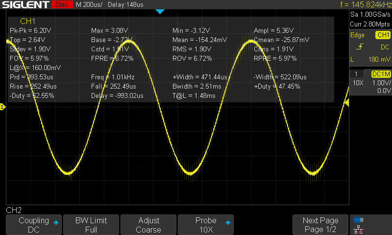

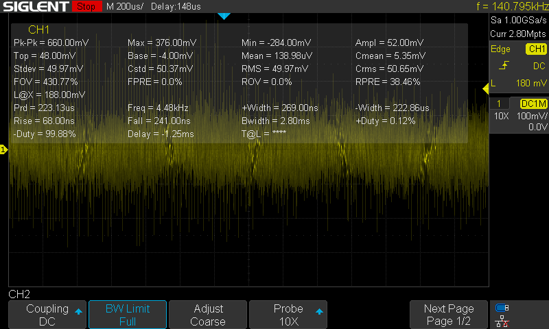

The reason for the different in sound could be , that the 2210-1678 circuit acts better as a virtual ground , than the 1632 as can bee seen in the scop dumps of the input to the filterboards. First 2210-1678 next 1632:

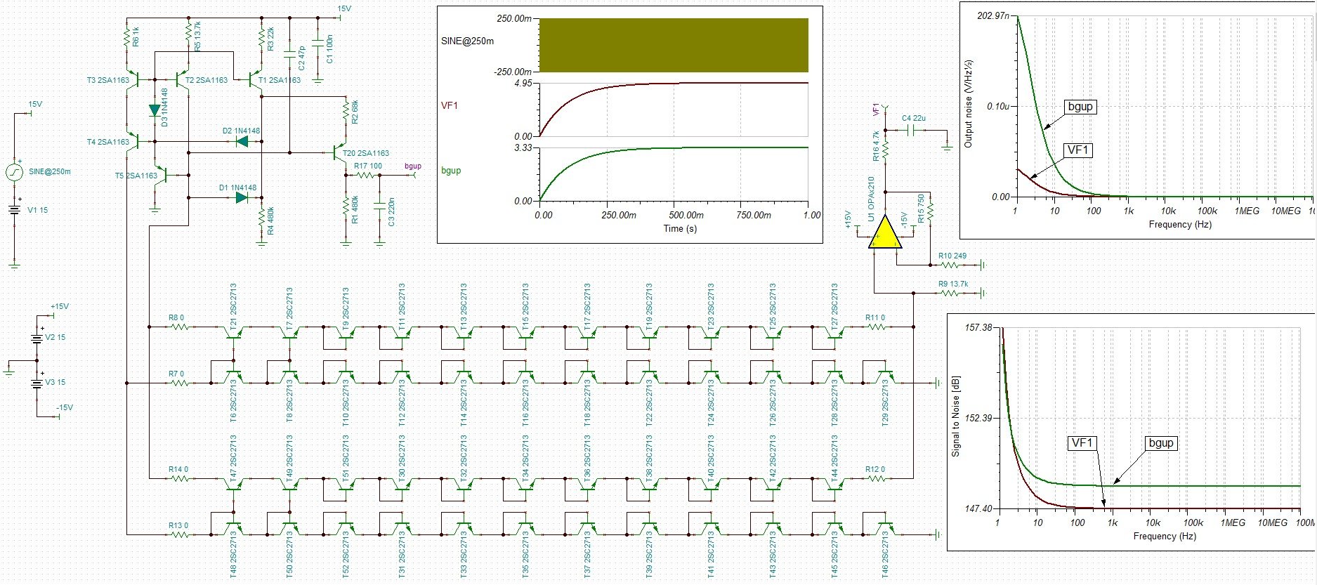

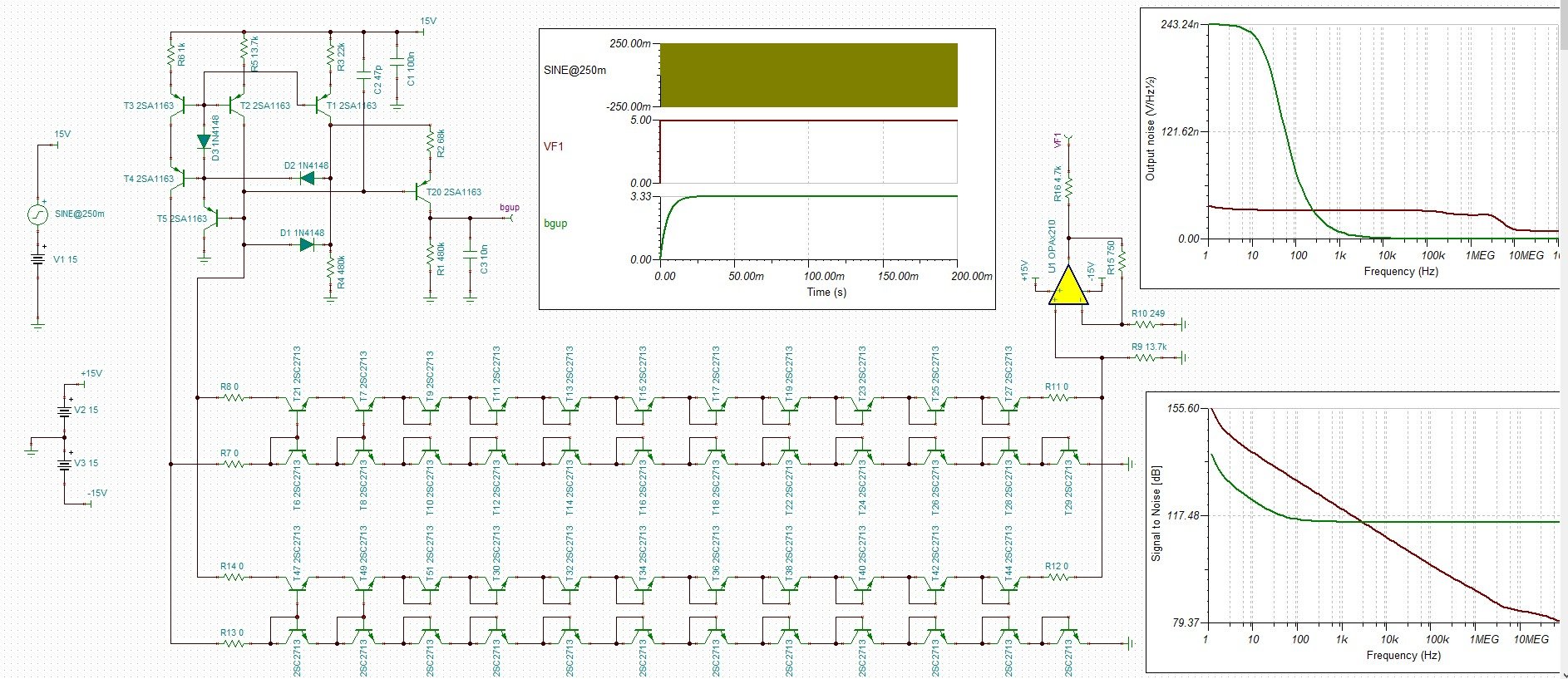

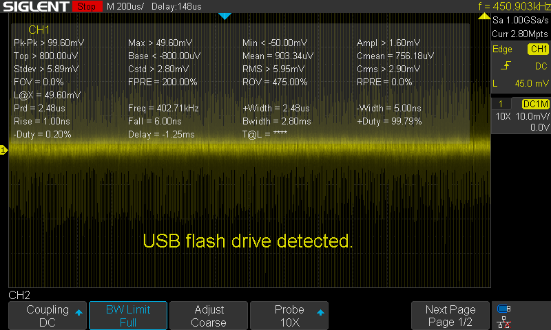

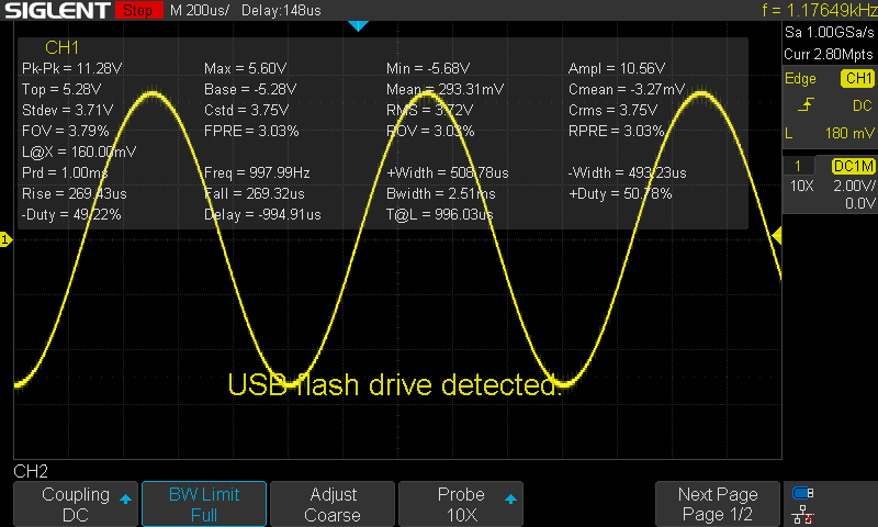

Is this ok to add some bgup and VF1 RC for noise surpress or you prefering faster startup without those capacitors? I do not see capacitors on your schematic? Also I have changed some resistor values for getting 5V and 3.3V, is it ok? Bgup is noisy even when I put RC network,
Edit: picture 2 without RC, nice startup but SNR is significantly worse. Whats prefered, with or without RC? Thanks

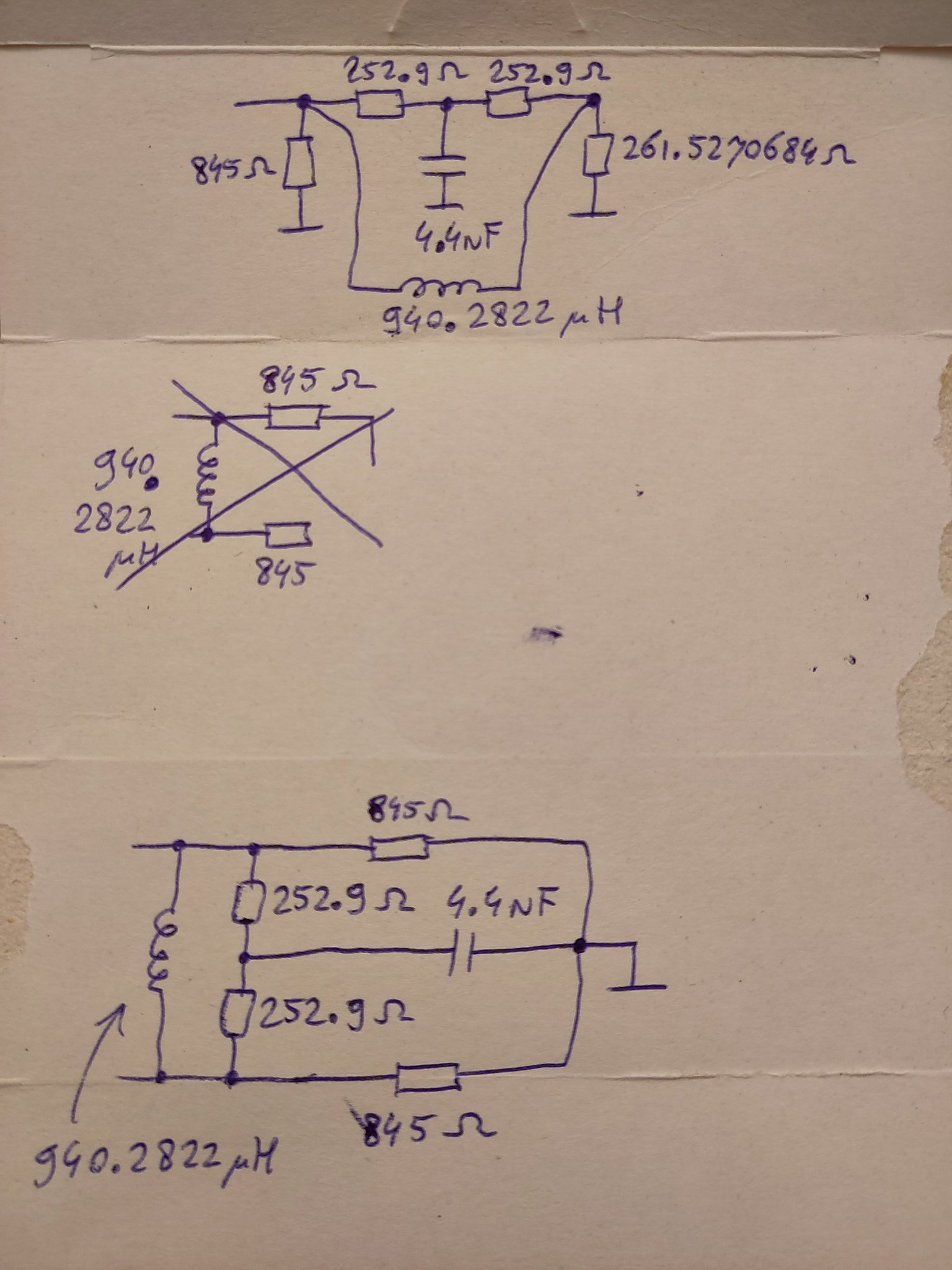

I know, one of them asked my advice. I would suggest using a resistor that is a bit closer to 378.75 ohm. The nearest E12 value is 390 ohm, the nearest E96 value 383 ohm.
The unused DAC output can then be terminated to ground with either a 200 ohm resistor or the upper circuit of this sketch, with all values rounded to something practical:
This is assuming the OPA1632 filter is filter is filter 3 from post #2471. (There were several filters with OPA1632s mentioned in this thread.)
Yes, understood. IIRC, I did try loading the dac inverting output to match what my transformer input roughly looks like. I didn't like the sound better that way, so I decided to leave the inverting output unloaded. I know, of course, it goes against theory. But I still ended up leaving it unloaded. So, I would be interested to see what other folks think if they try loading it or not.
