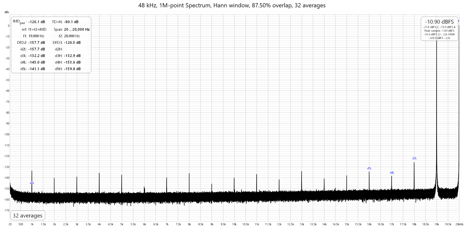

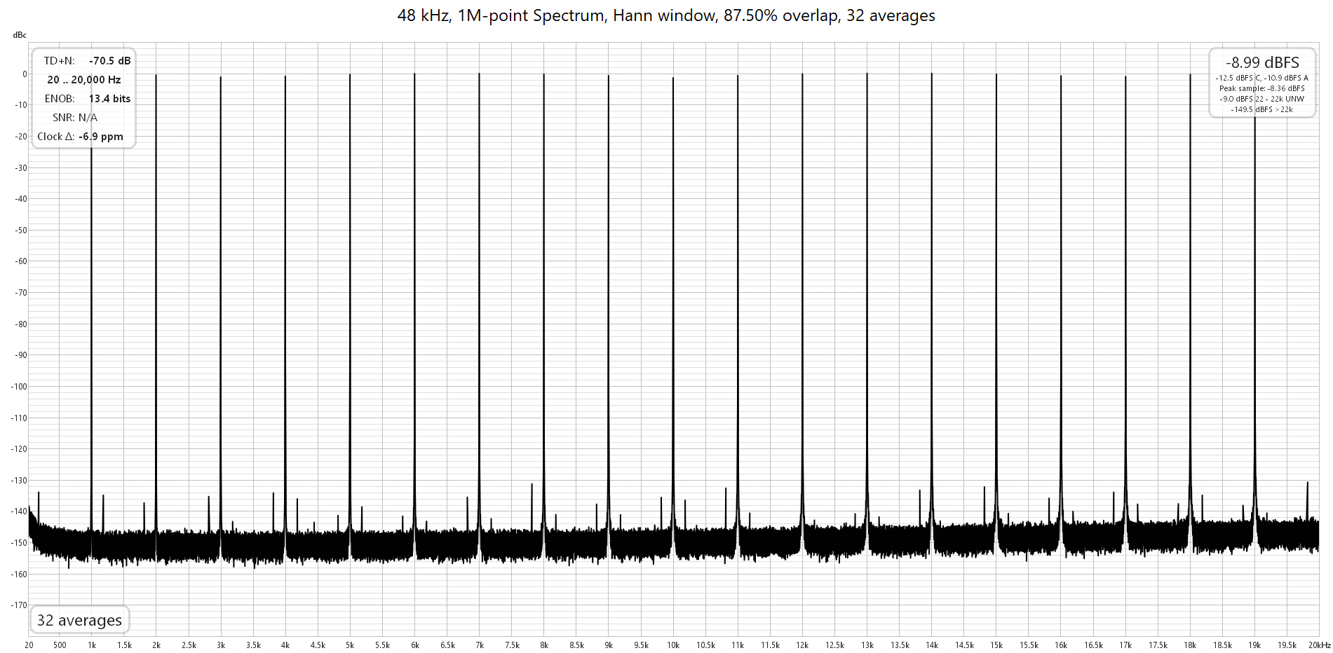

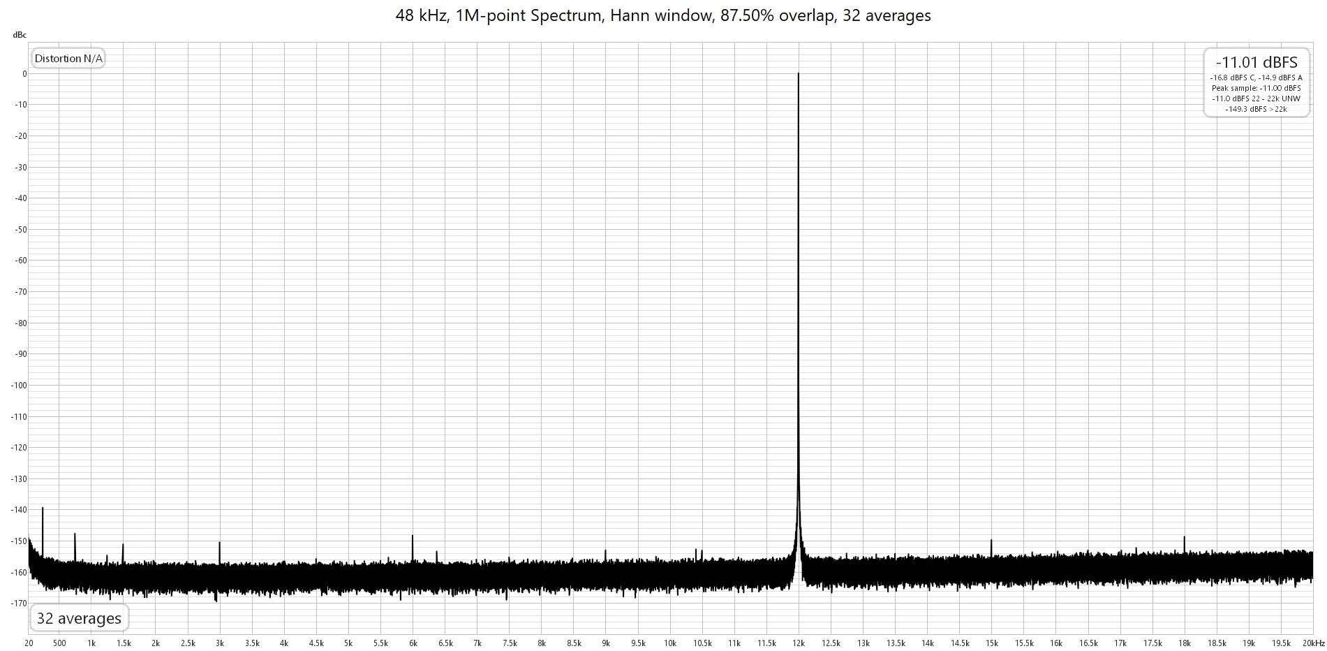

Sorry Markw4,

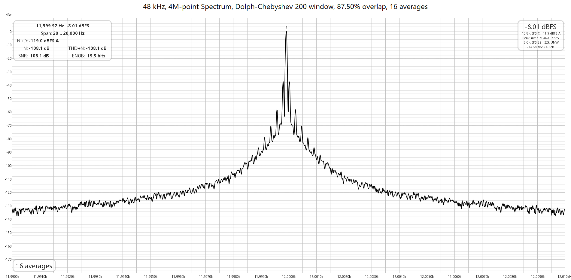

I want to add some graphs you might interested in:
1. Multitone at -1dBFS
2. 12K 20Hz BW 4M FFT for clock purity assessment at 0dBFS.
3. CCIF at -3dBFS
4. 12K J-test with default settings.

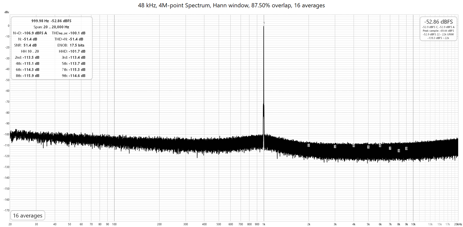

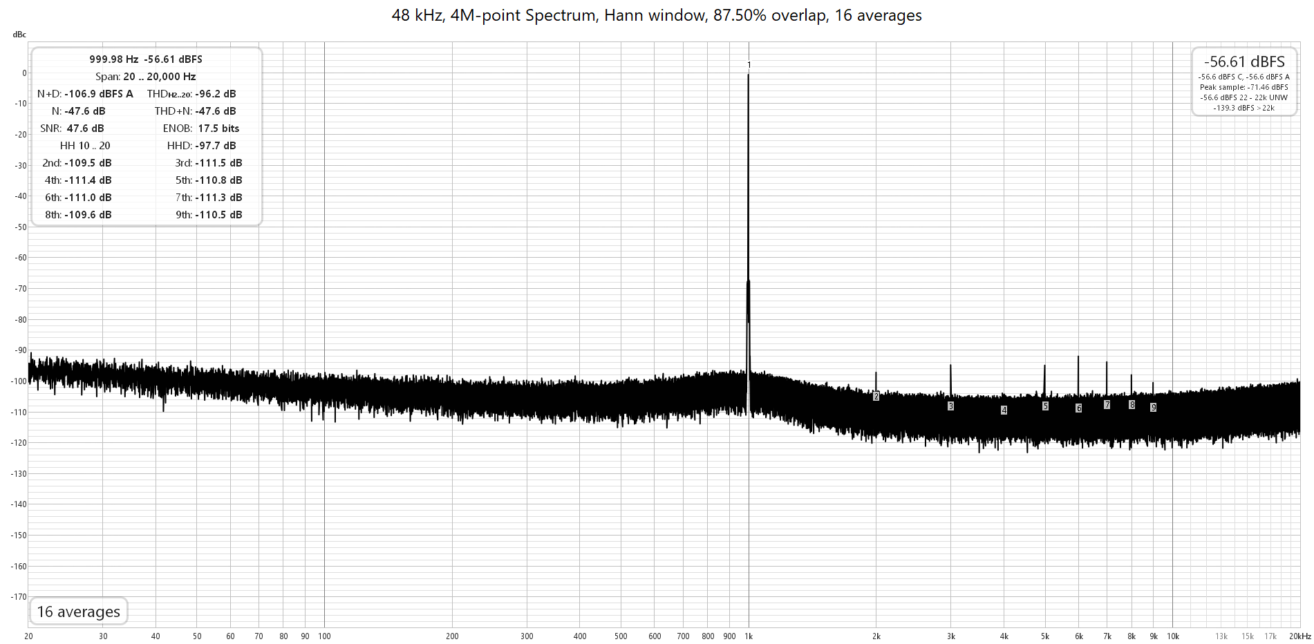

Hurray! I have caught this famous idle tones!
Carrier level is -60.01dBFS:
OK, so you don't have any offset and the idle tones are around -152 dBFS in your case, if I understand it correctly. That's some 20 dB softer than in my DAC using a version of olo111's and PJotr25's PCM2DSD. The difference can still be due to more effective dithering or a better DAC or both.

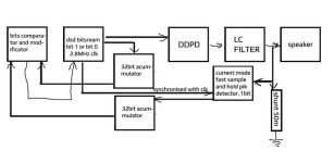

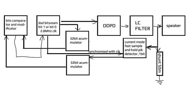

That nicely explain why I like ddpd huge dynamic sound even it have very poor result on measurement. Dsd bits simply pass through the H bridge on dsd frequency tact without delay, similar to water flow heater, it simply has to have good dynamics, and dynamic is really audible, incomparable to anything I have had the opportunity to hear. But there is also a noise, I assume that there is some problem with the dsd bitstream as I hear noise for example when track have silence, it's really not clear to me. I will have to try to manually make a dsd128 track and line up the bits like this 10101010... just to see if there will be any noise on the speakers, I will do that one day when I have time to deal with it. Will do that when gan version get finished.
I have an idea in my head how to implement feedback for ddpd, but I have no idea how to make a fast current sample-and-hold simple precision 1 bit comparator, it just needs to be able to compare the previous sample with the new sample on the shunt resistor against the peak value on the resistor and produce a simple bit 1 or bit 0. That's some idea I don't know how to implement.
