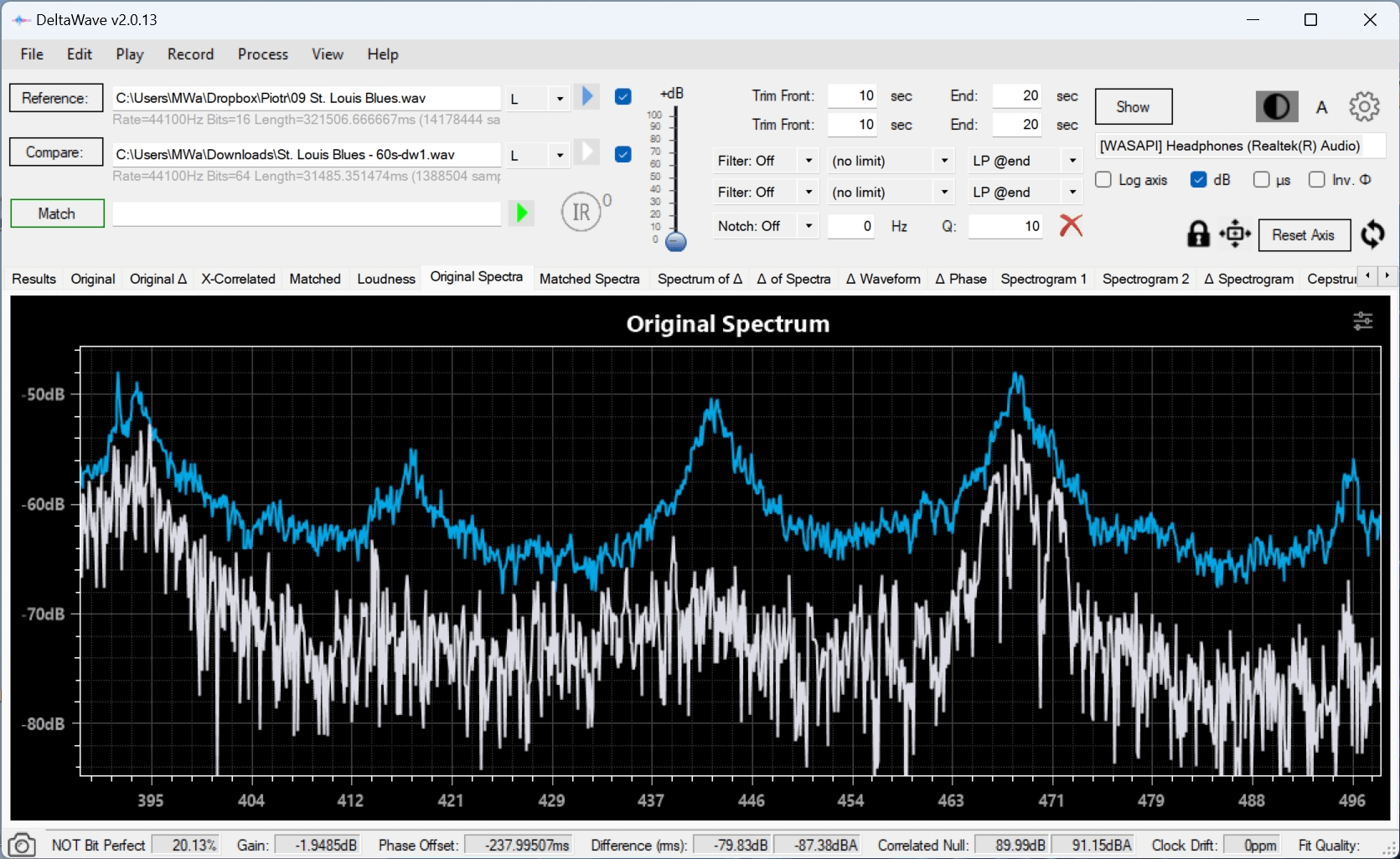

Not clear to me how DeltaWave computes some graphs. Here is a pic two original spectrums (covering a 10 second span):
As can be seen the original file has frequency peaks on average over the 10s analysis timespan. The peaks are located right around musical note frequencies (e.g. A = 440Hz). Obviously the the files are different. They appear to differ on average by 10-15dB at some frequencies over the 10s span. So why should they sound the same? 10-15dB different average power for a musical note frequency is not negligible in my book.
Where I have a question is, does anyone know how DeltaWave calculates the Matched Spectra plot? The only thing I can think of that it might doing would be to take the numerical value for each bin for each file, and adjust the bin value somehow to match the average bin value for each file. IOW, it is EQing each file bin by bin so that the FR of each bin for each file is equal to the average bin value for both files? If so, it seems crazy. Changing the FR of the files corrupts the data in them to make them look more the same!? Or what else is it doing to match FFT spectra???

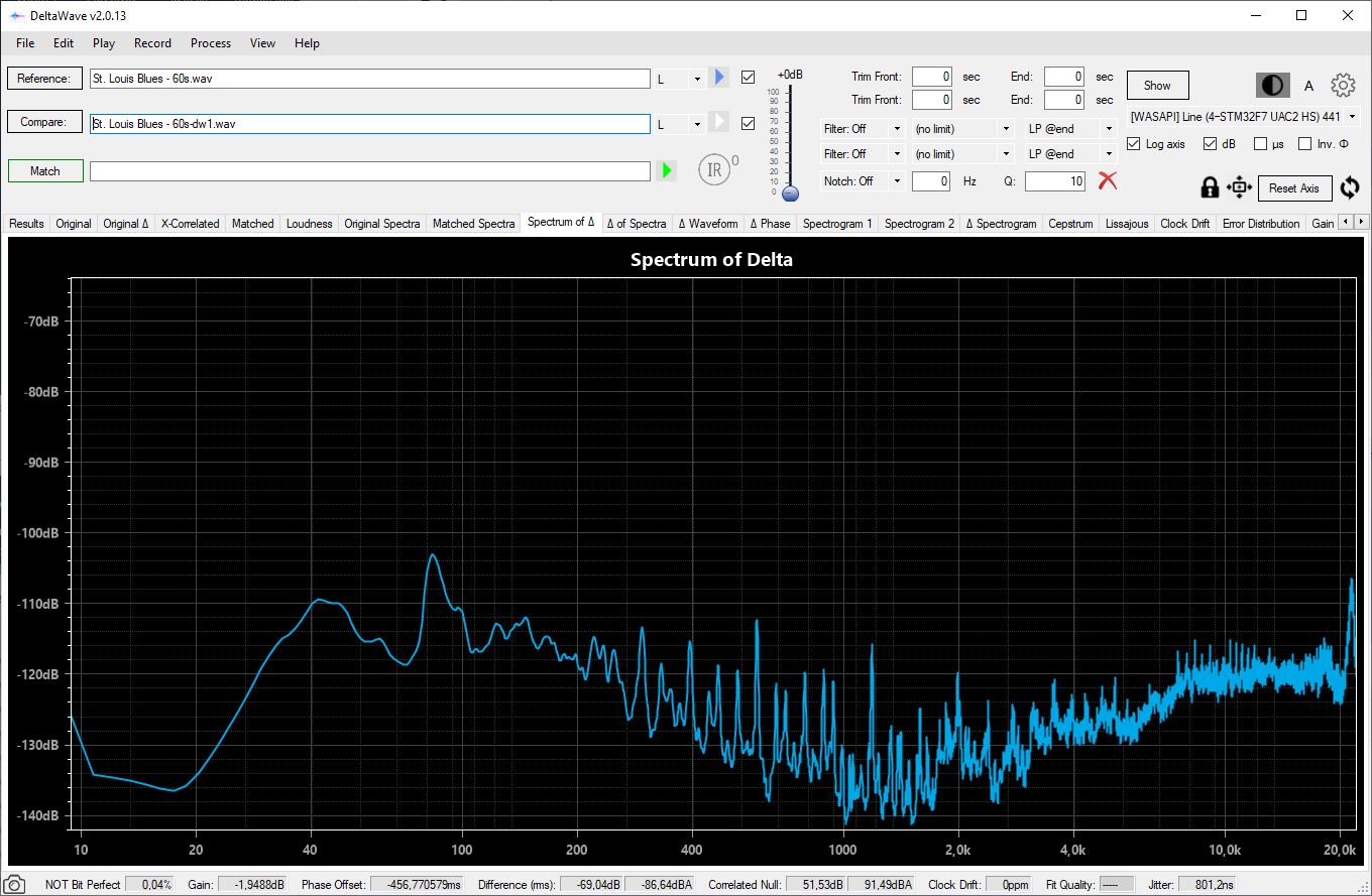

I would guess one is the magnitude of a moving DFT of the reference and the other the magnitude of a moving DFT of the difference between the momentary values of the reference and the file to be compared to it, after shifting one waveform to get the best match. That's just a guess, though.

There are two files named in the upper left corner of the pic. They are assigned colors for each, blue and white. The upper right shows the section of the files to be compared, in this case starting at 10s from the beginning of the files and ending at 20s into the files. There are FFT settings under the gear tooth icon.
So we have two FFTs of two recordings, an original CD rip, and another file made from the same CD rip but passed through PCM2DSD -> DAC -> ADC -> File.
If the processing of the second file was perfect then the two spectra should look identical, but they don't. So far so good.
The confusion arises when we click on the next tab that says Matched Spectra, and it shows the the spectra for the two files are now virtually identical. The question is what processing made them identical in the frequency domain and does such processing represent a modification of the sound of the files (at least if actually applied to the files)? IMHO, it looks a lot like a multiband FFT EQ has been applied to each file 10s segment to make its adjusted FR equal to the average of the FR's of the original two files? Thus they have been "matched" in the frequency domain. But did I guess the actual process used? Also, if played back with the adjusted FR, do each of the file segments sound different than they originally did? I think they pretty much would have to sound different from having been EQ'ed.

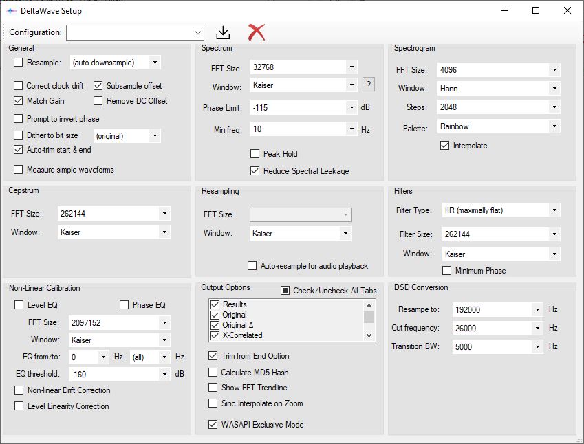

My understanding is that basic matching (as was done here) involves linear operations such as fitting based on gain and offset so no EQs involved and in this case not even clock drift correction as clocks were synchronized. But it is possible to do non-linear EQs if the matching otherwise is poor (see attachment of DeltaWave setup).We should get to that next. First I'm trying to understand the calculations used to produce the graphs. Otherwise I don't know what is being analyzed. Right now it kind of looks like DeltaWave is doing a lot of analysis to show that is matching algorithms produce very close matches. But matching what? Are they adjusting FR to make it match on average, and then you can see that is got a very small error in its matching process. But it makes no sense for use to compare EQed recordings and show they they can be EQ'ed the same to high accuracy. That's would amount to a corruption of the files for our purposes here. Maybe okay for different uses of DeltaWave though?

With the settings shown in my previous post the matching does not use EQ.
I think you are looking at this from a wrong angle. As I said before this is a tool mainly for assessing implementation quality. If matching is poor without non-linear operations then the implementation is lacking. In a scenario like this where only a single variable was changed DeltaWave can also be used to analyze differences. So for this exercise you should be more interested in comparing the recordings made with PCM2DSD against each other in DeltaWave.

If dac & adc are well implemented and synchronized matching is straightforward as only gain and offset need to adjusted. Spectra and other charts are based on matched waveforms. Of course well matched waveforms result in well matched spectra. However no matching of FFT spectra is done as is evident from the various screenshots in ASR DeltaWave. E.g. https://www.audiosciencereview.com/forum/index.php?attachments/1689022602024-png.298226/.I tried to explain in way that seems sensible to me. Maybe someone else here could chime in on it?
