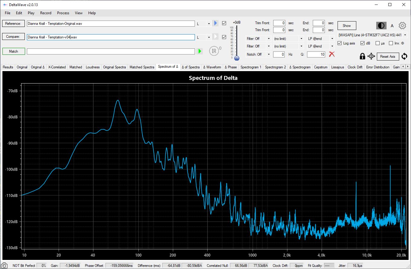

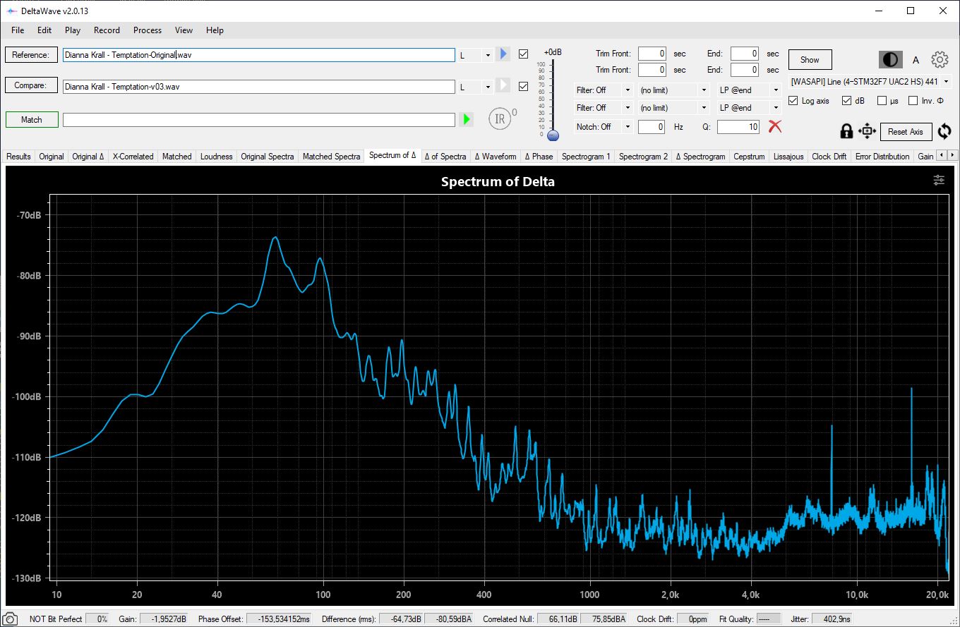

Here are examples based on v03 and v04.
- V03 Difference from the original.
- V04 Difference from the original
- Difference between v03 and v04
Okay, I see a problem, which is that FFT spectra do not show phase. However, dynamics and transient response is very dependent on phase. As Marcel has pointed out, phase can be the only difference between smooth white noise and a Dirac impulse function. Yet the frequency spectra are the same for both: flat.
Also if the above frequency spectra are calibrated, it looks the difference has an amplitude down about -29dB from the inputs for LF and with some larger amplitude of differences at HF?
Today I tested Marcel's LC+MFB filter from post #3028 with OPA1632 as opamp. To my surprise "harmonics" at -60dBFS did not improve at all. Different versions of PCM2DSD work exactly the same as before (v03 having splitted peaks and v04 without).
I also tested the difference of PCM2DSD v03 and v04 with DeltaWave audio null comparator. The difference was very small and by all accounts below audibility. Actually the difference between v03 & v04 was much smaller than e.g. between ESS/AKM dac vs. RTZ dac.

As I said those were just examples. It is possible to analyse phase or timing differences with DeltaWave as well. All analysis show minimal to non-existing difference between v03 and v04.Okay, I see a problem, which is that FFT spectra do not show phase.
E.g. here is phase difference between v03 and v04.

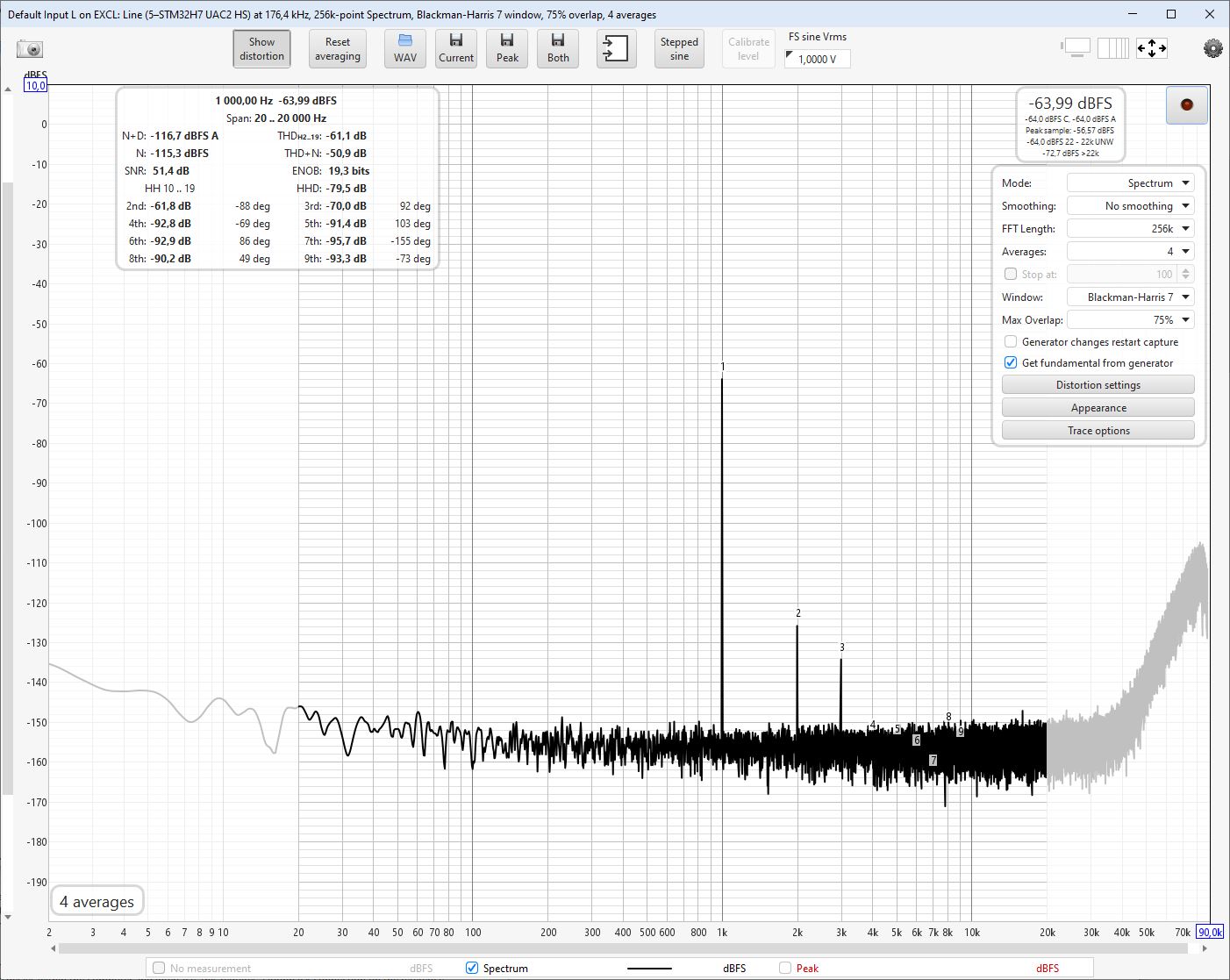

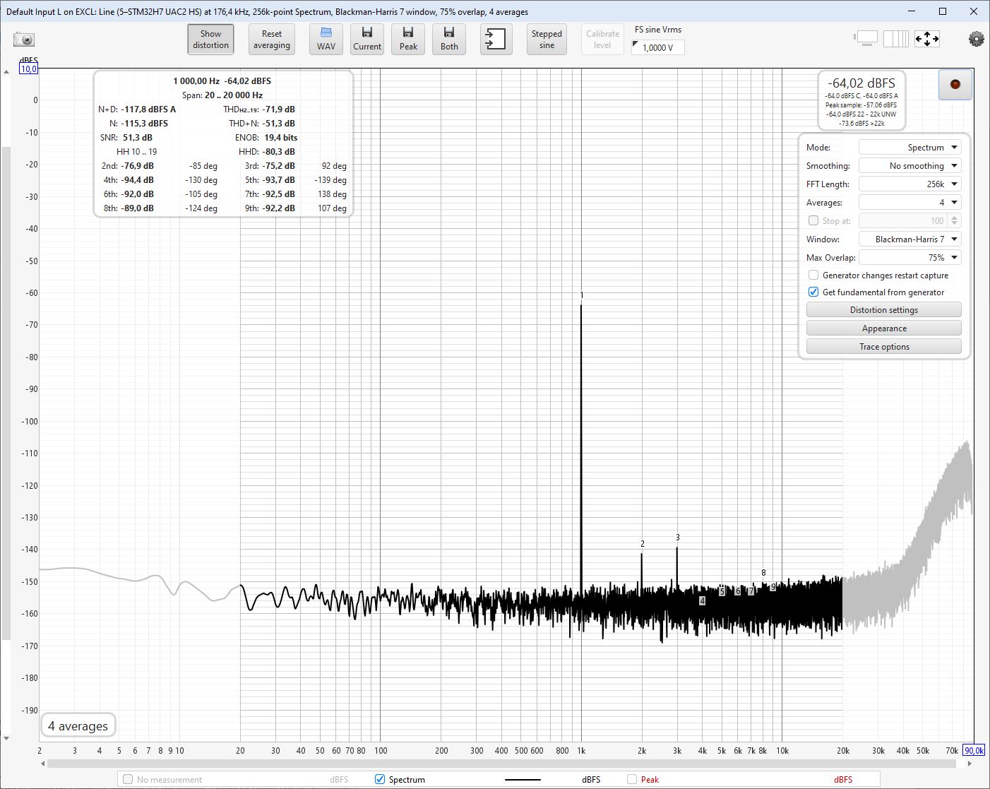

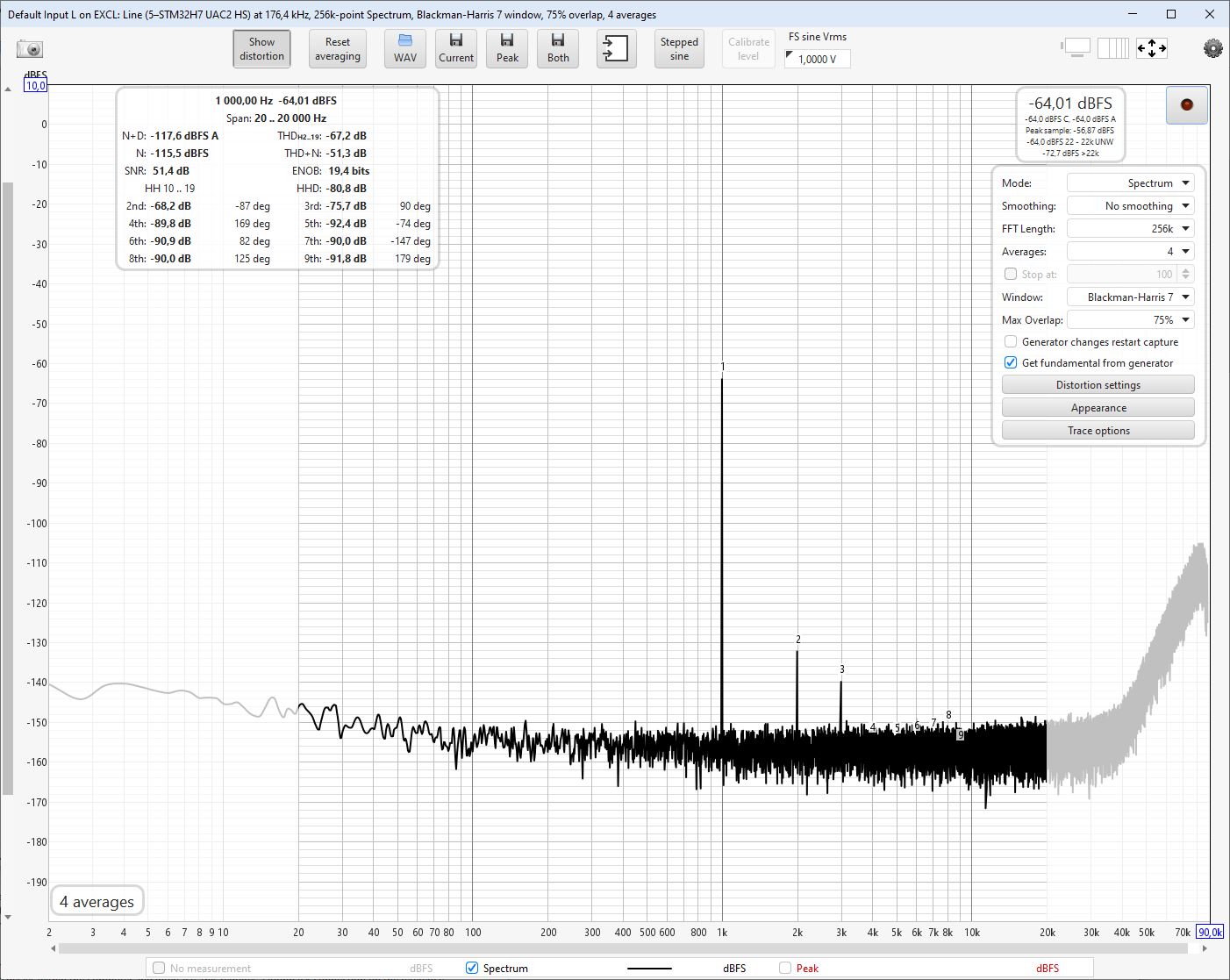

The HQPlayer ASDM7EC-light tests were done at a DSD128 rate, while the PCM2DSD tests were done at a DSD256 rate. That probably explains the very different -60 dB, 1 kHz distortion spectrum shape: almost nothing above the third harmonic with ASDM7EC-light. For a given signal level, at a lower bit rate, the frequency deviation is less, much reducing the higher Bessel components of the FM spectrum. The -54 dB, 1 kHz spectrum at DSD128 should then have a (roughly) similar shape as -60 dB, 1 kHz at DSD256, although the levels of the distortion/intermodulation products may be different.
PCM2DSD v3, -60 dB, 1 kHz, original filter:
ASDME7-light, -60 dB, 1 kHz, original filter:
ASDME7-light at -50 dB, 1 kHz, original filter:

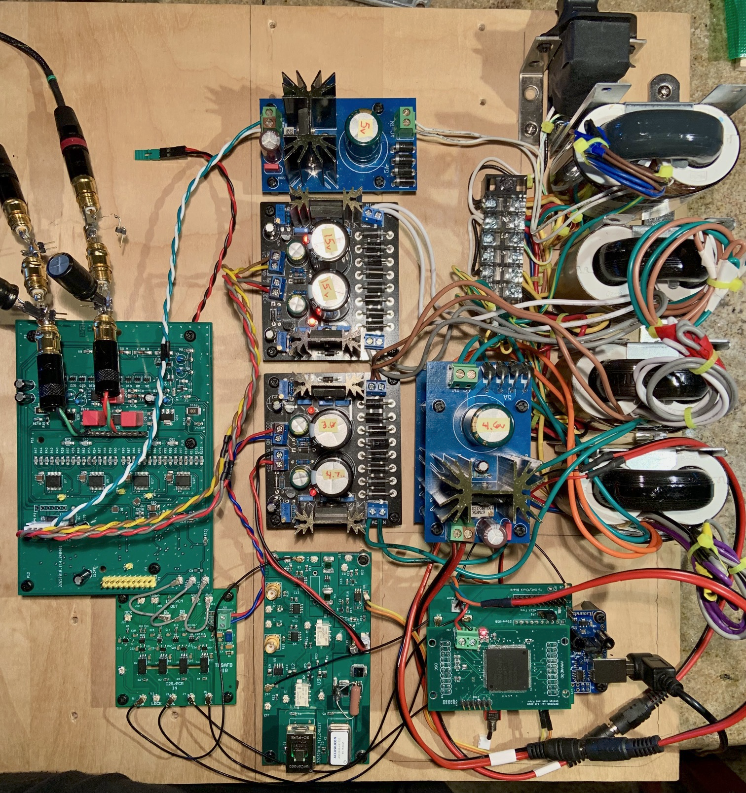

Looking at the picture this seems to be external re-clocking before Marcel dac. Marcel's dac has its own clocking which I presume you have not replaced.Marcel dac with external clocking working.
