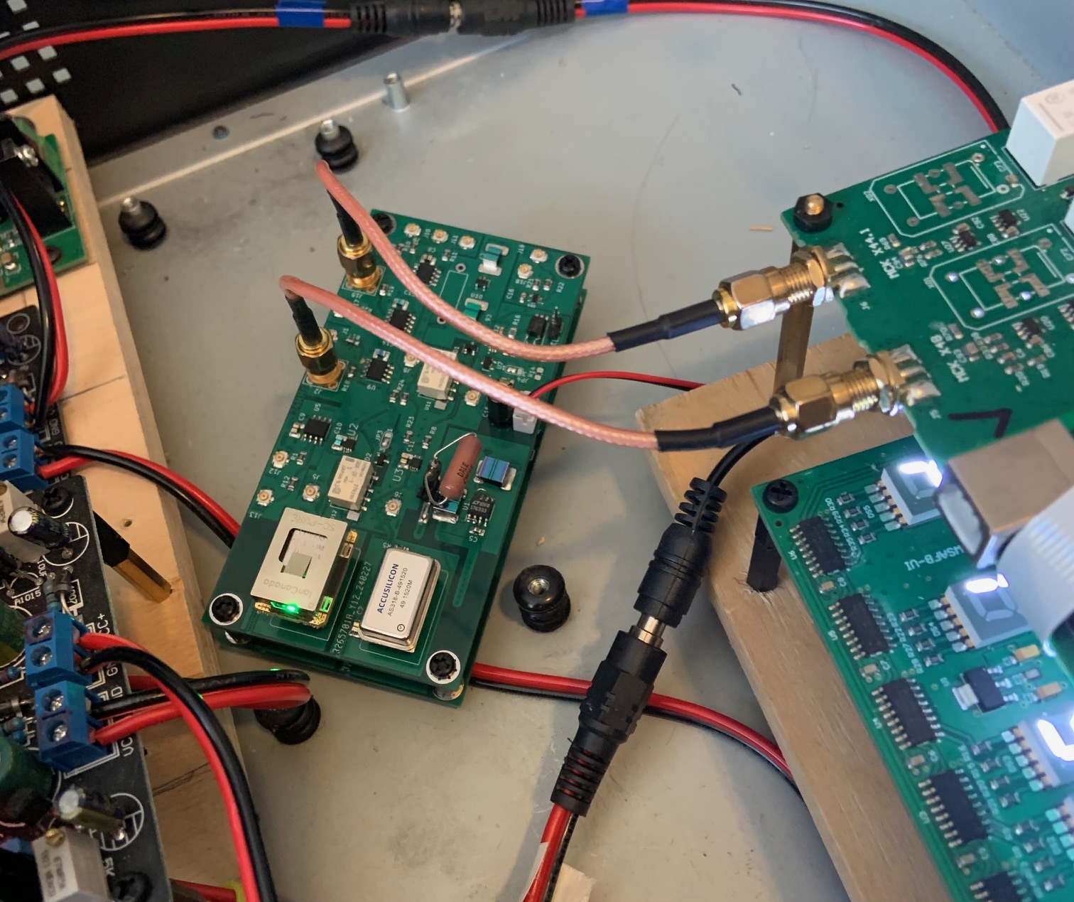

Since things have been kind of slow around here for the past few days, thought I would report in on my experience with an IanCanada 45MHz audio clock module. It in currently installed in the prototype clock board, and its been running continuously for the past 4-5 days. Initial jittery sound has faded away as is typical for new clocks. A pic of the clock in the prototype clock board below, in case anyone is interested in how it looks (its the metal can with the green LED inside):
Clock board is driving an Andrea Mori FIFO board which then drives the dual Andrea DSD dacs.
So far the IanCanada clock has been A/B compared to the Accusilicon 45MHz clock using the same clock board. For the purpose of driving the Andrea FIFO board, the clock frequencies are divided in half using NC7SZ74K8X flip flops. The division is expected to improve phase noise by about 6dB. (45/49MHz clocks are used in order to provide the option of buffered outputs for external clocking of I2SoverUSB.)
The clock board 22/24MHz outputs were also compared with AckoLabs 22/24MHz clocks for driving the FIFO board.
Basically at this point the Ian clock sounds significantly less "blurry" to me than the 45MHz Accusilicon clock. Definitely a step up in that regard.
The SOA AckoLabs clocks were chosen for comparison mainly because they are small and simple to connect/disconnect and move out of the way as needed. AckoLabs measured phase noise is similar to Andrea clocks such as 11/12MHz clocks with doublers, but not as low as Andrea 5/6MHz clocks with two doublers each.
At this point in time at least, the IanCanada clock is distinctly more blurred sounding than AckoLabs. Also Ian clock is less detailed in terms of instrument textures (e.g. natural piano chord textures), and not as precise is lateral spatial localization. These perceptual results seem more or less in proportion to measured close-in phase noise performance numbers, IMHO of course.
Would I recommend the Ian clock? Yes, to me its definitely better than Accusilicon, and its pretty pleasant to listen to. The downside is that the sound is still missing some of what the Acko labs clocks deliver into this particular system. That said, I would consider the IanCanada clock as probably acceptable for a somewhat budget limited yet pretty high end system (maybe good enough for an improved Marcel dac, say). Probably not desirable for a "cost is no object" level system though. Maybe that proposition can be tested later by driving the Marcel dac with the Andrea FIFO and Andrea/Acko clocks. Could be the Acko clocks and FIFO buffering will offer some improvement in SQ.
Regarding cost, still don't know what it would cost to build a clock board. Do know it would depend on how much of it was populated depending on its intended use. Thus, can't compare cost differences of different clock options at this point.
From this point, I will give the IanCanada clock some more time to see if it settles in any more over the next few days. Eventually, it will go into my build of a Marcel dac board setup with external clocking, and reclocking/isolation of I2S signals. More on that in maybe the next week or two as things progress.
Also regarding the clock board itself, it should be possible to do some tests later to see to what extent the board affects the sound of clocks mounted on it. Previous experiments with a similar clocking arrangement led to the best judged SQ of clocks used in earlier dac projects. Several variations of buffing, powering, bypass, etc., were tried. Based on that experience, so far I'm pretty happy with how clock board turning out.

Let me guess: that Dale resistor is the 'tuned' load for the LT3042 (45?) clock regulator..? Looks good
Or the reference voltage resistor itself?
Its an LT1763, but yeah, that's the load resistor for the main regulator. There is also an optional auxiliary regulator that can be used for some things or not.
Why not LT3042/45 ? Guess it could be, but I tend not the like the sound of them. LT1763 sounds okay (with an external NPO noise cap). I like TPS7A33 too.
I try to get away with using only one regulator for clocks and buffers. How power is routed inside the board is different for the clocks (considering the current loops and PCB inter-layer capacitance, etc.), but experiments showed one regulator sounded better than multiple regulators for most of the circuitry on the clock board.
Still undecided on cables, however for the purpose of this comparison I am using the same cables for the clock board and for the AckoLabs clocks.
