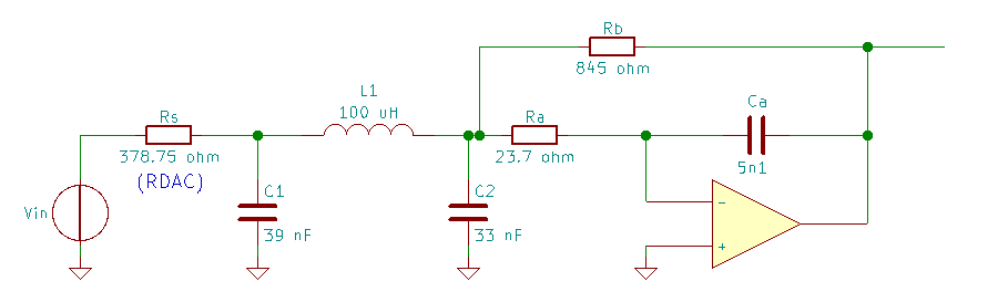

I finally made some progress with my attempts to synthesize a combined LC and MFB filter with a Butterworth response and an input impedance that is not worse than the original filter. You can read all about it in section 6 of the attachment, but if you are only interested in the result, this is a fourth-order 83.72 kHz Butterworth filter with a smaller input impedance peak than the original filter (129 ohm instead of 198 ohm excluding Rs):

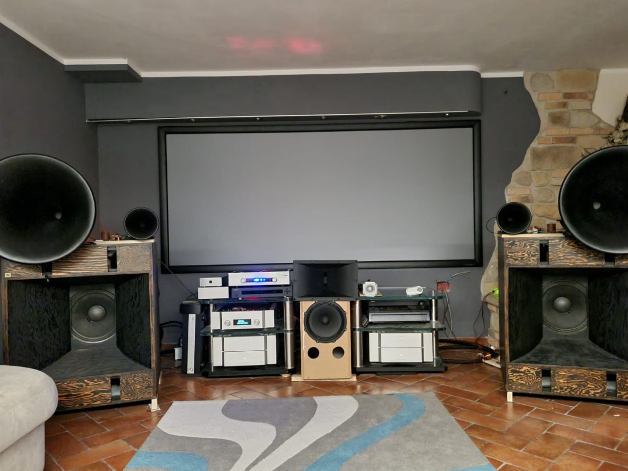

Mark. From Your description it looks like You are talking about the event that I had been fortunate enough to partecipate. For me You try to convey the information that you could gather from Andrea. Your 'transcription' sounds quite faithful, maybe with little corrections. Or rather, let me add my own impression too..
First of all, the setup of the host of the event. I hope I am not offending him (Il Gavro) if I show a photo
These are JBL bass, with JBL compression drivers on the Mid and Tw sections with horns. The amplification is Audio Analogue Maestro 200 monoblock+A.A. pre. These are zero global feedback, 200W/8ohm, 800W 2ohm etc. etc. oversized, 'gentle giants'.
The JBL system is ~ 104db sensitivity. (going by memory..)
I went into details, to make it clear that it's a very high resolution, low distortion, ~infinite dynamic capability chain, with a quite merciless approach towards the feeding chain. It's totally capable to throw a big, wide and deep soundstage and execute a 'disappearing act', all those massive mobiles and horns notwithstanding.
First of all, the setup of the host of the event. I hope I am not offending him (Il Gavro) if I show a photoView attachment 1305599

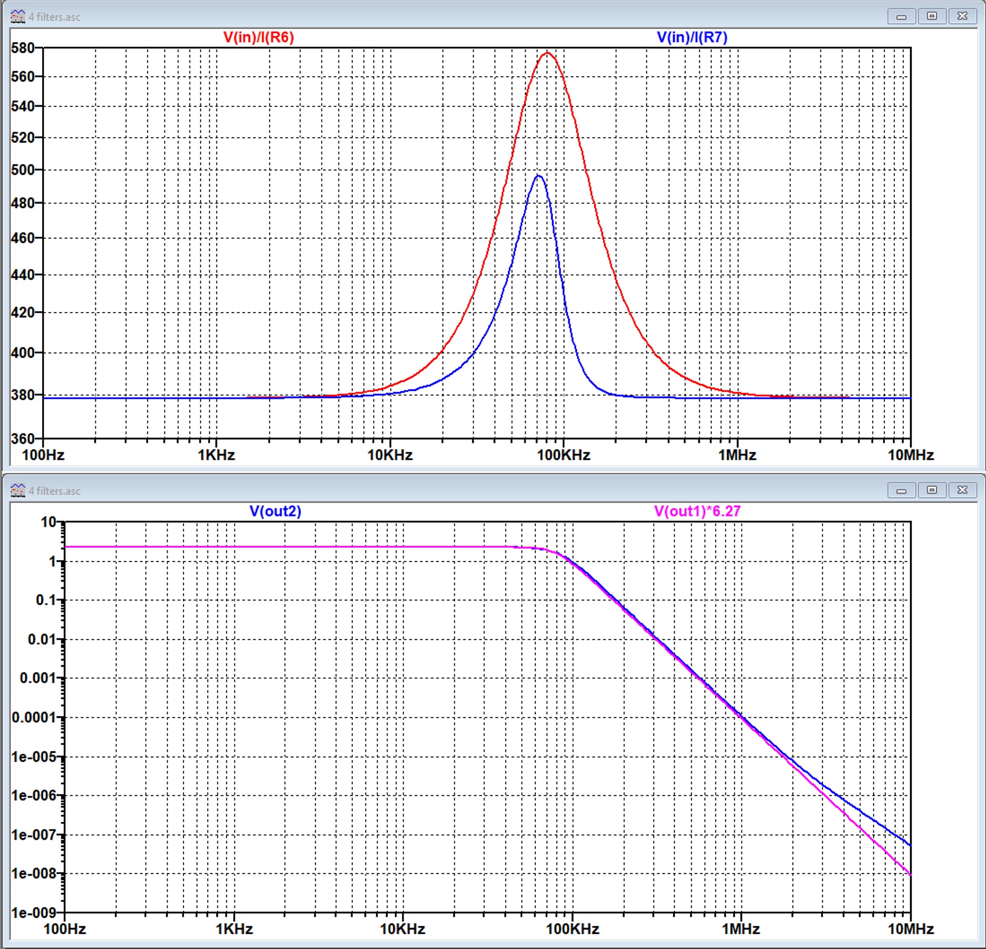

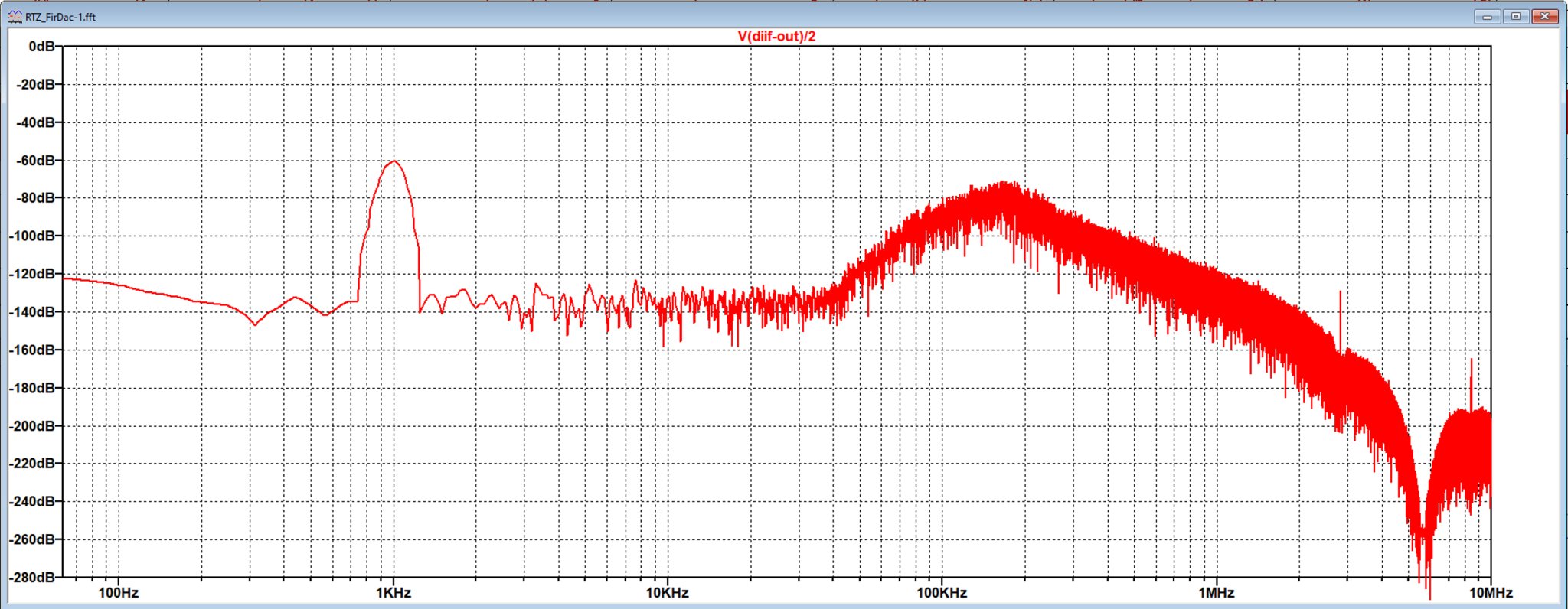

Marcel,
This seems like a step forward in getting rid of the alias products.
The input impedance , Red existing filter and blue the new proposal are in the first attachment.
Below are the FR in blue compared to a 4th order passive LC filter.
Above a few Mhz, the active filter is slightly deviating from the ideal filter curve.

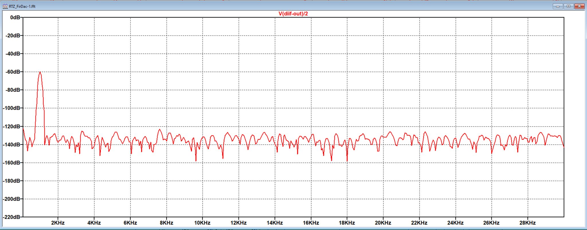

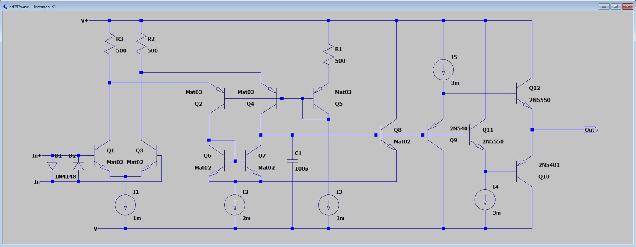

Not happy with all the op-amps that were misbehaving in the double clocked RTZ Firdac, I tried to make a copy of the AD797 with discrete components with interesting results.
The response was now exactly the same as with a passive filter, although LTSpice really calculates distortion when discrete transistors are used.
So for the RTZ Firdac such a discrete solution could be an option.
Hans
That is excellent.
Next stop, add a second Op-Amp at the inverting input followed by an Inverter (low noise of course) or perhaps just a low noise J-Fet with the output connected in front of Ra, as additional AC error servo.
Thor
For my understanding, what op-amp did you use for the combined LC-MFB filter and in what circuit did you simulate your new AD797-like op-amp? Each bit repeated or not?
I used the Opa2210 in the newly designed combined LC-MFB filter.

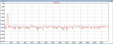

And my 797 like op amp was used in the original RTZ Firdac filter, replacing the Opa2210 while the digital circuit was driven with twice the clock speed, thereby using each .dsf sample twice.
As shown in #3013, no op-amp came even close to faithfully proces the Firdac’s bitstream.
But this discrete 797 like version passed the same test with flying colors.
Hans
