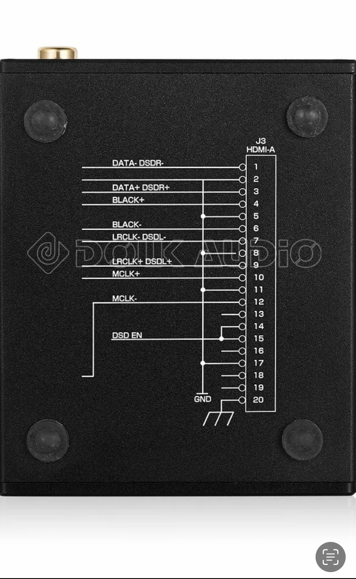

I have a Mini XMOS XU208 usb digital interface with spdif out and i2S which I used with another dac , maybe worth trying it with a HDMI to i2S receiver into the pcm2DSD . Its run from an external psu
No, didn't swap any opamps. On the HDMI issue, seems like jitter might be higher that way but you could try it and see.BTW did the Marcel dac you try have NE5532's in the active filter stage instead of the OPA1678's ?

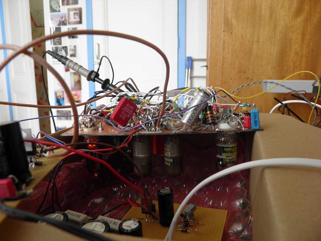

It did, but you could very clearly hear the noise floor go up when you touched the coaxial cable that carried the data signal - touch the insulating sleeve around the shield, that is. I decided to go for a four-layer printed circuit board for the final design, to get better and more reproducible shielding.
It also taught me how not to design a valve-based crystal oscillator. I originally wanted to make an oscillator that could be tuned with a reactance valve (which is not a special valve, but a simple circuit) to make it lock to an S/PDIF, Toslink or AES3 source, but never got it to work over the frequency tuning range required for that.
It gives an idea though of potential also quicker and cheaper to knock up and work on . I lashed up a dual TDA1541a with 6c45pi output stage years ago based on Leshas dac , it first looked like a rats nest but sounded good .

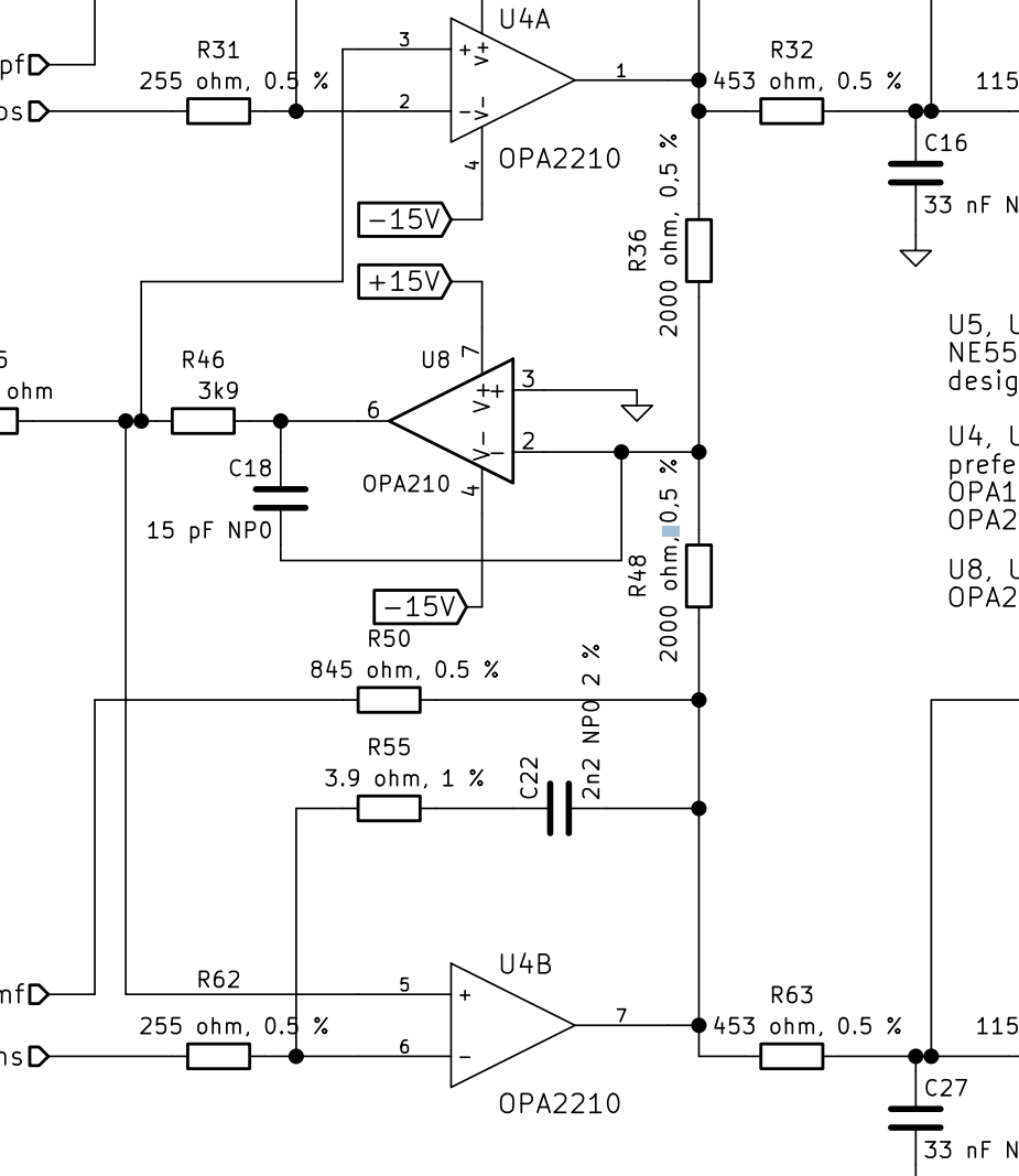

Hopefully tomorrow I'm going to try Marks idea of 1uf across C18/45 (15pf) and pair of parallel 1meg resistors from pin2 of U8/15 (opa210) to ground

What's that about? The mod I did to slow down the common mode servo was more less as follows: Basically C18 in the schematic below becomes 1uf. R36,R48 each become 1 meg. To make it reversible, I add pin headers so that I could put 1uf in parallel with the 15pf C18. Then I cut traces and installed pin headers so I could put 1M in series with each of R36 and R48....pair of parallel 1meg resistors from pin2 of U8/15 (opa210) to ground
Ah right ok thanks, I got confused by the photo , think it was Marcels it looked like resistors he used went from pin2 of opamp to ground with the croc clips
