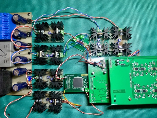

Thanks Mark , so far I do prefer it bypassing the last section so will listen for longer and try reverting back just to be sure . I'd like a little more depth to the sound so look forward to trying any other tweaks . I'm reading through the thread trying to find any ideas posted to try out .
I might try a couple more shunts and run the output stage board +/-15v separate
Just seen your edited post , thanks again I'll certainly give those a tryNice to see someone else trying some things with Marcel's RTZ dac. Please do post some pics and keep us apprised of your other experiments. IME bypassing the last section of the output stage board makes for a significant difference. What I did was cut a few traces and add some jumper wires. That way the output stage can pretty easily be restored to it original state if desired. The other nice mod on the output board is to reduce the bandwidth of the differential summing stage so that it only acts as a DC servo. Sure sounded better to me is SE after doing that. Also, I hope you are running the output stage from separate power supplies, instead of sharing the power supplies for the dac board. Otherwise there is digital junk on the output stage rails that affects the sound.
In addition I would also suggest to save the shunt regulators for the output stage and for the dac board Vref. Amanero and PCM2DSD can run from 7805 regulators and work fine. Also for series pass regulators, loading down the output with a resistor to ground can sometimes improve their performance. Its one of those things where you just have to try it and see. For my 3.3v regulators I might go as low as 47R to ground. OTOH for Marcel's Vref I paralleled 120R with each of the four 22uf X5R shift register bypass caps. That did help some too.

It is good practice to make some measurements as baseline before embarking on modifications. Then after each modification new measurements can be made and compared against the baseline. This just to ensure that the modifications have not resulted in performance degradation. Ears can easily be fooled.
You're right , I wish I could have measured it with the NE5532's in , after changing to the OPA1678's I didn't expect it to sound much different but was quite surprised . Its a shame its not easy to swap these things back

I've got some 120R resistors so can easily try adding those across the 22uf on the VREF , easily reversible
This is the reason why measurements are needed. Modifications rarely allow A/B comparisons before and after the fact. I'm quite sure all the proposed modifications result in measurable differences. Some better and some worse.Its a shame its not easy to swap these things back

That's typical of what happens when you start approaching very high performance levels of devices. There are lots of problems to solve and each one only gives a small improvement. Only by fixing all or most of them does the sound slowly start getting to the point that people can't believe you are playing something from a CD because it sounds so good. Also, it takes fixing things in the whole system, not just the dac. Otherwise the rest of the system will limit being able to hear improvements in the dac. That's one reason why really good dacs and really good systems tend to be expensive (which is not to suggest that expensive implies good, it doesn't). Just means fixing a lot of stuff can be complex and costly....its added a small but worthwhile improvement .
Another thing you may find is that solving some problems may sometimes require taking a step backwards before taking two steps forward in another direction. Using SE outputs may to be one of those things. Something is gained but something else is lost. The problem is then how to get back what is lost while keeping what is gained from SE. Turns out its doable, but figuring out a solution from scratch can take a lot of time and effort. That said, you can buy a dac board and support circuitry that solves most of the known problems. It just costs more than $1k to assemble them into a diy dac. That's what I am doing at the moment; the dac system includes boards from Andrea Mori, clocks from Acko Labs, and other devices which for now remain under NDA.
EDIT: One of things I did with Marcel's dac that gave one of the biggest improvements was to replace the Amanaero with the latest version of I2SoverUSB. The latter takes two isolated 5v power supplies for best performance. One thing it has that Amanero doesn't have is galvanic isolation. It helps with reducing common mode noise coming in through the USB connection.
I quite like using headphones too especially after any tweaks , they seem to be good at revealing issues
I keep looking at the I2SoverUSB because I'd like to try the simultaneous mode with my AYA2 dac too as well as using it with the Marcel FIRDAC . Hopefully it's not too fiddly to use with the simple pcm2DSD , the Amanero plugs straight in to it . I mainly use a MacBook ProThat's typical of what happens when you start approaching very high performance levels of devices. There are lots of problems to solve and each one only gives a small improvement. Only by fixing all or most of them does the sound slowly start getting to the point that people can't believe you are playing something from a CD because it sounds so good. Also, it takes fixing things in the whole system, not just the dac. Otherwise the rest of the system will limit being able to hear improvements in the dac. That's one reason why really good dacs and really good systems tend to be expensive (which is not to suggest that expensive implies good, it doesn't). Just means fixing a lot of stuff can be complex and costly.
I'll have a look at the options for Andrea's dac , maybe something to try after Marcels
It possible to make short adapter cable (or adapter PCB), so I2SoverUSB can plug into an Amanero format pin header. Also I made a little board that can hold an I2SoverUSB and output Amanero format which I used when I had one of Marcel's dacs here on loan. The board wasn't really designed for that, but it works. Maybe I could send you an unpopulated one if you don't have any other solution.
