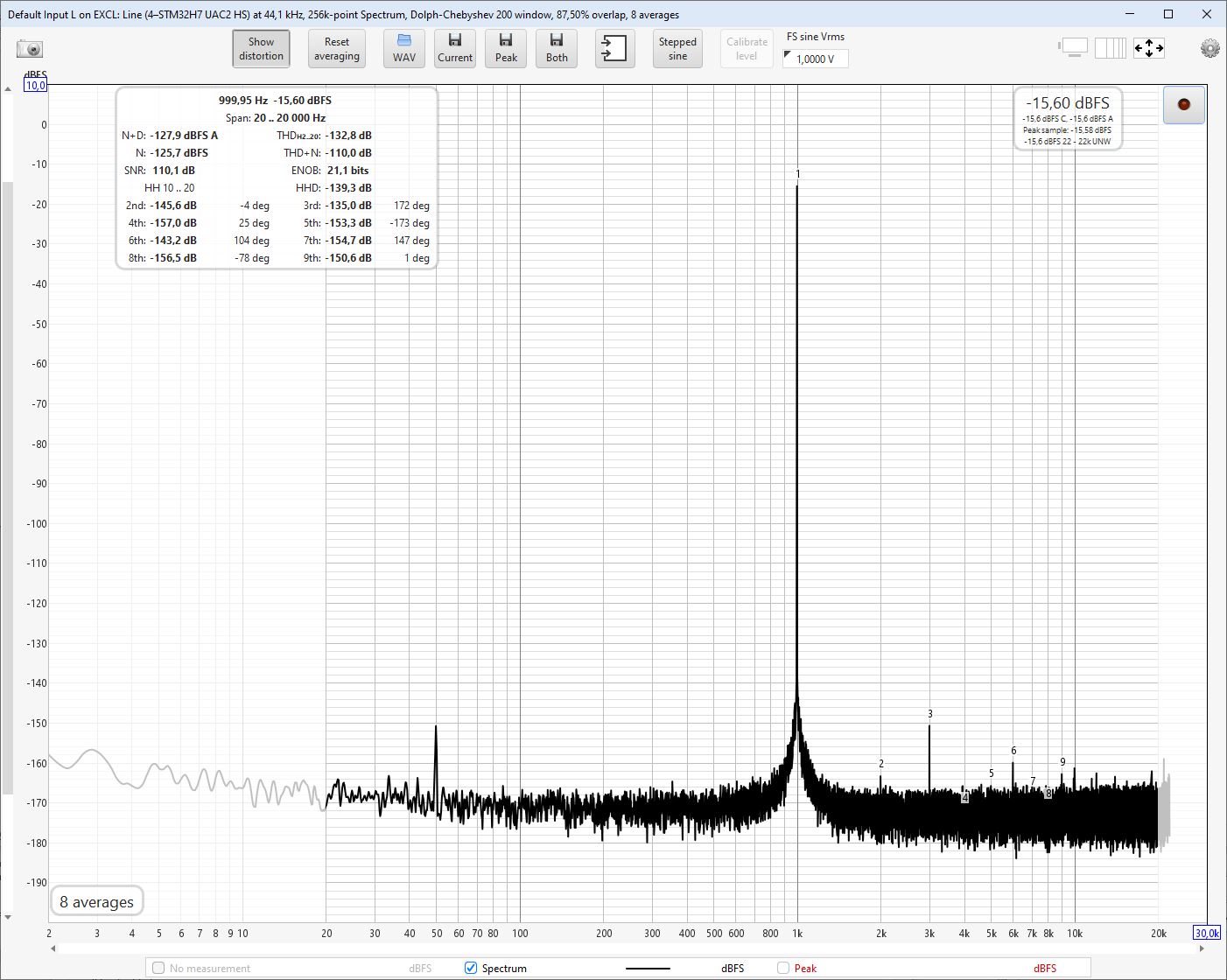

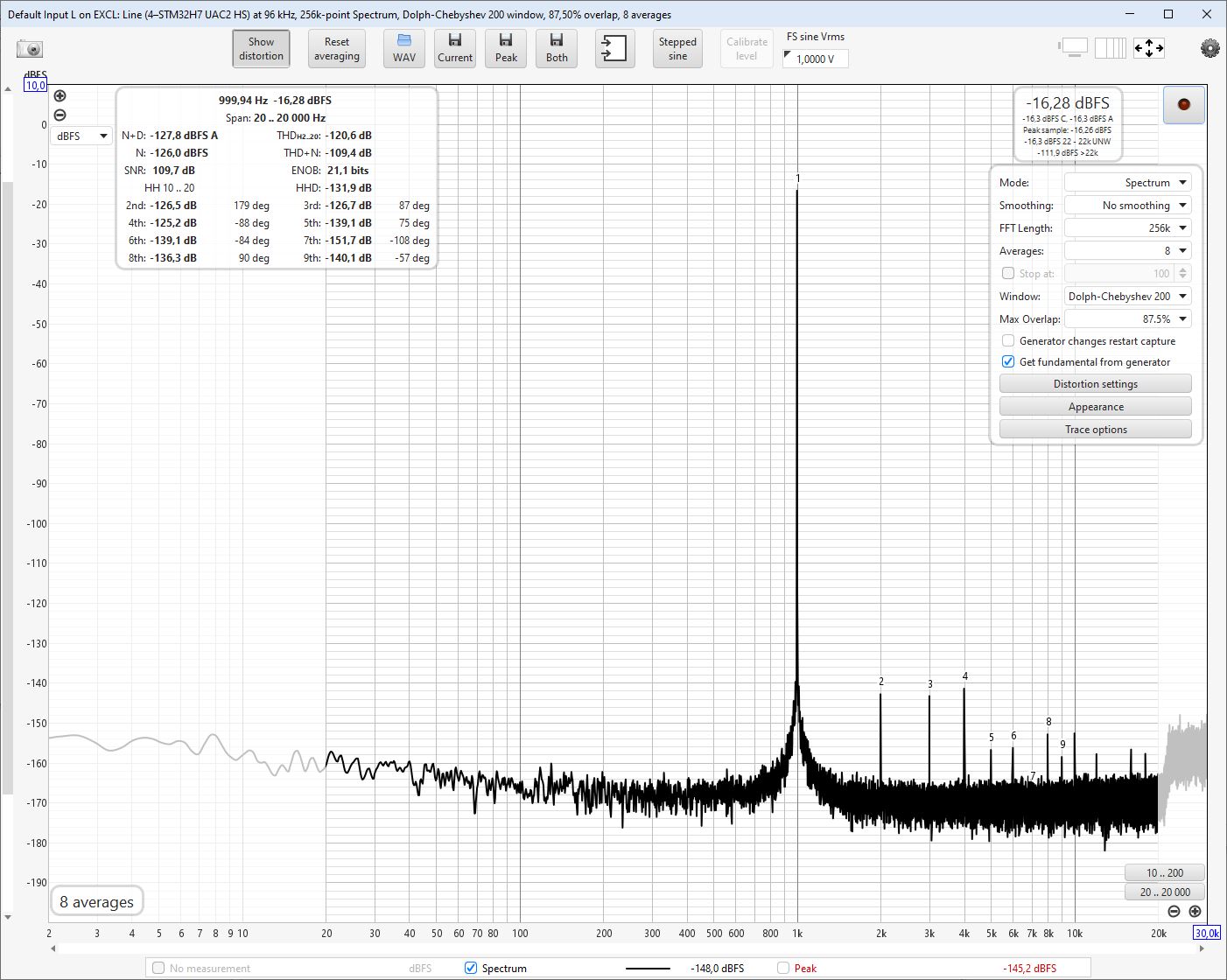

Here is 1k -3dBFS at 88.2kHz (ADC at 44k1).
I wonder how much of the distortions are in ADC vs DAC. Did you ever try to measure with a 1k notch filter?

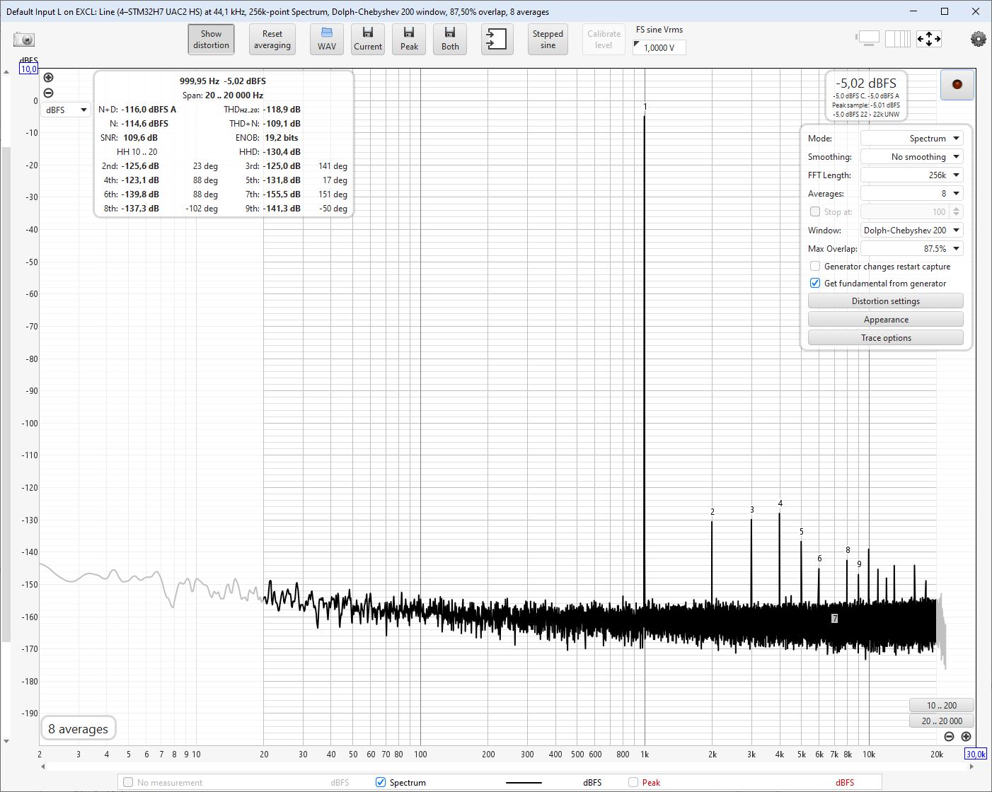

Just as a comparison here is same measurement with ES9038Q2M. So chain is: USB -> STM32F723 -> PCM2DSD -> ES9038Q2M mono -> Cosmos APU -> ES9822PRO.

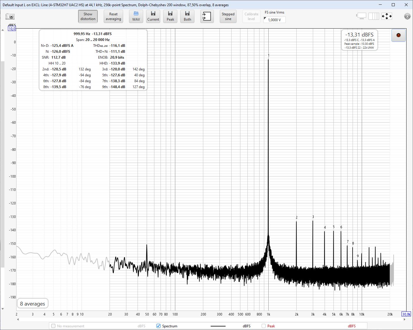

Returning back to RTZ here is a measurement at 0dBFS (with APU). SINAD of 111.1dB with pcm2dsd's DSD256 is slightly better than what I measured earlier with MultitoneAnalyzer's DoP128.

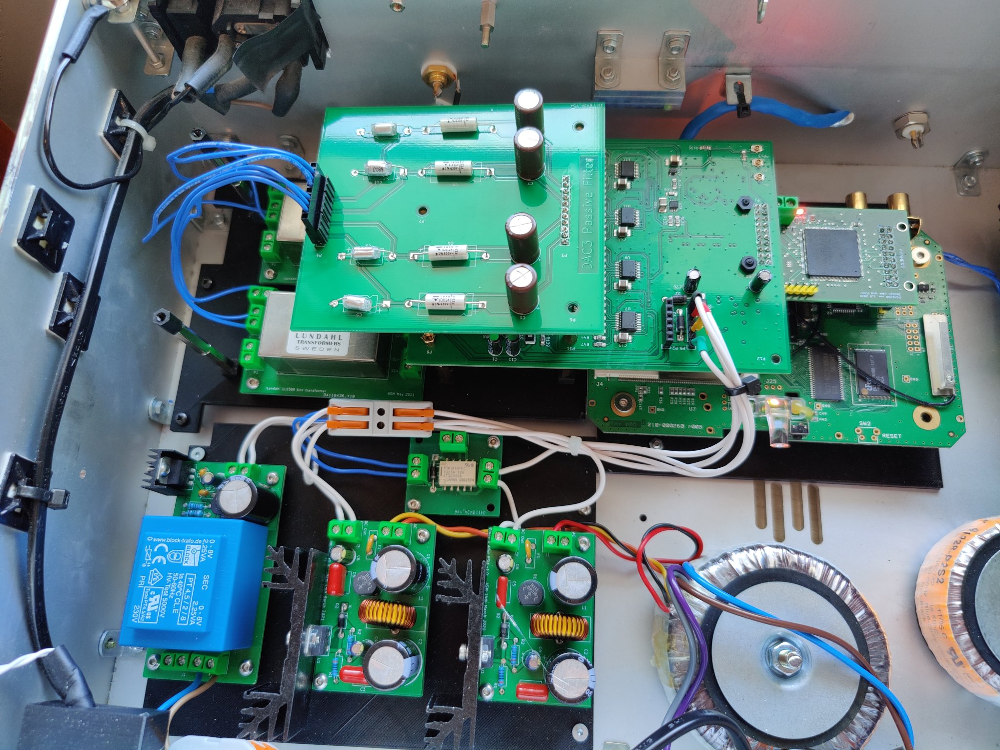

Presently I am using a SE Andrea Mori DSD dac as my main dac. Andrea has designed a discrete output stage board for it which IMHO sounds pretty darn good. There is also a power supply board for the output stage, and he makes another board to hold the power transformers for it. Its potentially a lot of stuff, although I am using my own power supplies and transformers. Could be the output stage would work with Marcel's dac. Probably have to ask Andrea about it.
Regarding the passive filter and DC removal that I have used, it relies in part the input transformers for my line amp for complete removal of RF. Regarding the filter itself, it may be a matter if trial and error to figure out what sounds best. Its not necessarily going to be silmic and or particular film caps. Usually the film bypass caps need to be quite small (~ .01uf) and they need to chosen to give a sound consistent with that of the electrolytic. By itself, its more of a DC blocking circuit with a small amount of EQ. There is still RF to integrate out, and it looks like Cestrian is also using transformers as a part of his circuitry.
EDIT: As an aside, from looking at the pic of Cestrian's dac, it appears the dac is using a shared ground for all the dac power supplies, +-15v and +5. As I explained when I was chronicling improvements to Marcel's dac by changing its surroundings, shared grounded of power supplies is one of the more harmful things that can be done when using off-board power supplies. Each of the three power supplies should be isolated from each other, with the grounds connected only at the load PCB. Otherwise there will digital crosstalk noise on every power rail at the dac board. IME any filter caps on the dac board typically do not fully mitigate the problem.
Similarly, using an Amanero without galvanic isolation (if anyone is), would be asking for ground loop troubles.
EDIT 2: IIRC, IME with Marcel's dac it was when I broke the final ground loop, the USB input ground, that SQ made a substantial improvement. Think I said it seemed like about 90-95% of the distortion/noise suddenly went away.

Yes, the grounds aren't starred to the DAC ground pin. I can easily make a test on one of my DACs and compare as they are both wired the same way and more of less the same layout.it appears he is using a shared ground for all the dac power supplies
Edit:
Having said that, this photo was prior to me splitting the +/-15v for the filter and DAC so in that case those grounds are now starred to the DAC ground pin. However the supplies to the DAC pcb are still using the shared ground line.
