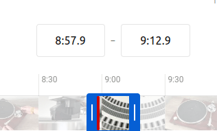

How do 'good' turntables perform under the strobe disk test? There is a reviewer here who does such a test and I have included a screenshot of the relevant attempted 'clip' from about 9:00 onwards. The strobe markings seem to 'pulse' forwards: is this detectable audibly?
Quartz- locked turntables do not seem to have this problem, in my recollection.
I know there is a thread covering this, quoted above, if there is a section in the thread covering this aspect of turntable speed analysis, I would appreciate it if a link could be provided.
