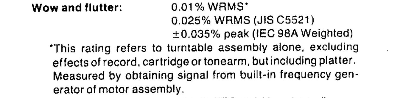

This is from a Technics owner's manual for an SL1200 mk II.
Good enough?
Good enough, however difficult to compare with other turntables, because for the only figure that is truly useful, the "peak" figure, they're using IEC 98A weighting while other manufacturers use the DIN method. Etc.
In any case, good enough not to worry about.
