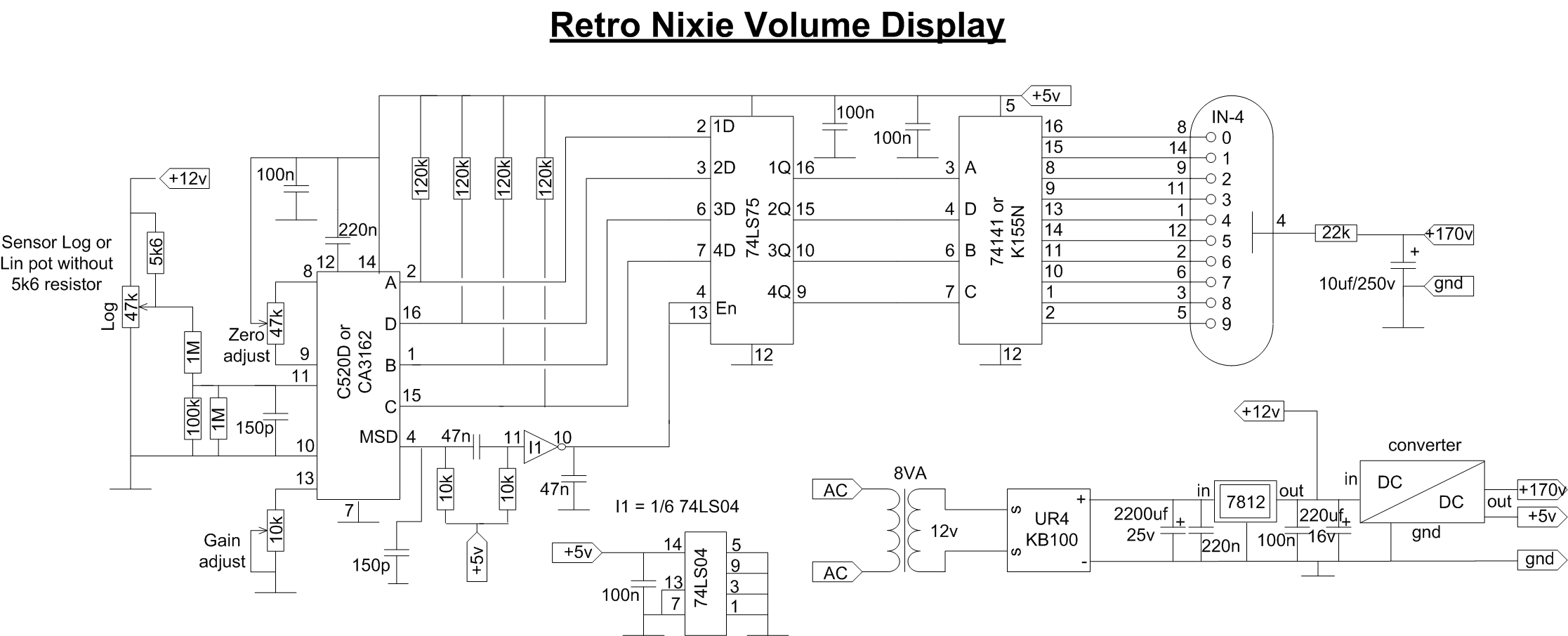

Steve,
you just need to use half of the schematic in post 1.
If you wish i can draw the schematic for you.
For the potmeter you can use lin or log type and any resistance.
So quad potmeters are possible.
Ronny
That would be grand! Yes, please, and especially mark that part of the circuit that is the 'volume control' doubled potentiometer itself.

Below schematic for one nixie version.

And yes the pot who indicates the position of the volume pot is connected as sensor. You can use also other value for sensor pot, like 22k, 47k or 100k. If you need 47k for stereo volume controll, you can use 47k quad potmeter.
With the 47k trimmer you can adjust zero position ( display 00 )And with the 10k pot you can adjust max position( display 99).
Ronny
