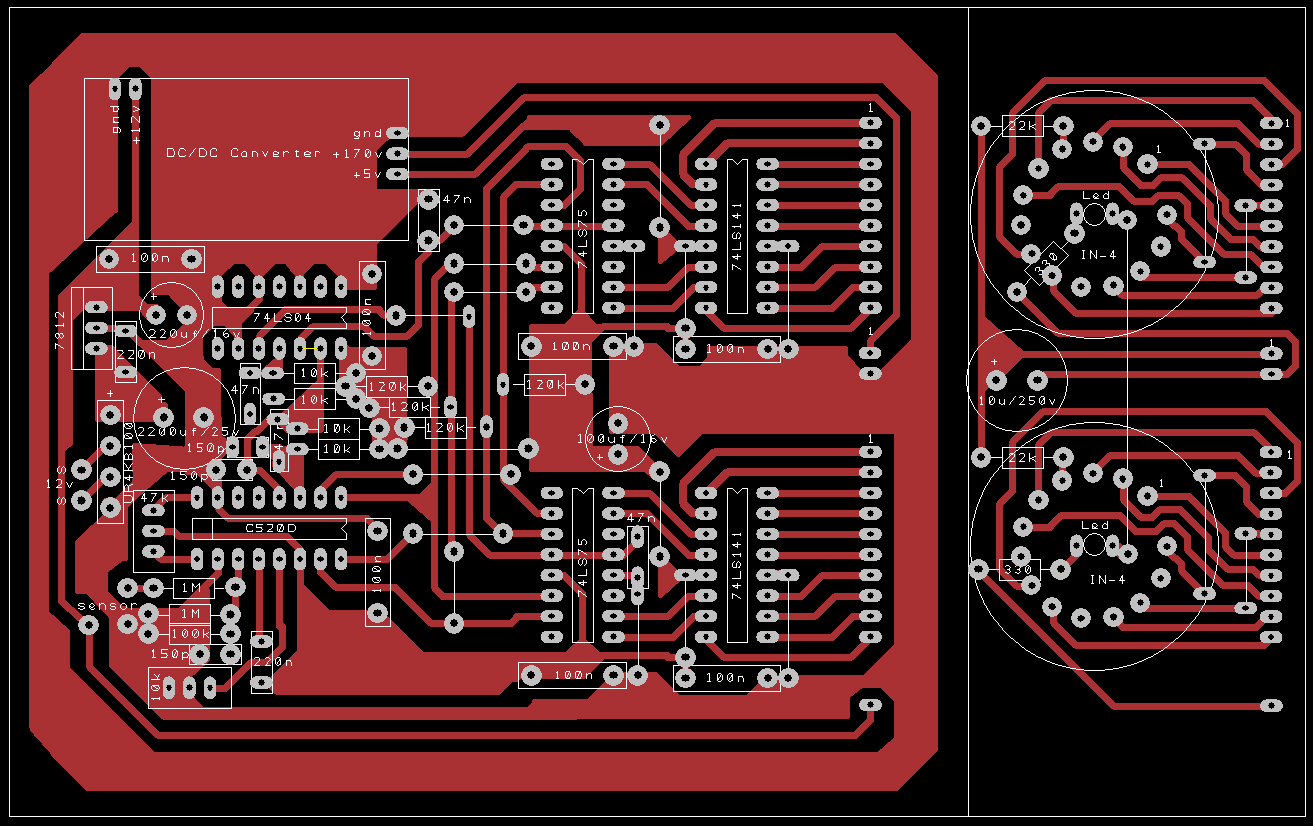

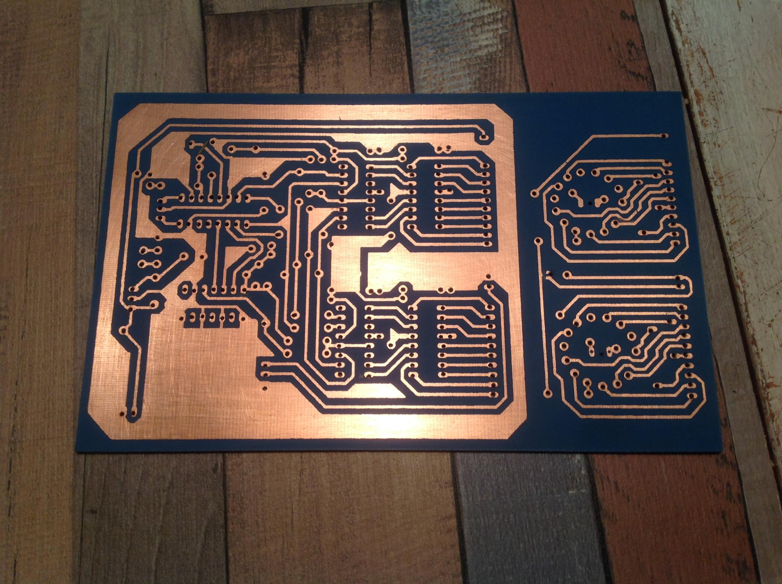

Today made the pcb design. I shall test it next week.
nice layout!

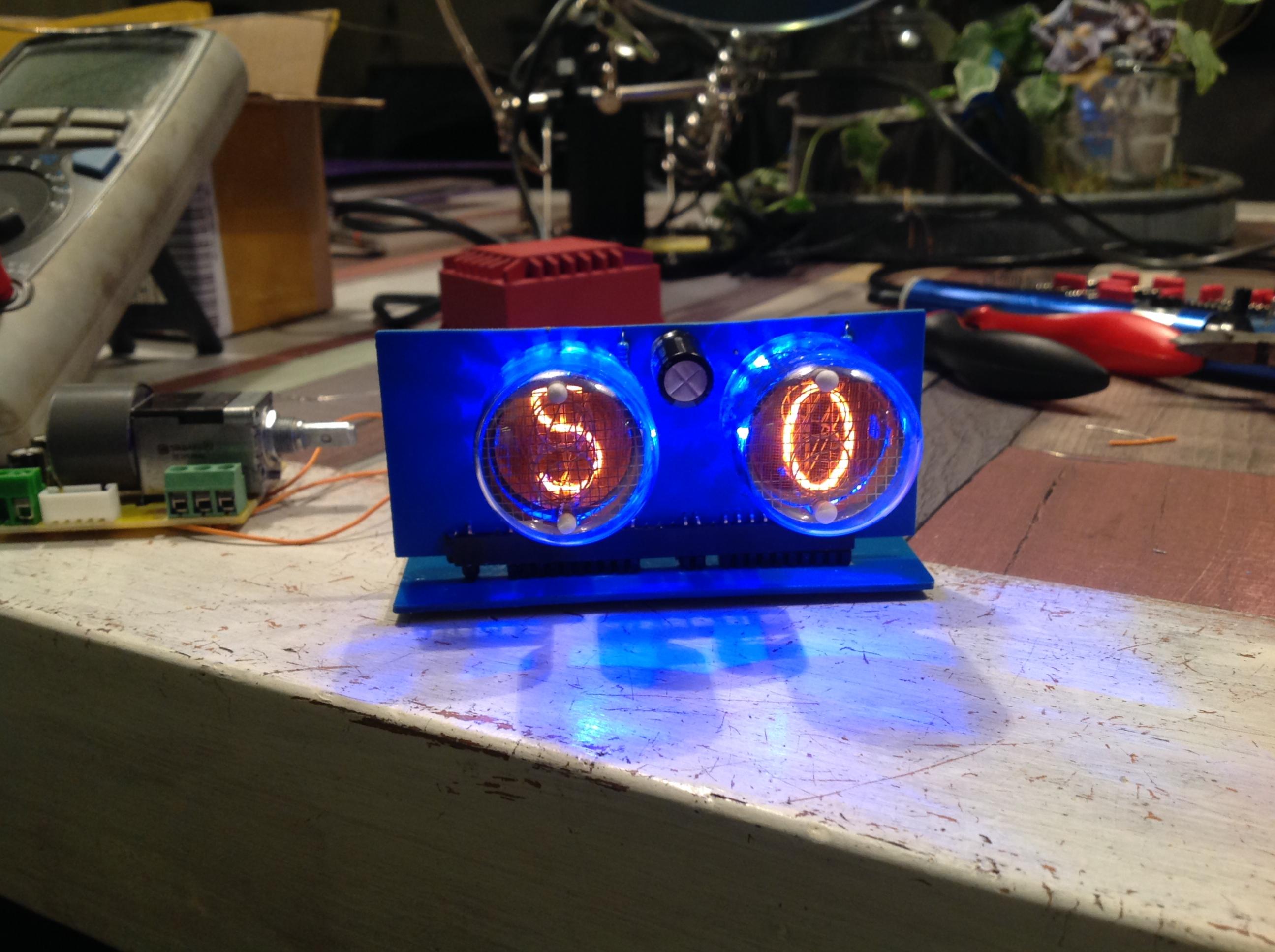

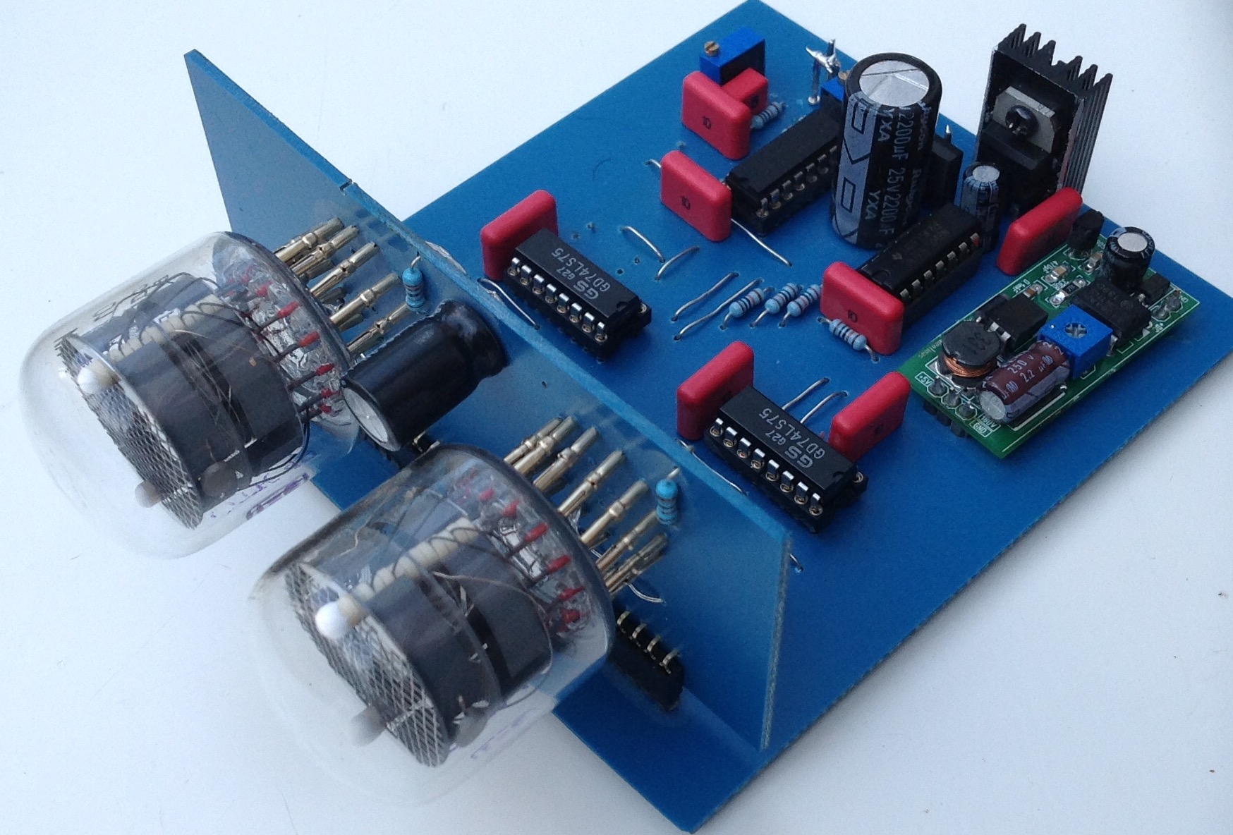

This evening completed the second tryout and it works.
See on youtube:
https://youtu.be/FfgYGh3b0X0
Pcb and schematic as build will follow soon.

You can think of a lot of extra options when using a microcontroller.
For me just a volume display is enough. And designing and building this thing within a month is not possible for me when using a microcontroller. Then first i must learn the programming for the microcontroller and possible solder smd.
And using a switching supply is already a gamble because the preamp has also a phone preamp. A microcontroller is then a second source to worry about regarding HF radiation.

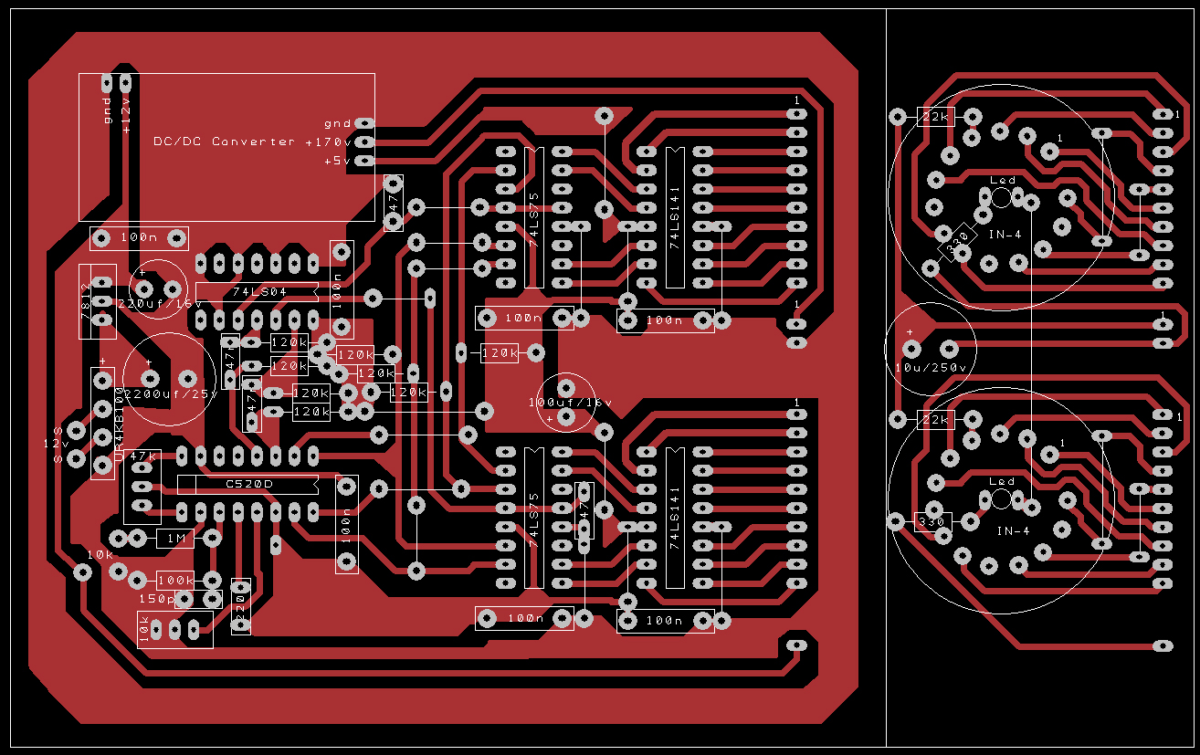

PCB
Bottleful idea and I would love to build one for myself. Is it any way to get PCB design in Graber format. I have very positive experience with DirtyPCB.com and if it is inside of 10cm by 10cm then it will be $24 with the shipment for 10-12 PCBs. Please let me know.
As Build.
