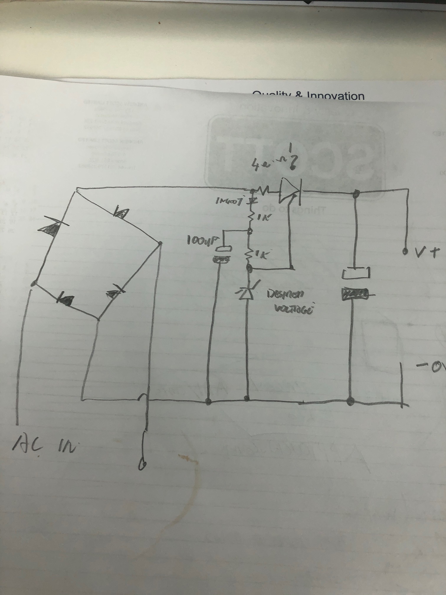

Exactly. A simple, quick, elegant, engineering hack that solves the speaker protection problem for a few pennies in a few minutes. Perfect! 😀Turn it up too loud and smoke comes out and the sound quits.
-Gnobuddy
That’s a pseudo-split supply amplifier where ground floats - similar to classic QSC but with a discrete front end instead of an op amp. The output is effectively capacitively coupled if that center connection between the 2 caps is not connected to the transformer center tap. They do work, and are quite bulletproof. The only caveat is that multiple channels cannot share power supplies. At all. Separate secondaries on the same core can be used, but with some crosstalk. Bifilar windings should not be used - if you use a toroid they should be wound separately. Separate transformers is of course the best option. For a single channel, like a powered loudspeaker, they are a great choice.

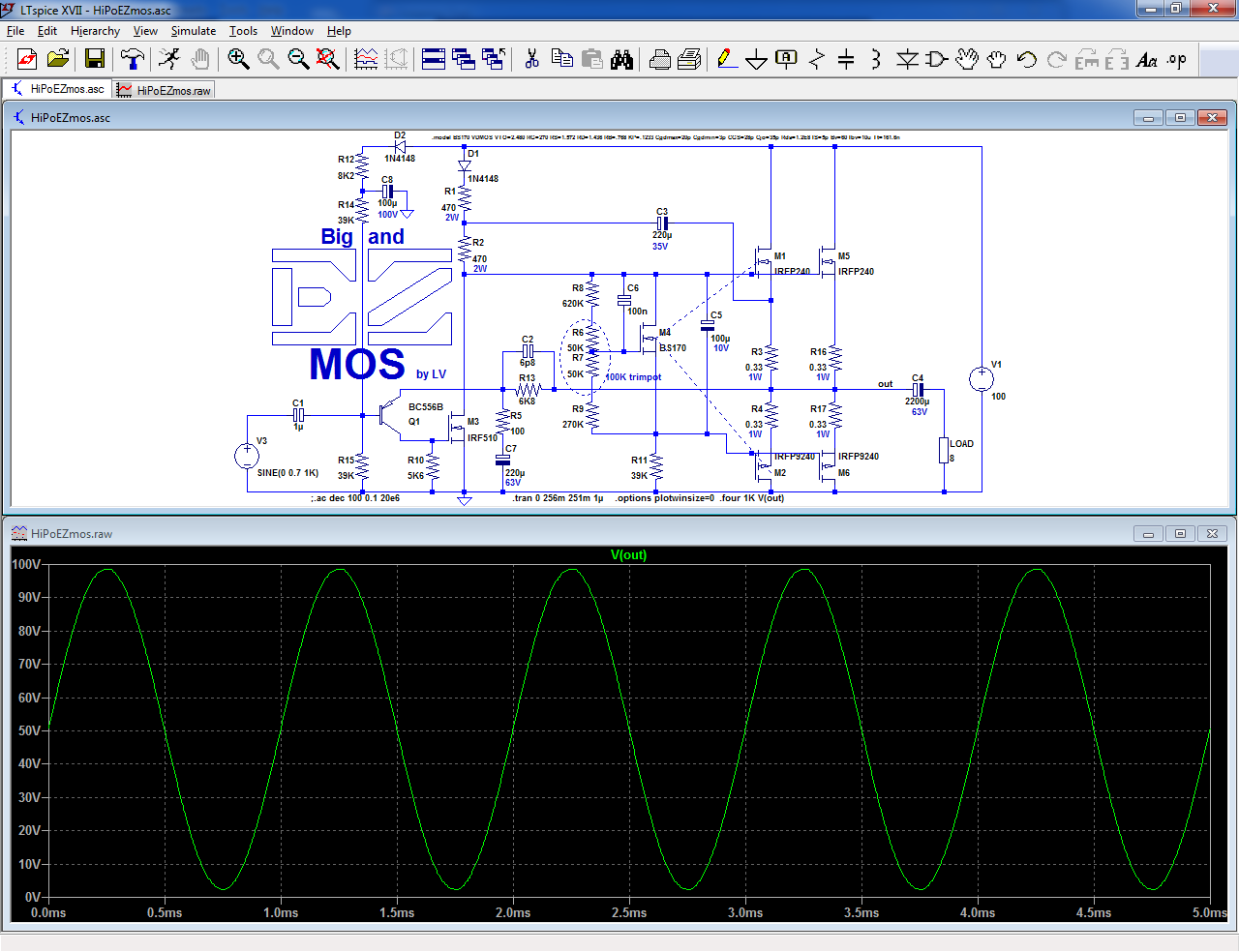

Looking at the sine waves, it doesn't look "perfect" to me.
Ye, clipping is not perfect, under clipping is almost everything perfect. You cannot expect total symmetrical and clean clipping from single ended and ac coupled stage.
Thanks for the insight. That's a problem I had completely ignored when I planned to use a 50+50VAC wound toroidal transformer in a small stereo amplifier recently. It was a bargain but now I'll have to rethink that whole idea........ Bifilar windings should not be used - if you use a toroid they should be wound separately. Separate transformers is of course the best option. For a single channel, like a powered loudspeaker, they are a great choice.
The differential voltages between adjacent turns can get high, and the windings are tightly coupled both inductively and capacitively. Signal will spill over from one power supply to the other, and you can even arc between secondaries. I’m pretty sure the toroids used in the QSC RMX amps have two sets of bifilar windings - separated from one another by an electrostatic shied. The older ones in the USA series used UI cores with half the primary and one secondary on each side.

Thanks wgski for pointing out problem with tiefbassuebert "disconnect the center tap from ground & double the rail cap voltage" DC protection scheme. 2 transformers required for stereo.

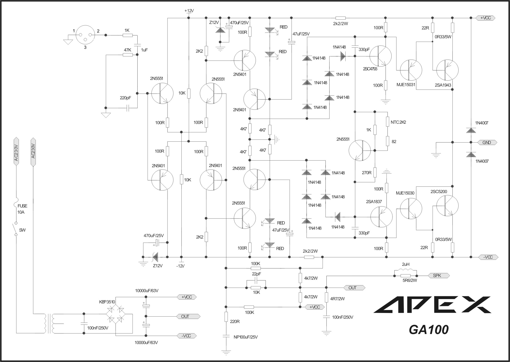

Think apex GA100 with one 2sa1943/2sc5200 is in serious soa danger at 113 vdc. OTOH with mje15030/31 drivers, with a heatsink, 2 pairs OT is possible. Since it is a triple, changing drivers to MJL4302/4281 with heatsink, and predrivers to something TO220 with a heatsink, could drive 3 or 4 pairs OT. 2n5401/5551 doing the VAS could be upgraded to TO18 transistors with heat sinks too, and the 100 ohm collector resistors dropped to 82 or so for more drive current. Newark is keeping around one 10 W TO18 pnp and npn most of the time, multicomp copies of something real.
Actually could hot rod my AX6 to more than 5 seconds 72 watts with two or three pairs outputs. The VAS is a GE D44R4 TO220 with heatsink, and the drivers are mje15028/29 with heat sinks. So the main reason I don't do it is no room in the chassis for more OT heat sink.
Simply using four 5200/1943 pairs would be enough to make it robust. Upgrading the drivers to NJW0281/0302 would be nice as well. You don’t need to add much more to it than that.
The original DC300A (same power supply voltage) used 4 pairs of 3773, later changed up to 2N5631 in newer rev’s, and you could beat the snot out of it.

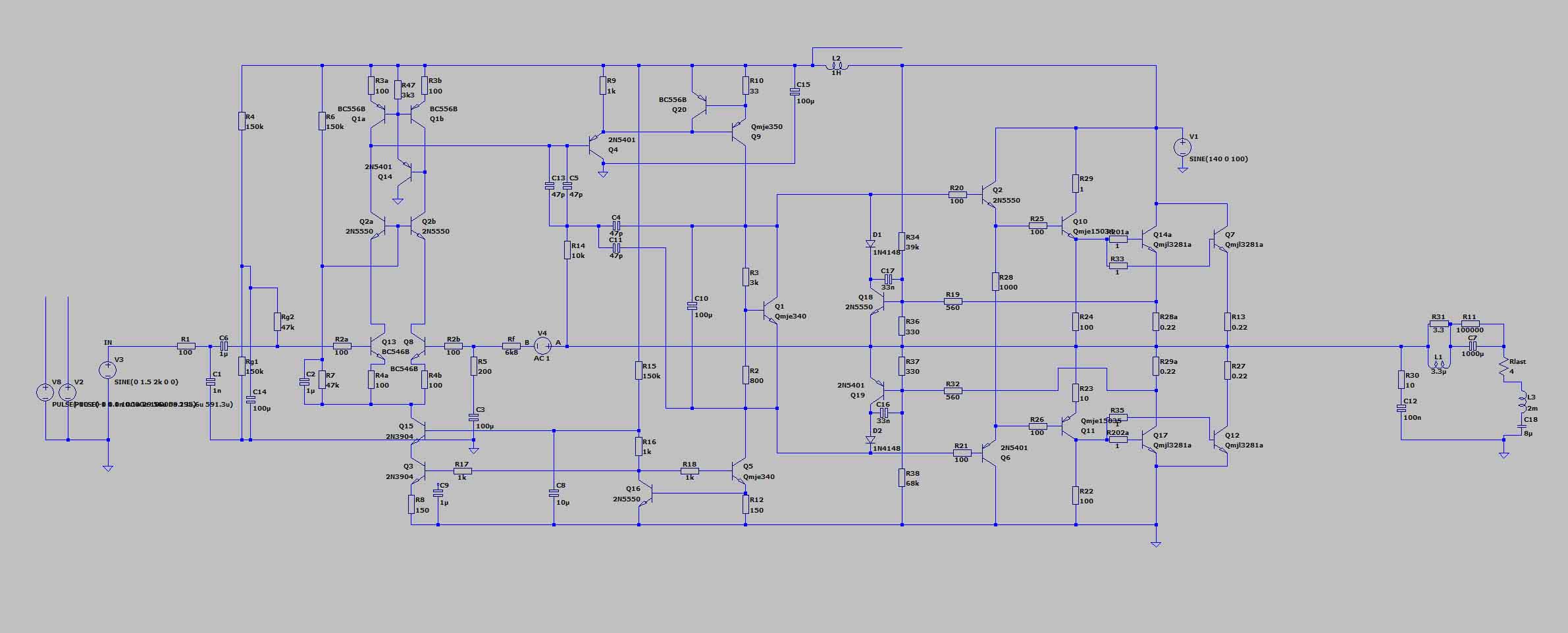

My 50cent on an single supply amp. Its not really retro - or is it. Why I want a single supply amp? Well as I am also building an active subwoofer with a series cap to interact with the woofer, why not let the cap be part of the amp... And of course, also for curiosity and learning.
So any comments and improvements from your side? Would love to here your opinion. At the moment is simulates pretty well.
