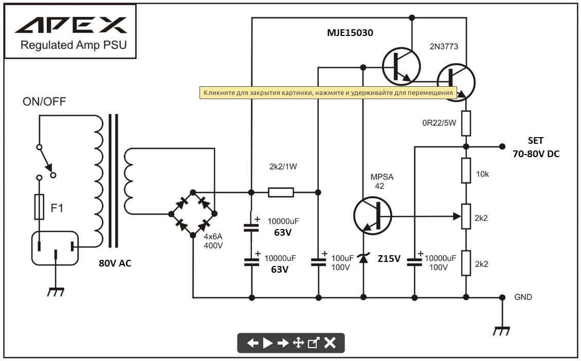

Can i use this simple power supply with an 80VAC transformer to power the AX6 without changes?
Changes for 80V AC input.

The circuit is fatally flawed in several ways; the worst flaw is that the 2N3773 will most like burn out instantly when the circuit is first powered up.
This will happen because the output is loaded with a 10,000 uF capacitor, which is fully discharged at turn-on, and acts like a short-circuit straight across the output at that first instant after turn-on.
There is no current-limit protection circuitry, so the 2N3773 has nothing to limit current through it except the tiny 0.22 ohm resistor connected to its emitter.
The output from the bridge rectifier will be about 110 volts; the 0.22 ohm resistor will therefore limit current to 500 amps. Result, the 2N3773 will burn out immediately when the circuit is turned on. :eek:
Most likely, depending on whether the base-emitter junction of the 2N3773 fails open or shorted, the MJE15030 will also burn out a millisecond after the 2N3773.
A high-power linear regulator is a very bad idea to start with, as Kay Pirinha politely pointed out. This particular circuit is even worse, as it will fail immediately due to overcurrent, even before it even has time to fail by overheating. :D
-Gnobuddy
Fold-back current limiting could (should) be added. And probably two 3773 in parallel.
The 10,000 uf would be needed so you do to have to set the current limit at 3X just to keep it from tripping on every cycle. And you want a back biased diode across the power transistor to keep from blowing it with the output cap charge if the input voltage collapses.

I use a 3300 uf capacitor. For 2 boards. Got 72 watts into 8 ohms out of each simultaneous for 5 seconds on Rhianna Shut Up & Drive.
I also use 5 parallel TIP147 to regulate from 75 v to 69, with .5 ohm emitter resistors for sharing. The heat sink is 30mmx 50 mm x 130 mm off a dead Pentium 2 mainboard.
