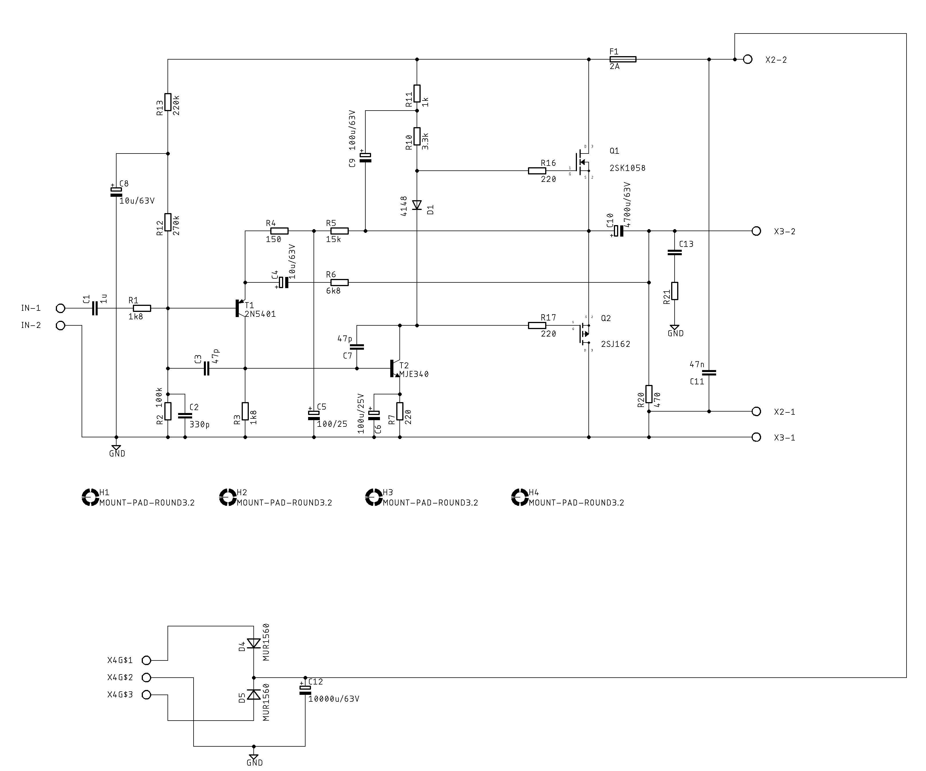

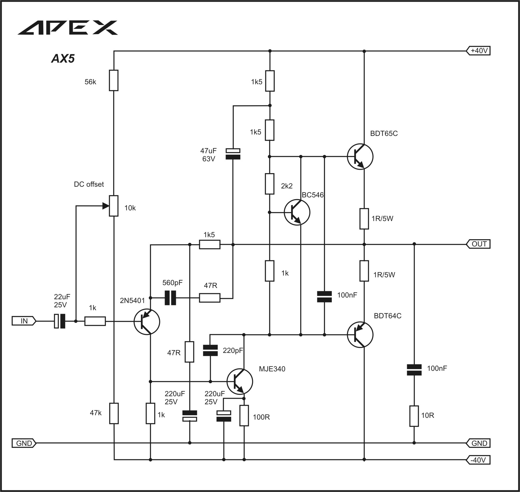

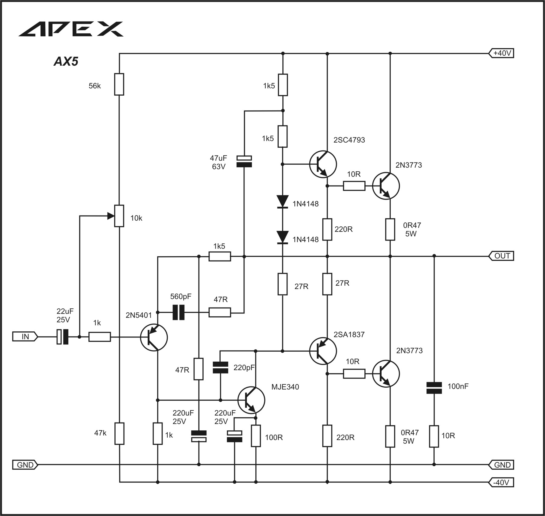

Nice, many thanks apexaudio. I will try the circuit soon. And what do you think of it's possible quality compared to the old circuit by Robert Penfold posted a few pages back? I've wanted to remove the output cap by using split power supply. Could you please provide such circuit with single ended input and split power supply?
BTW, what is the voltage supply range?
AX5 CFA amplifier, AX6, AX8 and FX4 supply range is from 50V to 80V DC.

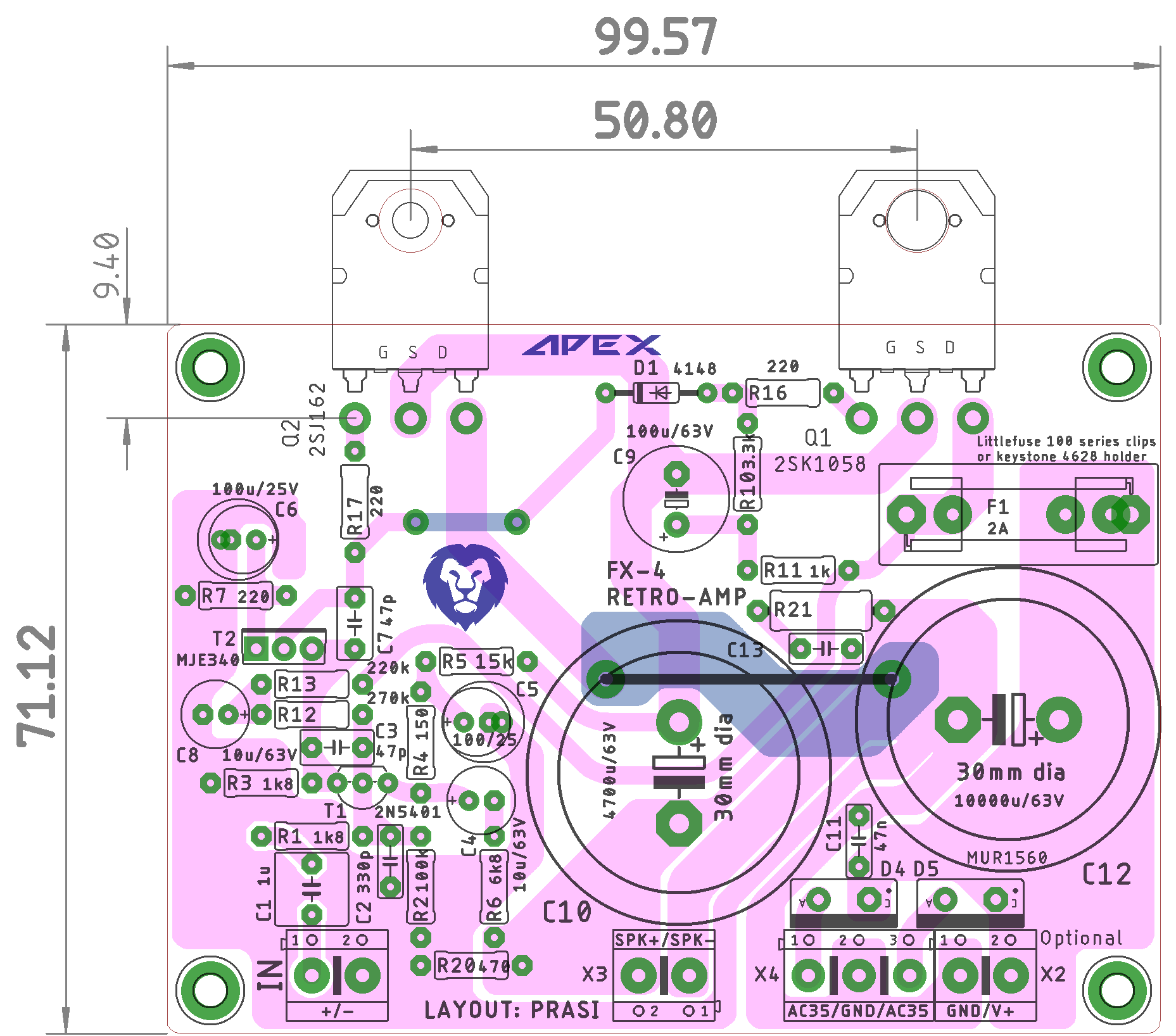

PS Here is a somewhat better looking FX-4🙂, although I very much doubt there will be any interest because of the cost and vanishing act of laterals .

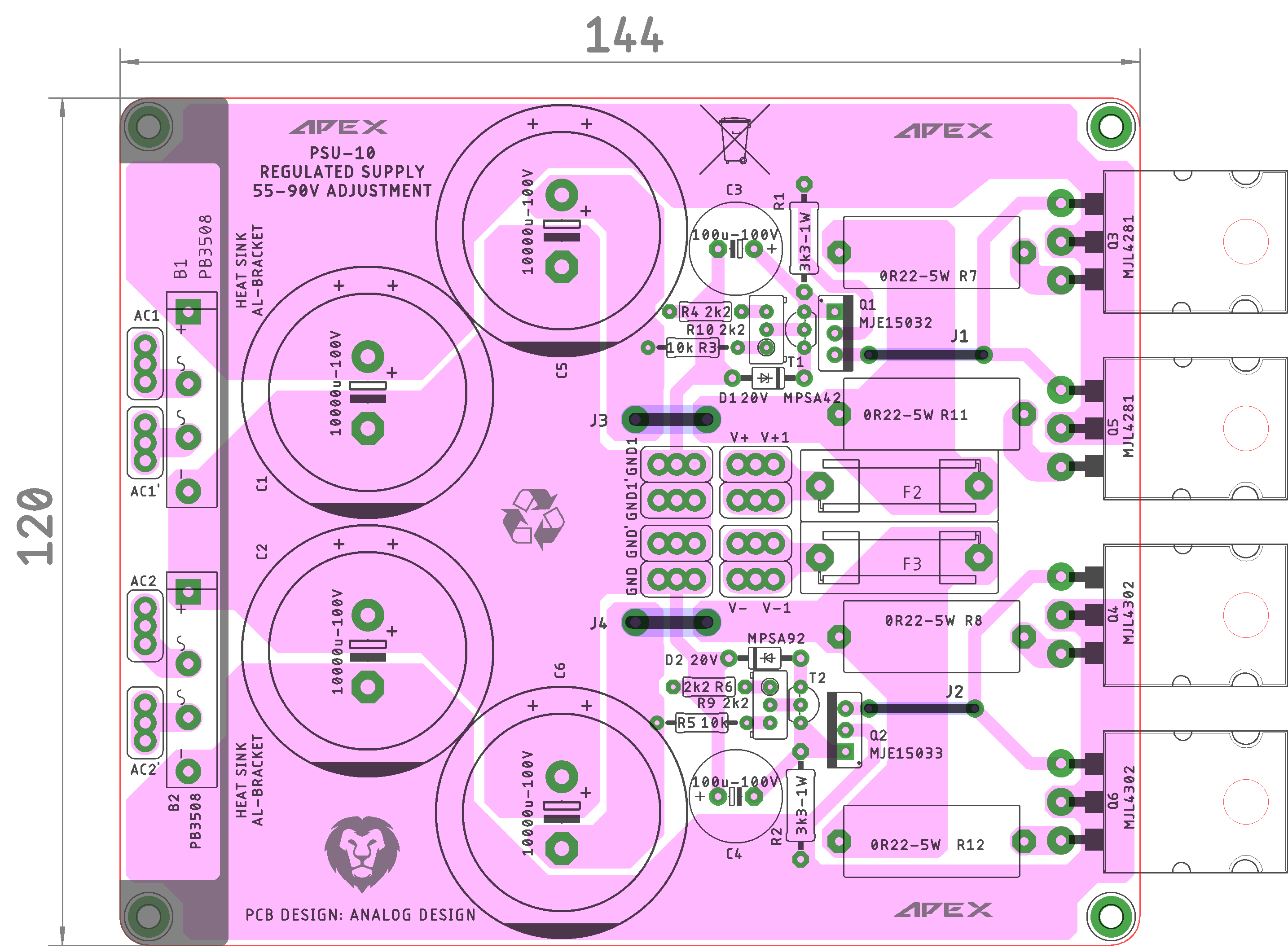

Prasi these PSU designs look great. I would love to have a test bench PSU that is versatile enough to adjust for many different amp voltages, maybe even current adjust. Investing in a good PSU would really help with other projects down the track. What do you think? Would the psu10 be the one? Im wondering also what the voltage range would be?

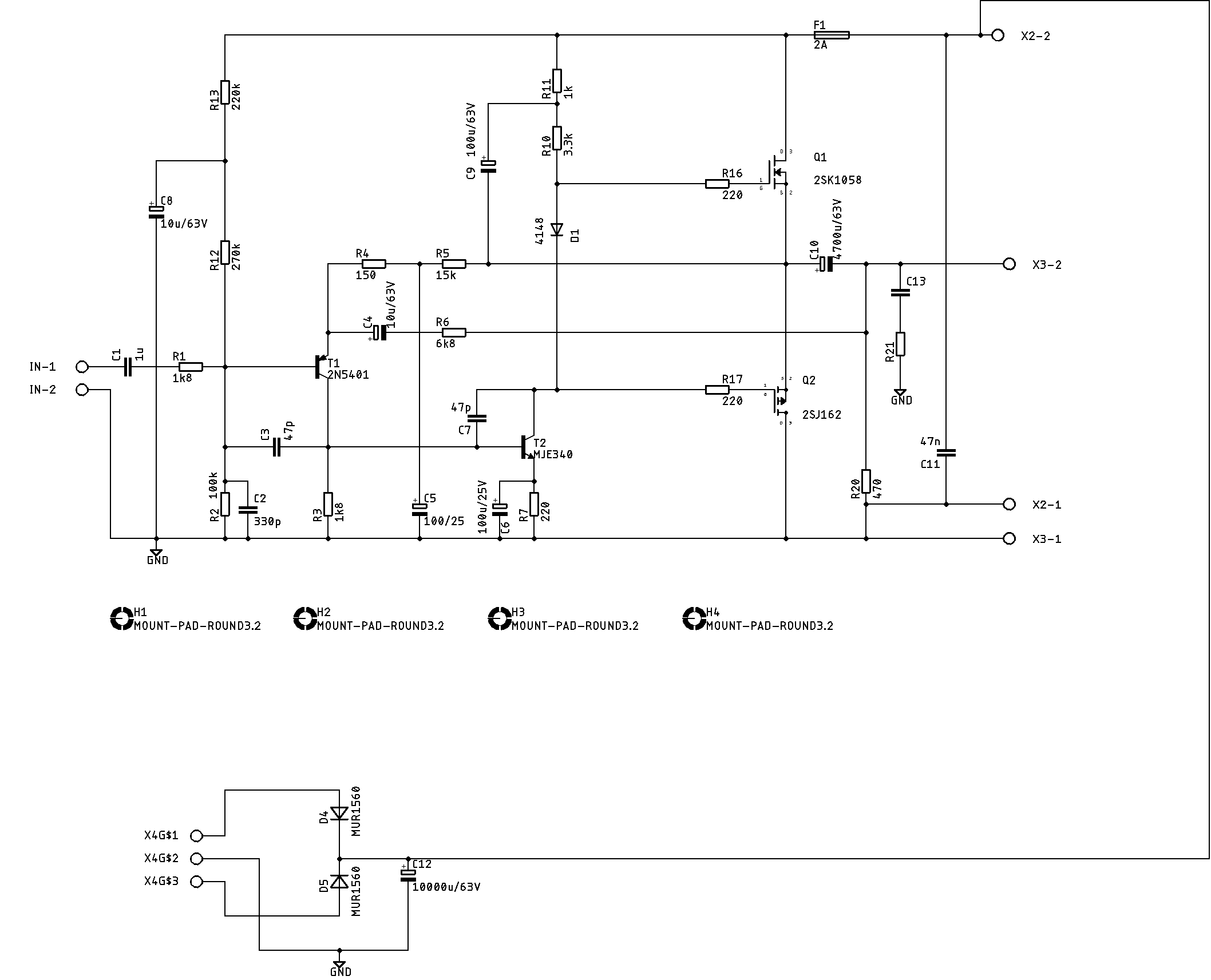

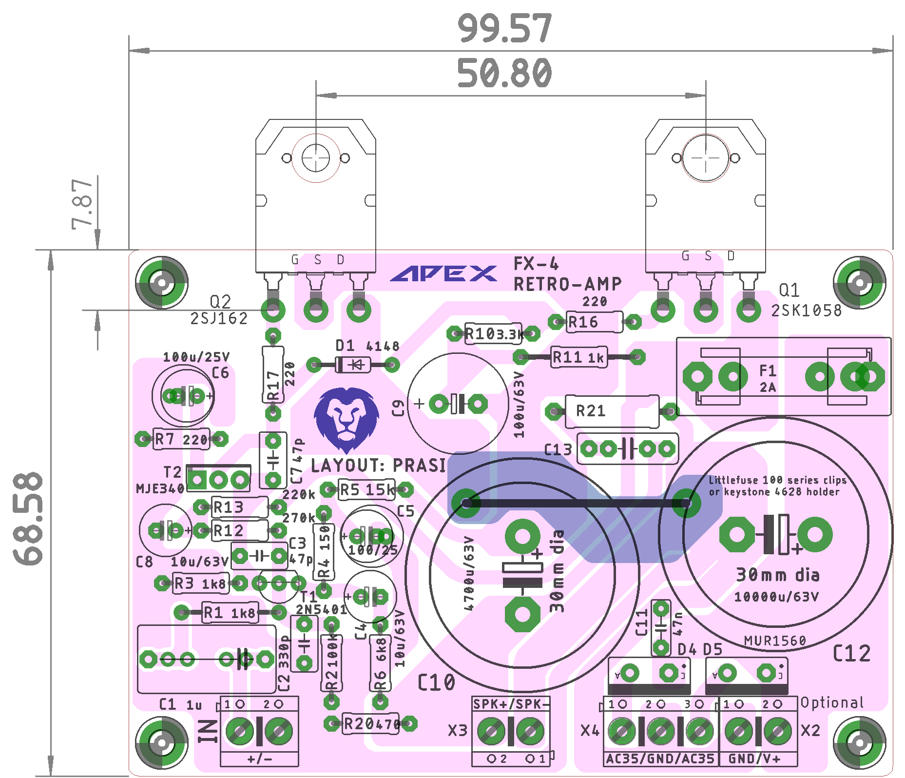

Hi Prasi,
Would love to build FX-4. Much appreciated if you can provide pdf layout.
Thanks,
Hi Prasi,
Thanks,

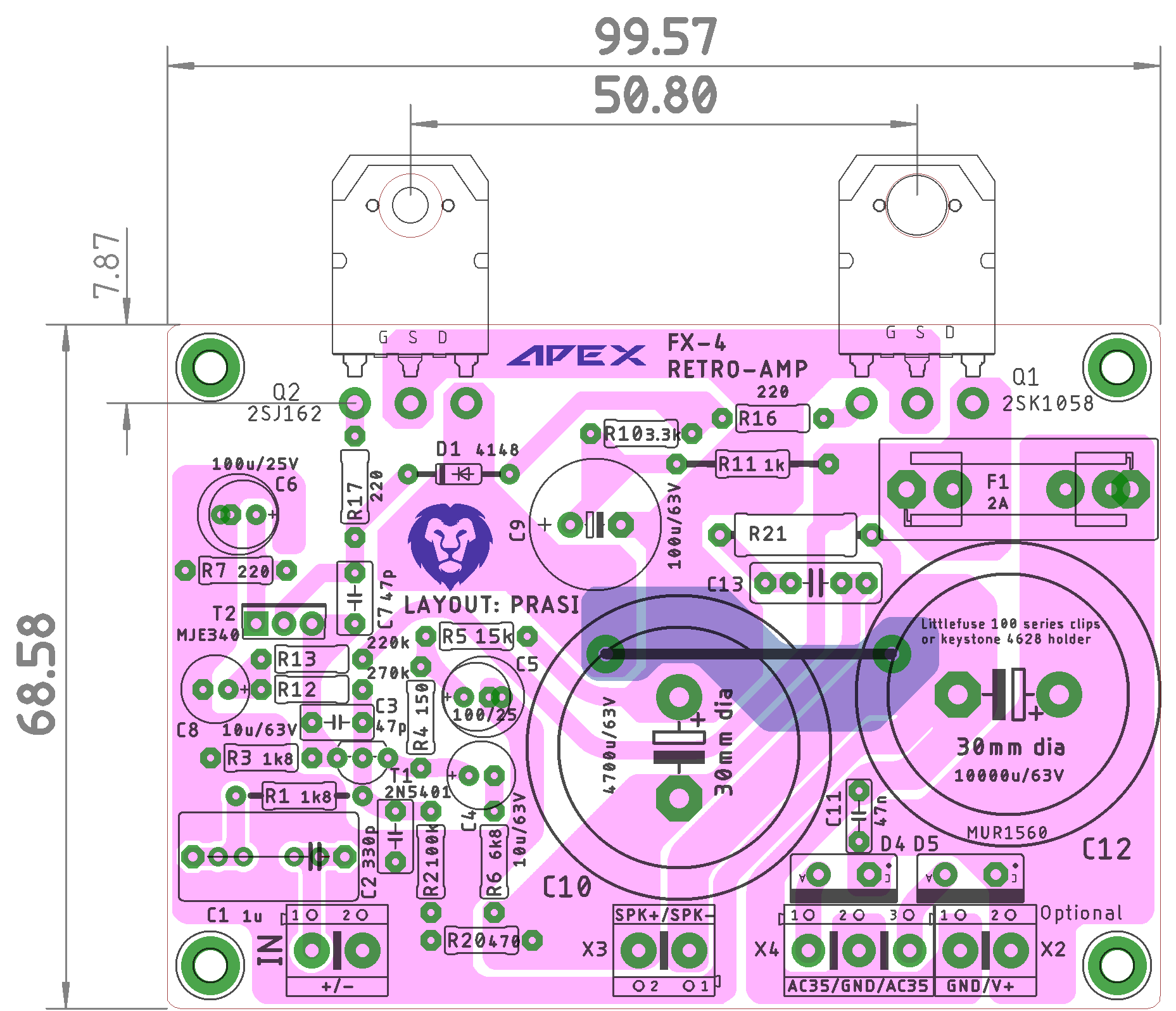

Hello Boyet,
Here are the files. All the best for your build. Do post here when you build and test it.
regards
prasi
  • FX-4 Files.pdf
    FX-4 Files.pdf

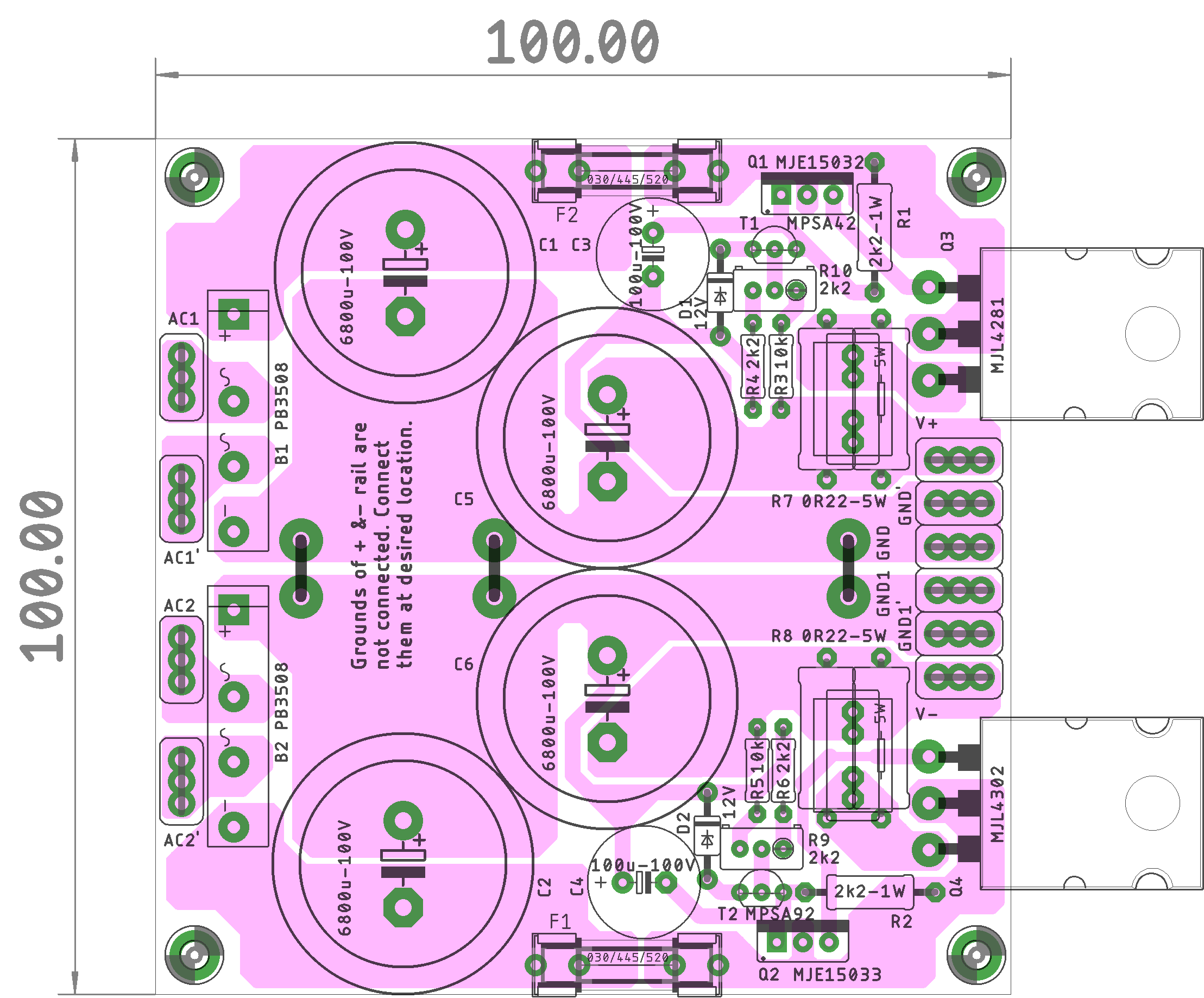

Mr. Mile,
I wanted to fit the dual rail PSU 5 in 100mm x 100mm for chinese pcbs. So here it is. Its beautiful isnt it?😉
However I could only fit 30mm dia caps, which makes it 6800uf 80V or 4700uf 100V. Some 10000uF in 63 V also available .
So my question is , whether 6800uF is ok or too low?
regards
Prasi

2- pair regulated PSU.....tedious, took a long long time :bigeyes::bigeyes::bored::bored: .. tired with making layouts, time to get on to building things...the pending projects need attention (long list....AX-6, Pass HPA-1, LM317+keantoken KMX, AKSA 55, AKSA 55N, JLH2003+B1 buffer, APEX AA9, APEX AX-14, many more)...
