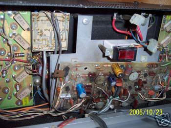

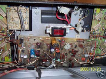

Exactly. Some differences but really its the same amp. Here is a peek in the DC300A II. There is the new IOC circuit added and a few component changes on the driver board. Also a few parts were cleaned up from the output board to the speaker terminals.
Other than that it looks itdentical to me. The DC300A's driver board kinda has two star ground areas connected by a link and the DC300A II has a better ground layout with one main ground star. This shifts the components around when you compare the two PCB's but don't let that fool you. Also, the DC300A has additional components to handle higher speed output transistors. I can't see much more difference.
IMO they are almost identical all but a few improvements over an existing design.

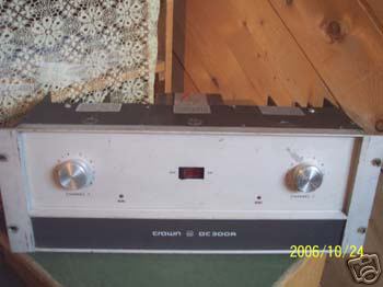

Can you show some pics of the inside of one of your DC300A II's? I'm even more intrigued to learn the differences. Here is a pic of the face of the above, obviously a late model DC300A. Oops. 🙁

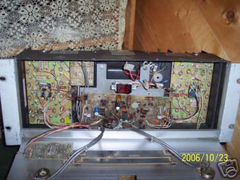

I just had to see...so I kept looking on the ol Google and I dug up a few glimpses into a DC300A II ...as I said before, its the same amp with a few tweaks and a new face. Unless someone took the face plate off an older model and threw on a version II?
