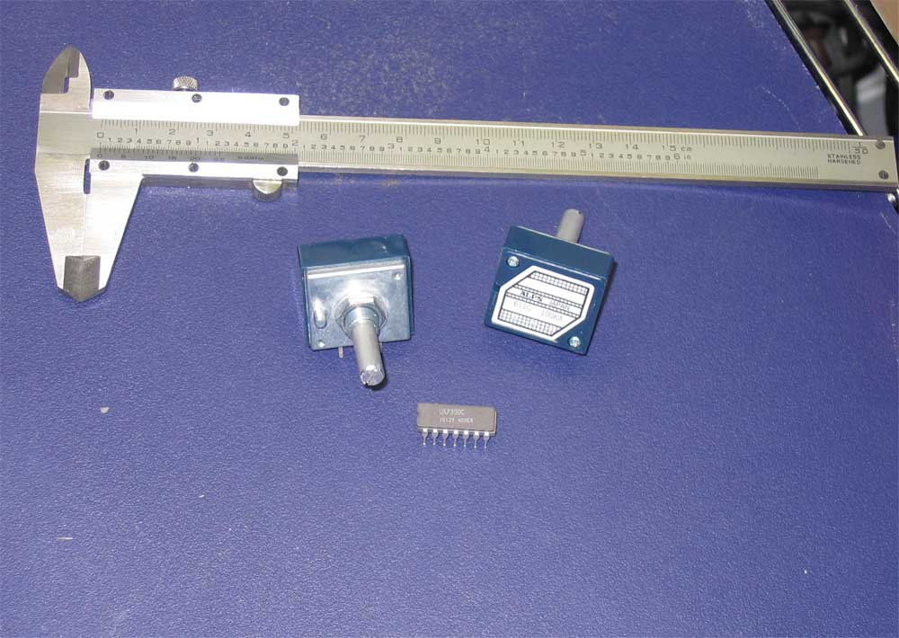

anatech said:Hi Shawn,
Nice controls. It's also good to see those reliable op amps.
-Chris
The alps pots are ok but these are junk compared to the other products they make. Still they were almost $50 including delivery! I think I was ripped-off. The Canadian dollar needs some more weight. 😉
The opamp is marked:
UA739DC
FB127 Korea
Any takers on who made it and when?
Shawn.
That would be Fairchild and probably about August 1981....could be '91 but less likely 😉
There are MUCH better modern alternatives available but you would need to make up an 8 to 14 pin adapter.
