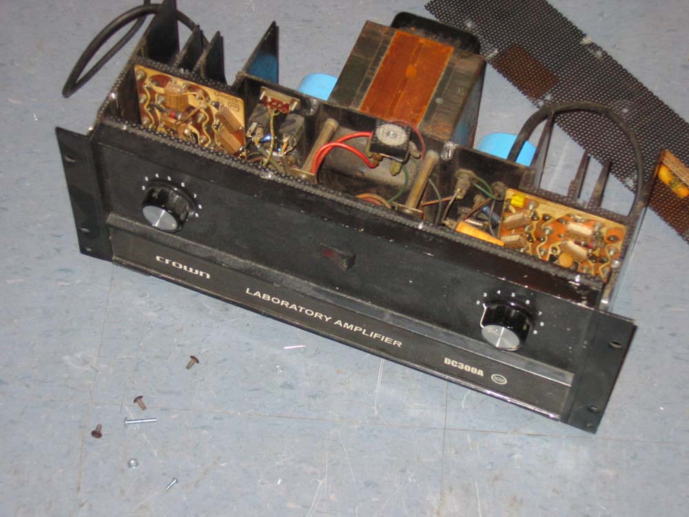

I started here:

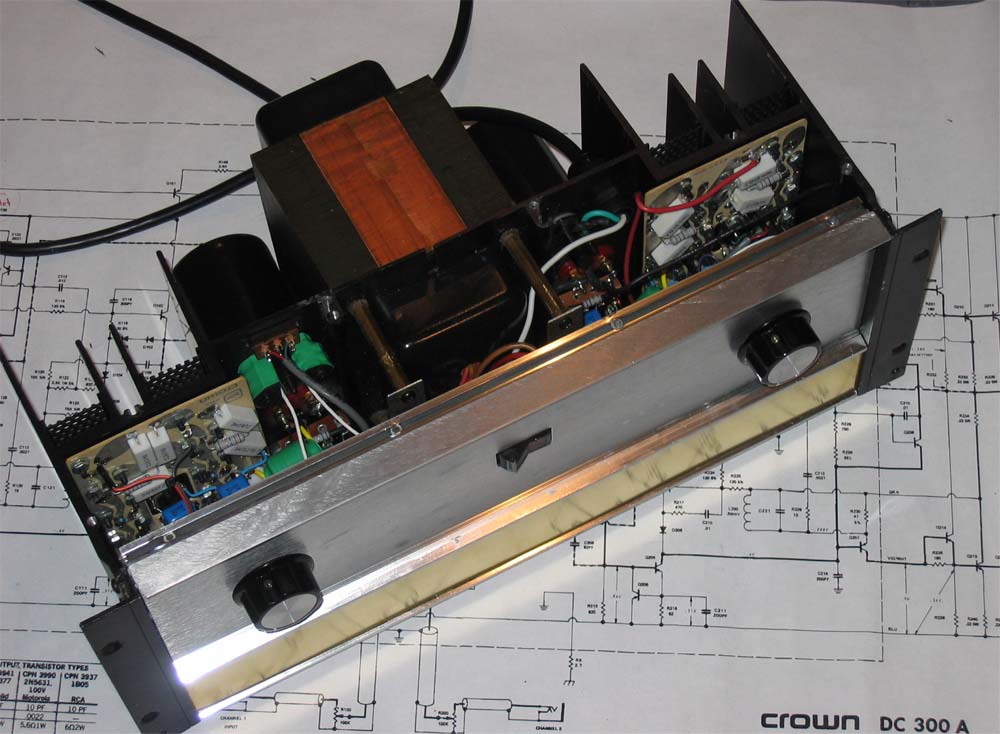

Fixes
Thanks again to Joe. I followed the documentation you provided and installed the anti-pop and anti-squeal mods and the start up and shut down noises are barely audible.
Also there was the compensation circuit changes to handle faster output devices. I made those mods to the amp as well.

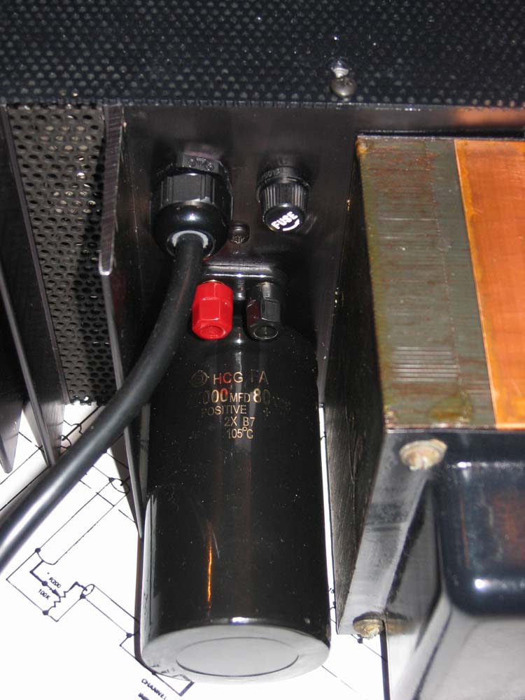

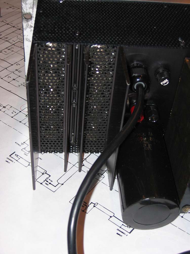

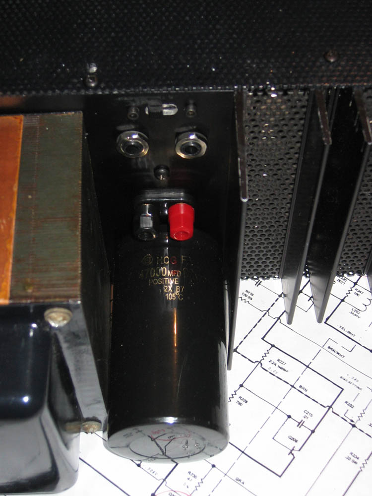

The power supply caps from Apex Jr. were a shoe-in replacement to the old ones. 2 X 17,000uF has been upgraded to 2 X 47,000uF!
I modified the driver board to allow the use of 100K volume pots and I purchased some decent Alps pots on line.
After I completed the final modifications I made adjustments to the bias circuitry and some cool stuff occurred. R109 and 209 turned out to measure within 1 ohm of each other. Also the input and output offset pots are in the exact same location for the left and right channels. This really means nothing but to me it shows the precision of using tight tolerance devices.
Perhaps tonight I will crank it up a little.😀
Shawn.
