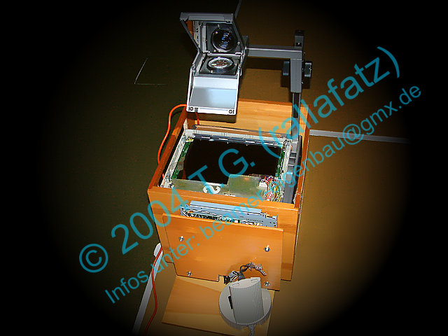

New Pics and results...
My New Setup (wooden box with wheels for better movement and better shape).
see http://people.freenet.de/rallafatz/Beamerbau/thumbnails.html
New projects are in progress.
