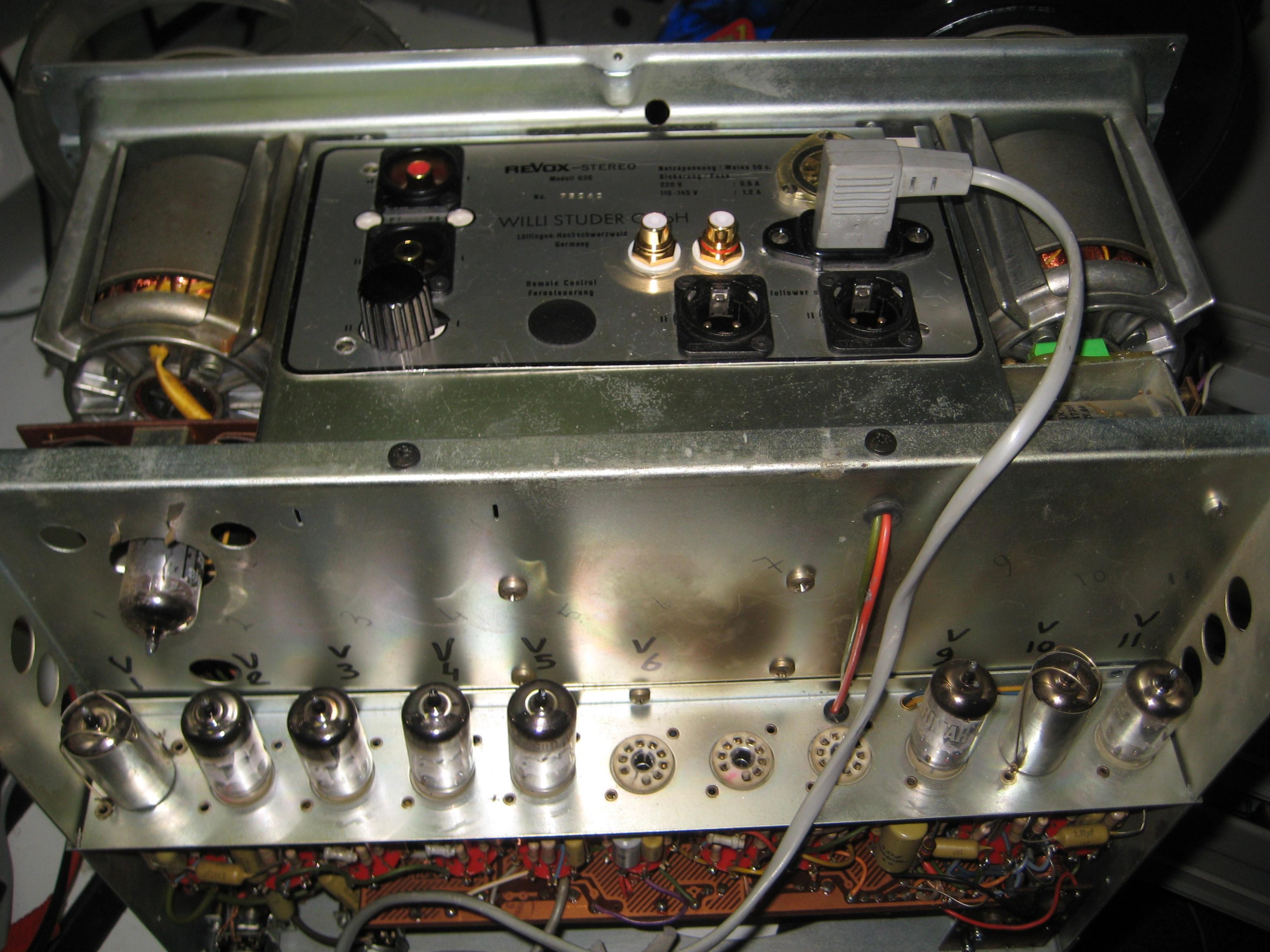

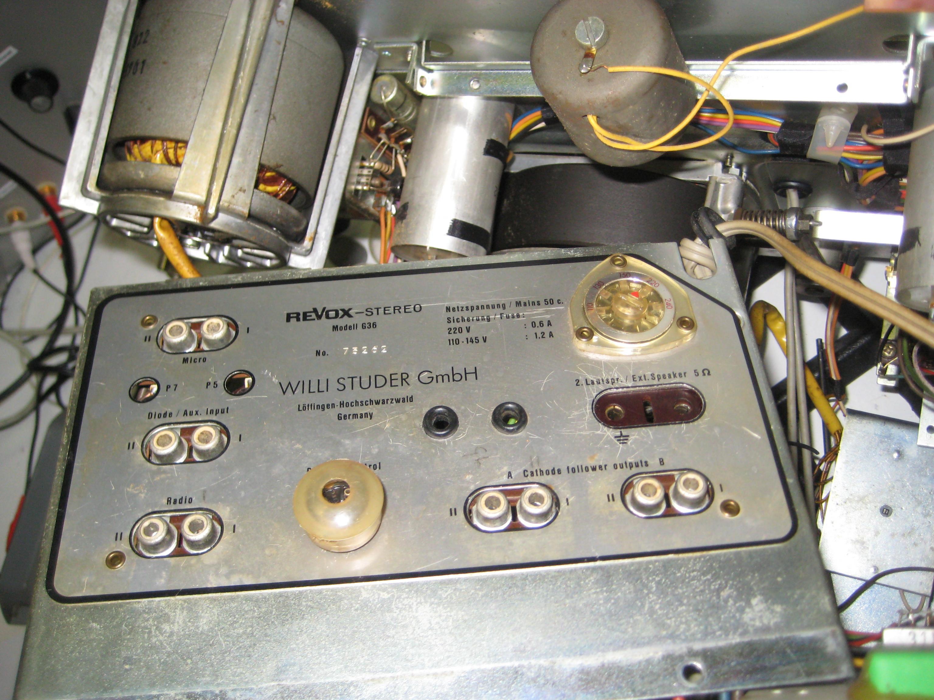

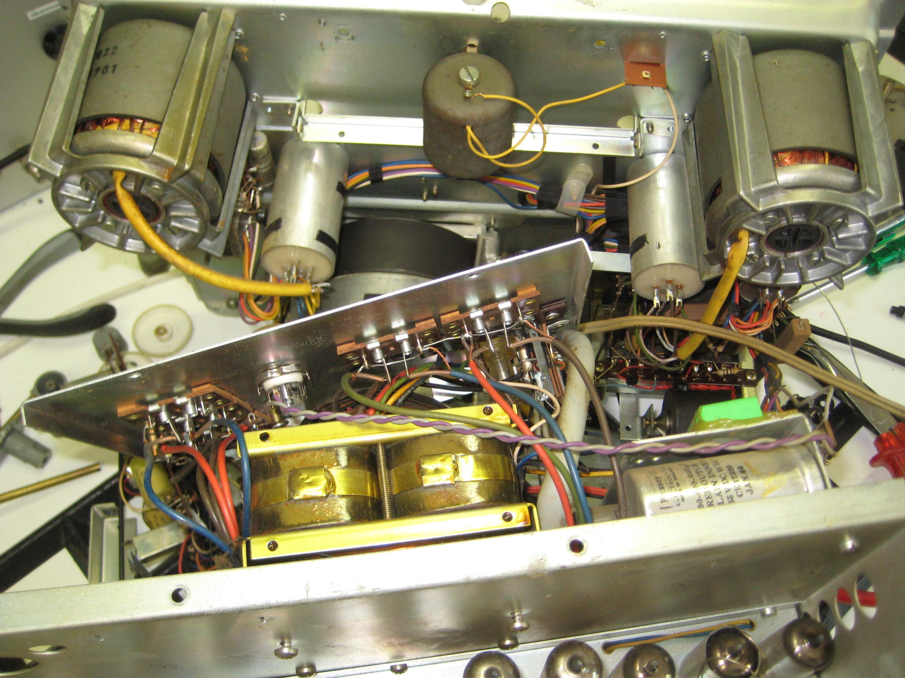

Recently listened to a master tape on my Studer A80 and the Revox G36 HS which made me decide to revise and upgrade the Revox G36 HS.

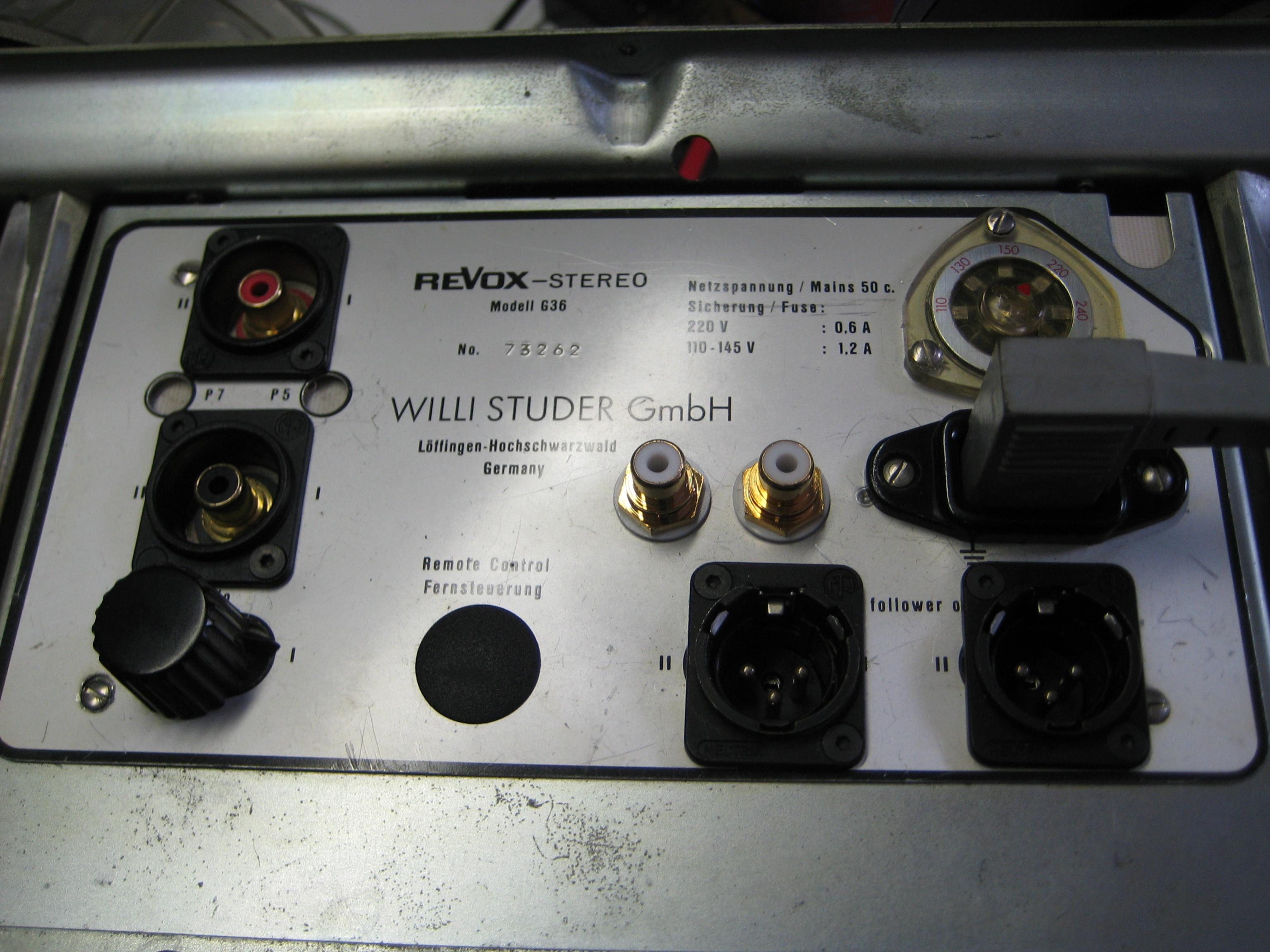

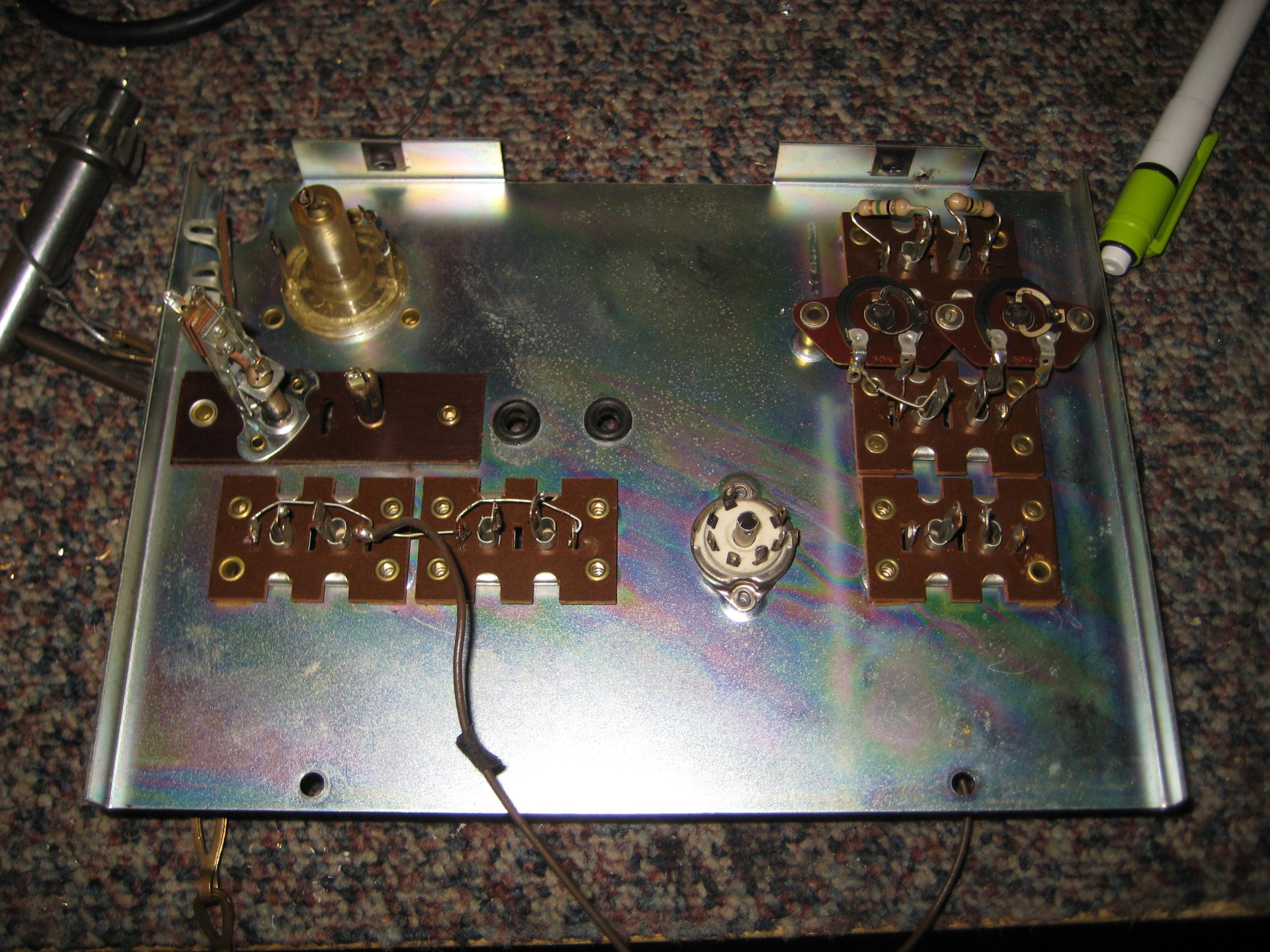

The first to the replacement of the terminal connectors on the top panel as well as a new power socket with mains switch on the same panel.
Working on the G36 is not easy because the top chassis is connected with a lot off wire for powersupply,signal , I try to clean-up this a little .

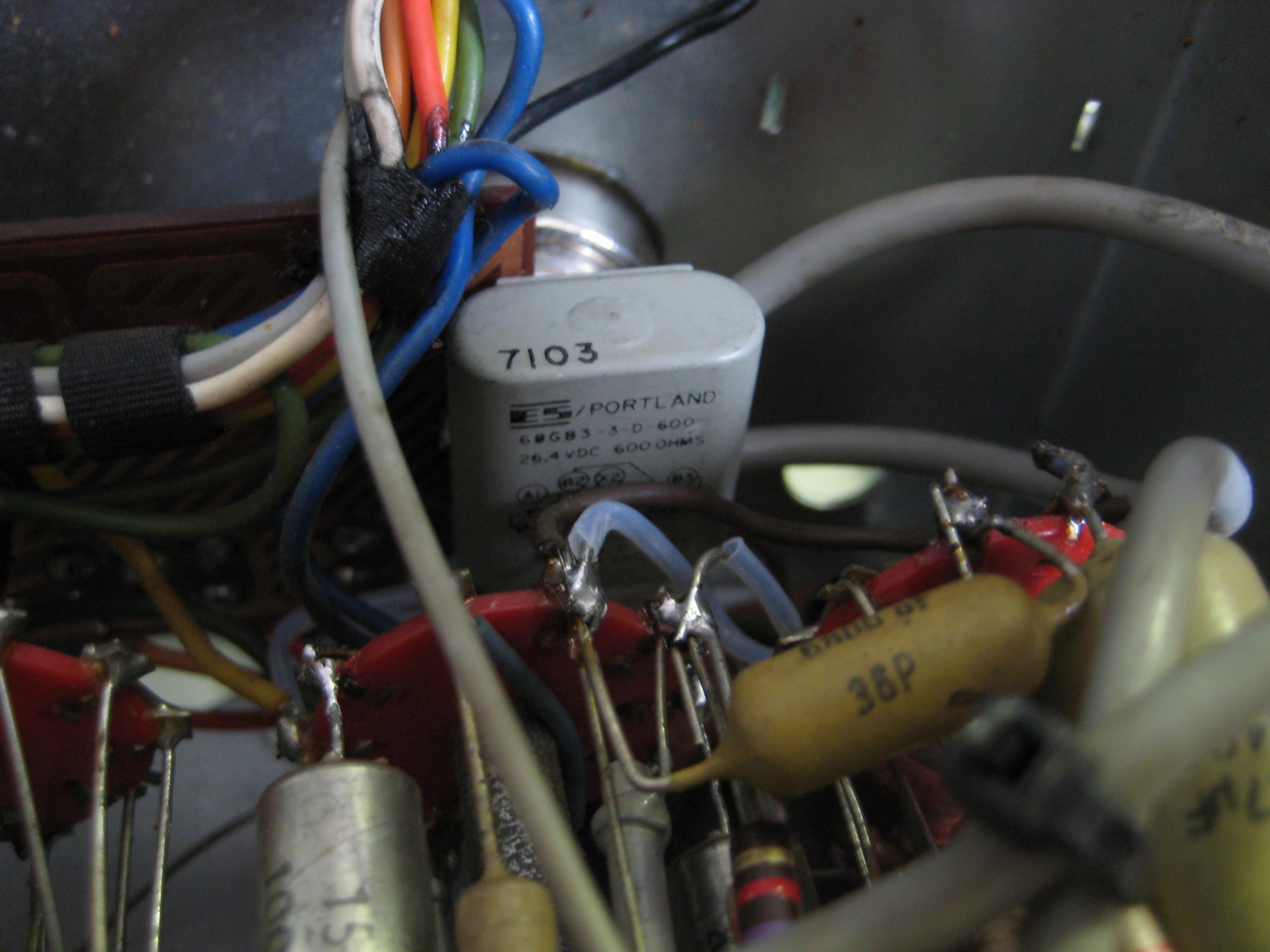

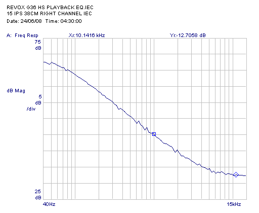

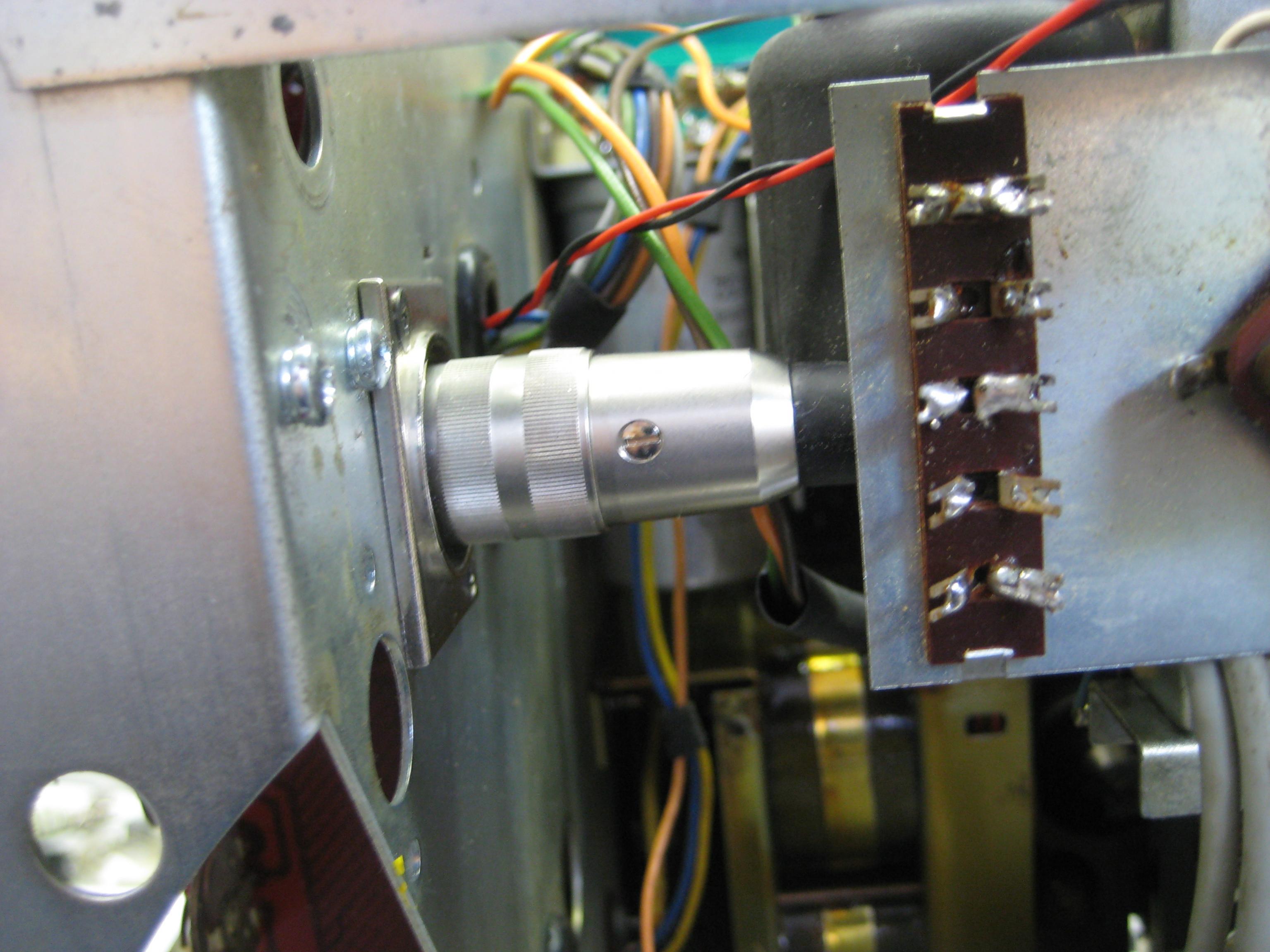

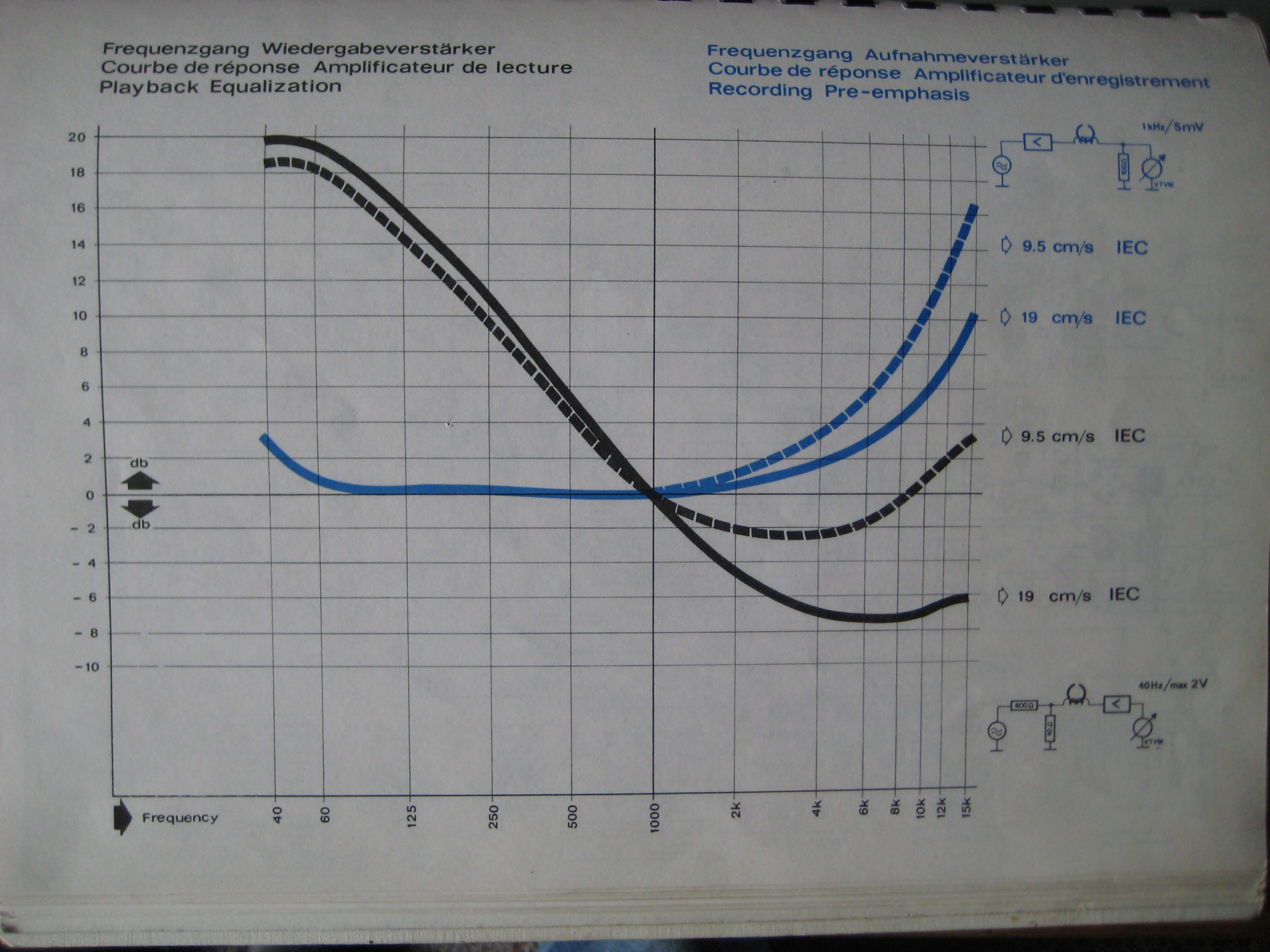

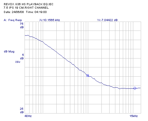

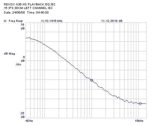

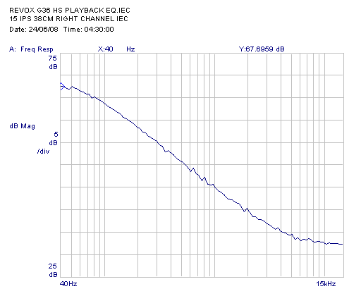

Playback head by 5 pole DIN connected to back plane, and 28volt NOS Milspec relais for playback eq. switching. keep the wire"s as short as possible. Check playback eq. both channels 19 and 38 cm not bad for a machine from 1968 . next the record amplifier and oscillator

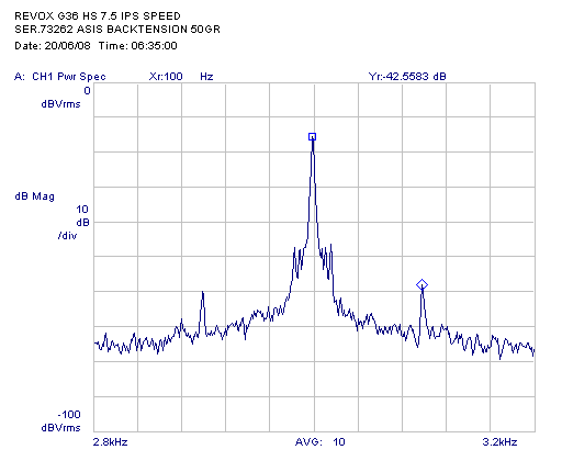

IMG_0889.jpg IMG_0894.jpg IMG_0887.jpg Revox G36 HS Playback eq.19 cm sec  IEC .png
Revox G36 HS Playback eq.19 cm sec  IEC Right channel .png Revox G36 HS Playback eq.38 cm sec  IEC right channel .png Revox G36 HS Playback eq.38 cm sec  IECleft channel .png ]
Hi Volken , nice work. Can you be more specific about how you modify the bias, record and playback EQ?
Thank you that will be the next step after the revision from the rec.amp concerning inputamplifier connections etc. I use the original IEC eq. nothing changed so far. First motor revision, capstan replacement]. Checking and modify the tape path, back tension regulation lot work to do. Eventually I'm going to experiment with the currently available tapes for best results. and changing the bias oscillator.

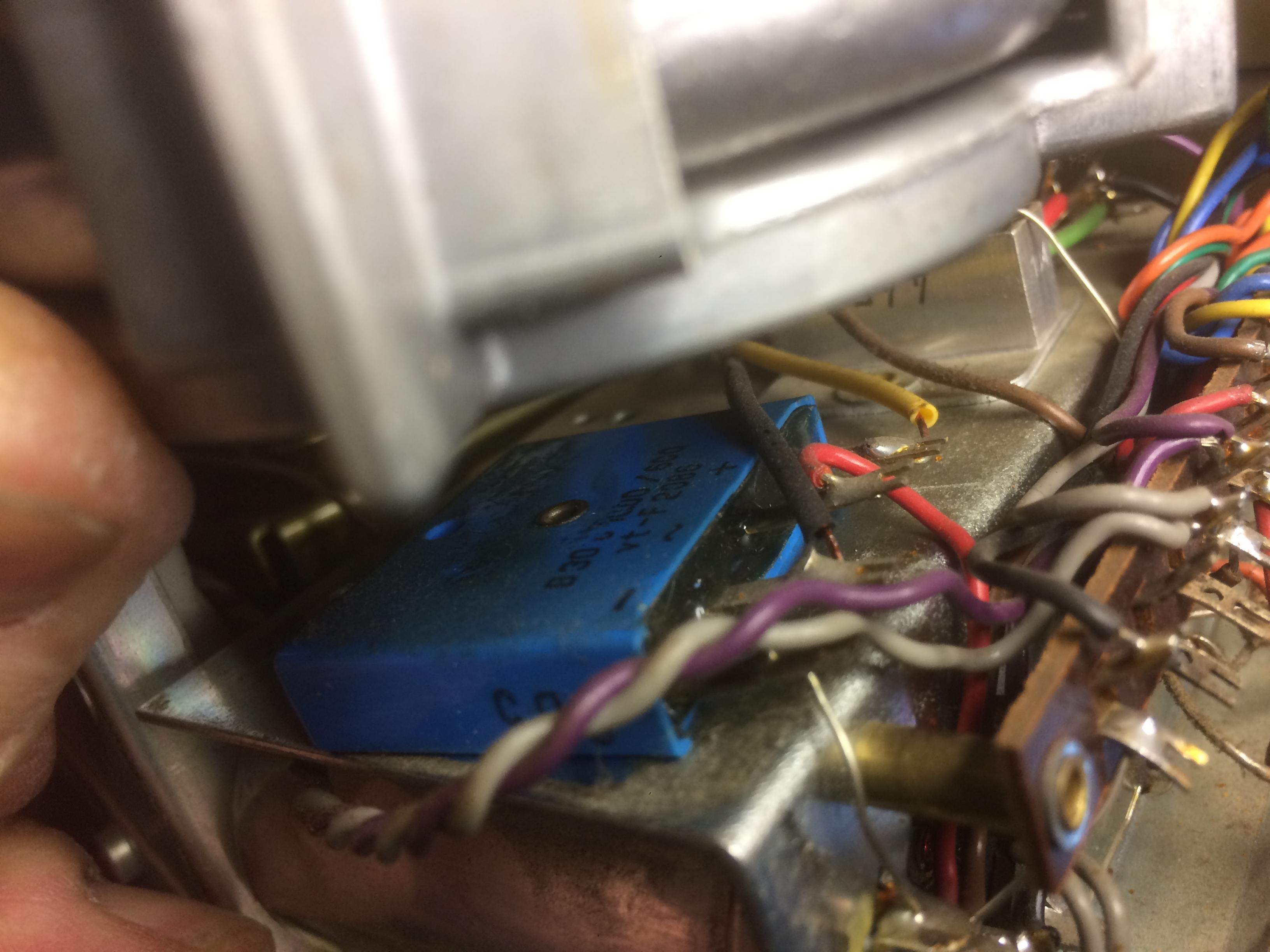

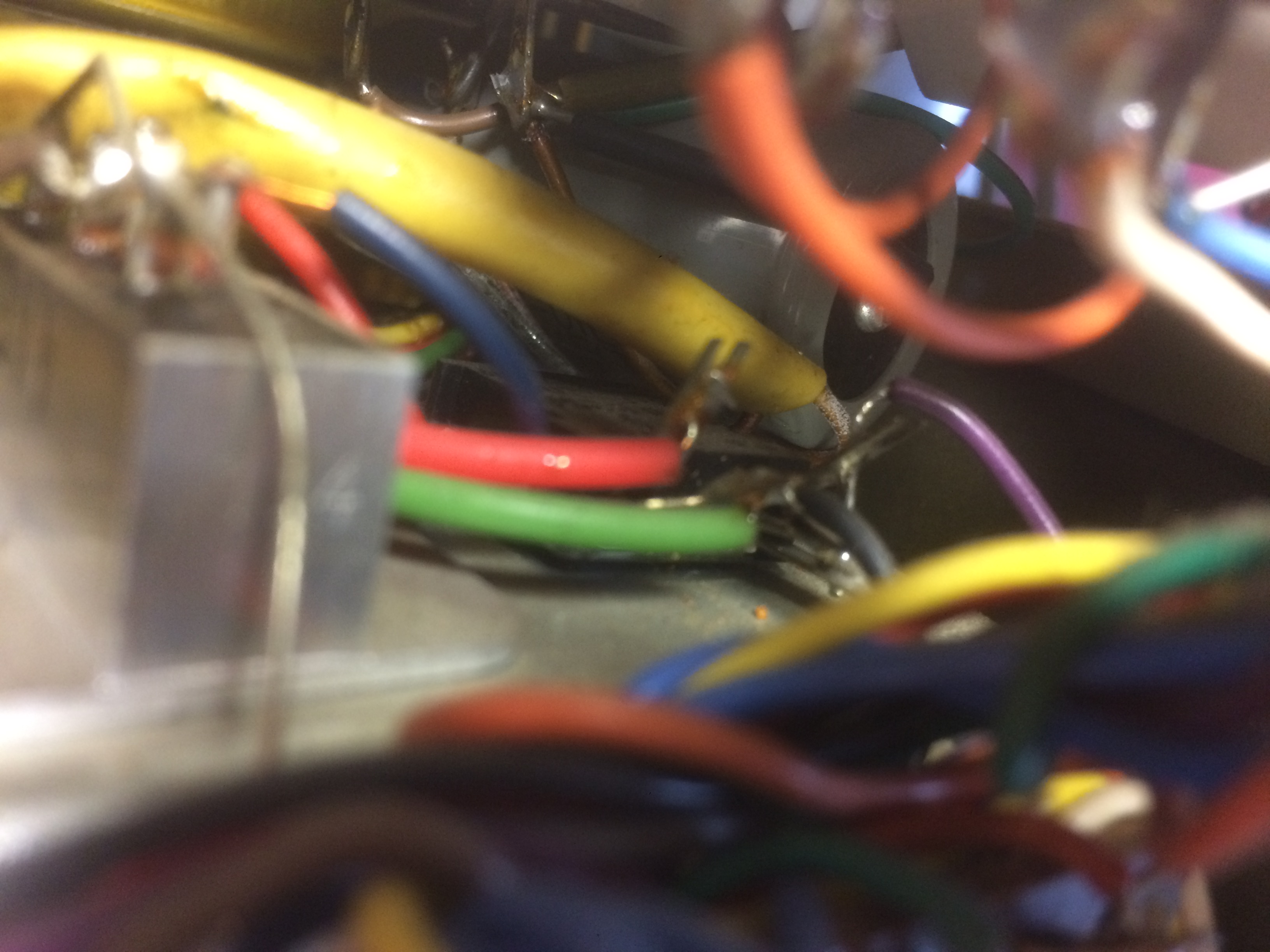

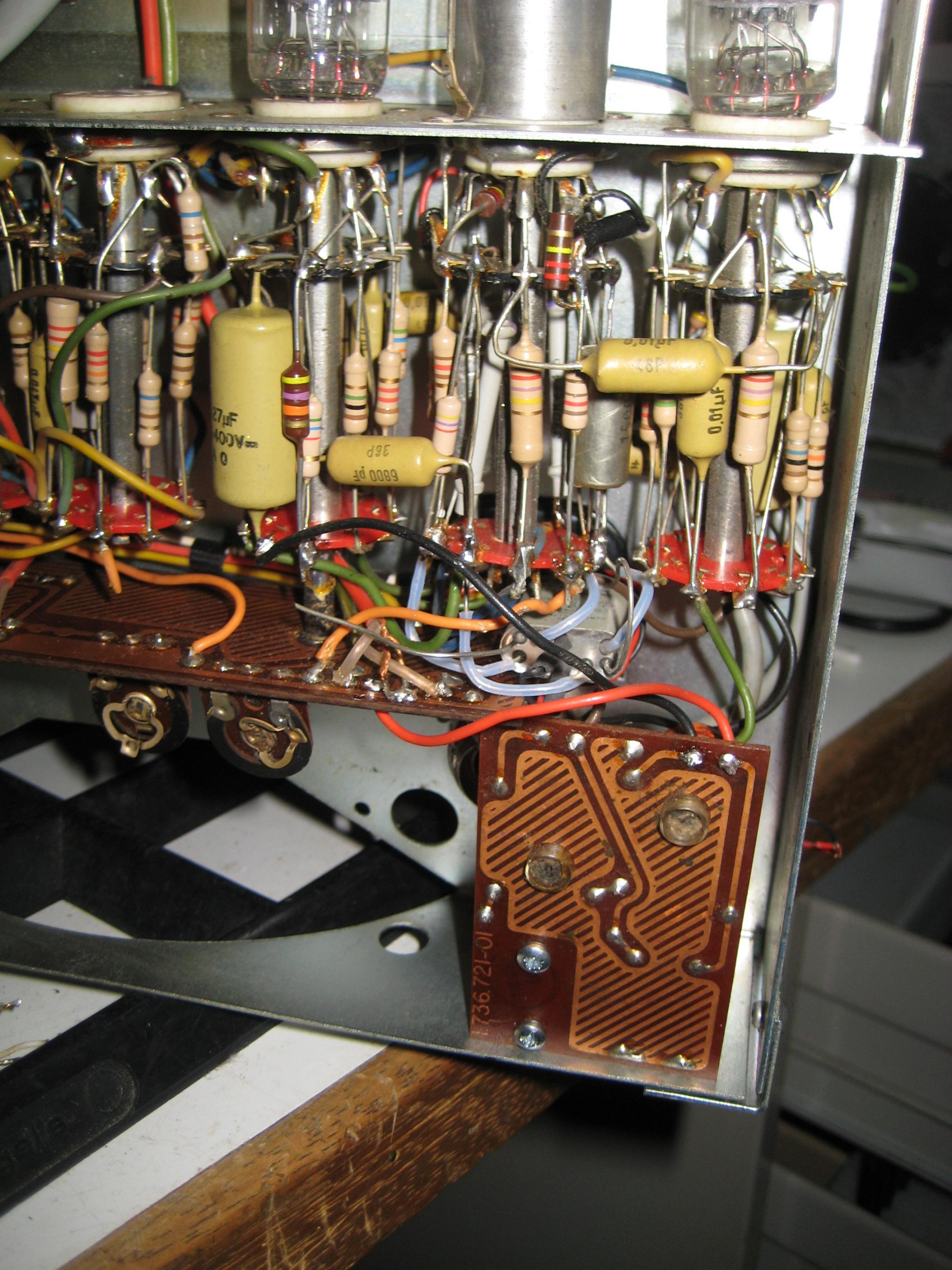

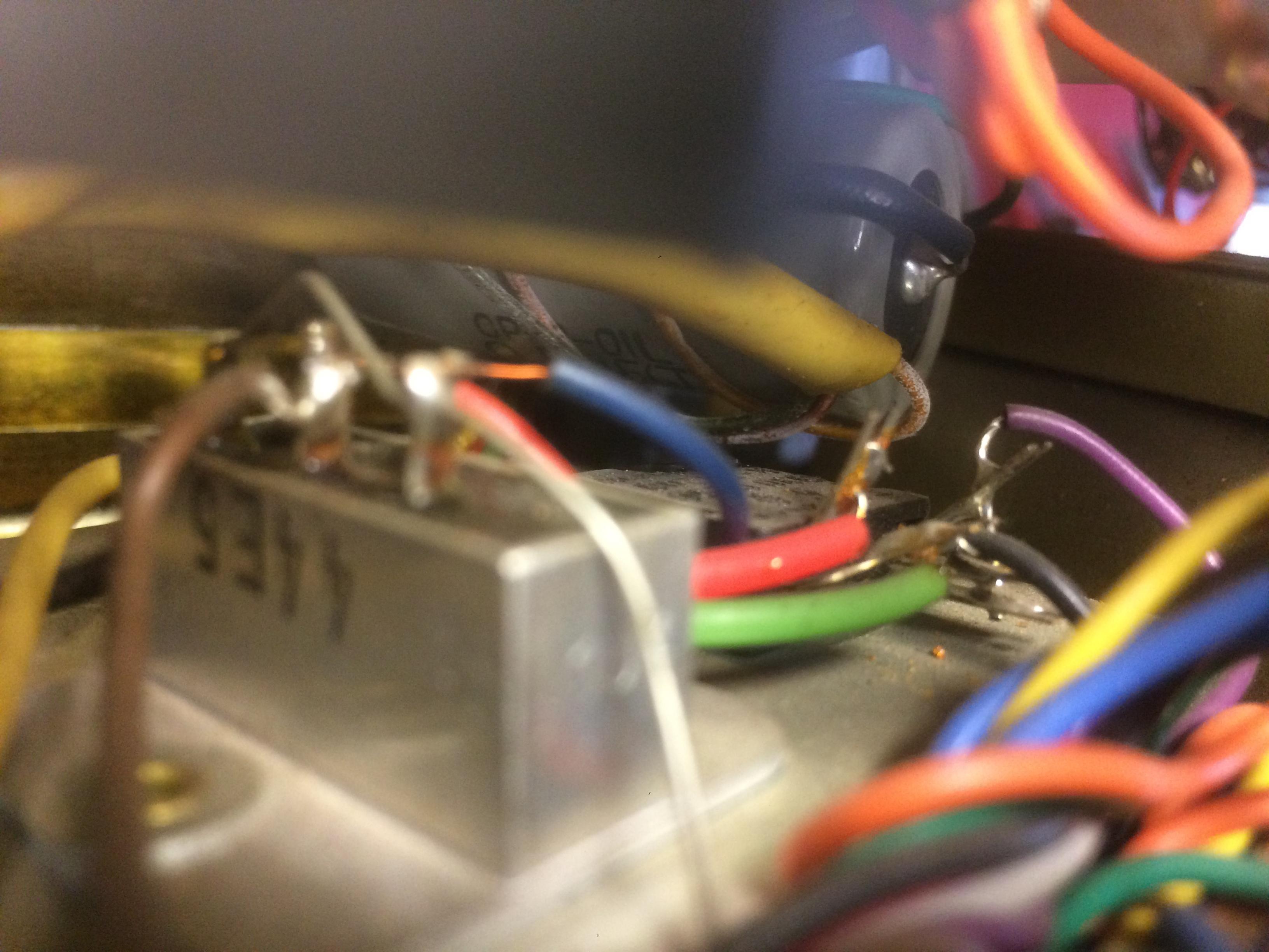

just aquired a G36 , everything is working finer but was concerned about the Celenium rectifiers. I opened up the machine and to my surprise I see a blue plastic rectifier, next to a kind of cylinder type of aluminium thing (resistor?) and a flat square component (another rectifier ?) question is: are these components original from a later revision, or has this machine been upgraded somehow? So, no selenium in it, right?
Administrator
Joined 2004
Siemens selenium rectifiers came in a variety of packaging in the early to mid 1960s. I had a MKIII with the originals which did not look exactly like yours, but those don't look like a recent replacement either.
The B30 is a standard Siemens selenium rectifier PN btw of the time. These were encapsulated in a plastic housing. This one is the LV bridge for filaments IIRC.
