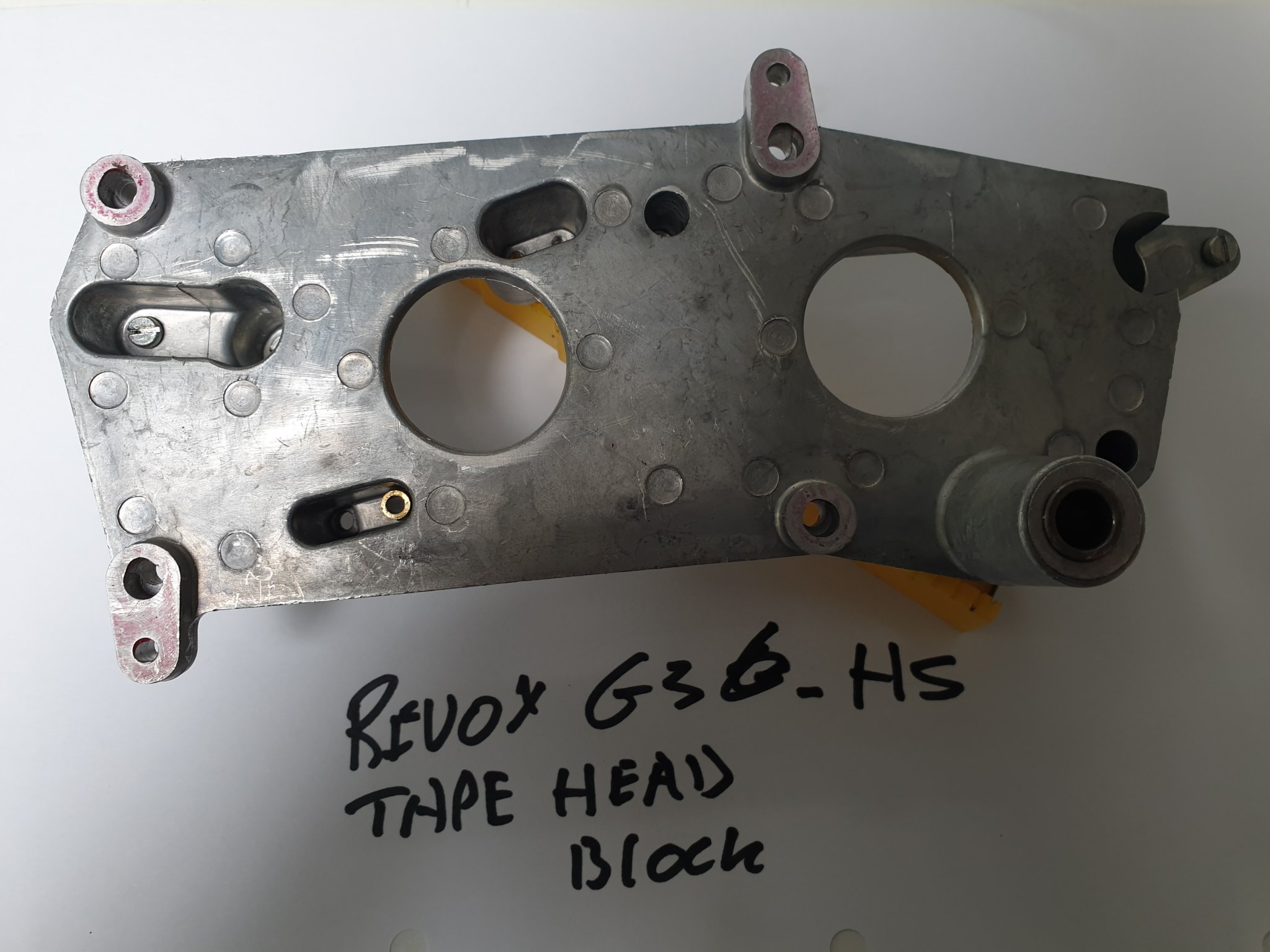

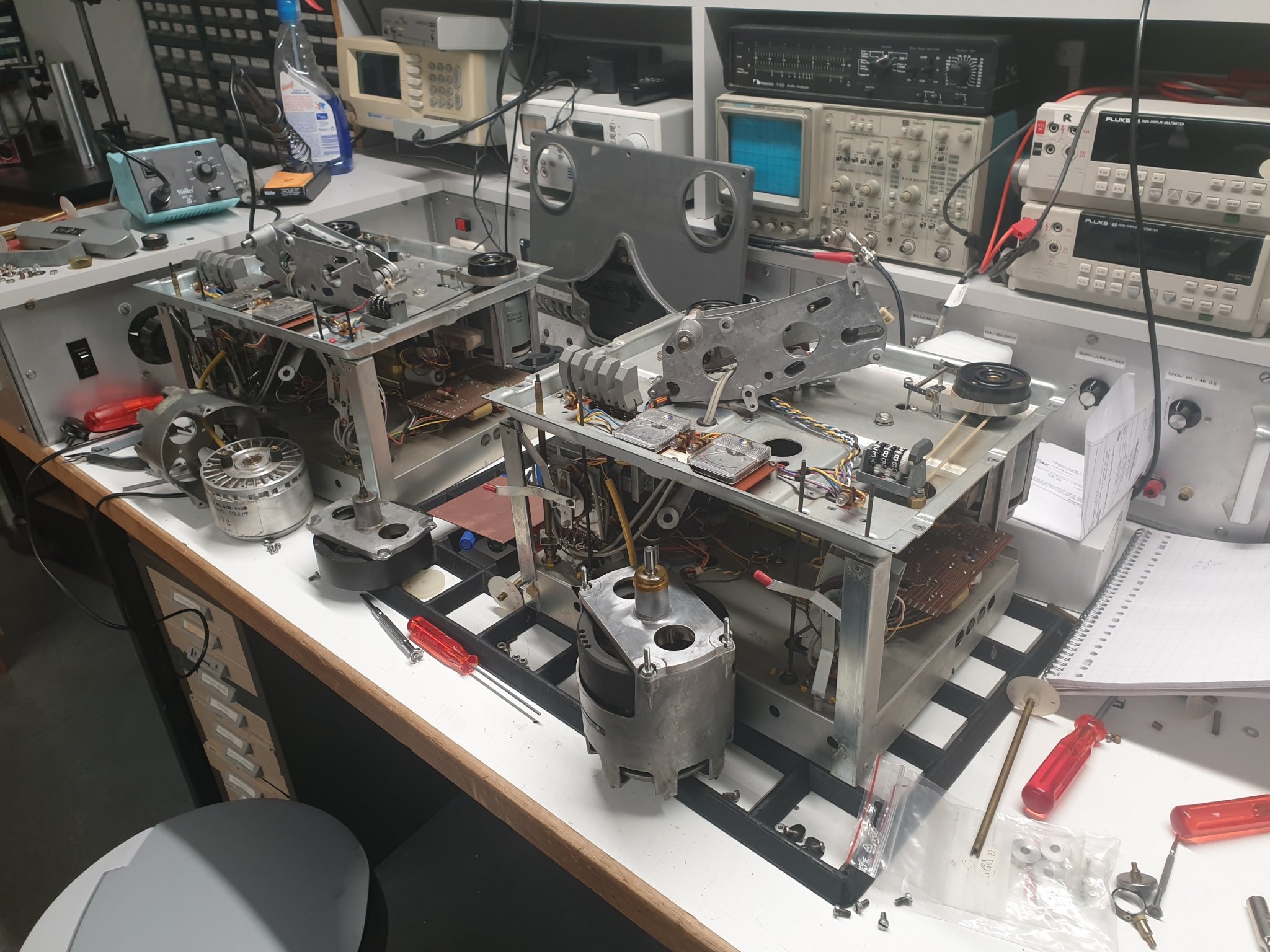

Two G36 recorders one a low speed the other HS for modify the LS to HS the motor chassis mounting needed some modification too.
Seen at the second picture the headstack original factory modification with larger holes , needed because the shaft size is two times the ls .
To keep a good tape contact with the PB head the motor is placed a bit to the back.
The two chassis pictures show the LS version and HS with endlarged holes

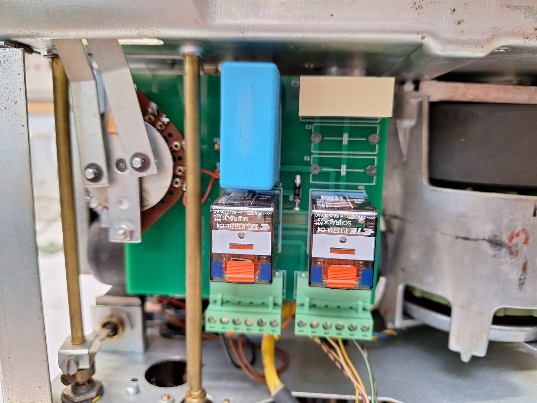

Yes the G36 motor is a three-phase motor just as most Papst motors are. I made a pcb as replacement for the old speed switch , with the option to connect a three-phase supply to it ,the phase caps need to removed then .

Yes same supply that I build for the EMT 930-927 turntable@volken
If the capacitors are removed, then will your new power supply drive a three-phase = 0, 120, 240 degree synchronous motors, like those in my turntable, however, without varying the rotation, correct?
Why another motor that motor is perfect and with three-phase drive you get more torque then single phase , but thats not important the 100hz flutter sideband is gone so is the stator vibration.
