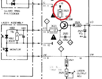

Hi guys!
I have a Philips CD-630.
I decided to check the settings.I did laser current adjustment and focus as written in the manual.
I then measured the voltage across the 3522.I measured 1.02 volts.
For the laser current we get
1,02/18=57mA
Is this normal, not too much?

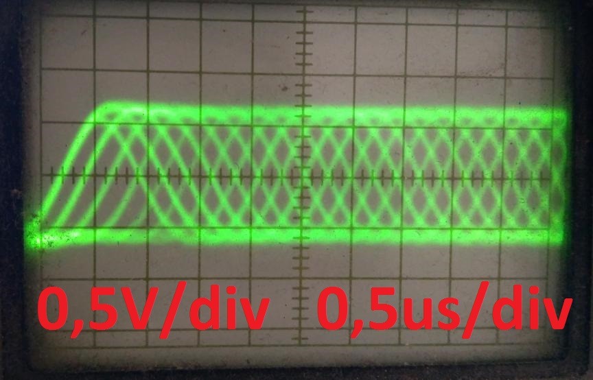

I am attaching a photo of HF too.
1,02/18=57mA
