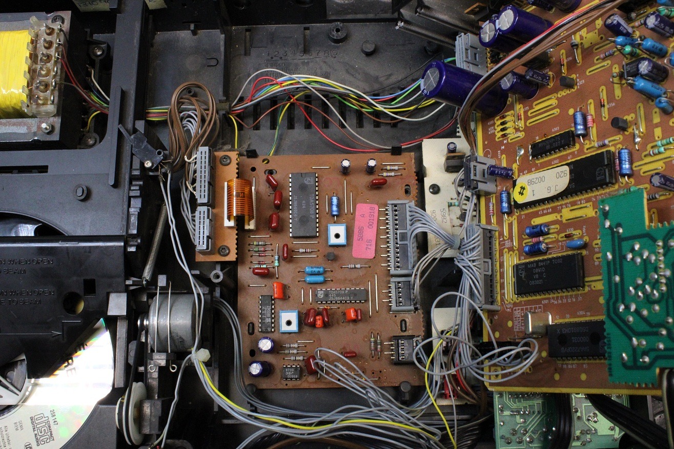

I have these 2 Magnavox CDM4/TDA1543 machines on the workbench:
For both of these machines the buttons to hold down for service mode are:
[SEARCH >] [PAUSE] [REPEAT].
This matches the service manual for the Philips CD582, but does not match the Philips manual for CD480/482.

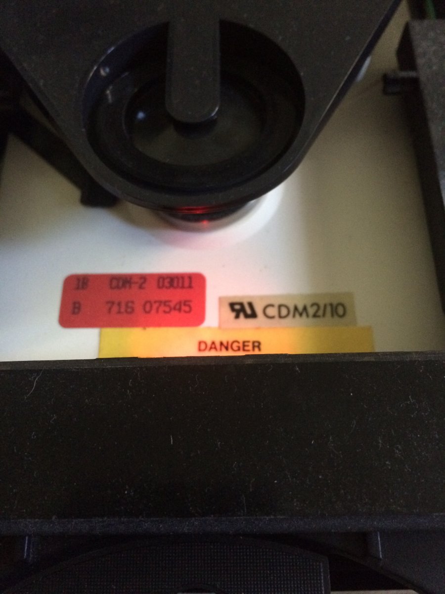

I confirmed one CDM4 transport has a bad laser diode. There is no measurable IR output. The Iop (actual laser diode current) is >100mA regardless of where the trimpot is set.
The other CDM4 has Iop=60mA after calibrating the trimpot for 50mV across 4K7 resistor. Measured IR light intensity is 100uW after this adjustment.

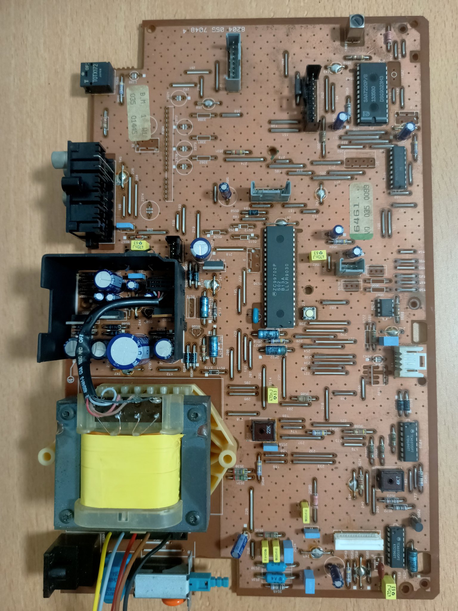

Now I'm troubleshooting the CDB480 main PC board. It won't rotate the spindle motor correctly. I suspect an issue with the servo controller. I'll compare it to the functional PC board of the CD2000. They seem identical in circuit design. However PC the board layouts are slightly different. All electrolytics have already been checked/replaced. Also the grounding jumper vias and other soldered connections have been checked.
-EB

Something I haven't been able to locate yet are exact schematics for the (nearly identical) Magnavox CDB480 and CD2000 models.
I'm currently using a Philips CD480 service manual.
It is close to matching my units, but it shows SAA7220/TDA1541 rather than TDA1543 alone.
Fortunately it does show the SAA7210 for the digital decoder. This is what my units contain.
Magnavox CDB480 corresponds to Philips CD480
Philips has a "combined" service manual for the CD480/CD482 models (I'm using it)
I saw a post mentioning 3 versions of the Philips CD482 model:
That suggests I have the CD482/10 version.
I also saw a Magnavox CDB492 / Philips CD492 mentioned. But I haven't found any service manuals for either of those models.
-EB

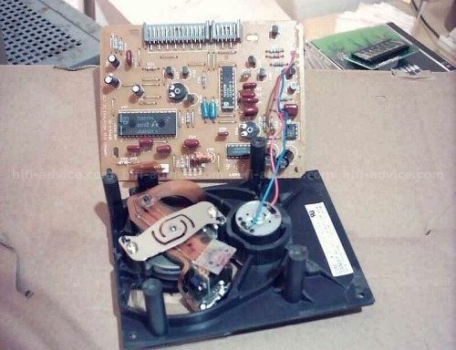

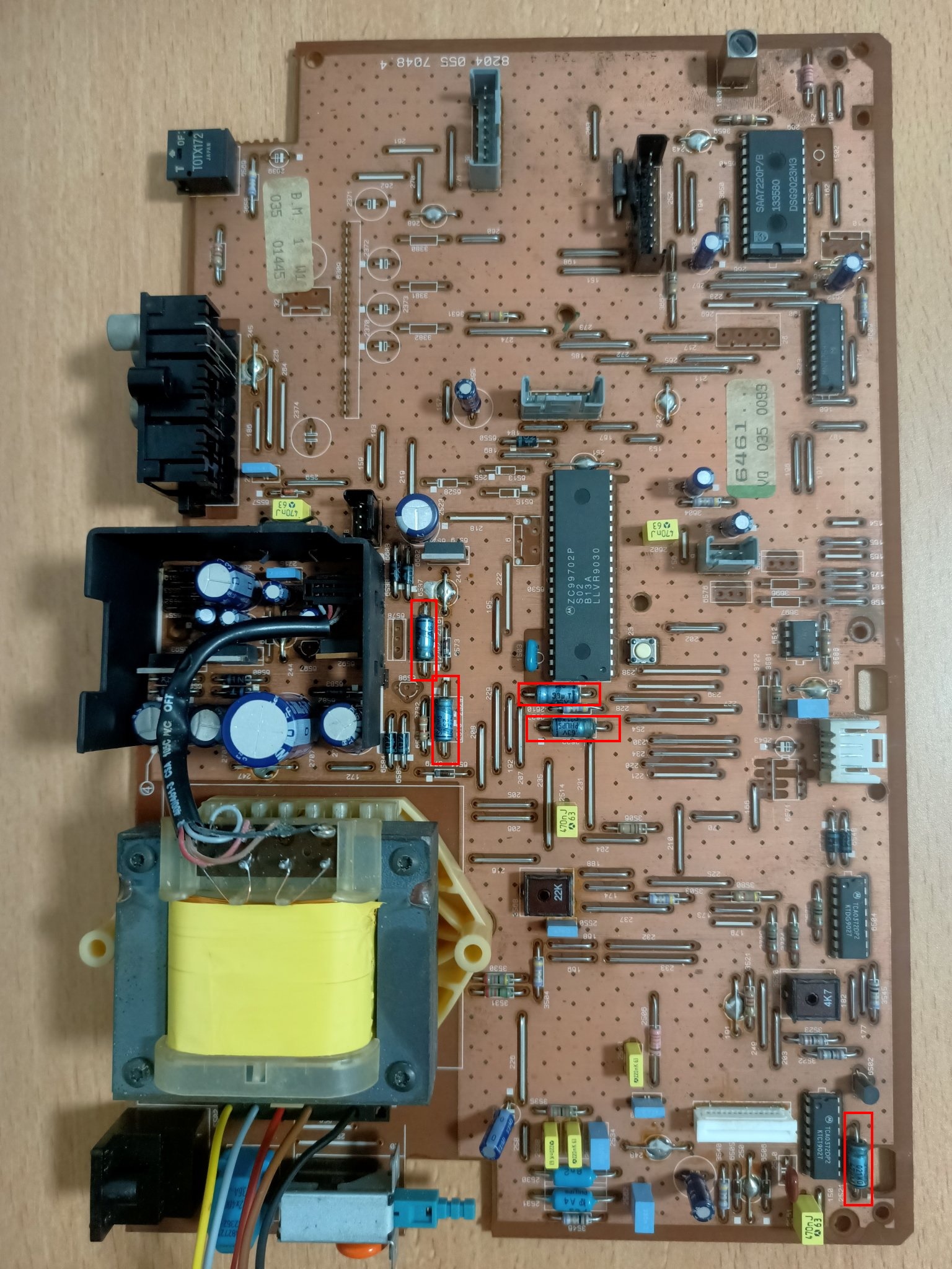

Hi brother , I m Jacky from Singapore, I have a Philips cd850 cdp , it spindle motor spinning non stop when power was on , what component was failed inside ,need your great helps..I’m still around but (temporarily) switched to repairing/restoring a bunch of integrated amplifiers and power amplifiers which are in my collection.

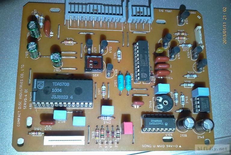

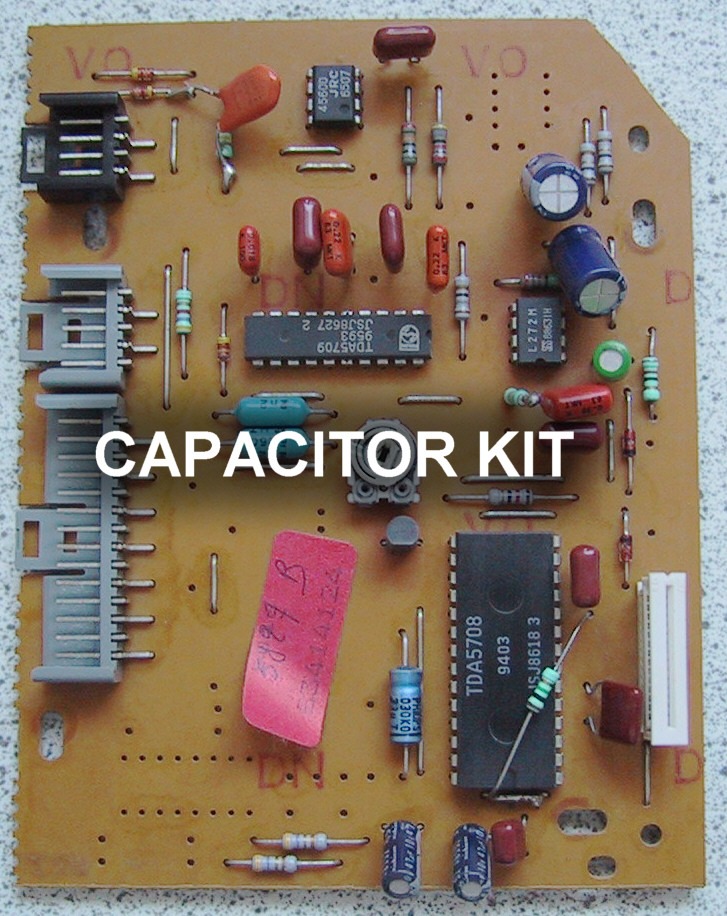

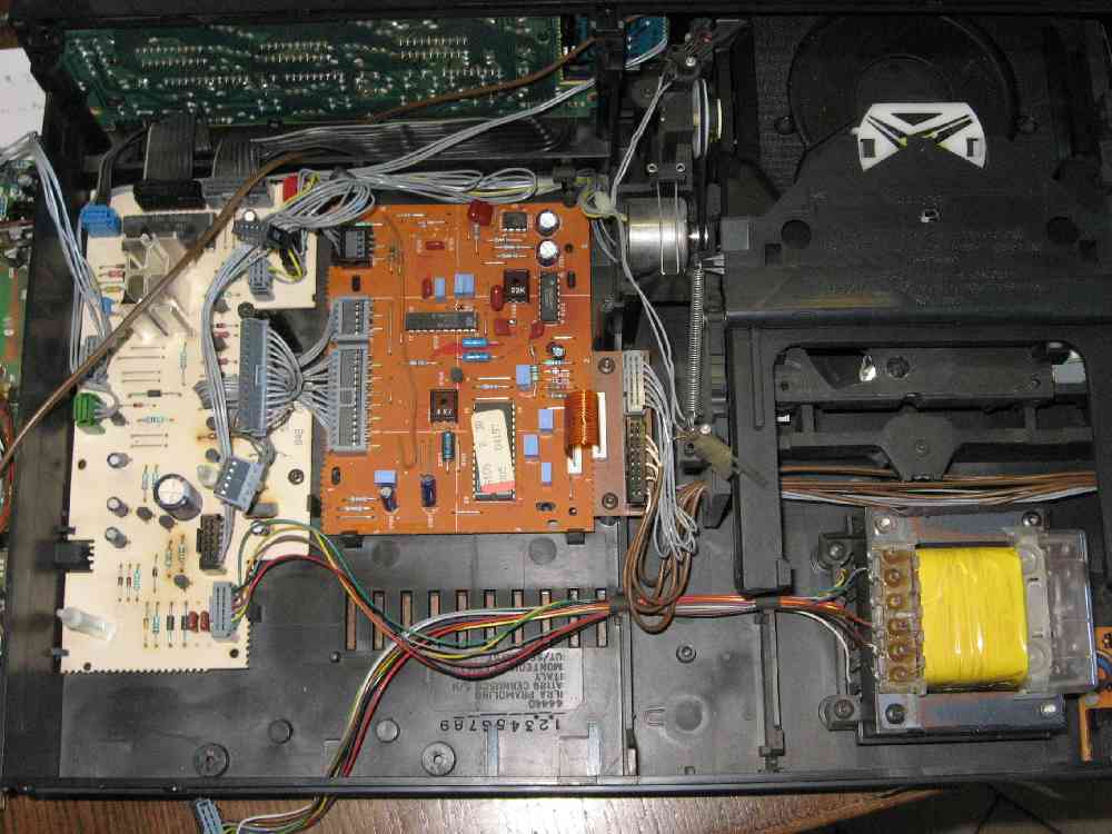

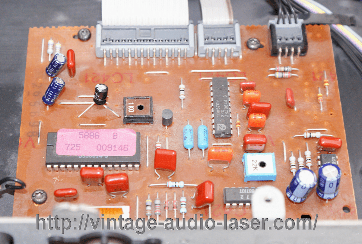

Hi, start by replacing all the marked axial electrolytics. You can replace them all by 22uF/25V, despite the originals might have other values. Is it spinning faster than normal or maybe reverse? A missing clock signal might also be the cause, here with the CD850, its coming from the DAC doughter booard, so check there too.
according page 6-1 of CDM-2 service manual (also for CDM-4) which is additional necessary as supplement for a lot of models, there are a lot of different associated servo boards.
This PSB's can be recognized by the 4-digit number on the attached sticker mostly glued on the surface of TDA5708 (check out the attachments).
Unfortunately from several PCB's sticker with this number isn't longer to find.
The service manual version under
https://www.hifiengine.com/manual_library/philips/cdm-2.shtml
also to find under
https://elektrotanya.com/philips_cdm-2_cd-mechanism_sm.pdf/download.html
includes the following PCB versions:

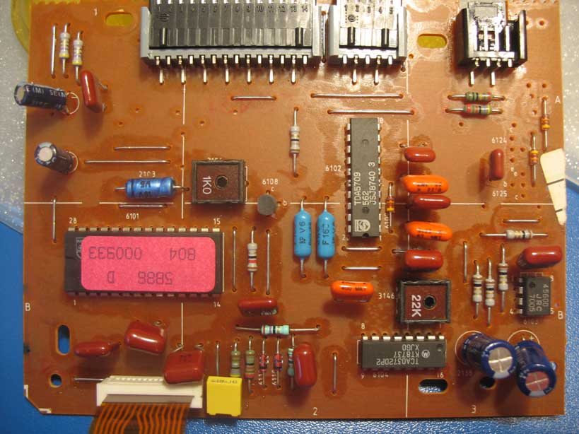

1) static version of CDM-2, 5725 and 5768
2) dynamic version of CDM2, 5826 and 5827
But there are many other PCB-Versions, 5886, 5888, 6127 and 6105 are some additional examples.
Because the version 5886 is in use on Philips CD660 and CD670 and the CD660 service manual refers to the above mentioned service manual for the CDM-2 I guess, there is at least one upgrade resp. supplement to the CDM-2 service manual.
Who can upload this supplements (for me most important is the version "6105" used in Micromega SOLO first series) ?
Thank you very much.

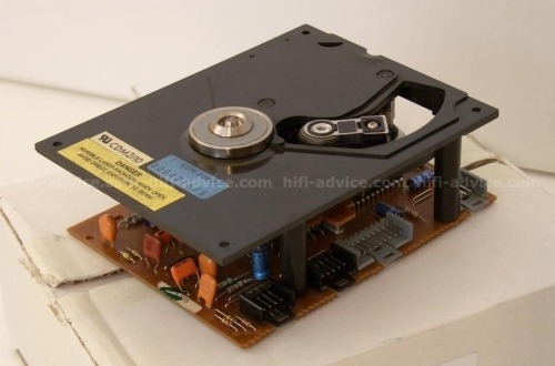

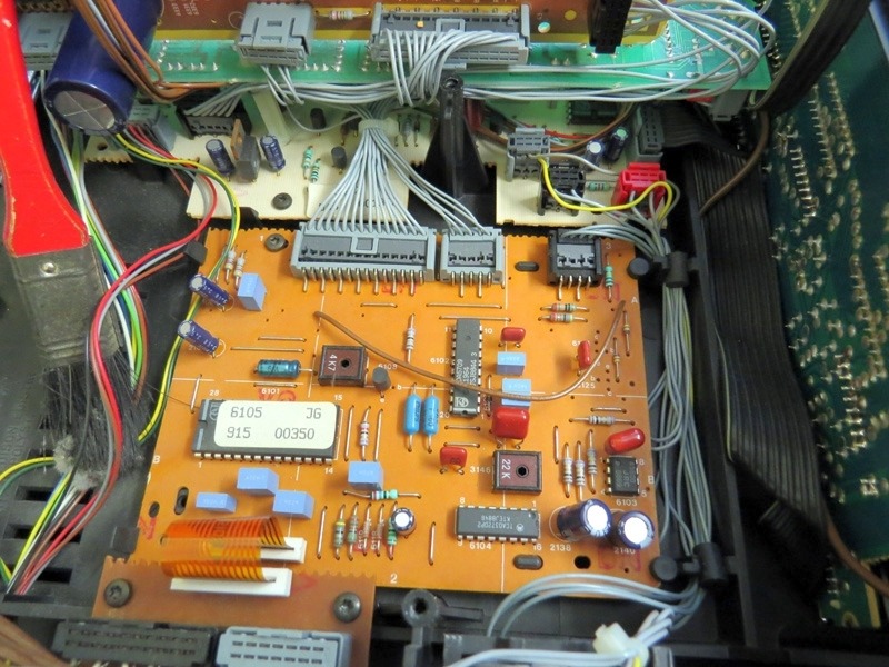

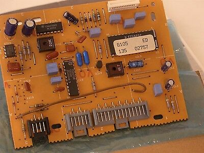

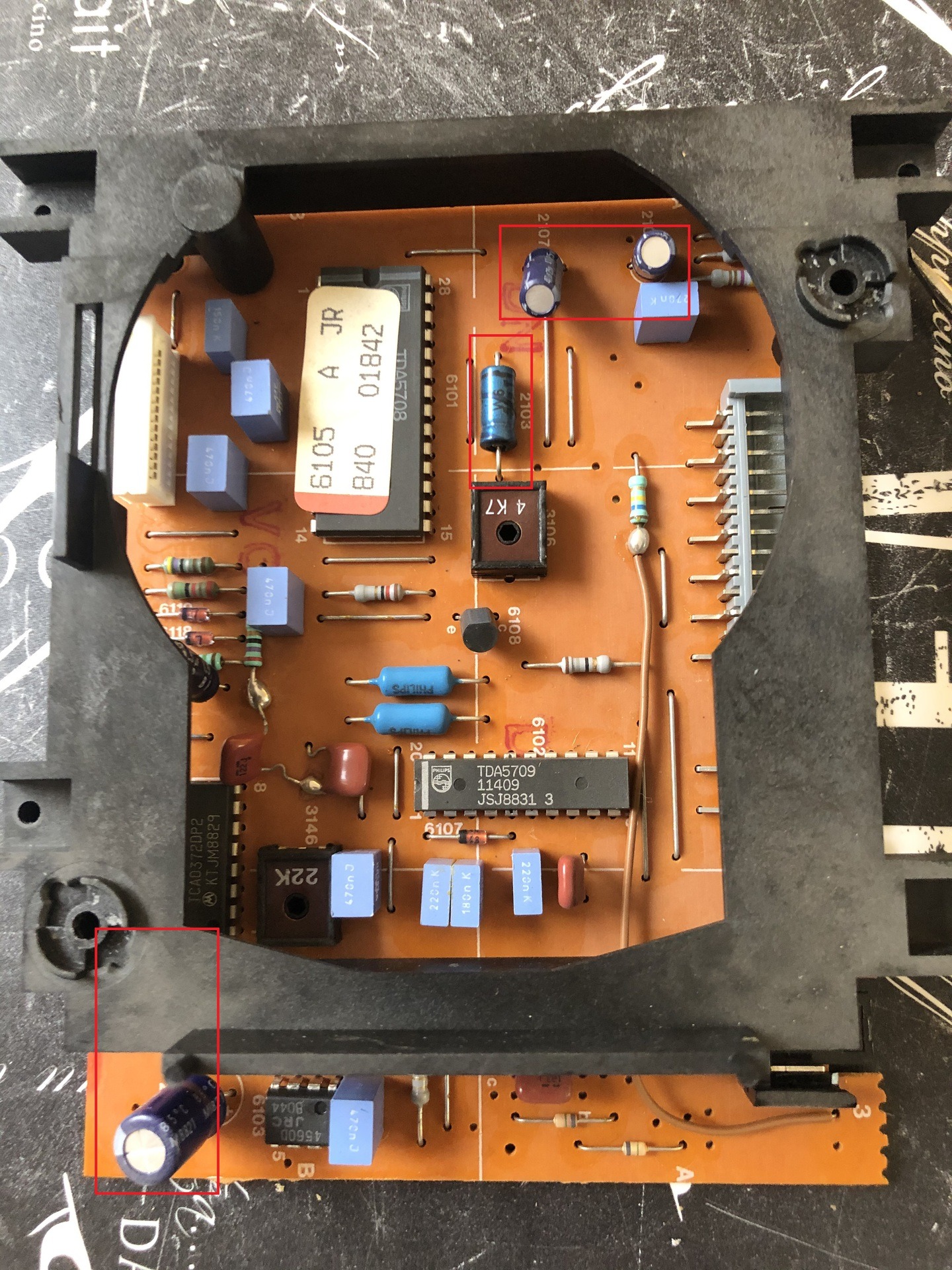

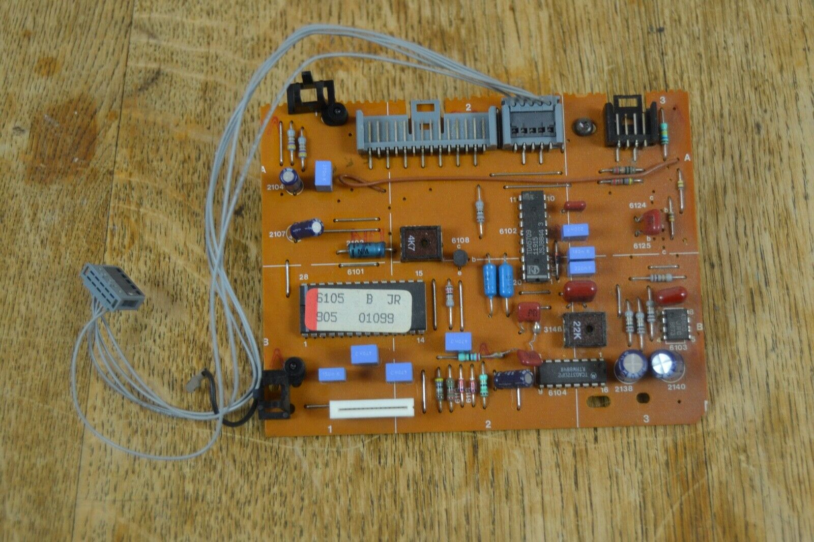

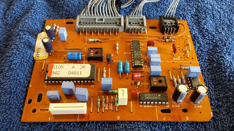

Problem is, that I have Micromega SOLO with faulty servo board "6105" for CDM-4 and I need therefore schematic and adjustment procedure.I have read your question several times on several threads and I still do not understand what you are looking for / want? or even why.
I must have between 30 and 40 players based on CDM (from zero to pro)
what is your problem, what are you looking for? ,it's not clear .
SM for Philips CD660/670 (partly same CDM drive with this servo board inside) refers to the separat available CDM-2 service-manual
This I have and there four different versions of servo boards described on page 6-1 but no version, what I looking for.
I need service information for the version "6105" (maybe "5886" is similar) and a Philips/Marantz CD Player, where the "6105" servo board is in use.
To make long story short I need a service manual for my Micromega SOLO, but nobody can help.
Therefore a short story is to extend and making complicate to explain my problem.
Check out page 6-1 in CDM-2 service manual - my estimate is, that there are a lot of supplements for additional servo boards exist from Philips like the mentioned.
This supplements I want to have for service and maintenance - not only for my Micromega.
Hi weissi , already replaced those capacitors , the problem was when on the player ,the spindler motor spinning non stop ,very fast speed , the missing clock signal from the dac?I disconnect the cable to the dac board still the same problem.haha..Hi, start by replacing all the marked axial electrolytics. You can replace them all by 22uF/25V, despite the originals might have other values. Is it spinning faster than normal or maybe reverse? A missing clock signal might also be the cause, here with the CD850, its coming from the DAC doughter booard, so check there too.

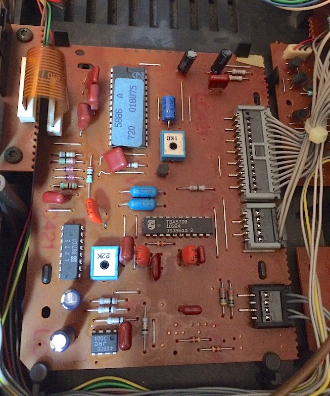

In the meantime I have found service-manuals for the servo boards 5886 (1K for focus offset) and 6105 (4K7 for focus offset) both boards are in use here:
1) B&O Beogram CD-4500, CD-3500, CD-5500 and CD-6500
https://www.vintageshifi.com/repert...ng-Olufsen-Beogram_CD-4500-Service-Manual.pdf
2) Revox B126
https://www.hifiengine.com/manual_library/revox/b126.shtml
I think, the servo-board 5886 is for the CDM-1/MKII, CDM-2/10 so as CDM-4/11 - and the 6105 for the CDM-4/19 so as CDM-4/27.
But this isn't clearly to find out without the genuine manuals from Philips together with all supplements and bulletins.
Service-Manual Philips CD-670, which I have, refer to the service manual for CDM-2 concerning mechanism+servo,, which I have also, but without any upgrade supplements and thus without any information concerning 5886 and 6105 servo board.
If I know the serial No range, within the CD670 uses the newer boards 5886 and 6105, the problem was solved and I had the right device to check out the mechanism+servo from Micromega SOLO (Revox B126 and B&O devices are too expensive for that).

Any more helps appreciate ,thks againHi weissi , already replaced those capacitors , the problem was when on the player ,the spindler motor spinning non stop ,very fast speed , the missing clock signal from the dac?I disconnect the cable to the dac board still the same problem.haha..

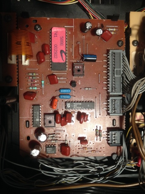

Servo board modifications from CDM-2 to CDM-4 are to find in Page 11-1 from service manual of B&O-Beogram CD-5500-6500-7500 - go also to the attachment (actually the differences between the servo boards "5886" and "6105" (attachment No 2 and 3 sre in higher resolution for "6105" servo board):
1) new values and additional parts for servo board 6105 with CDM-4:
R3105 4K7 (APC)
R3142 22 (focus drive out)
R3145 680K (focus offset)
R3155 8K2 (PIN8 IC6102 behind C2156)
R3159 15K (RAD ERR driver NFB)
R3162 91K (RAD ERR driver NFB)
R3163 15 (not 15K as mentioned in serv. man - RAD ERR driver Boucherot Network)
C2159 1u5 foil/MKT or MKS (RAD ERR driver Boucherot Network)
C2141 470n (focus ERR driver Boucherot Network)
R3214 220K (add between PIN6, IC6103, NjM4560, and PIN21, IC6101, TDA5708)
C2142 1n2 (add between PIN1, IC6104, Focus Drive, L272B, and PIN5, IC6101, TDA5708)
R3105 4K7 (APC)
2) old values for servo board 5886 with CDM-2 (find out in the schematics of Grundig's SM CD9000 page 11-13):
R3105 1K (APC)
R3142 27 (focus drive out)
R3145 390k (focus offset)
R3155 10k (PIN8 IC6102 behind C2156)
R3159 18k (RAD ERR driver NFB)
R3162 82k (RAD ERR driver NFB)
R3163 82 (RAD ERR driver Boucherot Network)
C2159 1u5 elcap (RAD ERR driver Boucherot Network)
C2141 220n (focus ERR driver Boucherot Network)
R3214 not used (between PIN6, IC6103, NjM4560 and PIN21, IC6101, TDA5708)
C2142 not used (between PIN1, IC6104, Focus Drive, L272B and PIN5, IC6101, TDA5708)
