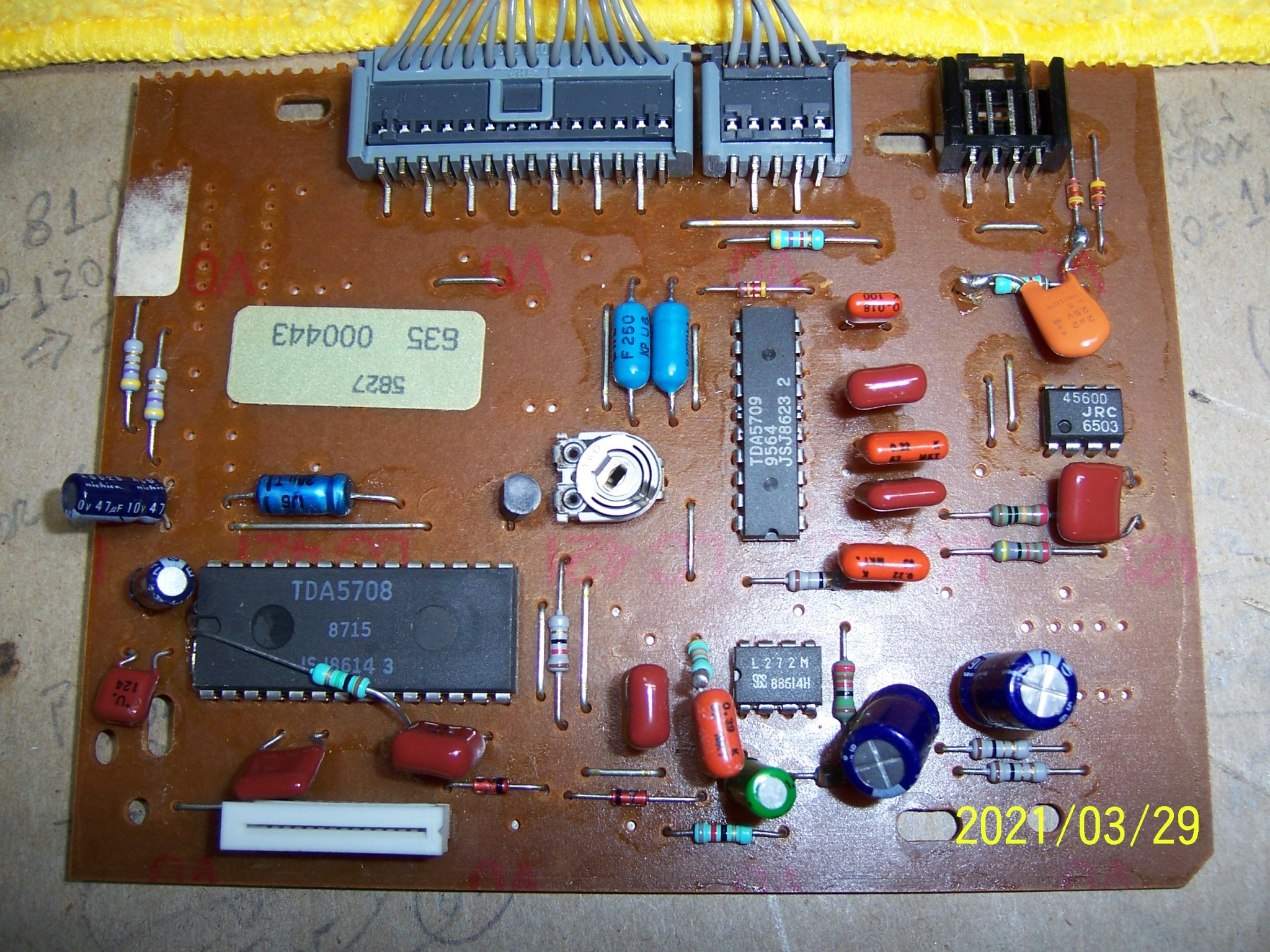

Your Mission PCM4000's Drive assembly PWB looks identical to my Magnavox CDB650's. As you can see, the factory's assembly of the 2nd 47Uf cap (lower left pair, lower of the two) is installed backwards in polarity. I corrected this when replacing them with Nichicoms (47uf/35V).

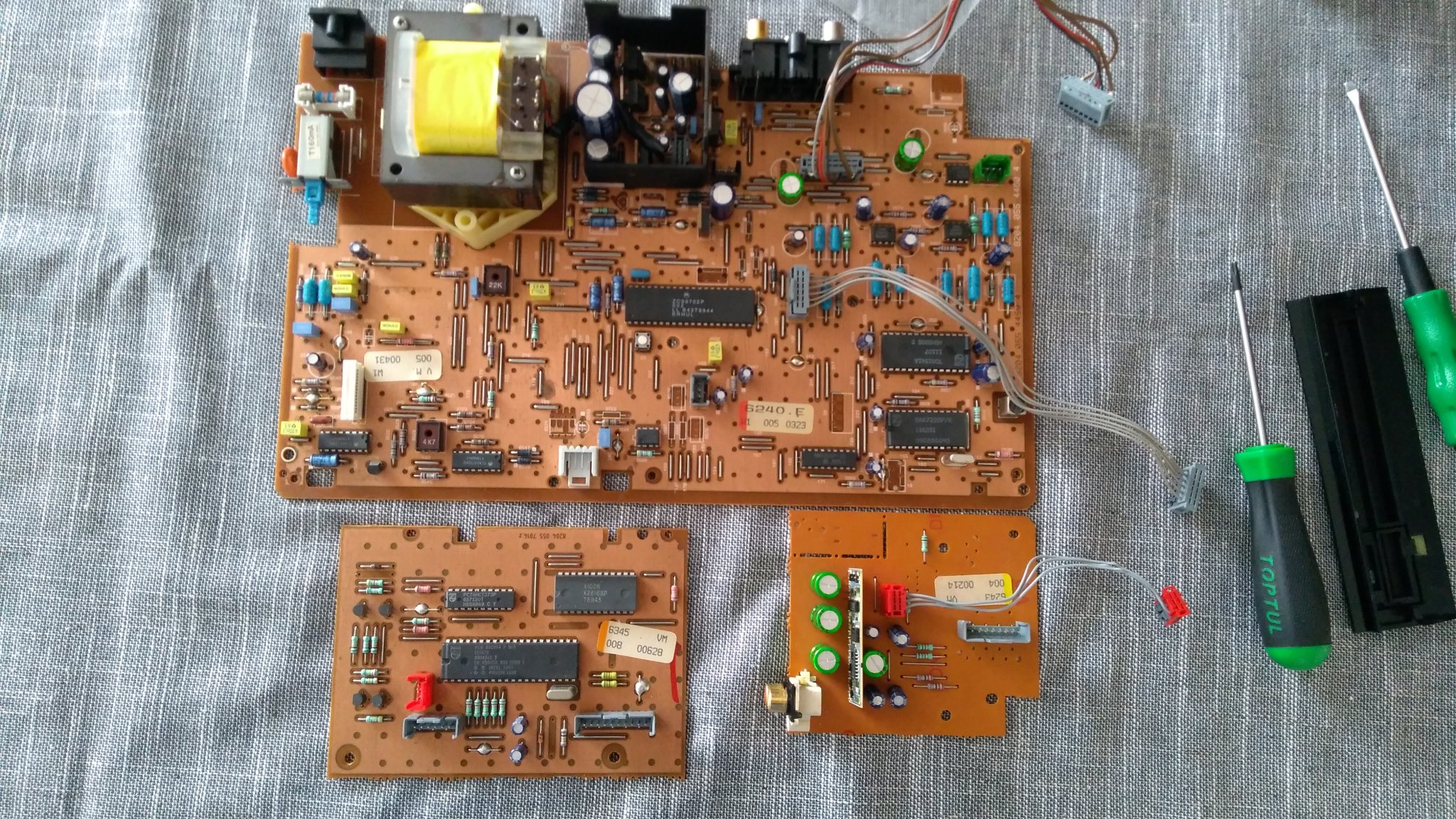

Hi in this great forum!
I was recently invited to a relative for dinner. Unexpectedly, I came home with a Micromega Solo which did not work correctly. He gave me the device with the words "It would be a shame to throw it in the bin" and "take it home and try to repair it". I thought I didn't need any more projects, but he was right and I decided to take the CD player home with me.
The device has now the following status: the cd spins and the lens moves for a short while up and down and tries to focus but after that nothing seems to happen except that the laser seems to recognize the beginning of the songs. the display shows 1.01, 2.01, 3.01 etc. But it doesn't play any of the songs. Should I be able to see the laser beam? I know it's infrared and dangerous if it goes directly into the eye, but from the side I think you should be able to see something in the dark, right?
I've already opened it a few times and there's a Philips cdm 4/25 inside. I also demounted the servo board from the laserdrive and have also already partially familiarized myself with some of the various repair instructions uploaded here. As i understand the first thing on the agenda will probably be recapping.
What will be next? I thought that I would have to check whether the transformer (it emits a somewhat loud humming noise) is supplying the correct voltages. What is the best way to check if the correct voltage is there? Which of the instructions gives the best information for this? (maybe the Revox B126/B226?)
My "normal" field is more tube amps and electrostatic speakers so im am not so much into transistor or integrated circuits electronics... Do I necessarily need a potential arm band to work with this kind of electronics in order not to destroy any of the components?
Many thanks in advance.
