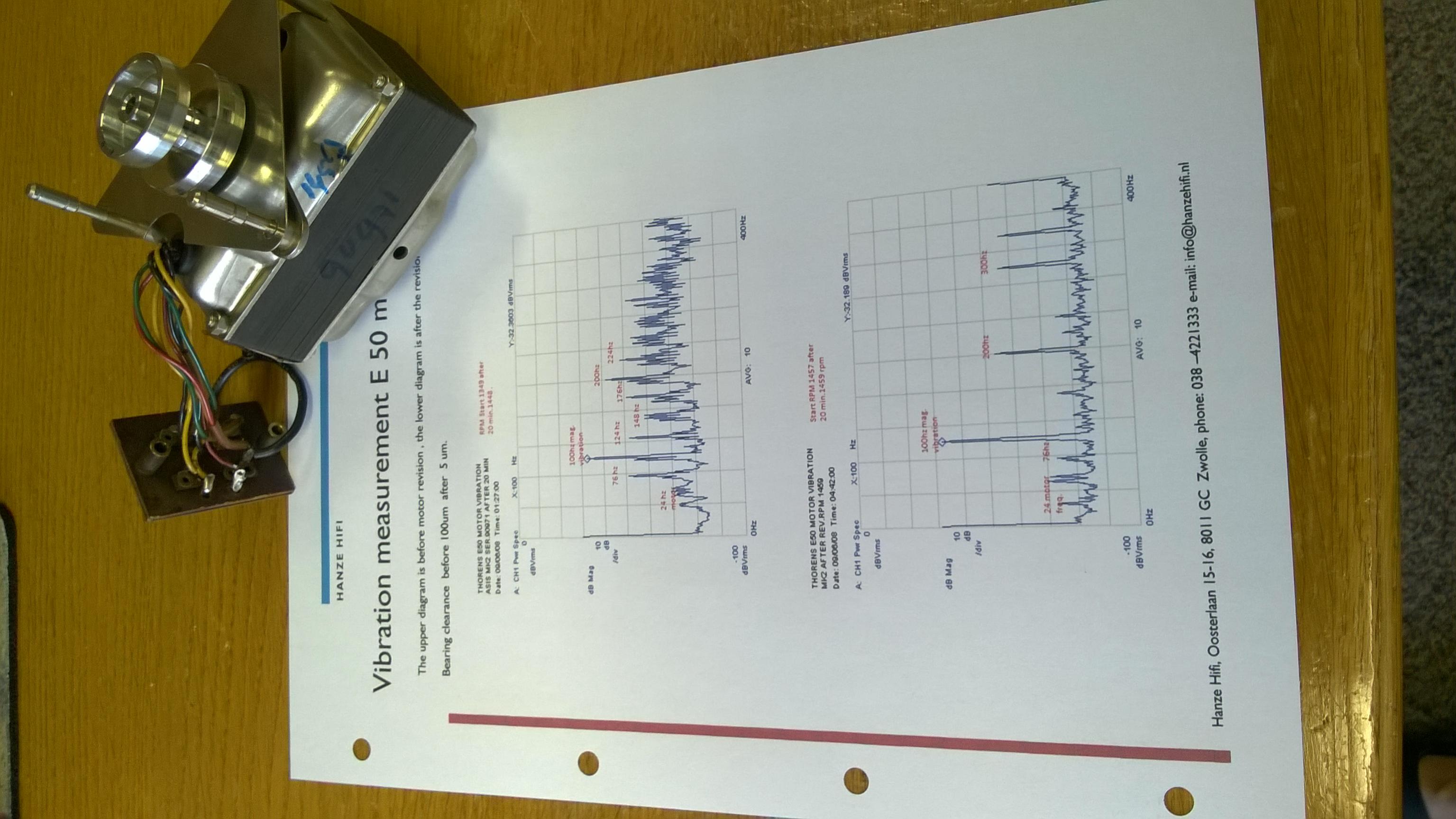

Thanks for the great thread. It seems you've left no stone unturned. I am rebuilding my E-50 motor and notice the coils are quite loose in their housing. Does anyone know about shimming the coils so they are held tightly in the case? If so, what did you use as material? Nylon tie strap material seems about the right thickness but I'm sort of concerned with the heat.

Also any thoughts on snugging up the coils in the housing? I'm thinking some teflon insulation off of some Mil-spec wire would fit nicely into those corners and prevent any rattle of the coils.

I would probably use thin plastic stock to shim, that said I have never needed to do it. Make sure you use something with a relatively high melting point.
I am not sure how much benefit you will derive from the shimming.
It's a good question. If too tight it can be worse. If the coil iron to other parts cardboard was often used when other brands. Not too tight so the cardboard can work as damping. On Garrard 301's it's more easily messed up by not looking to see if the gaps are parallel. TD124 is a bit more binary and is obvious when wrong, Being out of square is a problem.
In the past I have tried this but the difference in vibration was very small , more important to overhaul the motor incl new bearings and centering the rotor .To show the difference between a before and after revision I made a vibration measurement with a B@k vibration meter . Here you can see all the vibrations frequencies .
