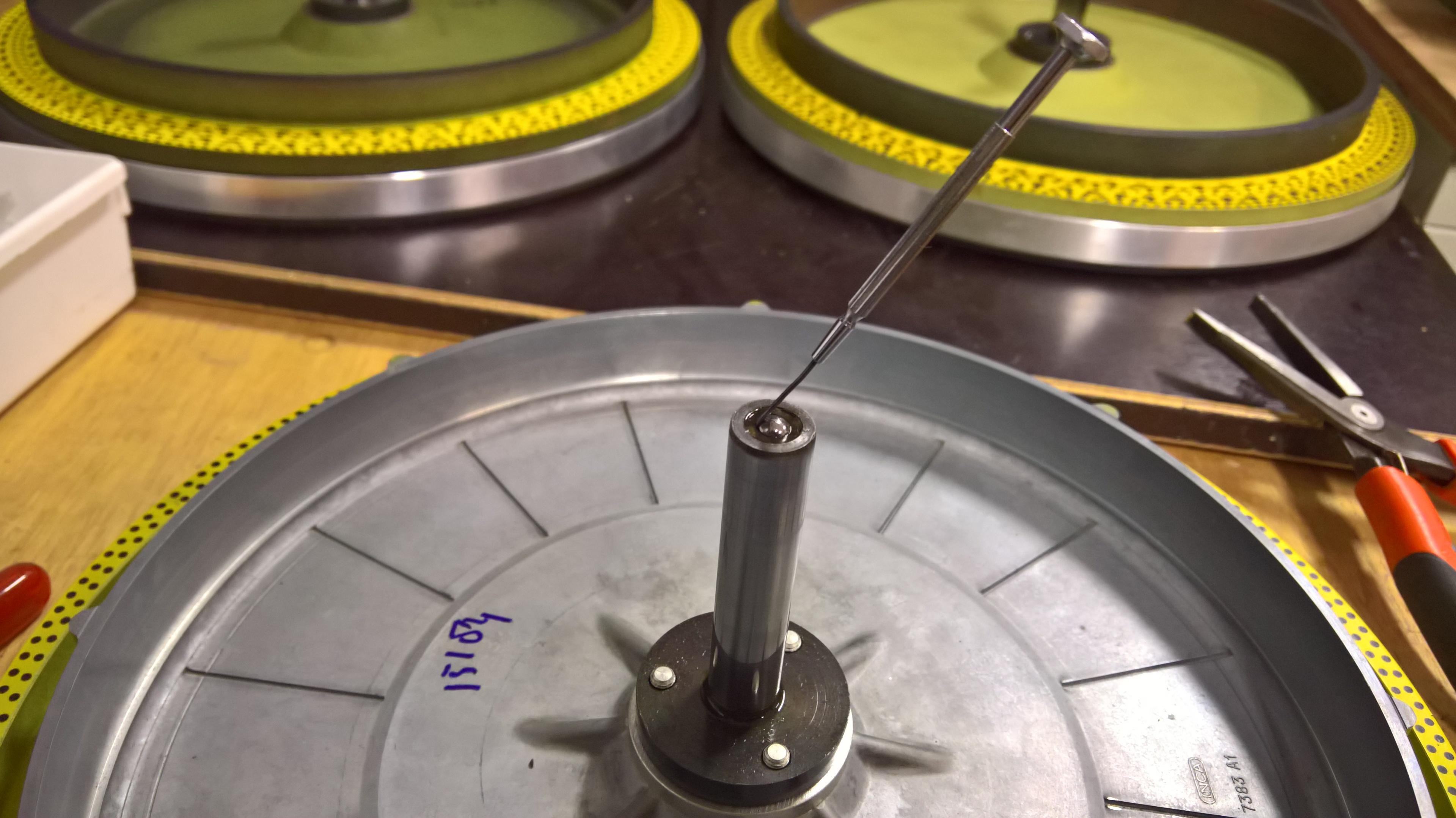

How to remove the tension washer like clip that holds main bearing thrust ball
Hi, TD 124fans:
I have a td 125 mk ii which I like. After I had read this forum (good read) I went ahead buying an used TD 124ii (#80582). I have had fun doing restoration. I have done motor rebuilding,tuning stepped pulley, replacing capacitor, light bulb and idler wheel. The table improved a lot. Now I am doingsecond stage of restoring: bush bearings. I am now having aproblem: I cannot remove the tension washer clip that holds the 6mm thrust steel ball ofthe main bearing assembly. The washer clip and the steel ball looks factory original but the steel ball is worn. I tried using precision screwdriver and utility blade to insert into one of the four tiny cuts on the washer clip in order to snap it out. But the washer clip would not budge at all. In fact it seemed that both the precision screwdriver and utility blade could not get into the cut much. Any idea? Thanks a lot.

That bearing ball is a must replace item if its never been touched. Its a cause for some degree of noise or rumble. I done a few, always seen circular score or wear under some magnification. Anyone used a Silicon carbide ball?
Volken,
Thanks for the advice. I did use a similar screwdriver but didn't get the tension clip off. It seems that you insert the screwdriver into the tiny gap between the steel ball and the tension clip and pry the tension clip upward. Is my observation correct? I tried to insert the screwdriver into one of the four tiny line cuts on the clip and that may be why I couldn't do it.
Thanks again.
