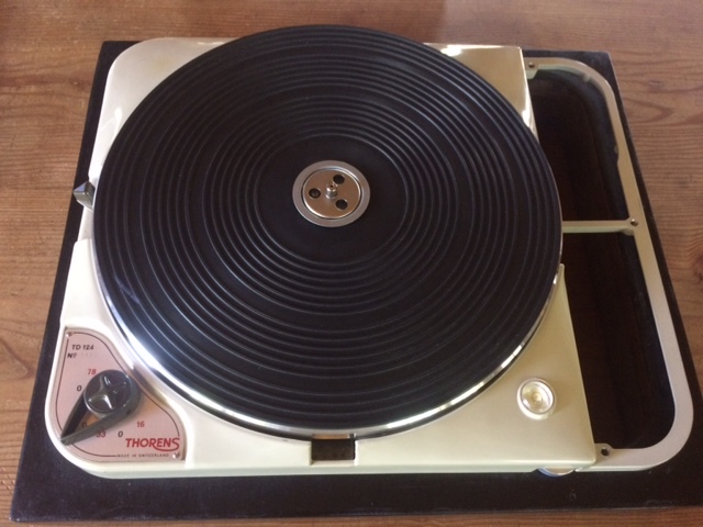

Best of luck. This week I installed a new belt from the Fla source that Kevin used. It’s a nice tight fit and now the table gets up to speed very quickly.
I cannot believe how good it sounds. Next up, I’m waiting for a new strobe window and o-ring style idler wheel from Audiosilente in Italy.
I’ve also installed a simple power line filter in the base.

Congratulations, that's an early one - probably around 1958 or so. (Maybe even 1957)
I highly recommend the Audio Silente (Simone Luchetti) idler as being by far the quietest idler I have tried.
I would also get the MKII motor conversion kit from Audio Silente, the sintered bearing kit from Audio-Silente, and the springs from Hanze Hi-Fi (Vulcan here).
Three-in-One 20wt electric motor oil is fine for lubrication, I've fiddled a lot with other lubricants and haven't found anything that I'd consider is really better.
Depending on the condition of the main bearing you may want to consider sending it to Chris Harban at Woodsong Audio, you can mention me. Alternately you can install new bushings - particularly important if this unit has nylon bushings installed. The main bearing is tricky as there are several variations in internal bore and it can be hard to identify the right replacement bushing.
The intermediate pulley may need a new bushing, if that is the case there are several people doing it, but I am not sure who to recommend.
Lots of options for the thrust plate and assembly - the stock one basically isn't very good and should be replaced. Lots of options for ball bearing and thrust plates.
Belts.. Hanze Hi-Fi has good ones, most others are pretty hit and miss. Good NOS OEM ones are rare but very good, and recommended.

Thanks Dilbert and kevinkr. After reading the tread. I purchased the springs from Hanze hi-fi. The idler wheel, MK1 to MK2 kit, new motor bushings/felts, thrust pad, and 2 belts from Audio-silente. Just waiting for them to get here now.
I was going to purchase the main bearings from ebay but the ad states that they may not fit my early MK1. So I have not figured that out yet. Maybe look for a caliper to measure what I am looking for.

I would send the main bearing out to a specialist. I have had problems with the bearing assembly in one of mine which came out of an early TD-124. (This table was pieced back together with parts bought over time from many tables.)
STS Turntables may be willing to redo the main bearing as well.

Thanks kevinkr. What do you think of the tool posted way back on post #2052? It does make it look simple as long as you have the right size bearings. Really... the nylon bearings have not left any marks that I can see on the spindle. But you suggest changing them still?

So my main bearing looks good to me. No scratches or anything like that. I do have the nylon bushings though. Should I still have them replaced just becasue they are nylon?
what do people think about the tool from post #2052? has anybody else tried something like that to replace main spindle bearings? It looks like it would be hard to mess it up with a tool like that.
I sent an e-mail to STS about cost as well.
