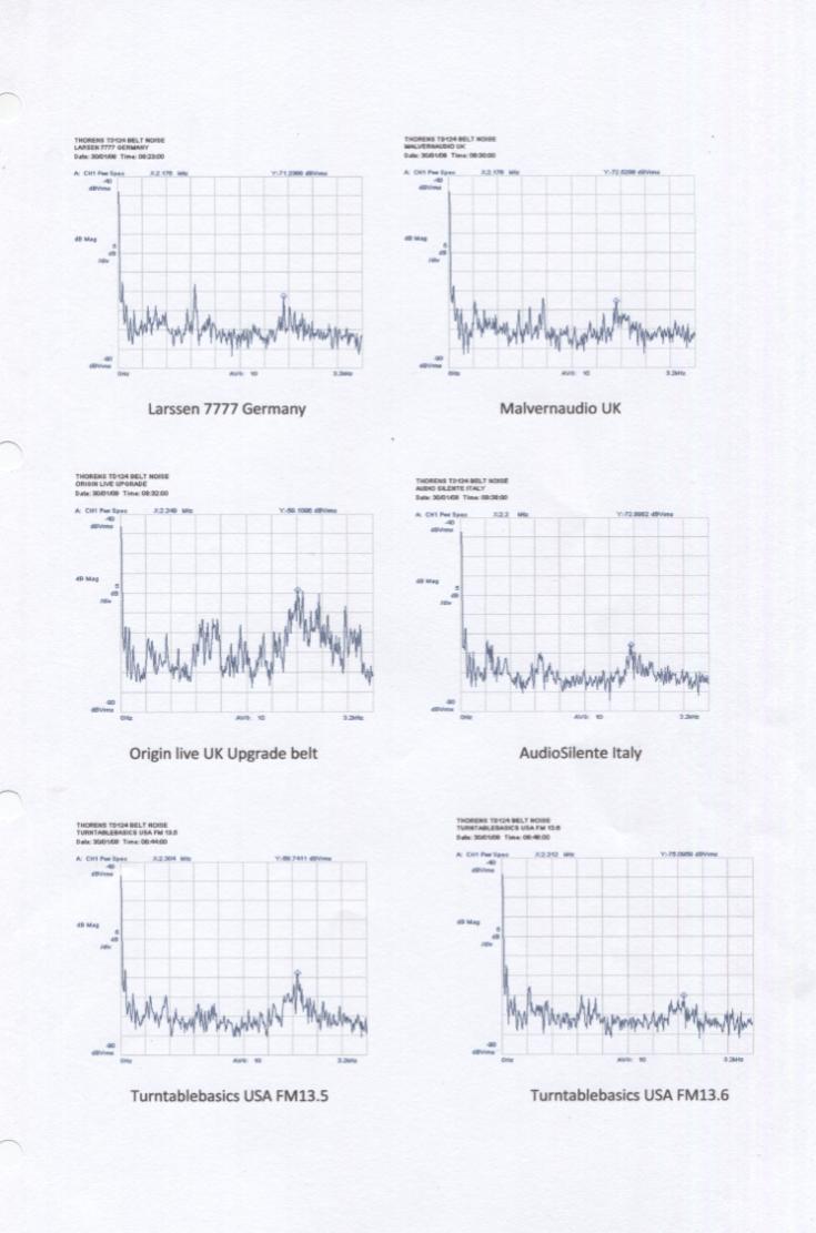

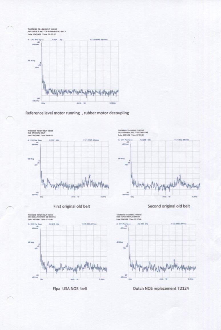

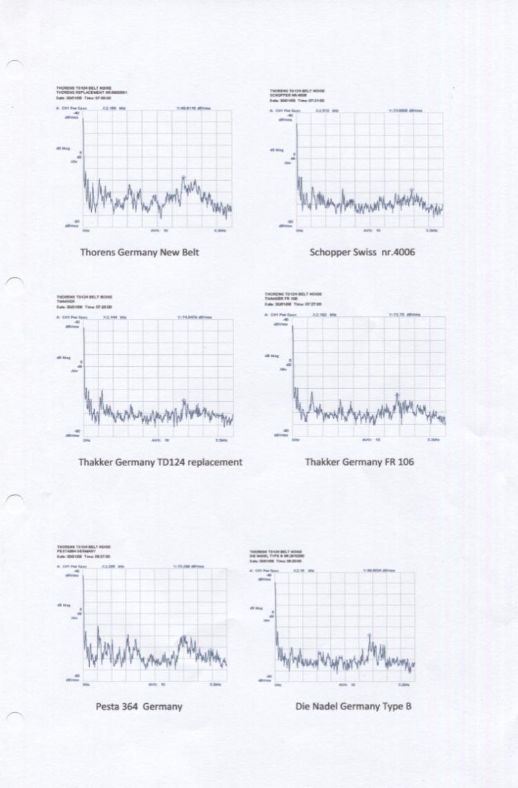

About a year ago I did a compare between 16 belts. The NOS original belts are the quietest as seen in the measurements .Searching after a good replacement I found finally a belt with the right dimensions , hardness, tension , who gave the results from the old original replacements.
I always suspected the original belts were the best.
How does it fare with regard to shedding?
Can you provide a link to your conclusion?
Thorens / Hanze Belt Low Noise
