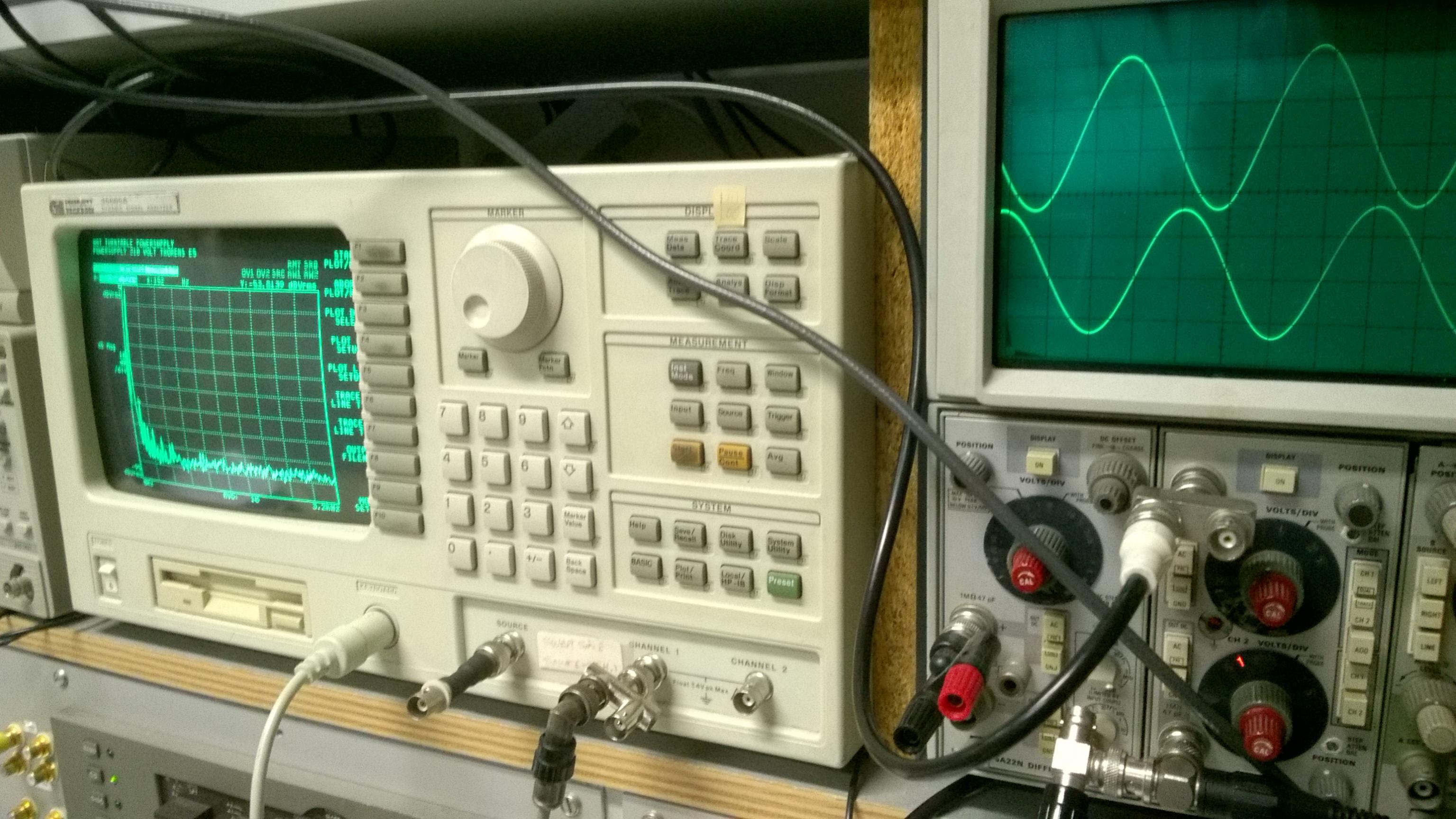

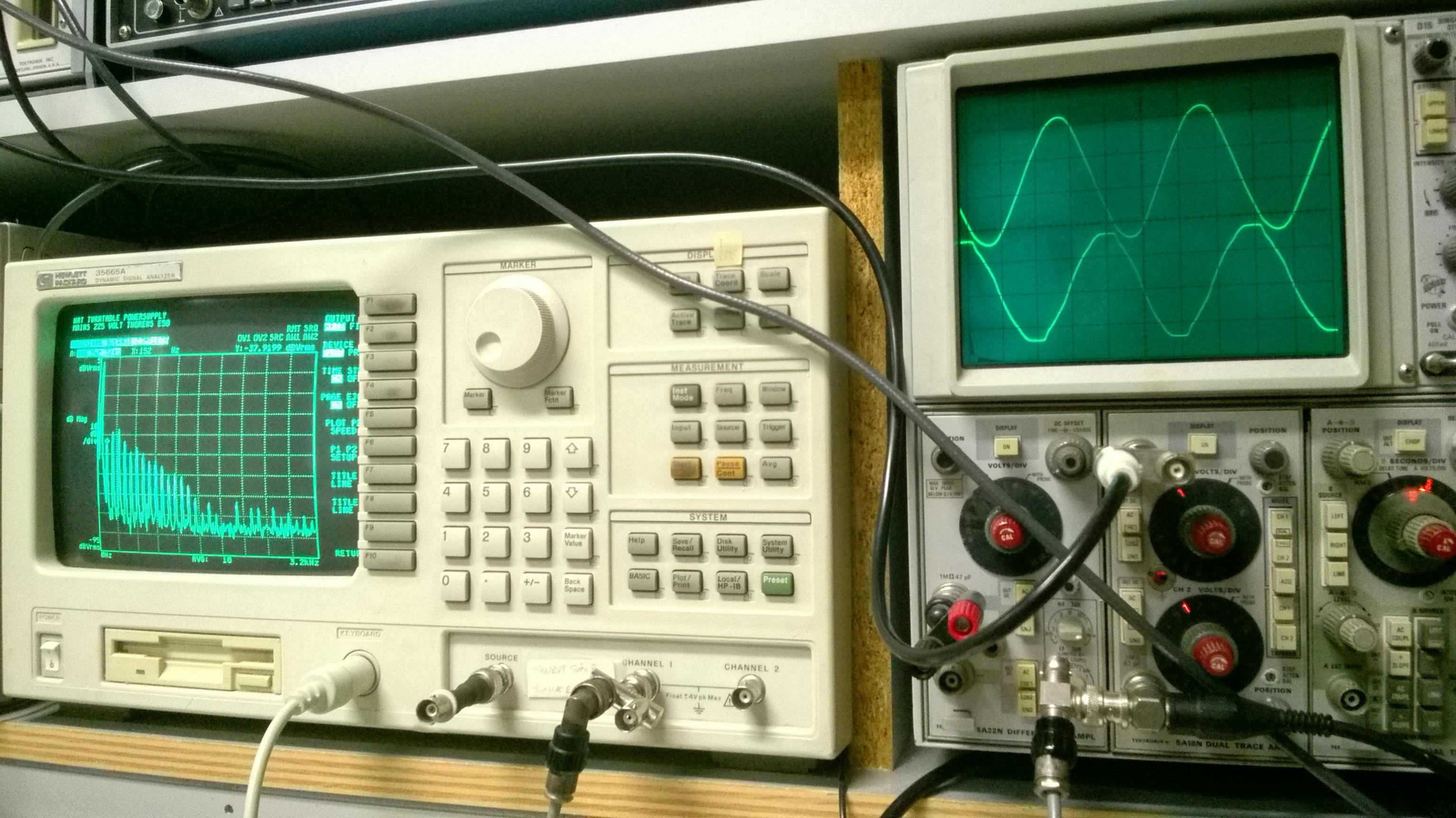

Thorens TD124 E50 motor powersupply measurements
Are preparing for a HiFi show next weekend, we let hear the difference between a Garrard 401 and Thorens TD124 turntable .Also a demo with the turntable powersupply to let the people hear the difference .

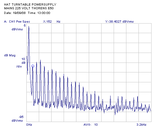

Some measurements I did here at home at our mains supply 225 Volt the TD124 E 50 motor connected , reference the third harmonic 150 hz with mains -38db with the powersupply on 210 Volt -53 db.
The the improvement in the sound is not subtle , black background, more detail , better and stable soundstage.
Volken

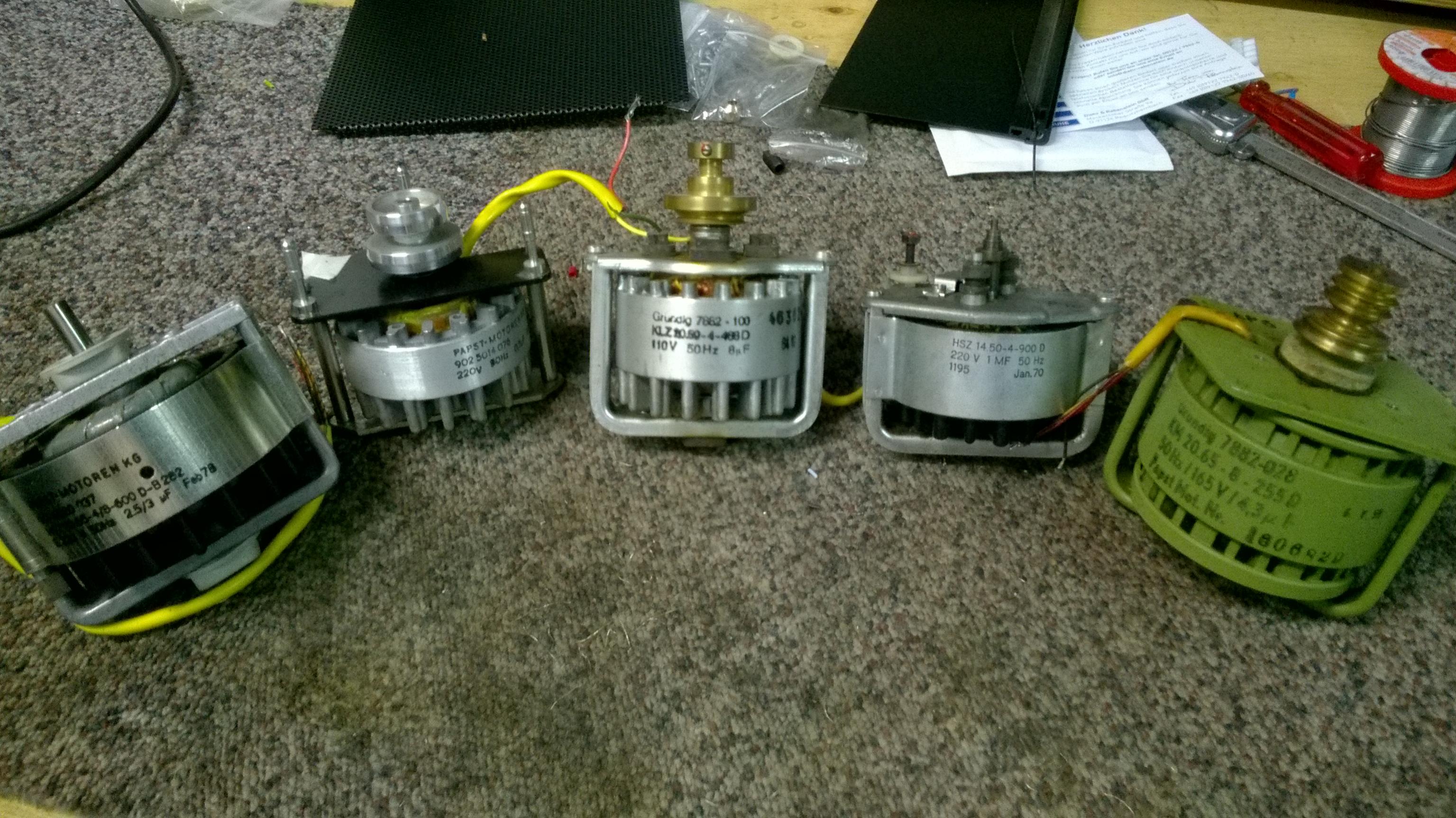

Nigel you creates more uncertainty about the original Thorens E50 motor this motor is a squirrel-cage motor same as the Garrard 301,401 and Lenco L75 motor , not a hysteresis the last locked to the mains frequency.
About the Papst outerrotor motor people think they are all hysteresis motors but they are not , depents how the outerrotor is made. The replacement Papstmotor for the E50 is a squirrel-cage motor!
From the Papstmotors on the picture there are two hystereris rest squirrel-cage .
