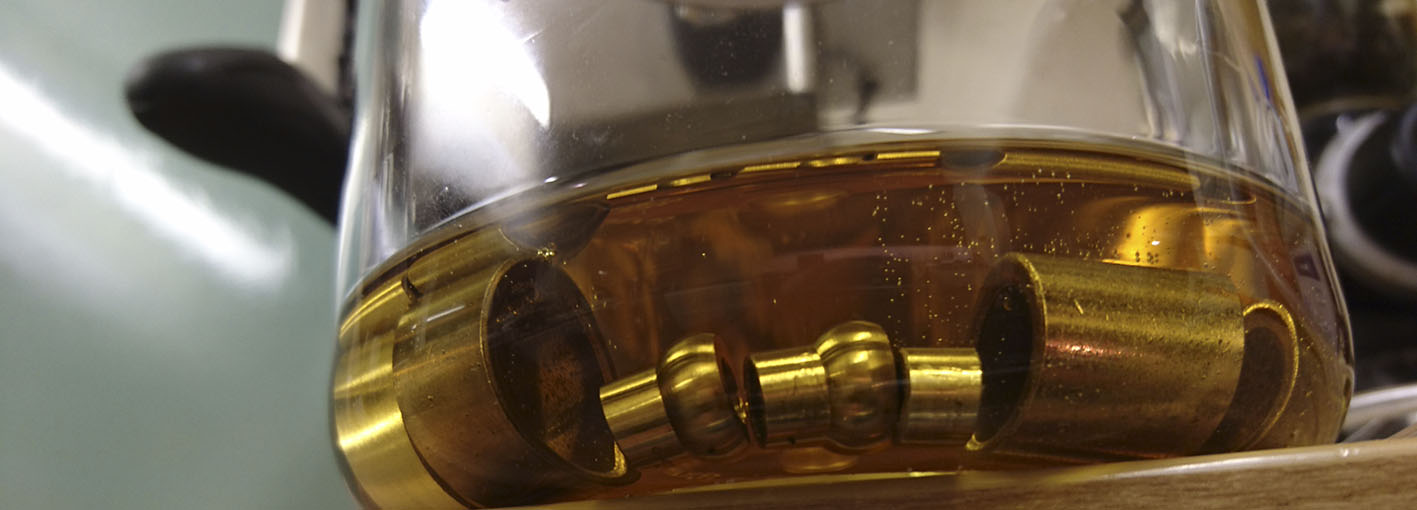

Just as a demo of the difference, here's a picture of oilite bushes for the td124 and td125, along with motor bushes for the E50 motor, all immersed in a low viscosity ATF fluid on which I've drawn a vacuum. You can easily see the bubbles of air flowing from the oilite, while there are non from the motor bushes. Proof if proof were needed of the importance of external lubrication of the motor bushes.
Are those motor bushes from Schopper?
I'm positive I'd prefer to use the porous bronze (Oilite), not whatever that is in the photo.
Did you say you had some TD125 bushing sleeves in there? That would be for a 10mm shaft. Impossible to service the TD125 bearing housing unless you want to do as the factory did; ..... Swage the bottom plate onto the housing. To rebuild one, you would need to destroy the bottom plate getting it off, debur-clean the end of the housing and then swage a 'new' bottom plate into position. It takes some tooling and a fairly decent drill press to swage.
-Steve
Hi Steve,
The motor bushes were purchased from Audiosilente as part of the E50 motor rebuild kit. I ended up reusing the original motor bushes as I wasn't happy with the replacements.
Replacing the bushes in the td125 bearing housing is tricky, but not impossible.
I used a No.1 12mm tap to cut a thread in the old bushing (top one first), then screwed in a piece of 12mm studding. By using a sleeve slightly larger than the outside of the bush, along with a large washer and a nut it's quite easy to extract the bush. As the bearing housing is machined all the way through its exactly the same process for the bottom bush. ( in the US I would expect 7/16 to be good replacement for the 12mm)
After extraction I removed and replaced the bearing support plate ( actually I simply turned it over and reused it) and thoroughly cleaned the inside of the bearing housing to remove any swarf produced by the tap.
Installing the new bushes is easy, I used a 100mm piece of hardwood, turned to just fit in the housing, then further turned down at one end to fit into the bush. It's then just a matter of pushing each bush into place, having well lubricated both the bushes and the housing.
This whole operation is much easier if you have the Mk1 td125, with its removable bearing housing, in fact I bought a replacement mk1 bearing housing and did the work on the bench before pressing out the mk2 housing and modifying the hole to take the earlier housing.
Audiosilente now has bushings made of sintered bronze which are supposed to be about as good as the OEM bushings when new. They've been available for a comparatively short period of time - I have a set I am planning to install during the next upgrade to my old MKI table which will include the MKII motor mounts, HanzeHiFi springs, different bearing end cap.. Etc.
