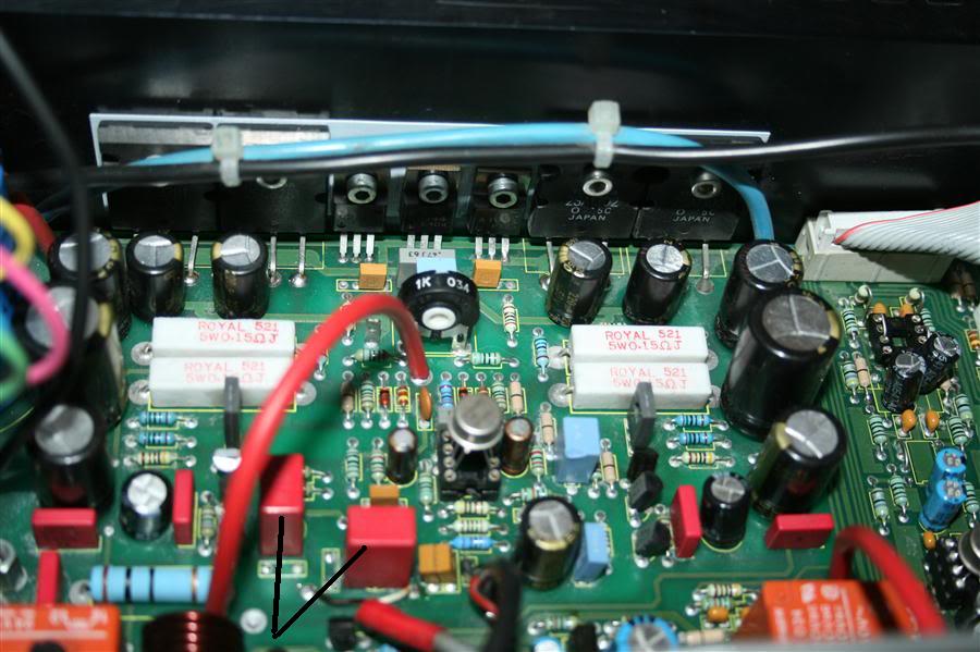

I meant to say that in the restek, there are 2 dc bloking caps on the input to the power stage. I replaced mine with some MKS2 22uF poly caps which unfortunately are now obsolete. This is a must for this amp! def get rid of all elco's in the signal path.

In the diagram, they are 22uf Bi polar elco's bypassed with 1uF poly caps. I think mine were similar but not exactly the same.

didn't actually get which elco caps you are talking about. Do you have a picture of these 22uf caps?

The caps are marked on the pic below.
In the service data, there are no caps shown on the gnd connection.
In my amp, on the signal input, there was a 22uF elco bypassed by 1uF film. The 1uF has been removed and the 22uF elco is replaced by a 22uF film (red block in the pic) I did this for both the signal and gnd.
